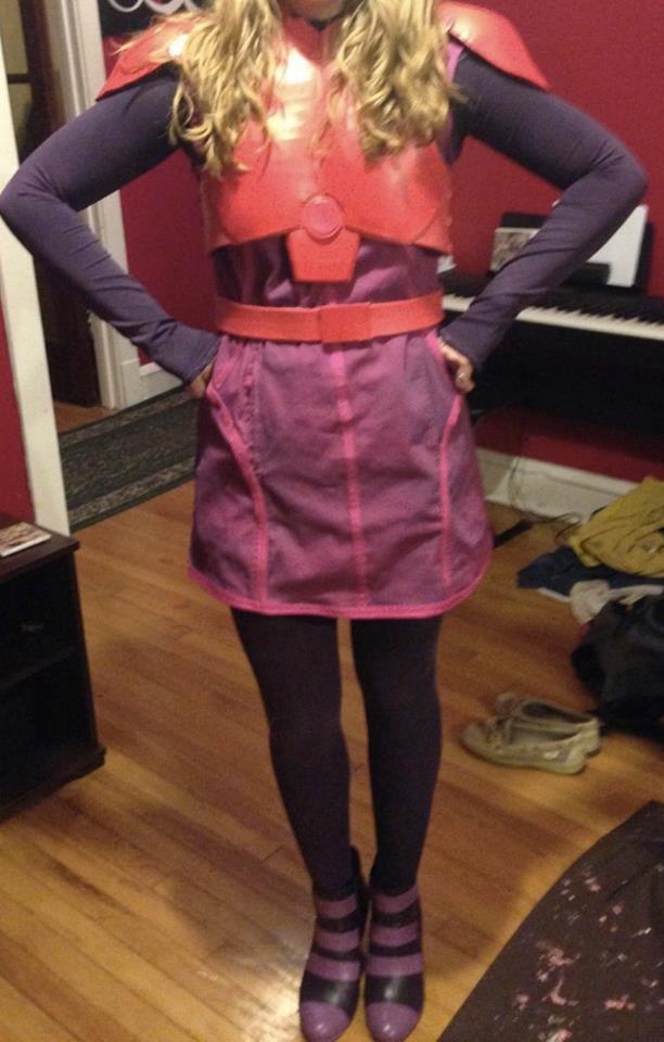

Hey, could you explain how you did the chest piece? Was it the same idea as how you constructed the helmet? Thank you!
Re: Honey Lemon - Big Hero 6
Same process! I built a template using the same process as the helmet. I apply upholstery foam first, if I'm trying to build up thickness in certain sections.

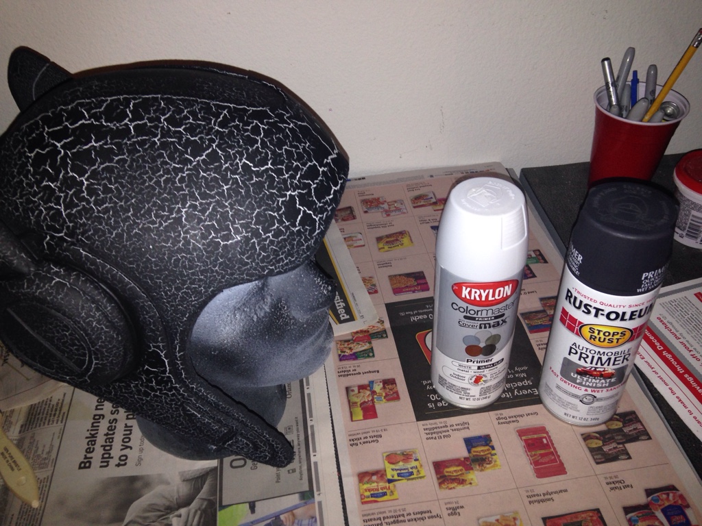

Arrggghhh! Was doing layers of primer and think I just found an incompatability between two different brands! I had a good base coat of white Krylon and sprayed a layer of gray rust-oleum automobile primer and got this "lovely" effect!
I'm officially aggravated!
While it's aggravating for what you wanted, keep that combo in mind. It's hard to get that mottled / cracked effect.
