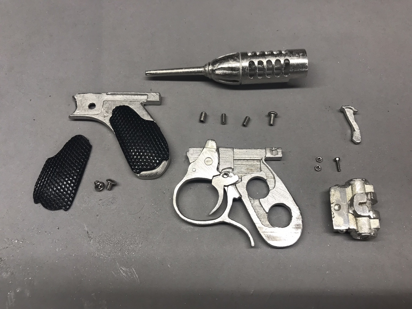

I'm very well advanced in my kit reguarding the metal work but there is no way to guess what you intended with all the screws.
Please help us

Just a drawing or a few pics of where the screws go and what size they are would be great already.

Hey,
so far, I'm pretty well advanced on the metal work on the kit, just have the grip frame to clean and then try to improve the big back piece that has lots of deep surfaces that are hard to reach with the process I used.
I have been doing everything by hand, sanding on perfectly flat surfaces then using smaler and smaler grain of sandpaper, starting at 320 and ending at 12000. (I'm a guitar maker and used a wet sanding sandpaper kit for laquer finishing). Then I polished by hand with mother and mag polish. It's great, you just rub it by hand and the result is great.
For the big casting flaw that I had at the front of the main part, I used silver solder wire like McKeePhoto depicted in his thread:
It worked nicelly and the part is already better looking but I didn't manage to get a perfect surface without any small crevices sadly.
good luck for your kit, it's very fun to work on.

can you at least confirm quickly that the large grub screw is M4, all the other screws exept the really small one are M3 and that there is no need to tap the small one as it has nuts?
