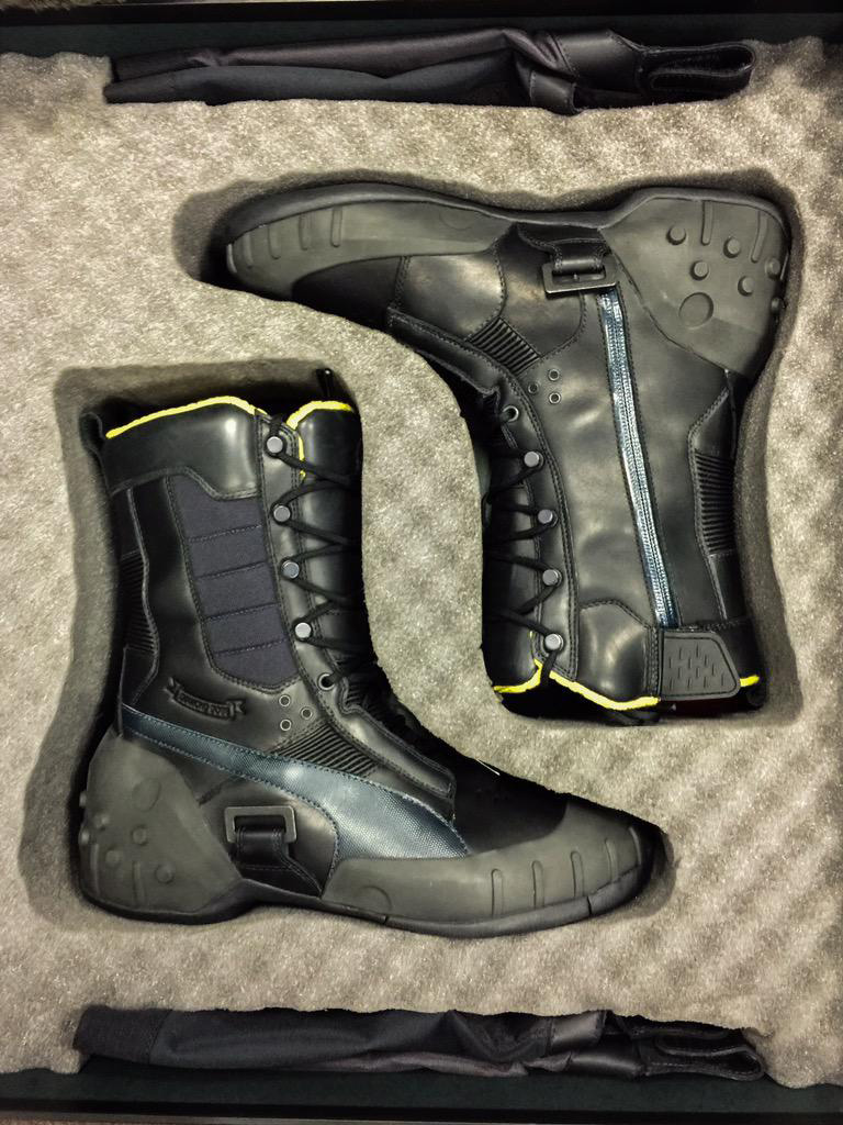

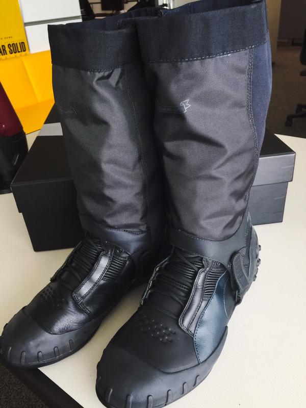

Puma Boots!

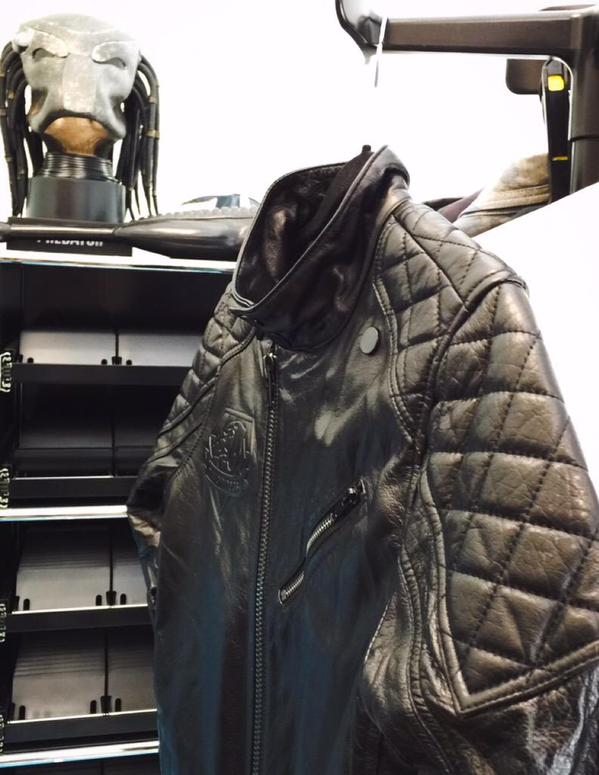

Snake's Leather Jacket-

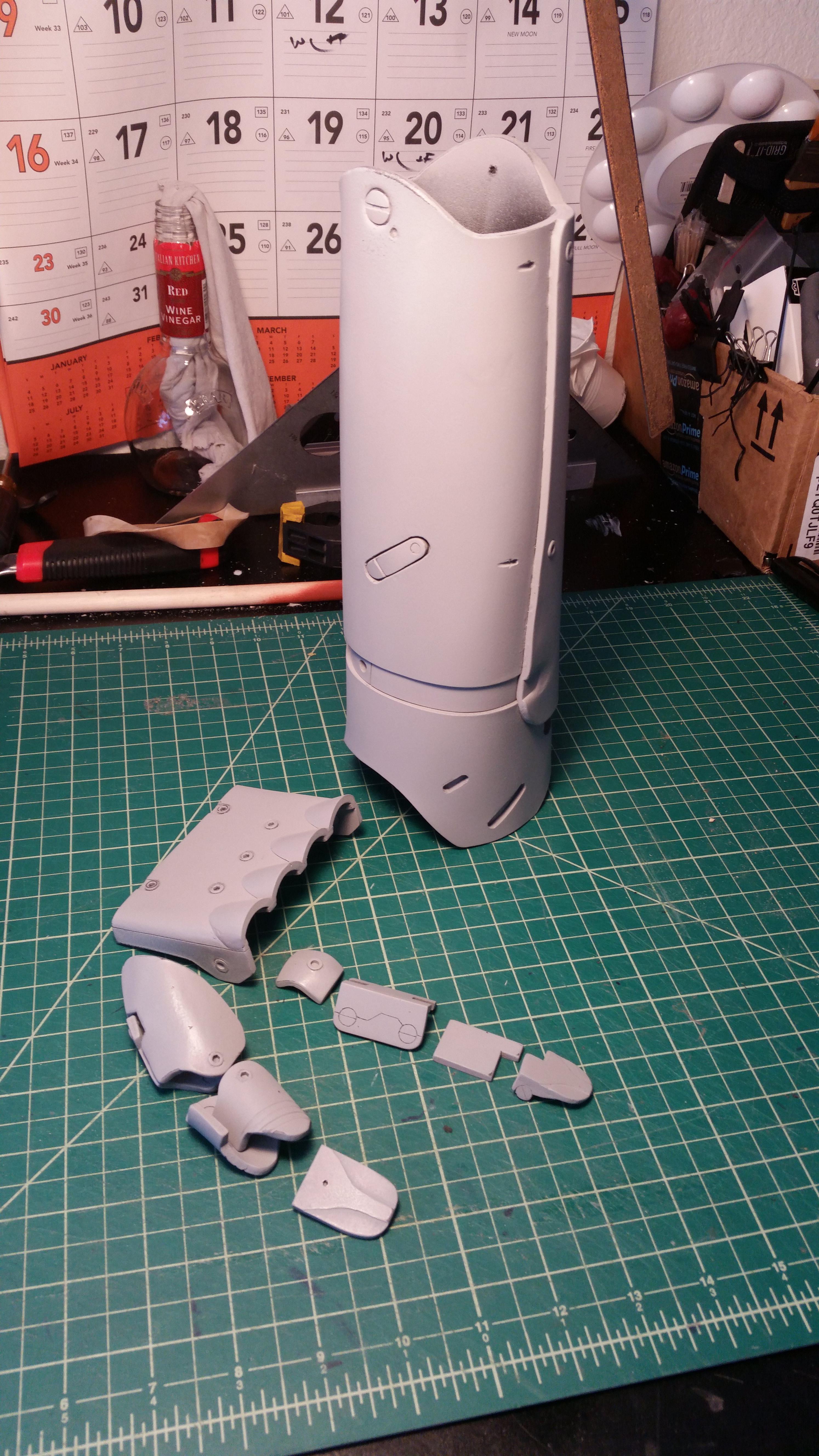

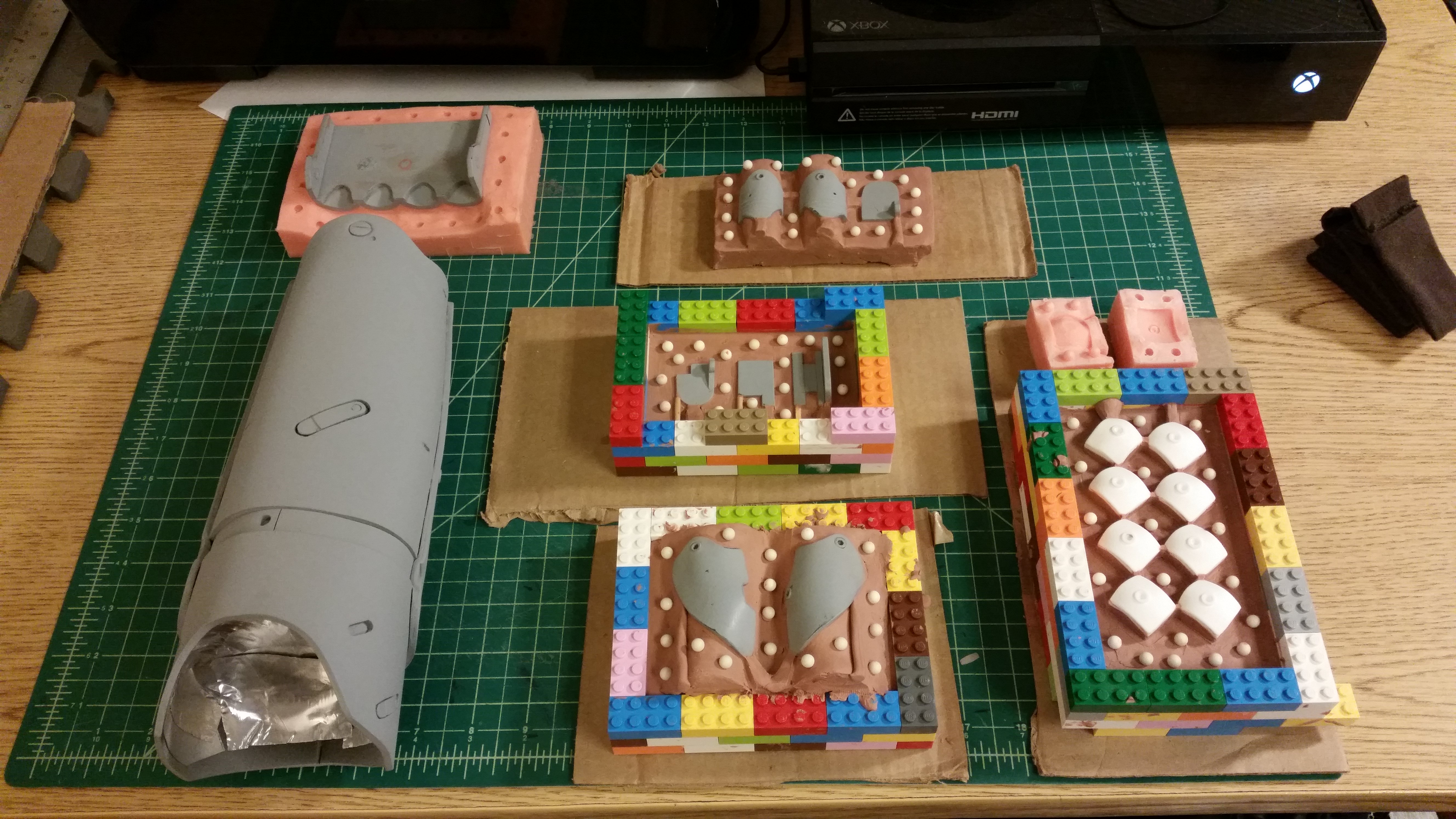

Hey Metal Gear fans! Thought I would add my WIP prosthetic arm to the collection of cool stuff here. Unfortunately it is not 100% accurate - some compromises have to be made in order to actually wear the thing. The fingers will be simplified by only casting the red portions, leaving the grey parts represented by the glove underneath. The slanted plates at the cuff are omitted because they would completely prohibit movement of your wrist. I had to favor scale/practicality over accuracy, as including those parts would only be possible by enlarging or distorting the rest of the build. There are also some details that I didn't see until I found this thread, so I'm going to try to add those in before molding continues. Everything in the master is made out of 3mm Celtec.
Despite the obvious pitfalls, I plan to cast these in Smooth Cast 300 (and maybe 65D because I have a lot lying around). I am 6'2", so it's probably longer than most people need it to be. The length of the arm can be customized by shaving down strategic points, like the inner elbow. The 65D comes out flexible, so a slit could be made to accommodate wider arms than mine.
I'm waiting on more silicone rubber to continue, but here is the progress so far:
The arm is not as uniformly tubular as it looks in that picture - it flares out at the base, but perhaps not quite enough :\
Close-up of the knuckle plates. I hope this method works, because I really don't want to cast each of the eight pieces required per hand one at a time.
This is the first time I have tried using BBs as registration keys - something I thought up when my last mold didn't like to stay aligned. I think it works pretty swell, as it is both extremely easy to add them to the mold, and the mold actually holds itself together like a true puzzle.
Thanks for looking! I hope to be casting these by this weekend, and painting soon after!

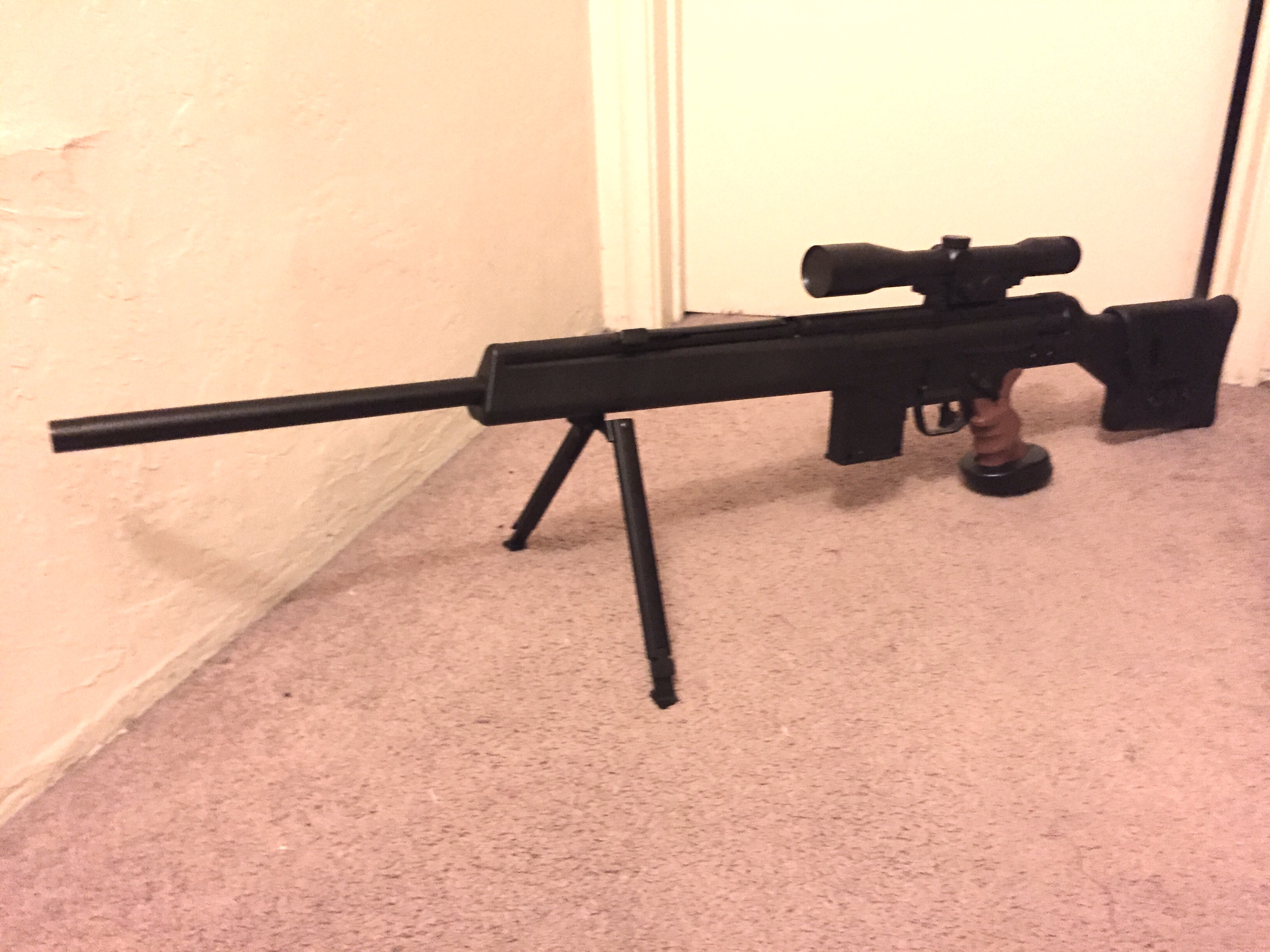

PSG1 was a cardboard/foam/PVC build, one of my first props. Same with the stinger. Raiden armor is mostly EVA foam on tights. Gray Fox helm by Stealth, finished by me; suit was a sub dye painted by me and sewn by Unicron Sushi.

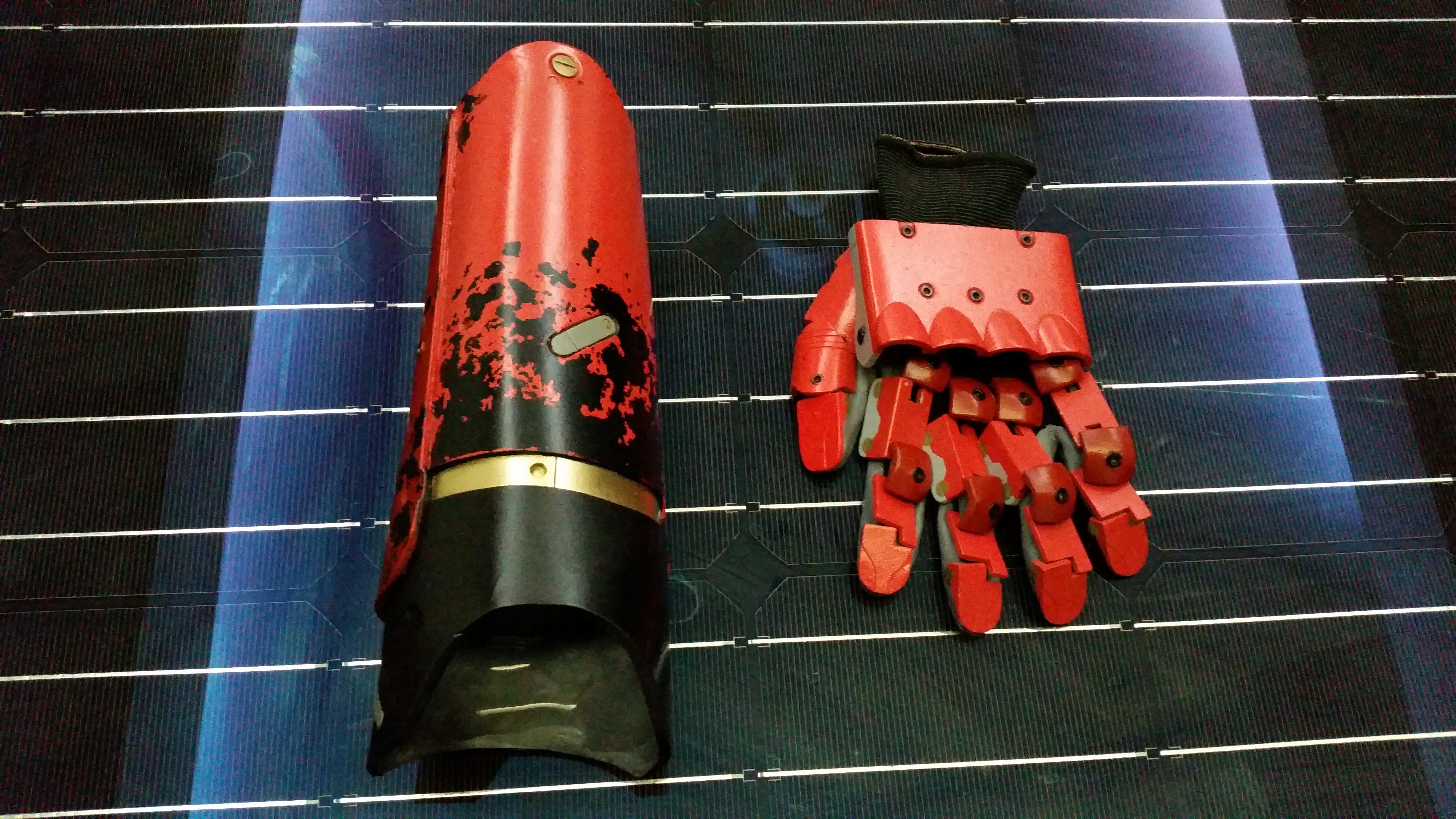

Finished Snake's arm with 14 hours to sleep before I can finally play!

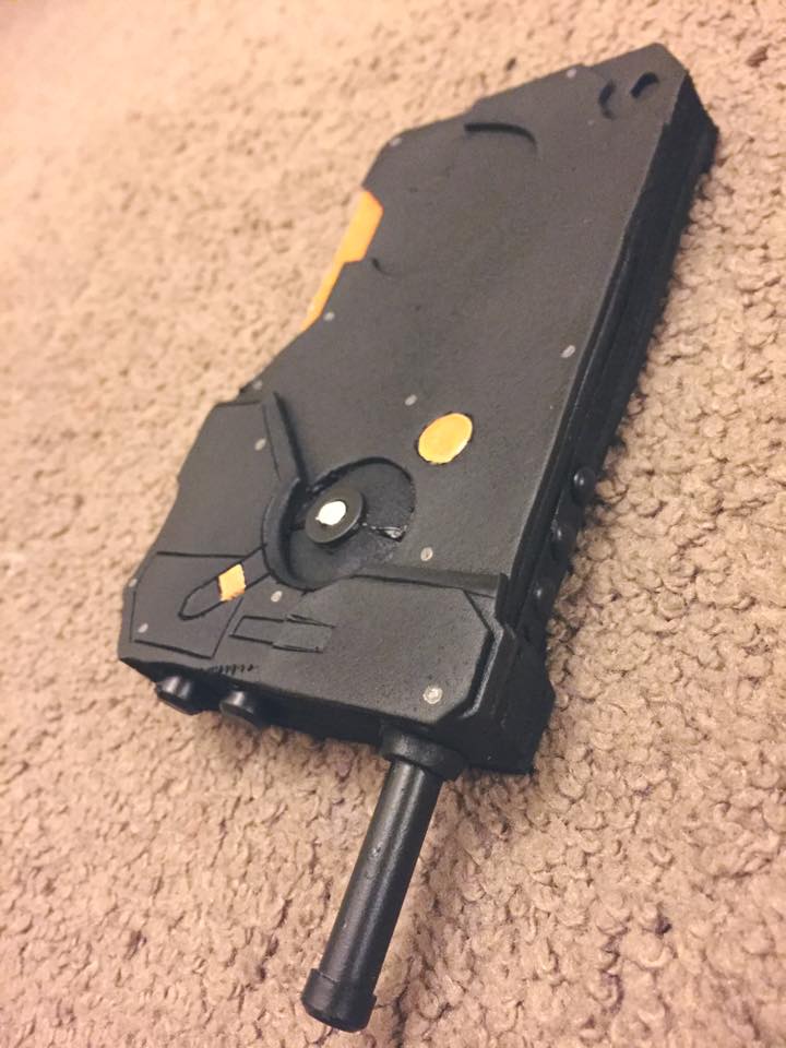

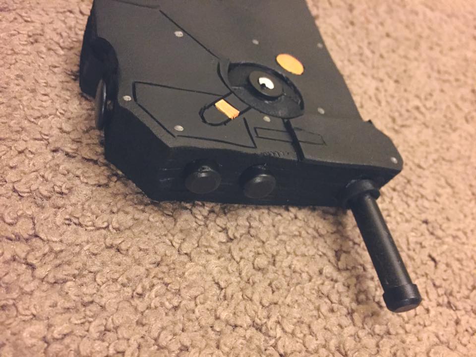

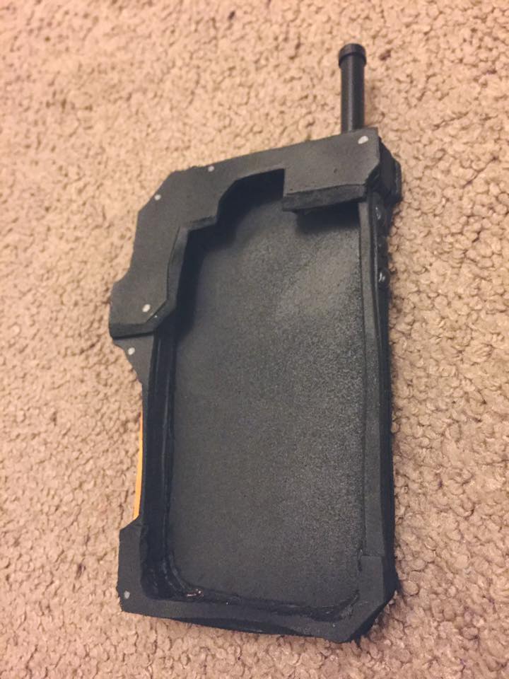

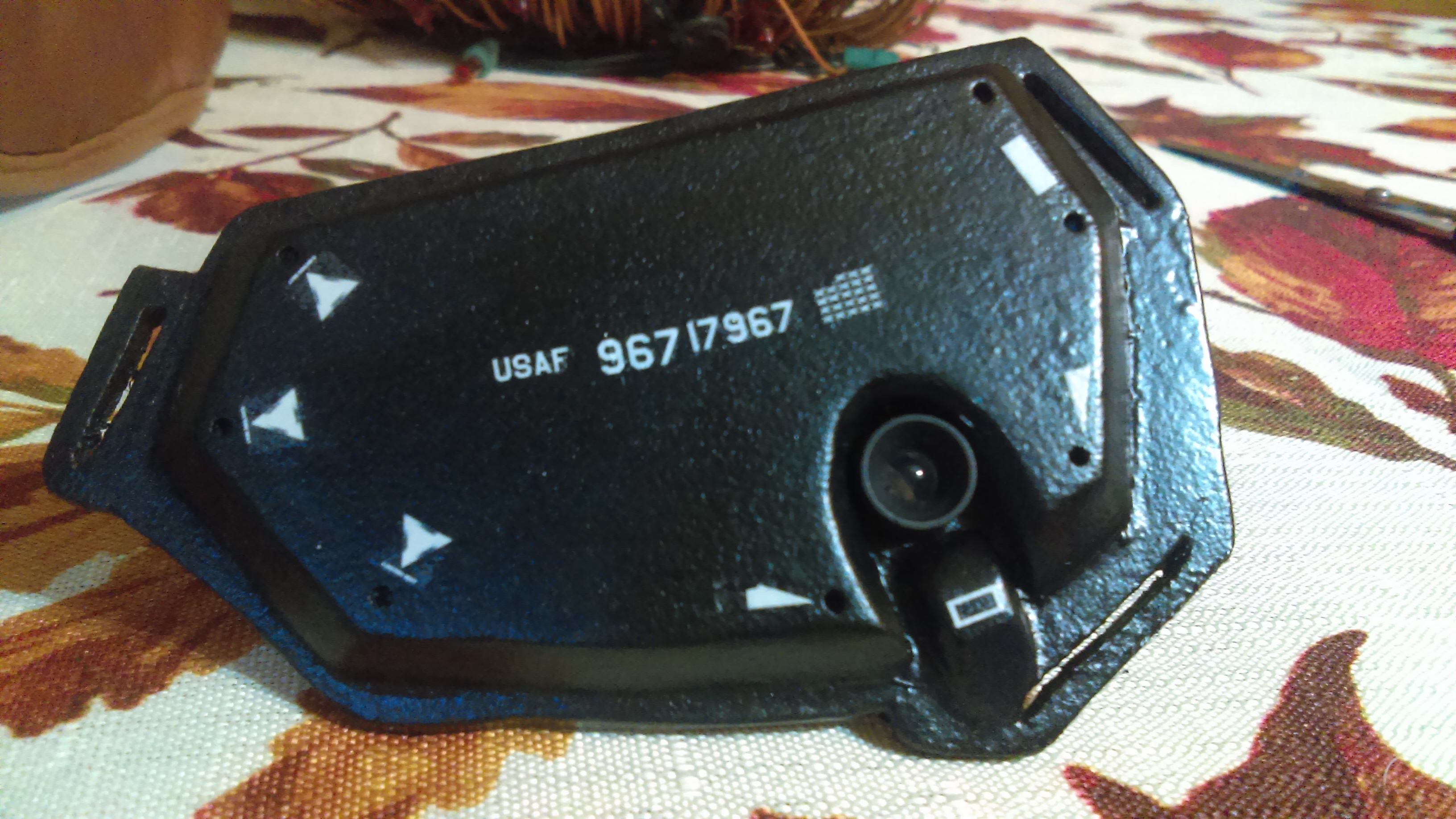

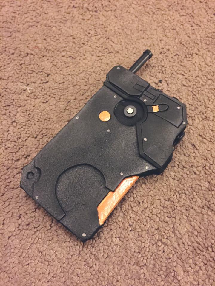

I'm currently working on Venom Snake's sneaking suit from TPP, but as I wait for webbing for my SPIE harness I decided to take a crack at the props, starting with the iDroid. I really wanted one of the official ones for the iPhone 5, but now I have an iPhone 6, plus the cases themselves go for a ton of money now that they're secondhand. So, I decided to make my own iDroid, out of EVA/craft foam. I layered the foam up around a "frame" that fits around my normal phone case; this way, I don't have to worry about removing one to use the other. My phone just slips right into the iDroid. After building it, it got coated in black PlastiDip and then orange, white, and silver acrylics for the details. It doesn't have the bells and whistles of the actual iPhone 5 case, and it lacks ports for the back camera, side buttons, and Lightning port, but my phone slips out easily enough that it's not a problem.

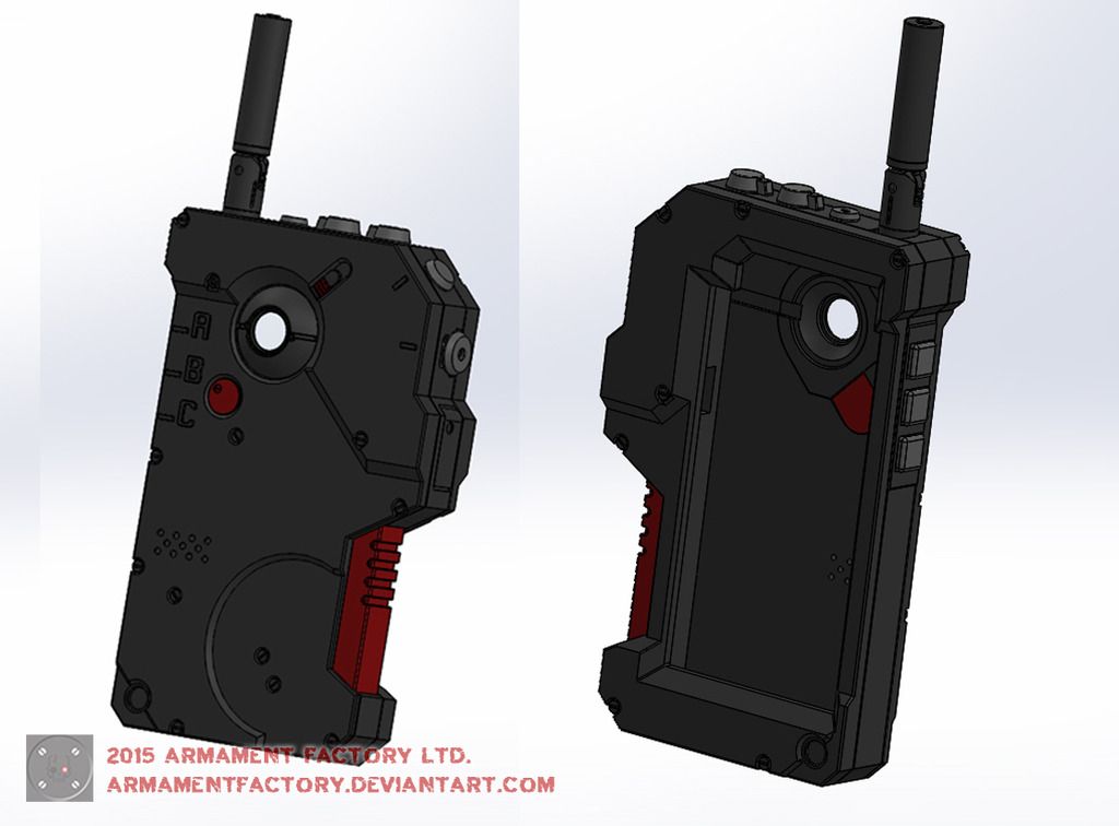

Been working on an iDroid too, it's at its 3rd rebuild already.
I based it on the official case, then modified it so it looks closer to the in-game model. It's built around my Android phone, still trying to figure out how to make it "print-friendly".
There's still a bunch of mechanical things I need to figure out - like how to install the phone, and where the batteries will go.

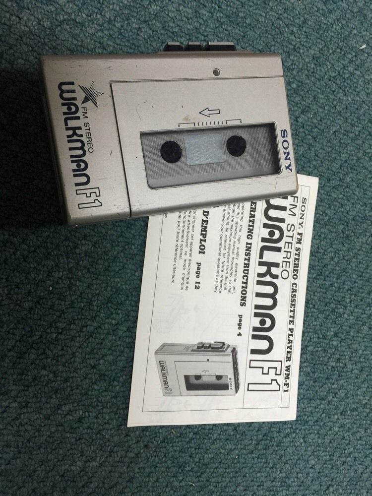

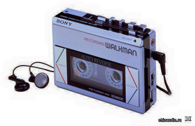

Neither is the WM R55 from TPP (the 3rd photo), but unfortunately those go for a pretty hefty sum now. I have to choose between them; the WM16 has the bigger window with black around it but is nonfunctional; the F1 looks less accurate (more like the silver+blue TPS-L2 from GZ and Guardians of the Galaxy), but it is partially functional, which would be nice to have with the MGSV soundtrack converted to tape.

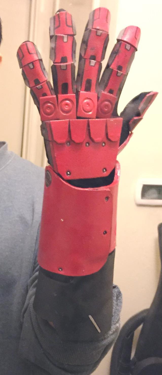

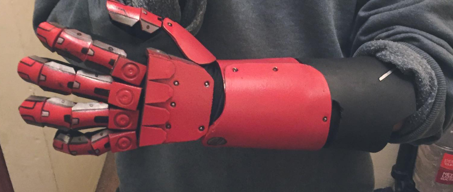

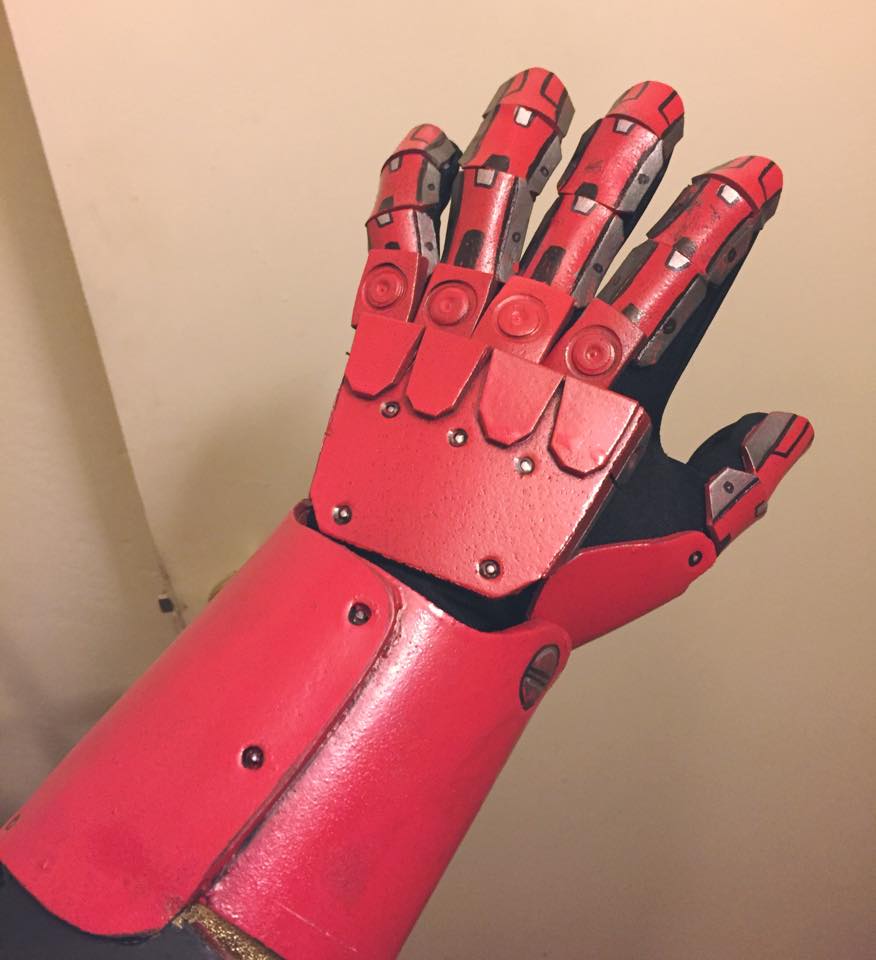

More MGSV Venom Snake stuff, I remade my bionic arm after Comikaze, since that first one was made the night before the con. v2 is all just 6mm and 3mm craft foam, sealed with PlastiDip and then painted with Krylon Color Master red and some acrylics for details.

Been taking a few (functional) liberties with the design. In particular, the lanyard loop (I think I did ok with making it look like it belongs there).
The data/charging port is definitely inaccurate, but since we never actually get to see it, I figure it'll do. ;)
