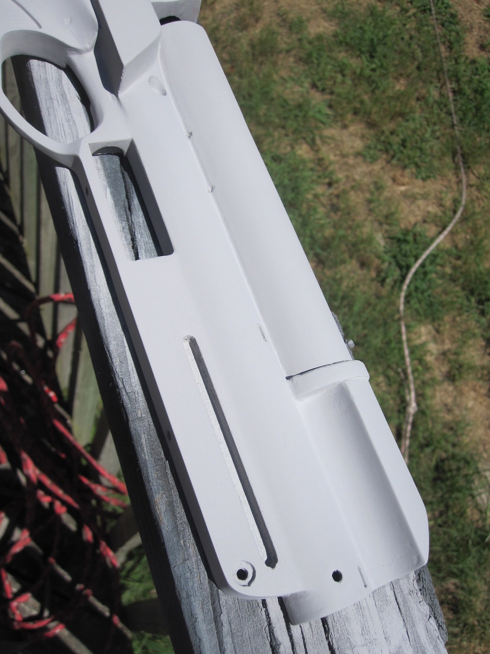

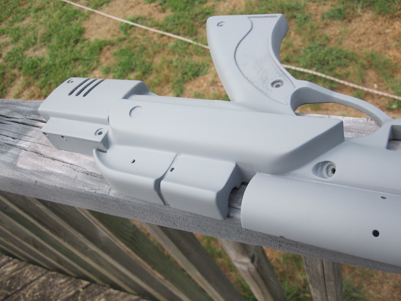

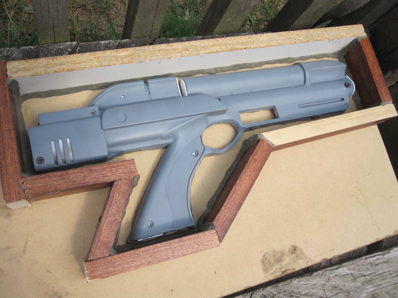

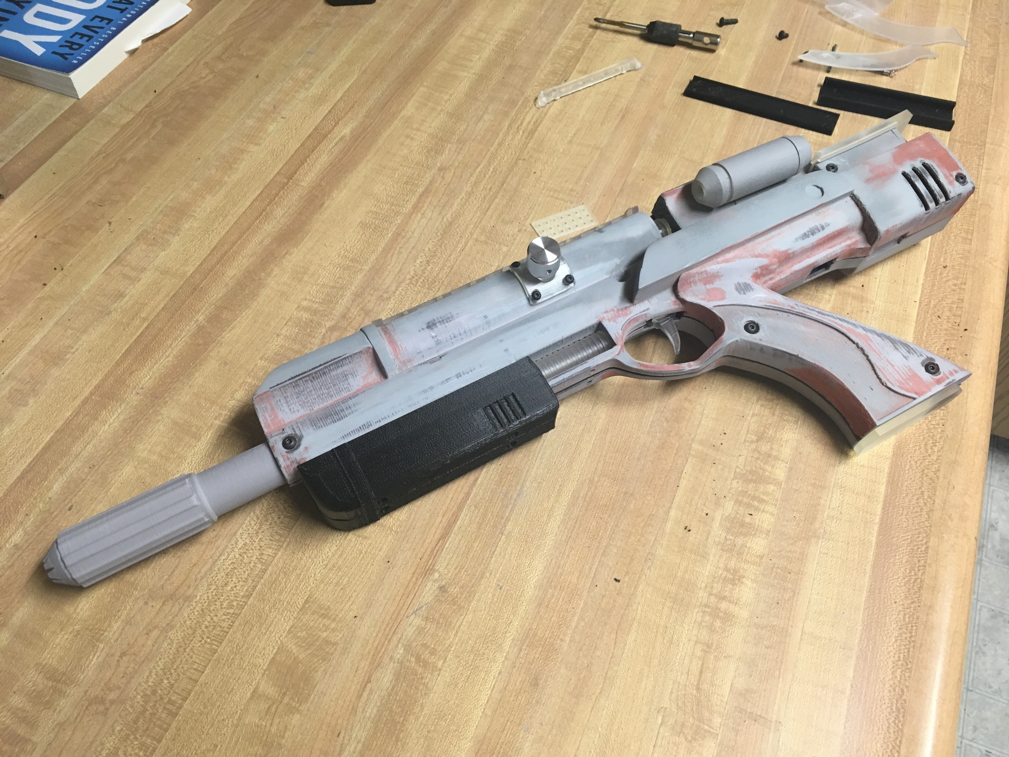

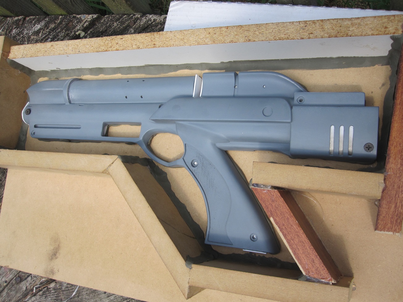

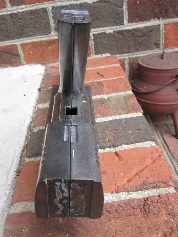

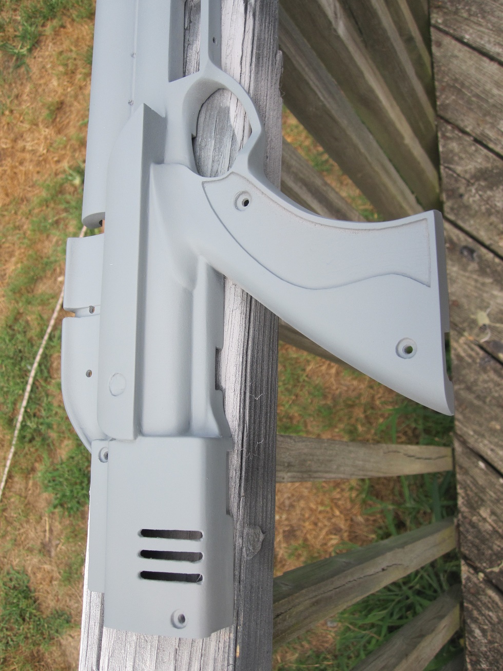

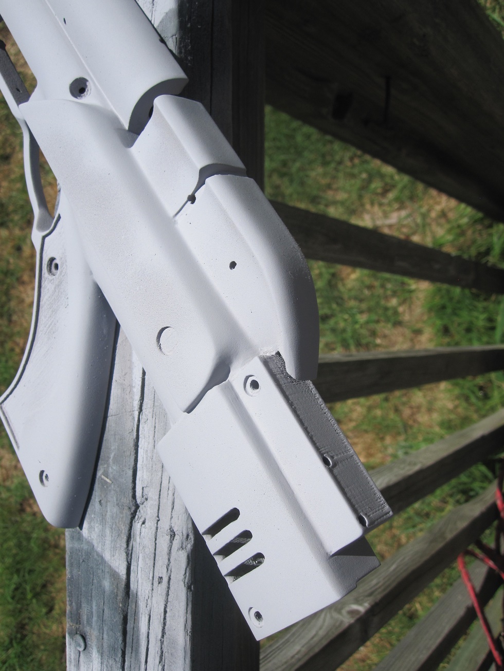

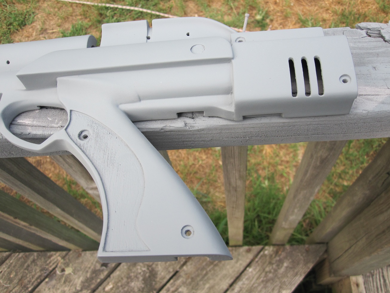

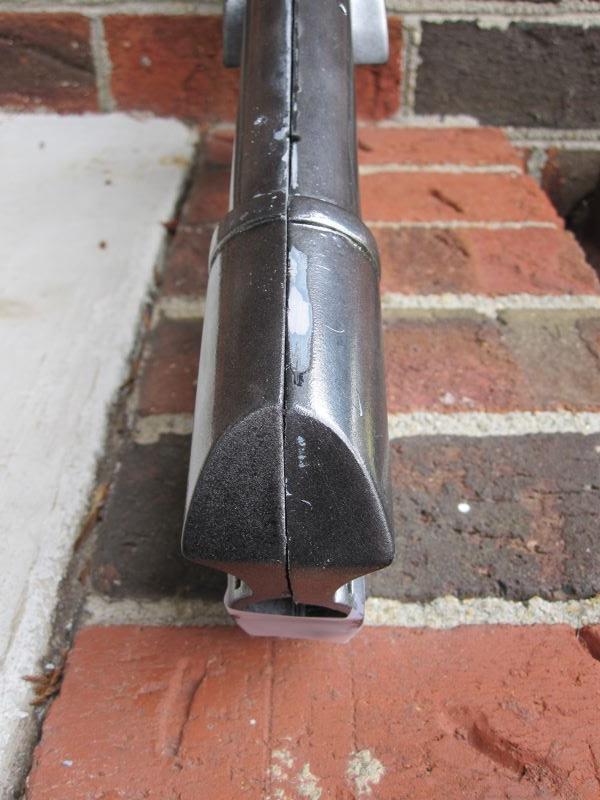

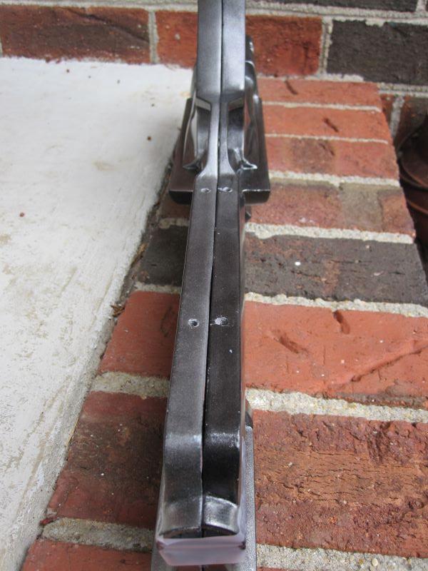

Well, I had ordered a few parts from Shapeways and they came in today. I was doing another dry run and didn't have enough of the screws to attach everything. I'll be going by Sunday to pickup the rest. Just like Joatrash said there have been a number of issues that have come up because of the main body being printed in ABS and then the smaller parts being done in resin. The original RPF member I got my parts from has said they are going to replace all the parts that were poor quality so I'm waiting to hear from them still. Here are a few photos of what's attached as of now. The rear plate now fits but one of the edges wouldn't clear when it was being tightened and a small crack happened. That edge will need to be sanded to make clearance easier. The resin grips also did not fit the body and have been resized by Skylu3d to fit the ABS body. The difference was about 3mm or so. The bottom magazine piece also needs to be sanded as well for the bottom handle of the grip to close all the way. While there has been some setbacks it's still moving along!

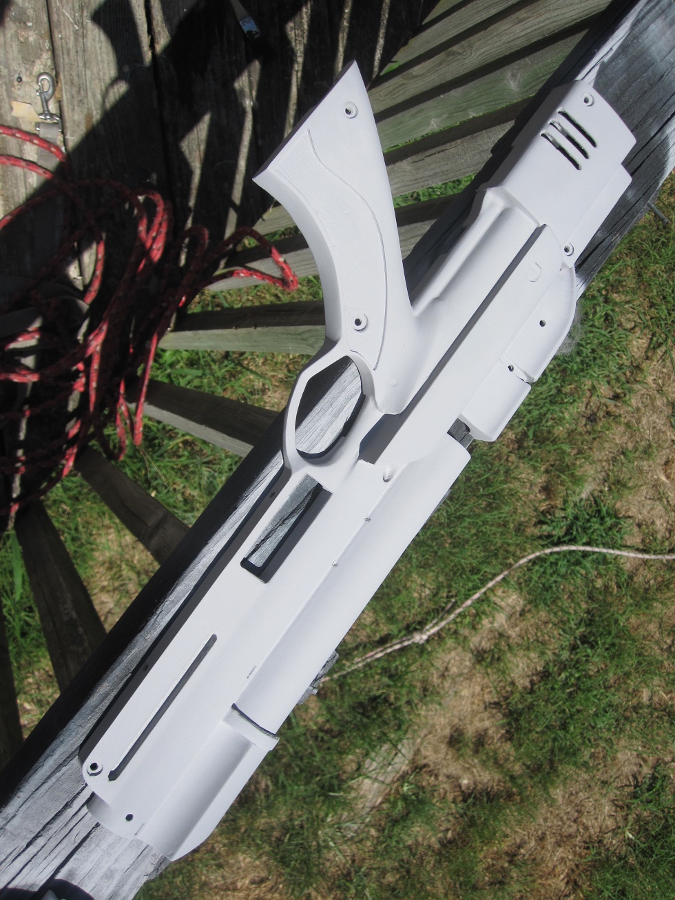

....and now here we are. Pat sent the gun back because it wasnt really going together as well as he wanted. The 3D printing was pretty bad and some errors in the design didnt allow certain parts to fit and to be honest most every part were just wrong. Of coarse one thing led to another and before you know it im pretty much remaking everything....sometimes a couple times...lol Rusty agreed we post some of the progress that has been made.

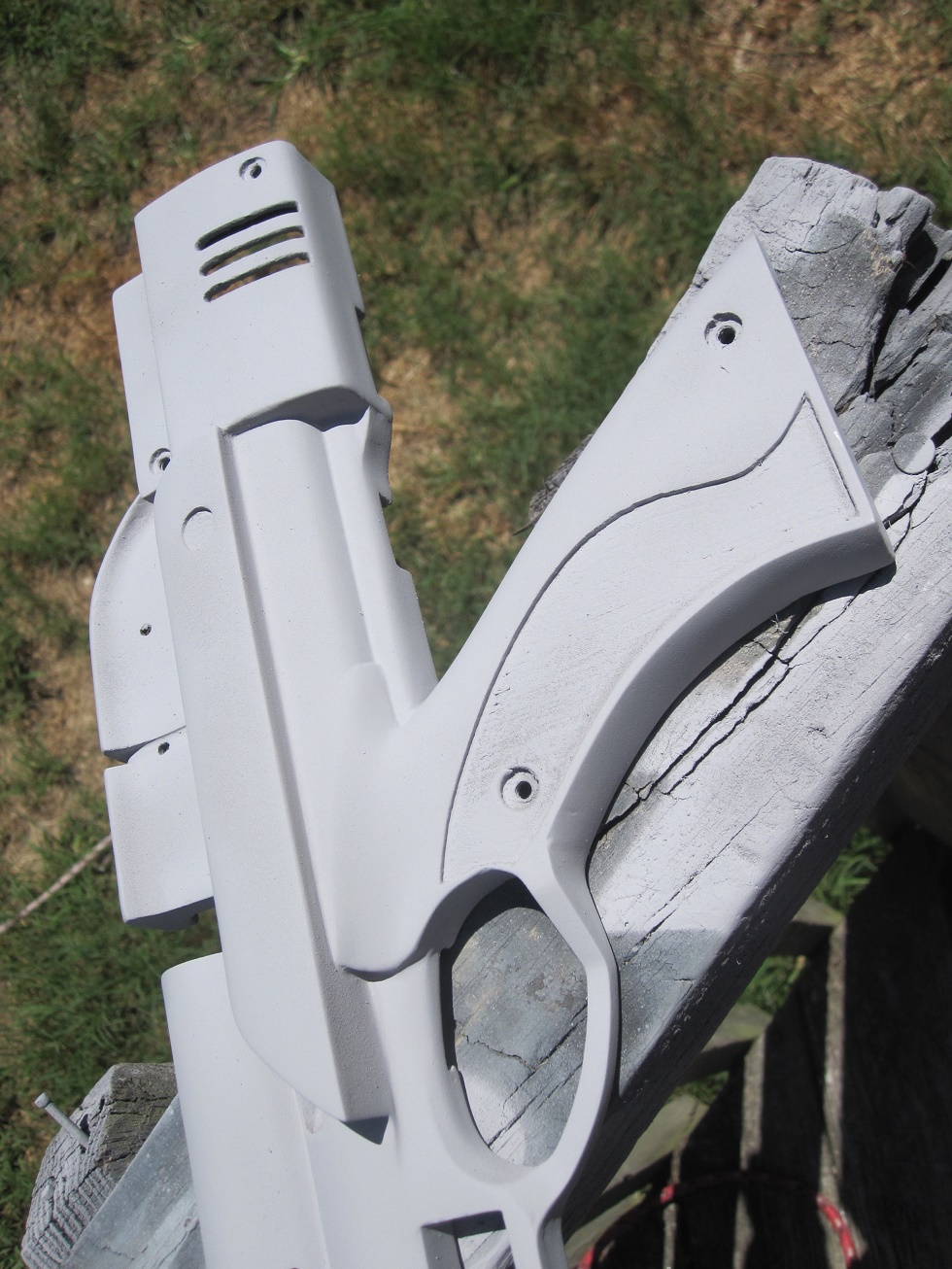

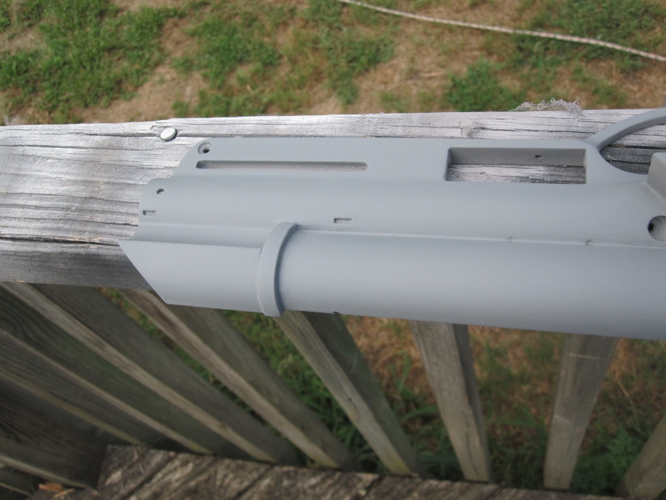

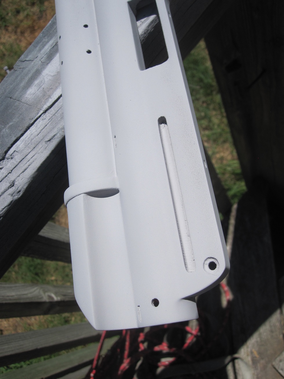

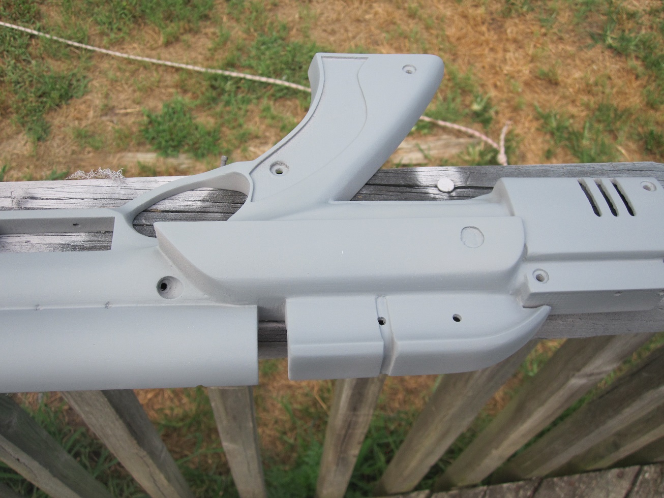

The shells had a tongue and groove system to hold them together but the printing didnt allow for it to fit so they were removed, here they are after they were removed and the shells trued up.

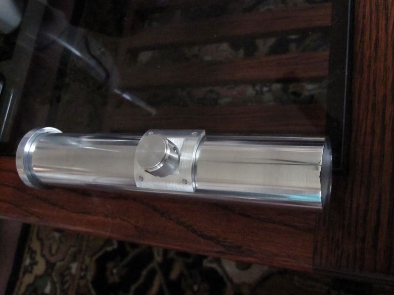

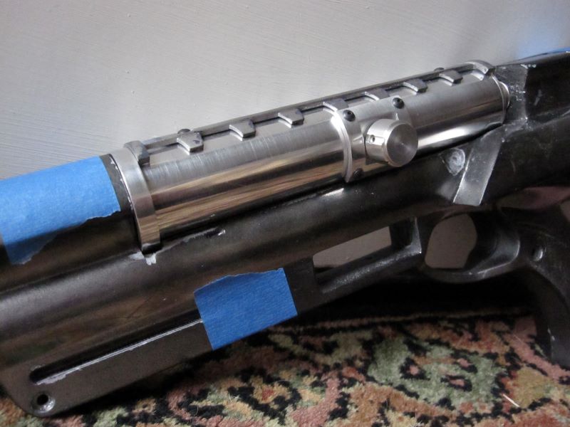

The top tube was never going to work right so i decided to just make one along with the piece that goes on the side and an end ring. I also found the correct knob that was on the original prop but it ONLY took 2 years to actually find some for sale.

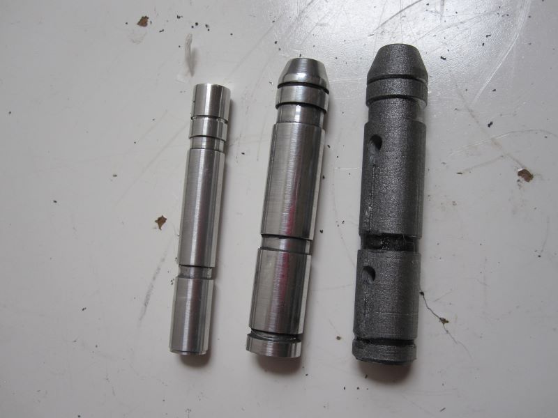

Here is one of the cylinders i remade....couple times. The right is the original resin, center is the first one i made to replace it but after relooking at the reference i realized its not even close, the one on the left is what its actually supposed to look like. Pretty much the same as the fronts but shorter. I remade the front to use the original resin ends but i will be remaking them since the detail spacings are a bit off.

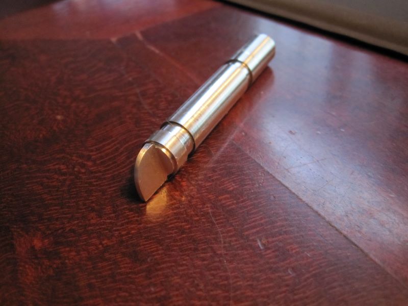

Here it is with the blade cut into the end..wish i had a mill to do this but i had to make due with a file..lol

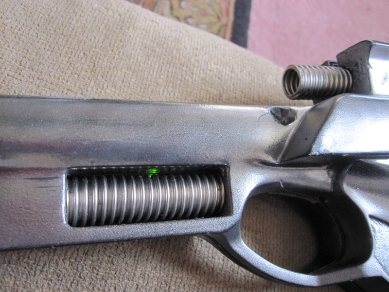

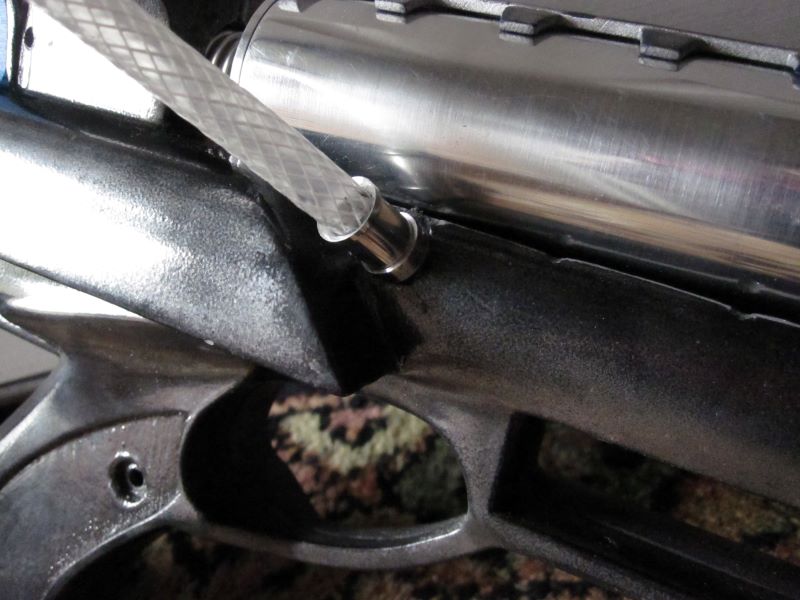

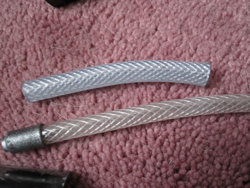

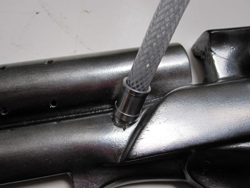

I remade these hose holding doodads but the hose is too big, We found the right stuff and its on the way to me now. I also made one of the side tanks but i messed up trying to figure it out so all these parts will be remade.....

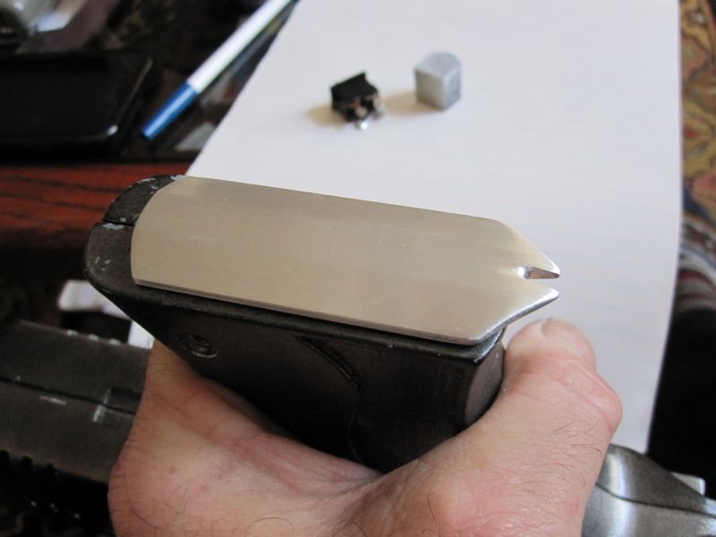

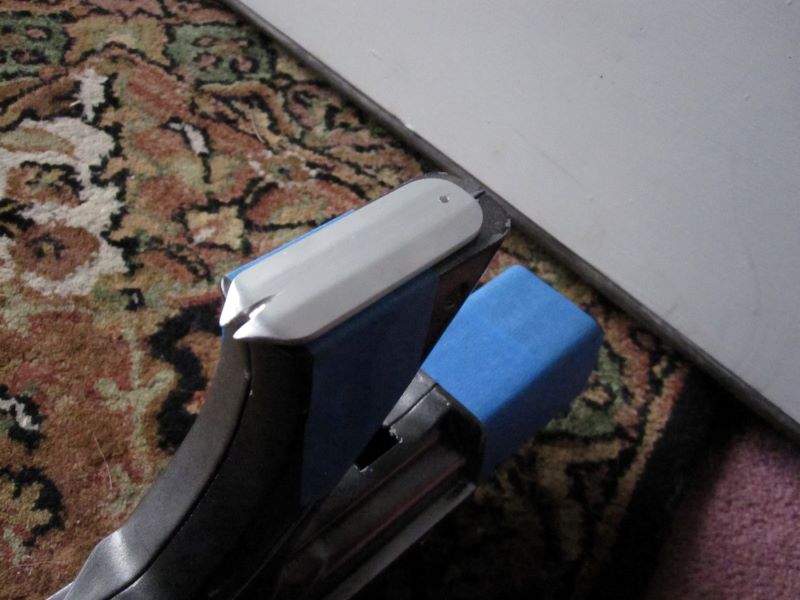

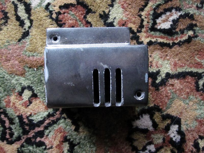

Found a better lower switch that was completly black and remade the magazine base plate because the original was way off. First go at it was too big and not shaped right.
Here it is trimmed down and a few areas corrected.

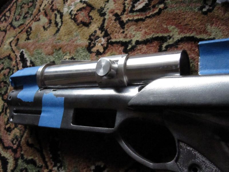

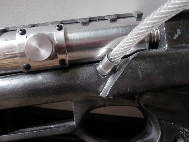

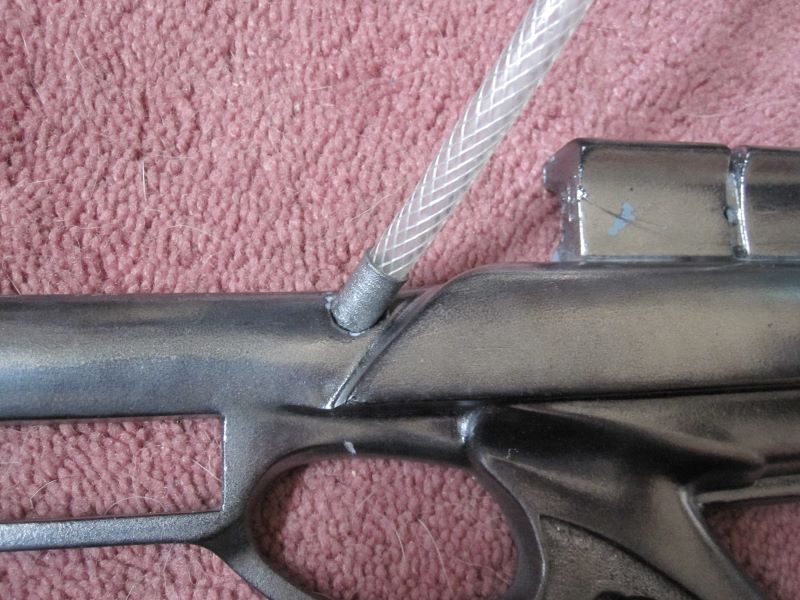

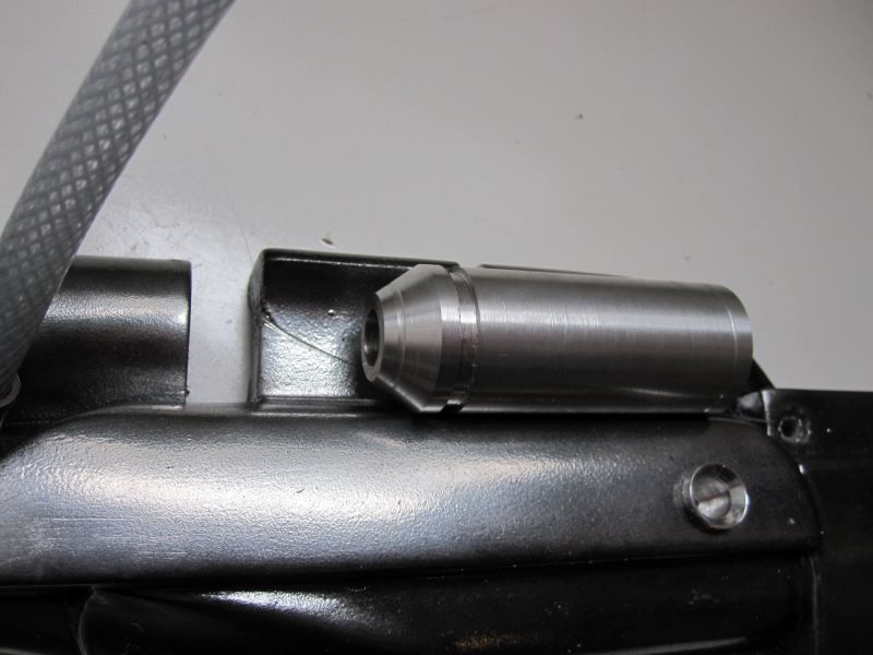

Here is the tube fitted, only a couple tiny spots to fill due to an over jealous file operator......also need to fill in those slot below the top tube,they were supposed to hold the front little cylinders but they dont even come close to them....besides they are supposed to be held on by screws which is how the prop was and how these will be.
And by some miraculous luck, with the top saw tooth part in the center of the tube and the tube fitted the knob base plate fit perfectly in between !!

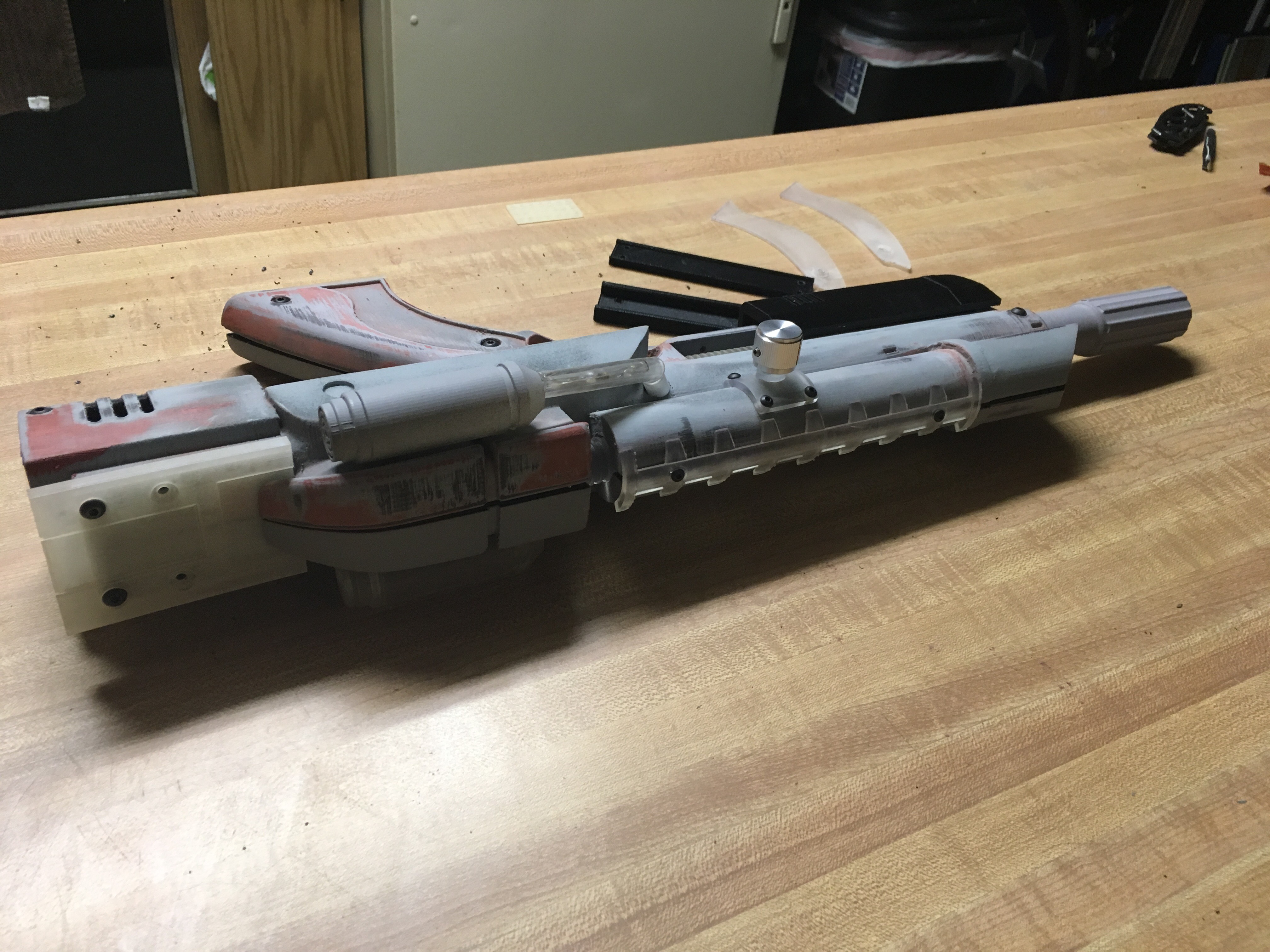

Thats where it sits. More aluminum and hose is coming. I still need to remake the trigger in aluminum, attempt to make the barrel, remake the front cylinders and big tanks, an end cap for the top tube, and Pat went all out and ordered some corregated hose to replace that stuff as well. Should be a decent little prop when done......as long as i can figure out the finish.....

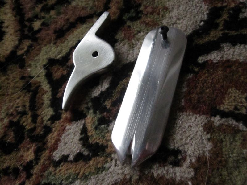

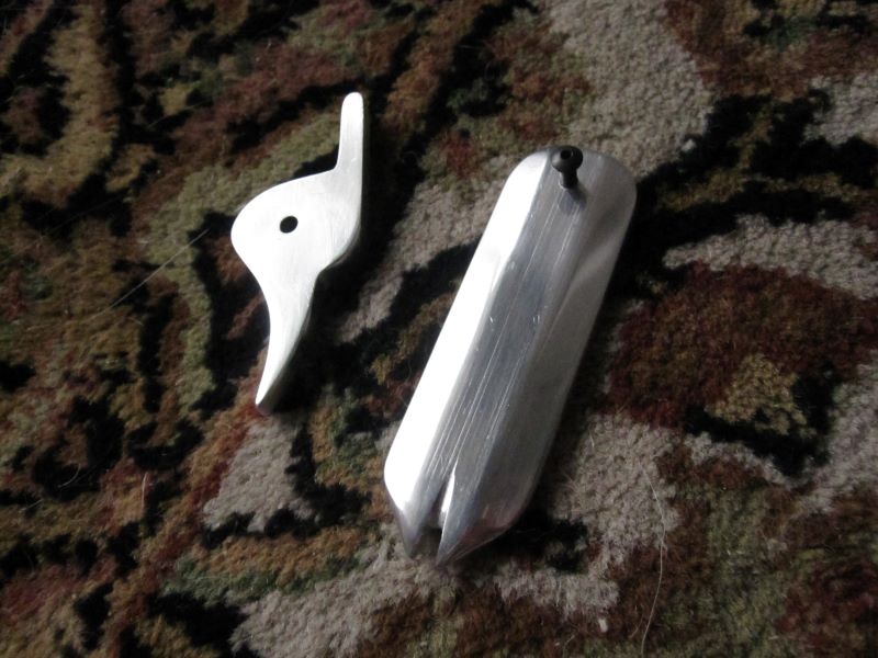

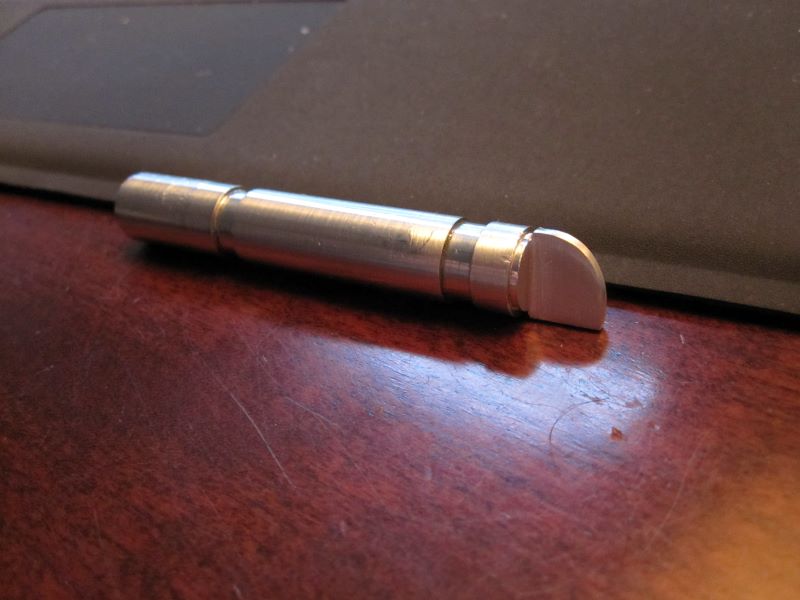

Trigger done in aluminum, also got the correct hose in today. Will be remaking the new recepticles this weekend....

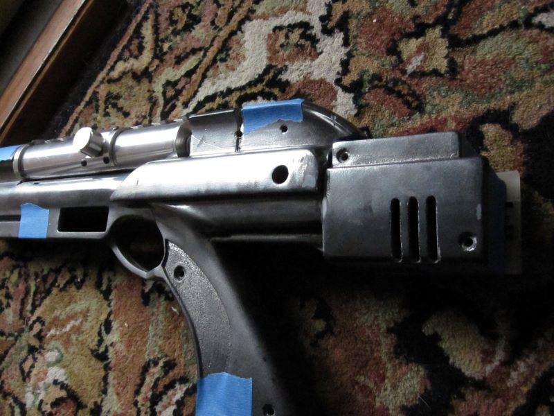

A little more done this weekend.

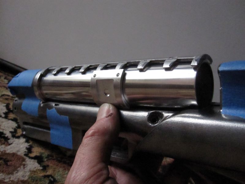

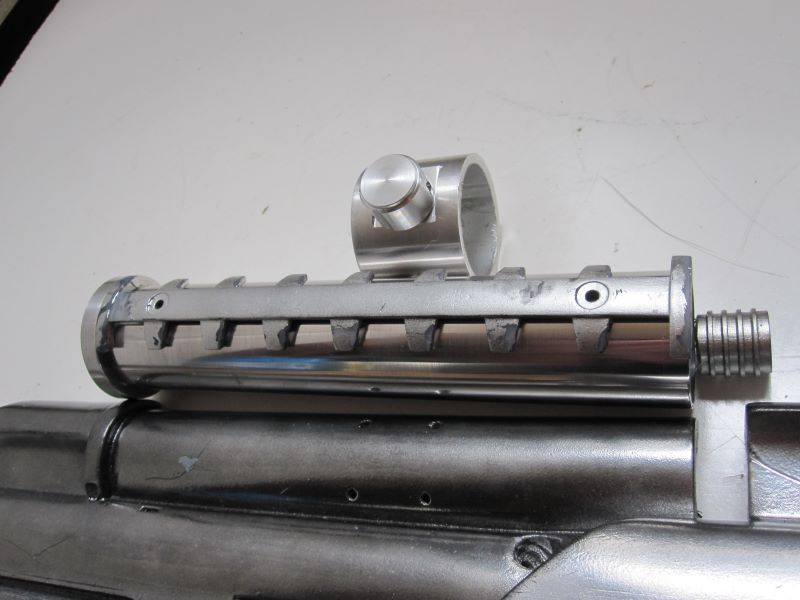

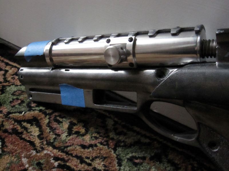

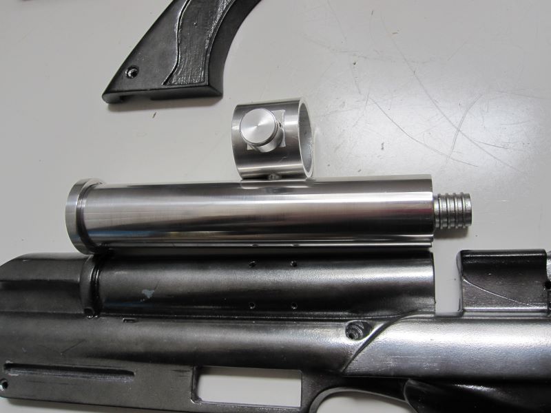

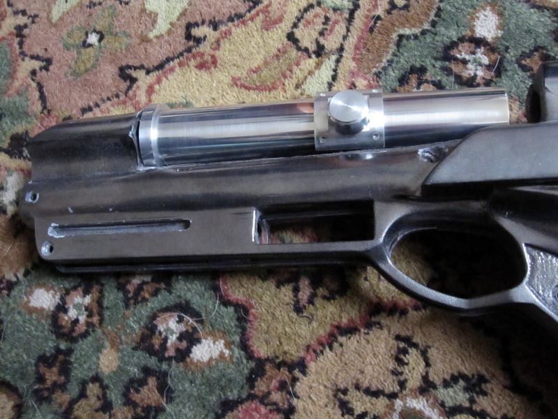

Top tube is done. Although it will all come apart towards the end for a re polish. I used a potentiometer on the knob for a smooth knob turning experience...lol

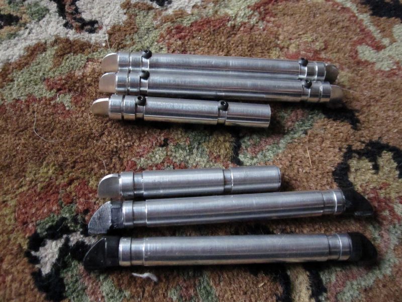

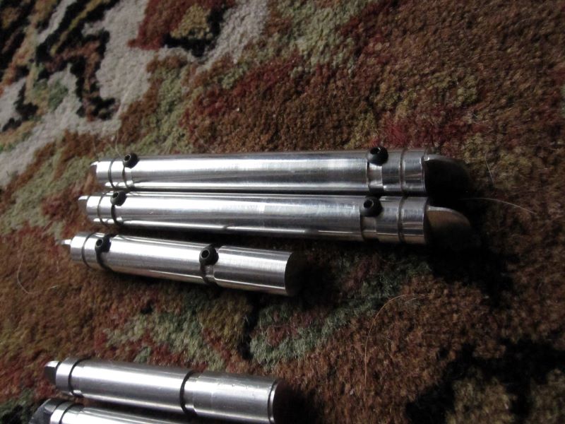

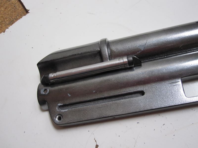

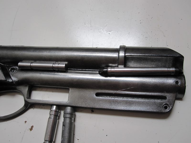

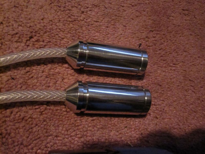

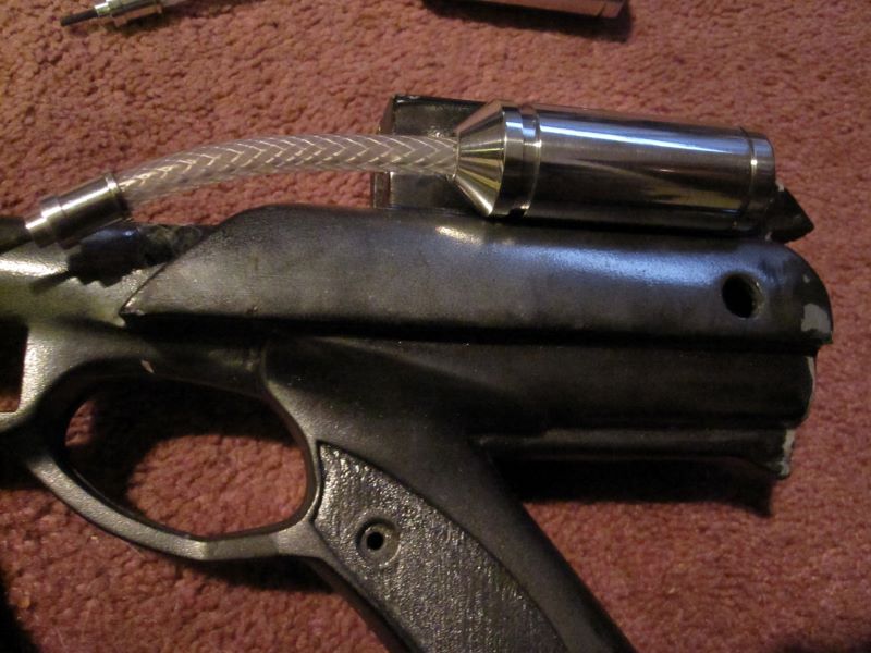

New small tube holders are done and shells opened up to fit them. A little filling needs to be done..
New small tubes compared to first try. Not 100% happy with the ends so i will try to do something else for the little blades.

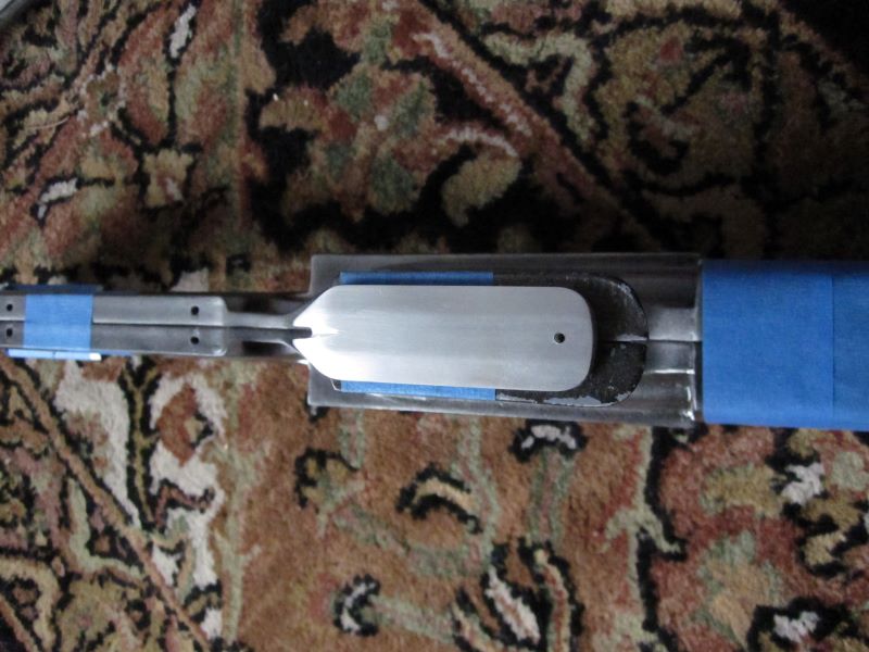

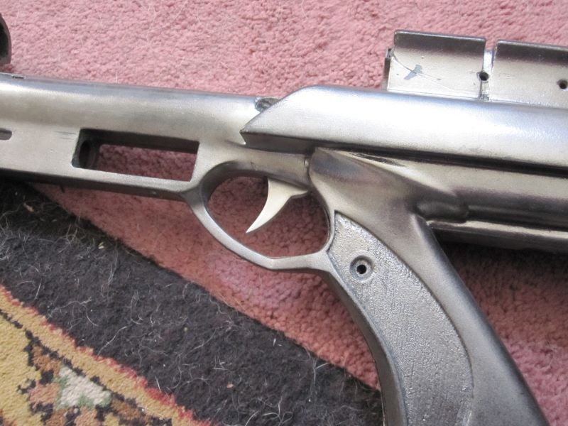

Polished up the magazine base and trigger which exposed some fine marks so they will get cleaned up at the end when i re polish everything. I put the top lever on the trigger so if Rusty decides to add some electronics later the lever can activate a microswitch.

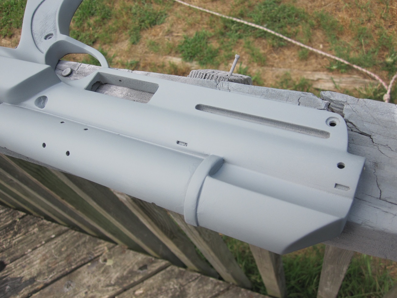

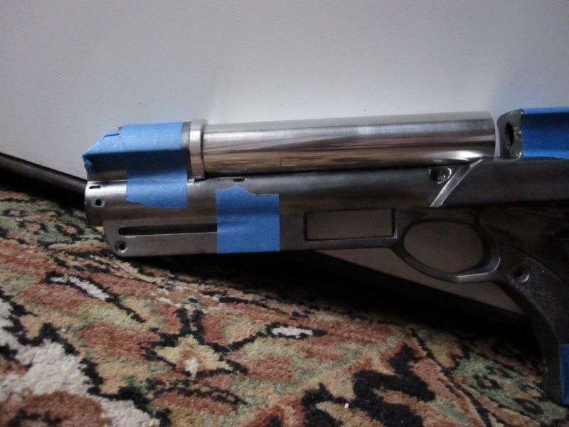

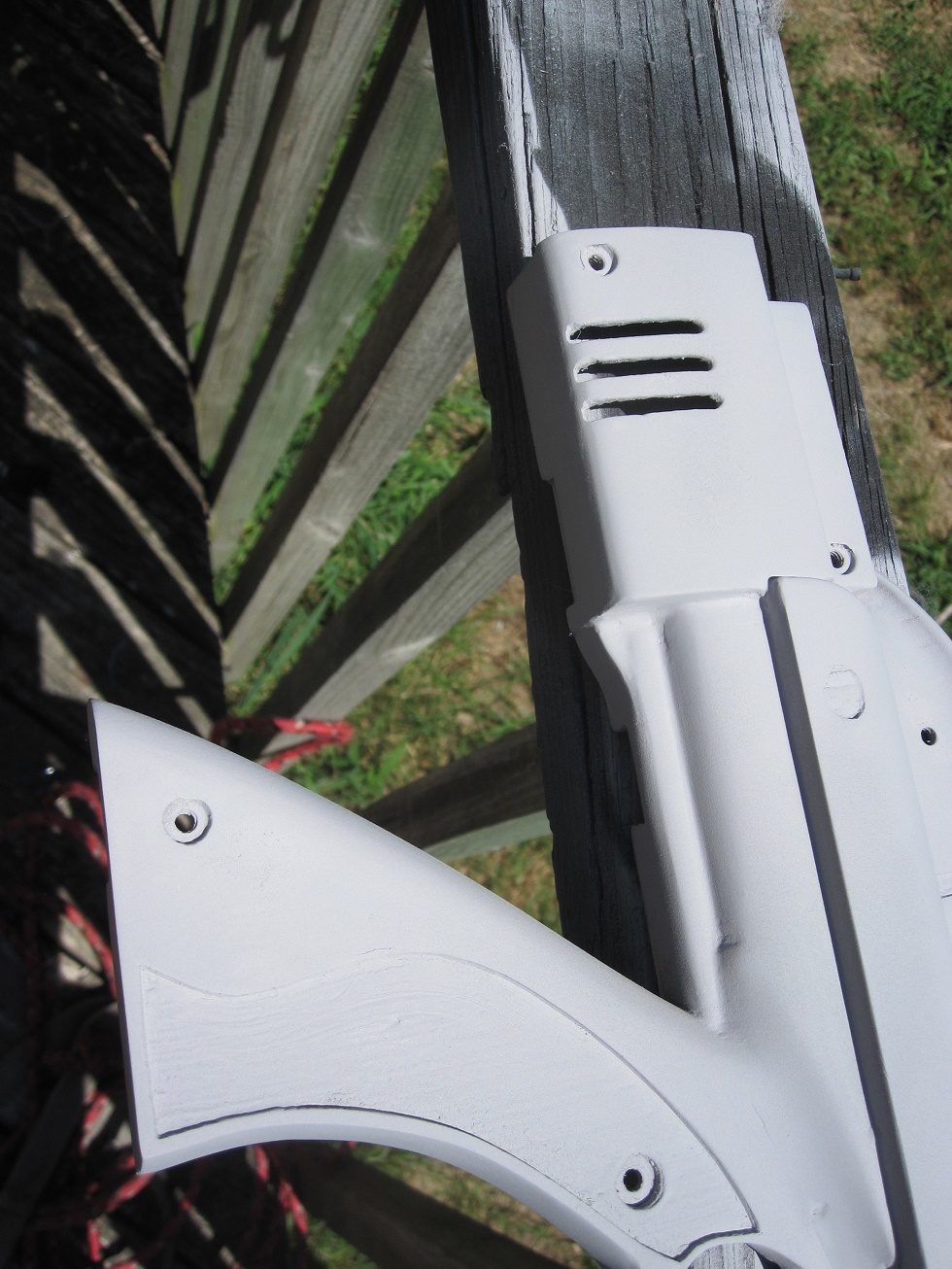

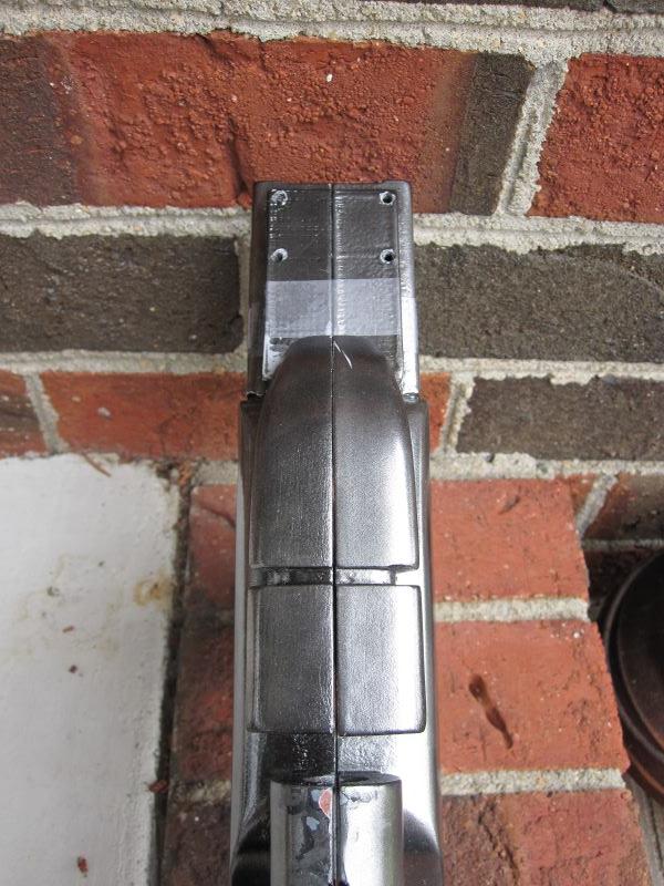

I ended up cutting off the rear section. It was designed too high so it just didnt look right. It also prevents the proper 1/4" thick shelf that goes on top of it from fitting and got in the way of the back of the big tanks that go on the side. Also had to increase the slot size as they were too small.

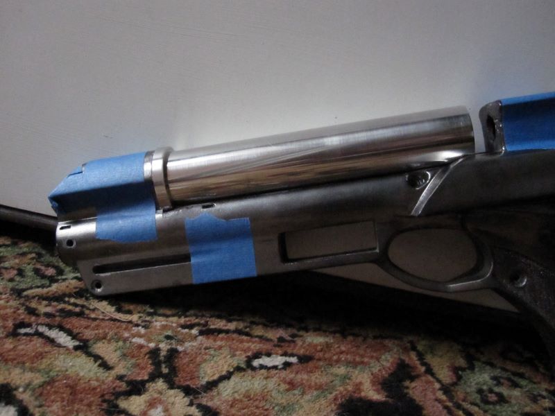

Next project is the barrel assembly, the one that came with it is way too small and shaped completely wrong and it really needs to be aluminum at this point. Also need to make the big tanks. Just a couple more parts and this puppy will be ready to get some sort of finish , unfortunately the last few parts are going to be a PITA...lol

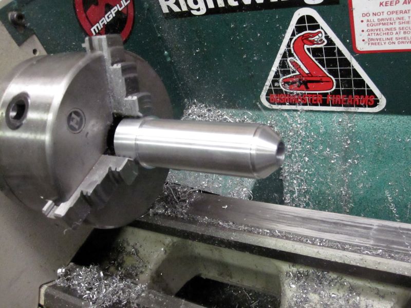

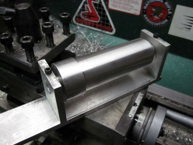

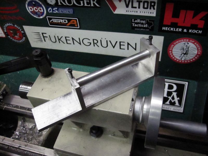

I redid the side tanks. They came out right this time. Also started the barrel and made the jig to machine the grooves. Still have a few things to do to make that happen like drill some set screws to hold it in place while grooving it and making a piece to hold the jig to my Unimat.
