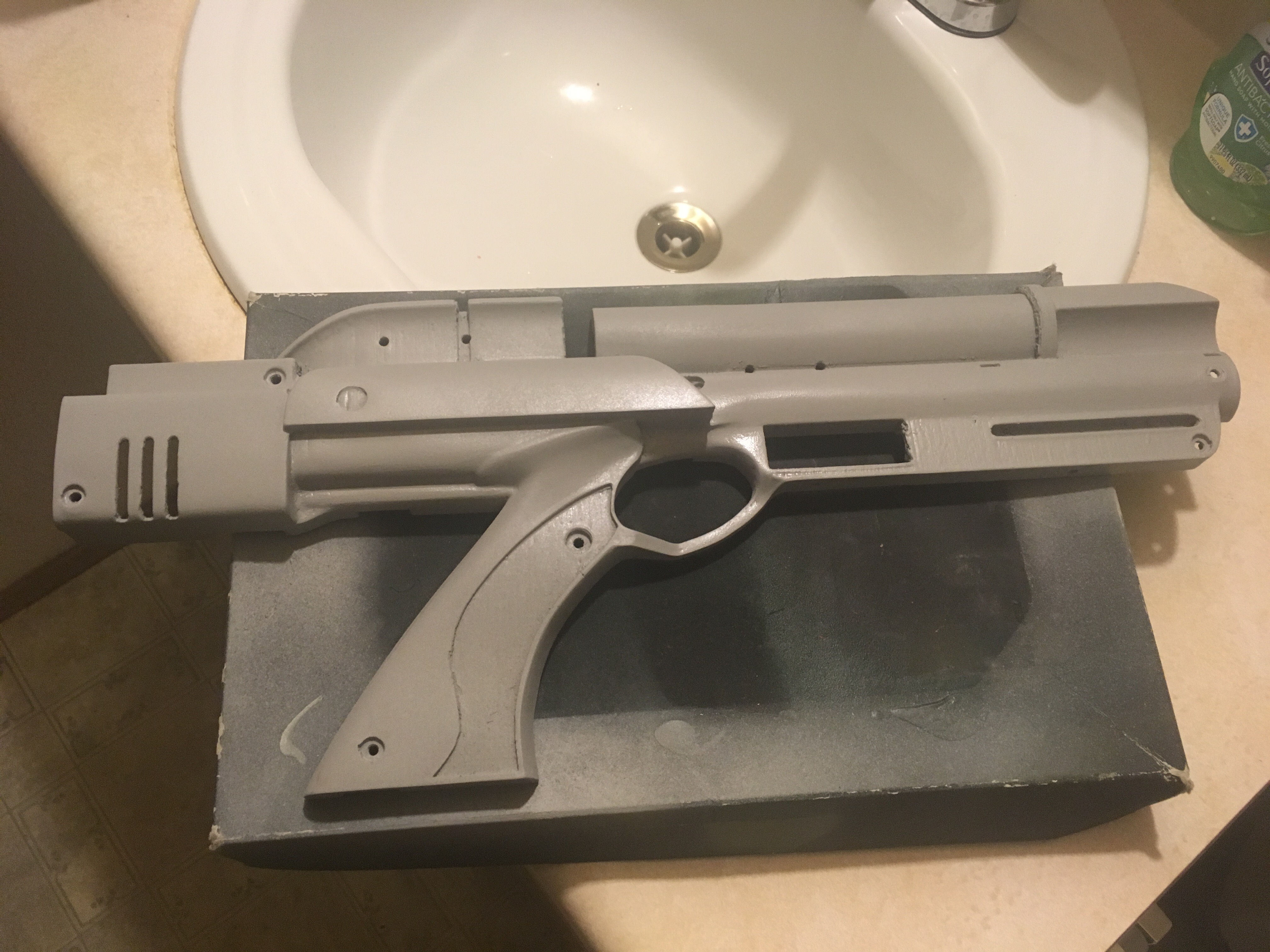

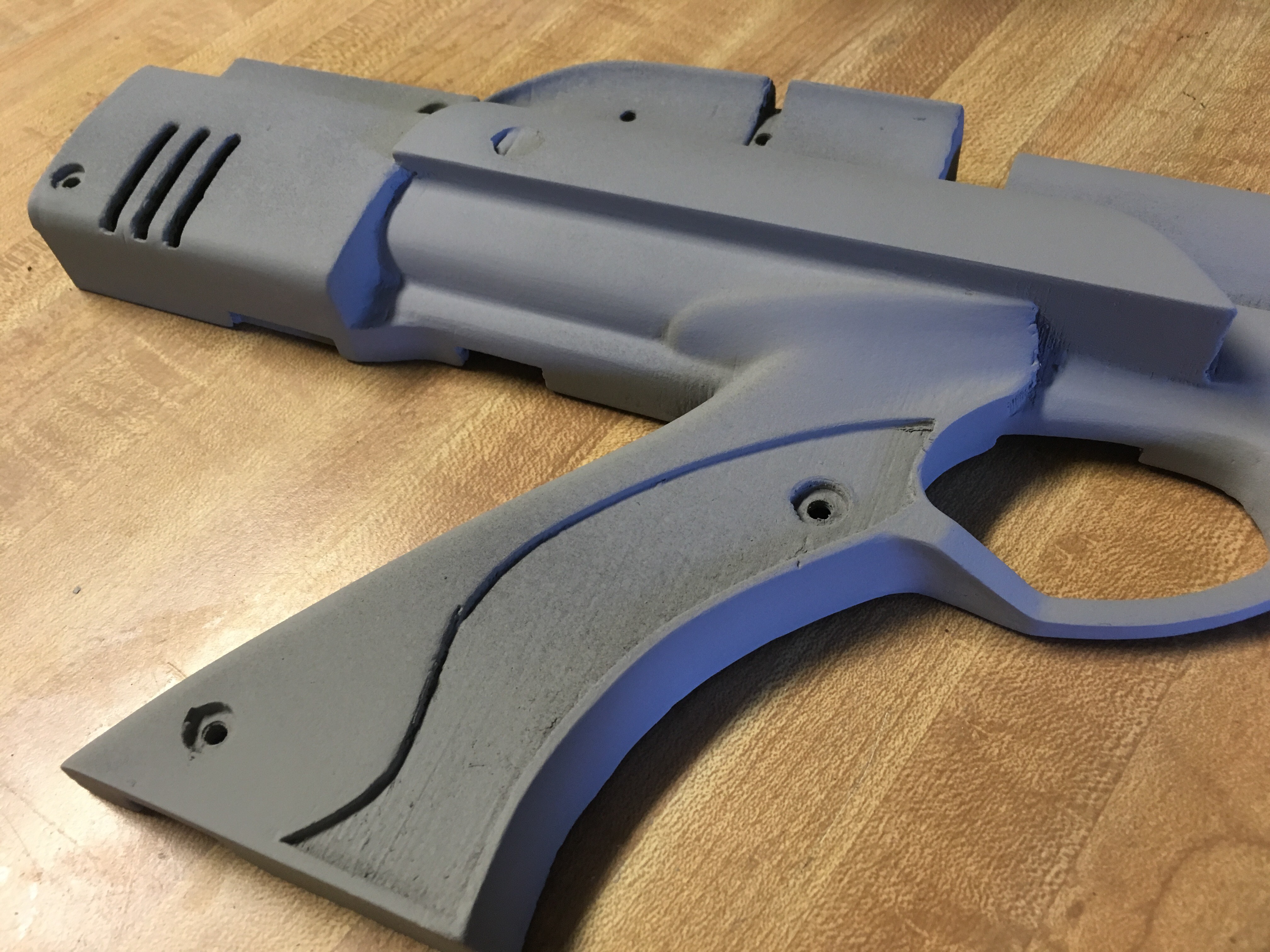

I've slowly been sanding the body on the gun, it's coming along nicely! I've been working on the right side so far but this pic is the left in case anyone is wondering. Here's an additional picture for anyone watching this thread :)
Re: Men in Black- Series 4 Deatomizer Update 4/21/17

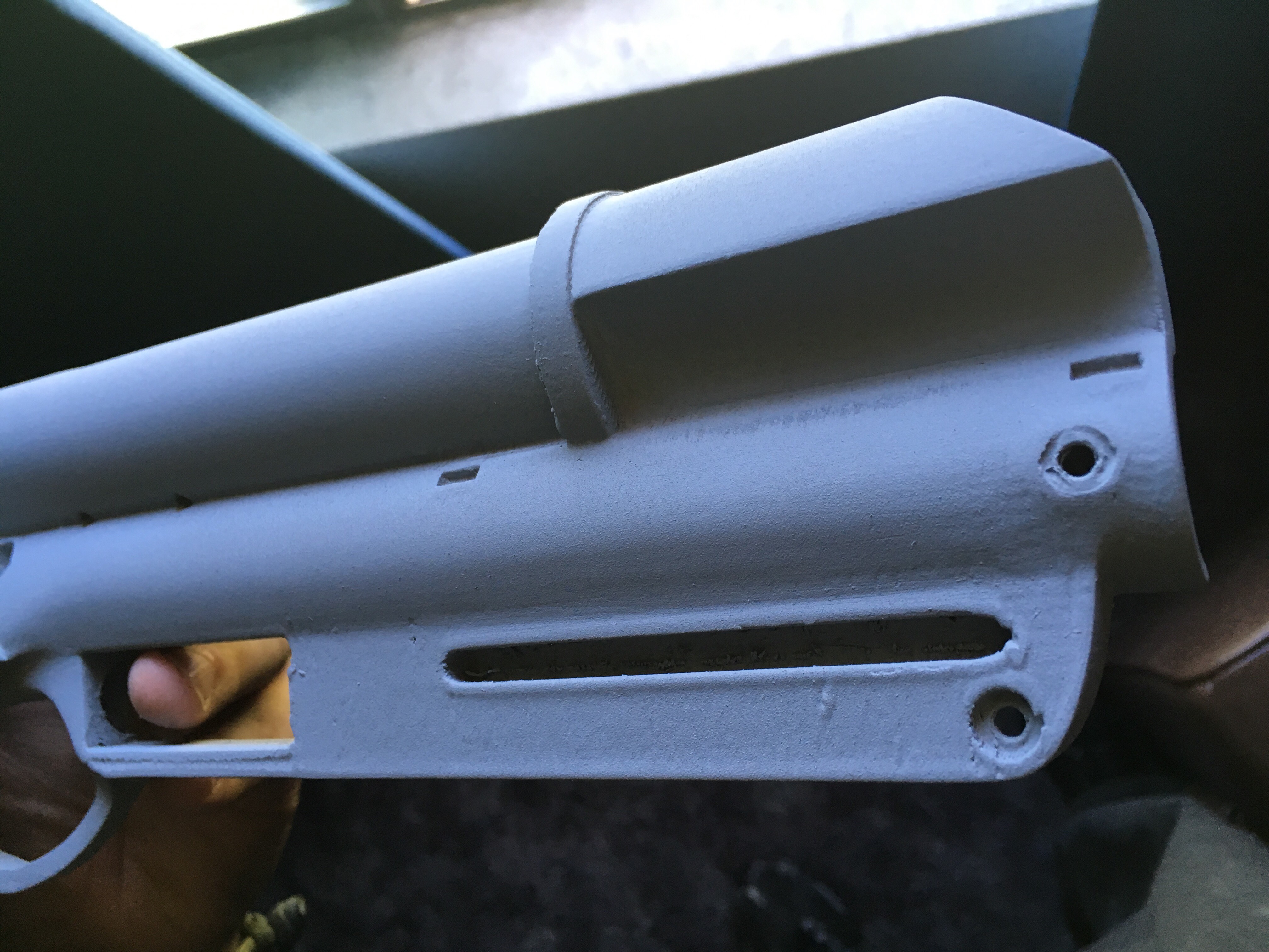

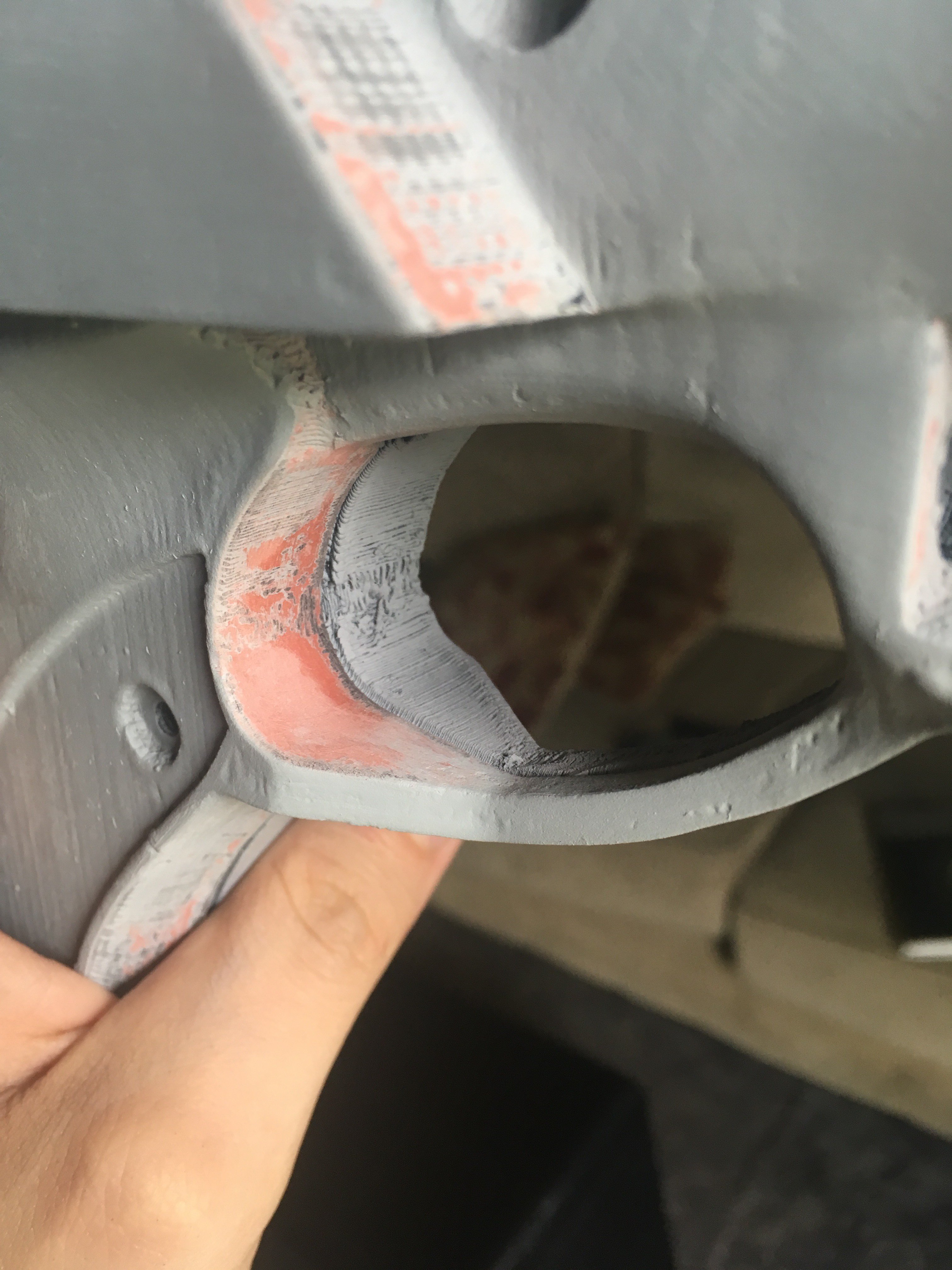

Just did a little more sanding and filling today. You can really see the difference when you put it next to the other half that I've yet to start.
The trigger area especially needed a lot of work, I've filled it and sanded it at least 3 separate times now and it still needs more. It looked similar to the other half when I started.

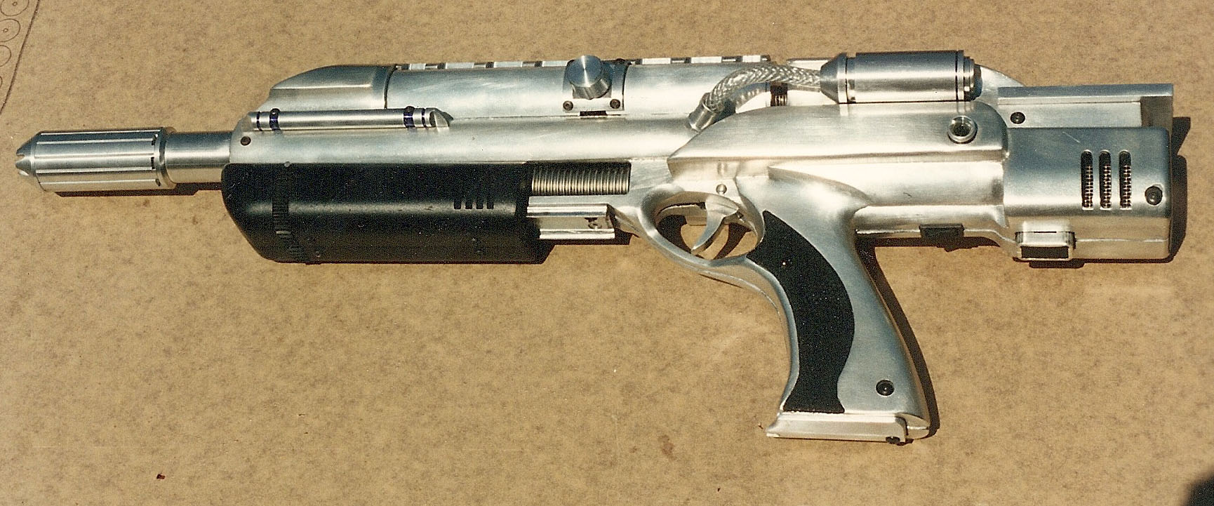

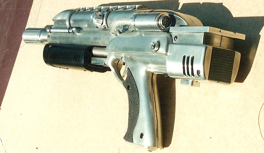

me and guns.jpg You guys are doing a great job. I do miss that gun. It was my favorite too. Series 4 deatomizer 2.jpgSeries 4 deatomizer.jpg Hope these help you out in designing it. Lots of talent out here in the RPF. I haven't been active here in quite a bit. Been quite busy still making props.
You guys are doing a great job. I do miss that gun. It was my favorite too. Hope these help you out in designing it. Lots of talent out here in the RPF. I haven't been active here in quite a bit. Been quite busy still making props.
Thanks Rick, that mean's a lot! Anything interesting you can tell us about this gun?

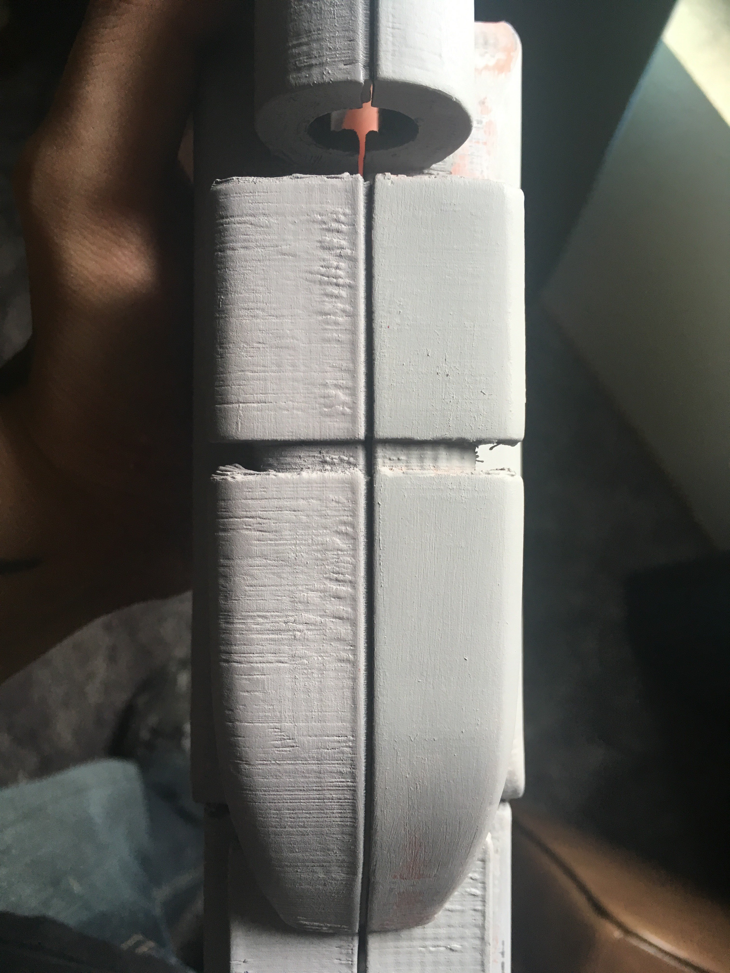

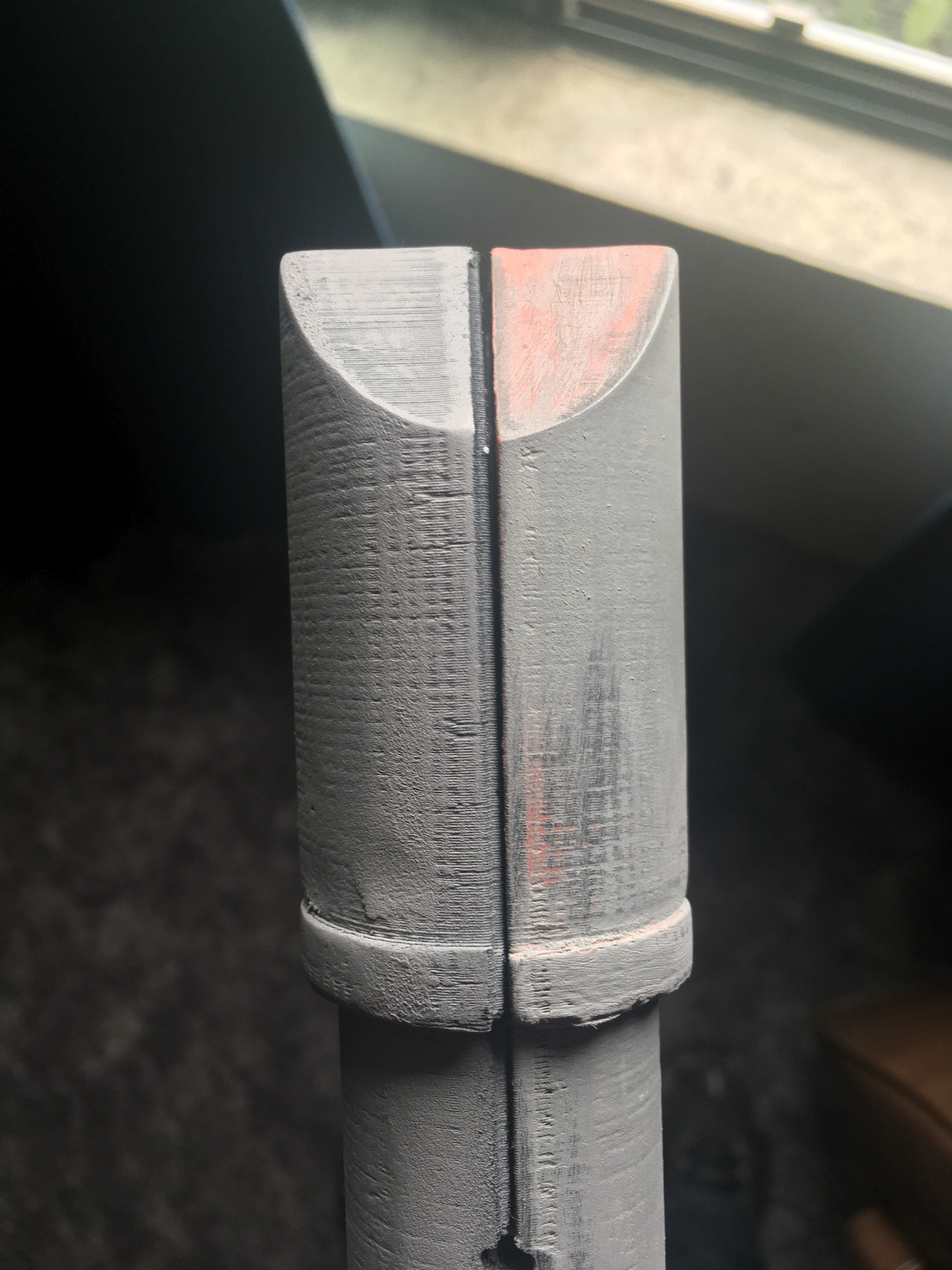

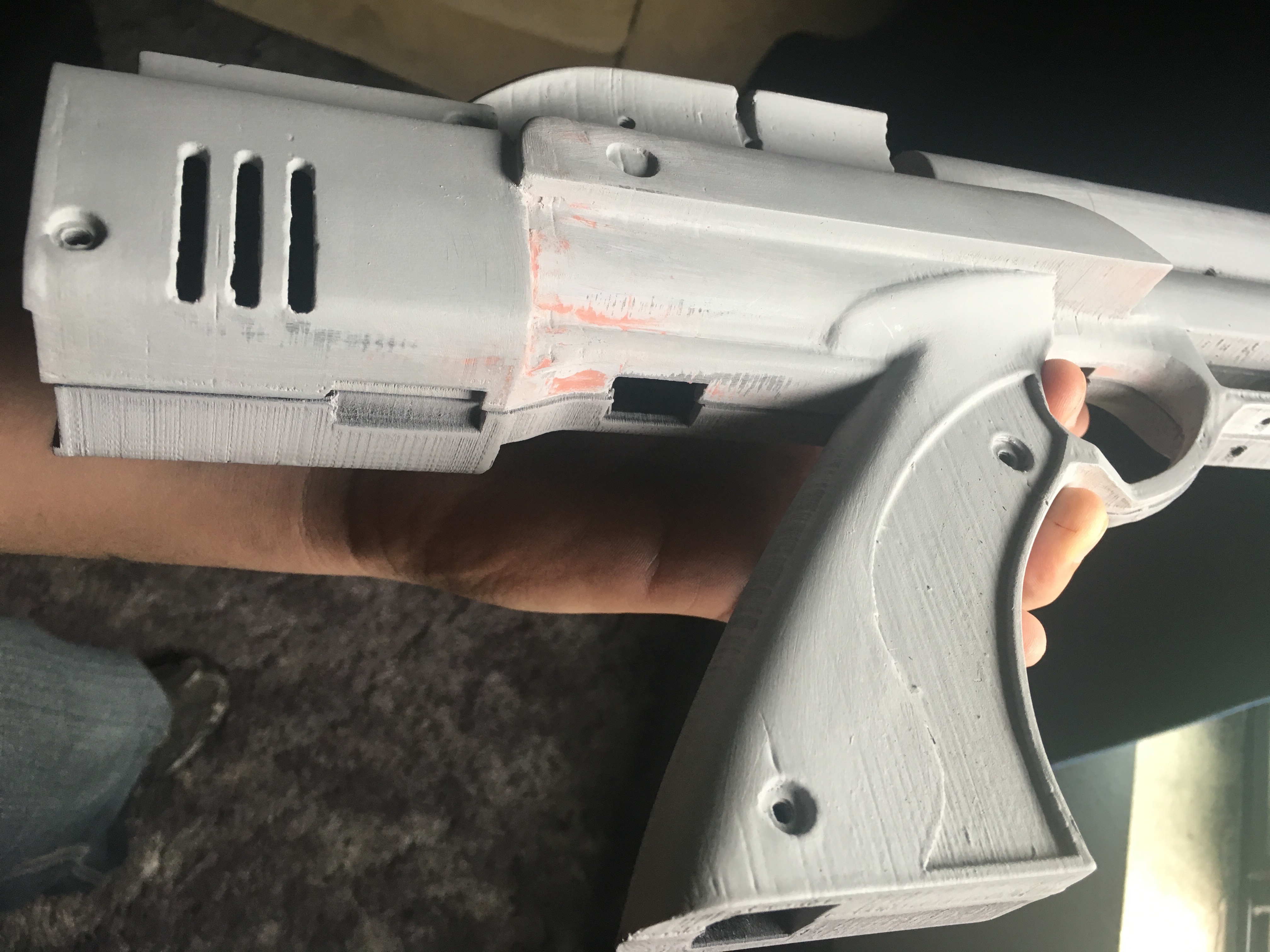

Did more sanding on the right half, almost have it finished! Had to bondo a few of the flat spots that were a mess but those are looking a lot better. I found the company that did the chrome for the guns for the 3rd movie too which is exciting, I've been talking to them about getting this finished once it's molded.
Glad you're persevering with this. Keep in mind that you will need a glass-smooth surface if you want the chrome/metallic to look good. Every single little scratch, bump or imperfection will stand out like crazy once you have a reflective surface there.

Thanks guys! Yeah I'm working my way toward the smooth as glass look. There's a lot of little nooks and crannies there that are difficult to get to. The one closest to the trigger area is the only one left that I haven't done much to. The others I've been gradually filling and sanding. I believe the trigger guard was the worst part on the gun when I started but that area looks great now!
