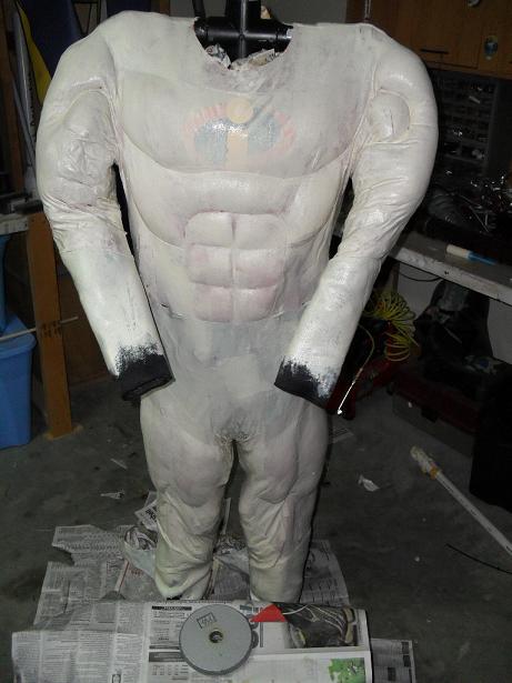

Got it done...time for the hard part...paint :)
I gotta say man, that layering looks pretty thin. You might need some more. I used the entire gallon and then some, and I was still finding places during paint where the red was showing through.

FYI- I'm on my second coat of latex to the suit. I tinted it with Khaki colored latex paint. I used a ratio of about 3:1 (3 parts liquid latex to 1 part latex paint). It is coming out great. The first layer scared me since I almost used half the gallon of liquid latex. This second layer just about used a pint--phew. I'm going to do one more layer then add the veins and rough parts to the shoulders and back, then sew a cleft in the middle of the chest to get the "pecs" look. Then add another 1 to 2 more layers. Also need to cut out a pee hole-LOL. After that--it's on to airbrushing. Enjoy.
Naa it's really thick, about 4 coats..used a gallon. It will paint fine with a layer of primer. Painting it only becomes a problem when the latex doesn't make a thick skin to paint onto. I'm gonna use latex paints as well so less cracking
