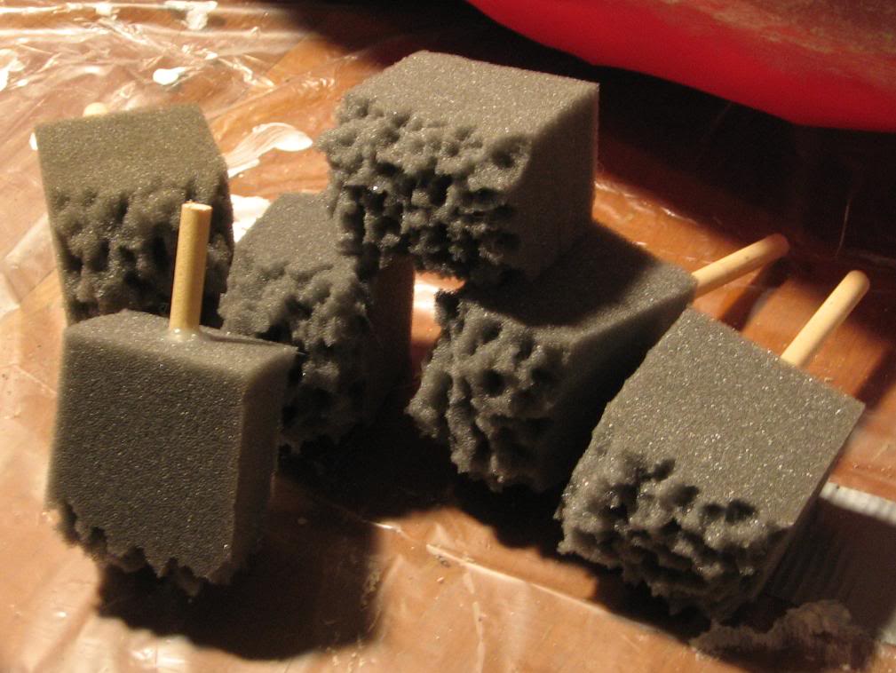

Although, I quickly learned these types of homemade sponges I'd made w/ pieces of foam cut into blocks (used for winterizing a/c units, found at any hardware store), textured by ripping out small bits w/ a pair of pliers & then hot glued pieces of a wooden dowel as a handle worked out BEST for stippling on the latex. Cheap & easy, since each sponge is only good for maybe 1 hour of use & then has to be tossed into the trash.

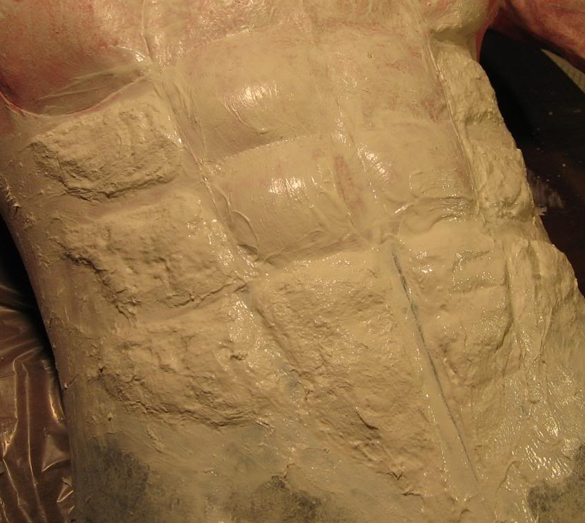

My suit after first layer of latex.

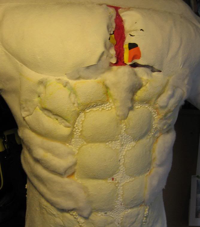

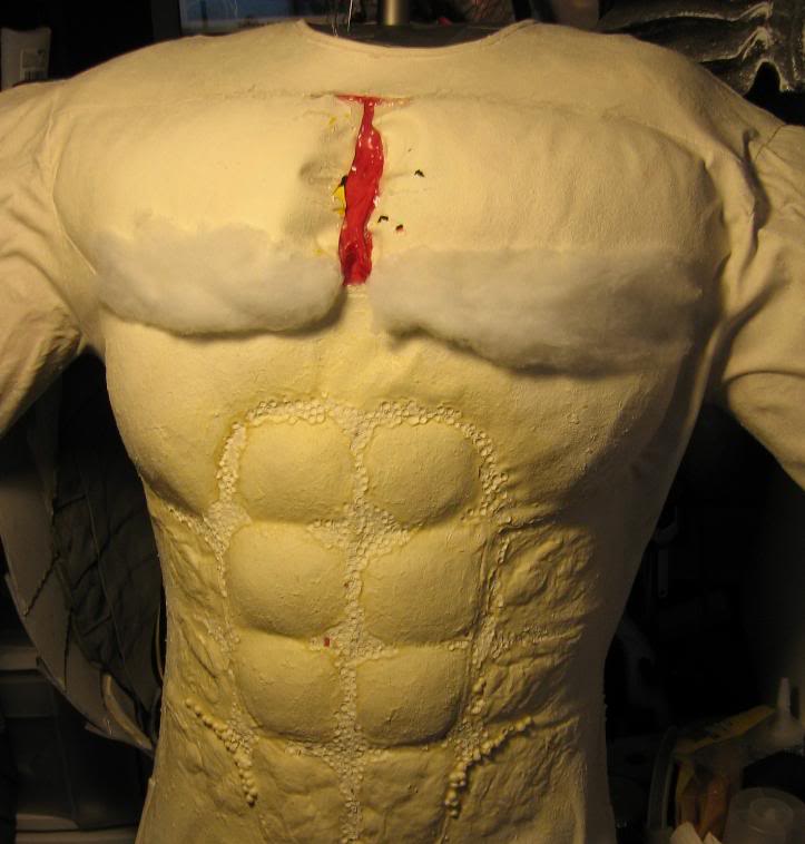

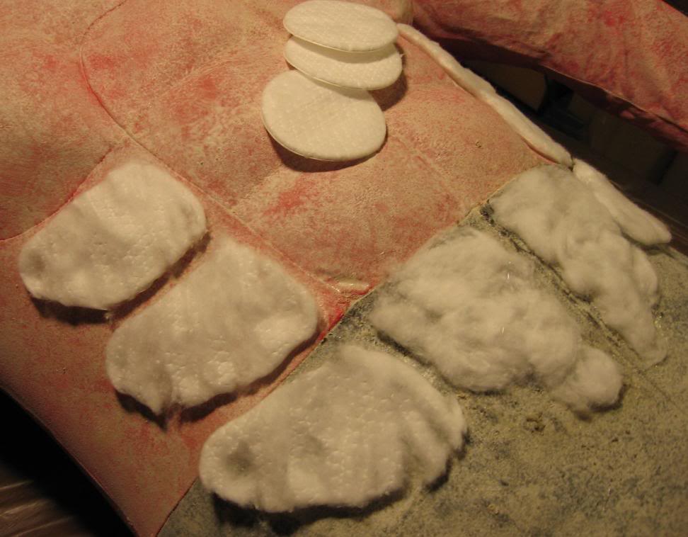

I used cotton pads to create better Predator-like abs. I found cotton pads were easier to work w/ than cotton balls.
I'd added in some polystyrene beads to create a better look, but then later on it just didn't look right to me. So, I removed most of them w/ a razor blade & it left a bunch of small, cool looking recessed/dented in bubble-shapes that was unlike anything I'd seen before, but in a very VERY COOL WAY! *Check out what I mean by scrolling down a few pics!*
I also added some craft store pom-poms & more polystyrene beads to the back area and to the area around the leg muscles.
I spent a lot of time just staring at it, which helped me realize that I needed to get it as far away from the original look of the Mr. I suit as I possibly could. So, I then decided to make even further changes on the chest & abs to enhance more Pred-like features. I achieved this by adding pieces of cotton batting I'd cut into specific shapes & continued adding a few more thin layers of latex onto the entire suit.

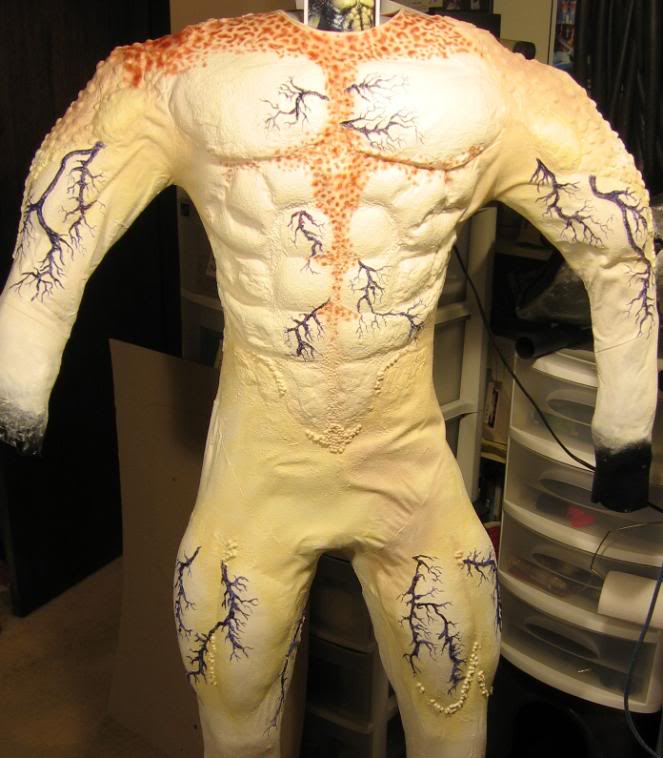

I then added pieces of yarn & small lengths of thin rope to create the appearance of bulging 3-D veins.
I painted the veins w/ a deep bluish purple before adding the final layers of latex which gave them a neat "under the skin" look. Although, after I'd been experimenting a bit, learning what I could do w/ my airbrush on a 3-D surface, I later white washed the entire suit & began a whole new paint scheme.

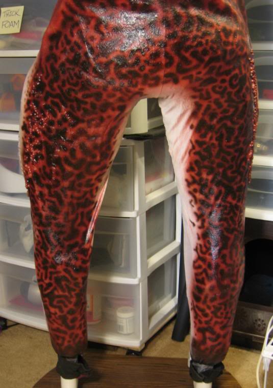

All of those many steps above, inevitably led me to what you see here below...MY FIRST FULL LATEX PREDATOR SKIN!!!
