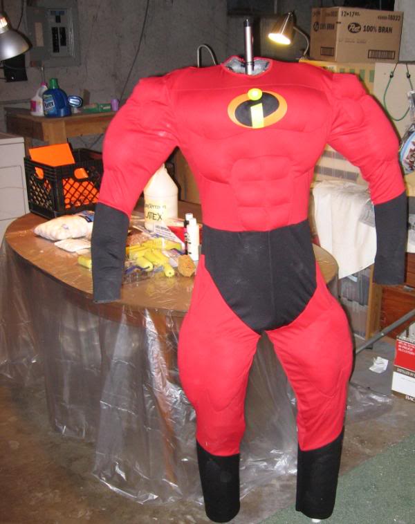

ZIPPER - I HIGHLY recommend replacing the zipper on the back of the Mr Incredible suit with a better zipper made out of much stronger material than the cheap plastic type which comes already installed on it!!! I'd forgotten to do this on mine & when the time came to get suited up, the damn zipper broke immediately! I used safety pins to hold it together, but that made it a real pain in the ass to get on & off.
DUCT TAPE DUMMY - The duct tape dummy I'd made was made in two separate parts, the upper torso & the lower legs. I also made an internal "skeletal" structure for it using pvc pipes & pvc pipe connector pieces. Doing it this way, I was able to glue certain joints together so they'd stay there permanently, such as the knees, hips & inner shoulder joints, while other parts were left unglued, such as the waist & arm pieces. Therefore, it allowed me the ability to pull certain areas apart once I needed to remove the Mr I suit from the dummy. It still wasn't exactly "easy" by any means to separate the latex suit from the dummy, but these features did help out a great deal. As I recall, it took both, myself & one of my good friends about two hours to fully remove the latex suit from the dummy w/o causing damage to the finished suit. Although, much of that time was spent cracking jokes & laughing hysterically throughout the suit-dummy separation & removal process!
Mr. I suit on Duct Tape Dummy................CHECK!
Space to work uninterrupted.....................CHECK!
Table (protected w/ plastic cover).............CHECK!
1 gal of Monsterroom Latex..........................CHECK!
Plenty of different materials to experiment.....CHECK!

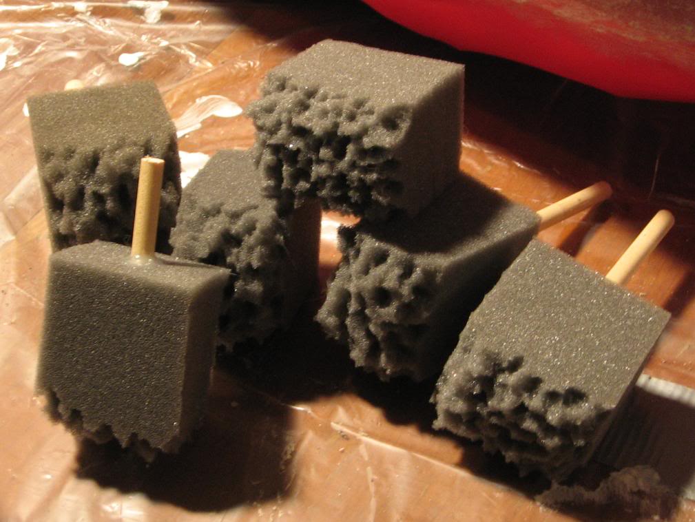

Although, I quickly learned these types of homemade sponges I'd made w/ pieces of foam cut into blocks (used for winterizing a/c units, found at any hardware store), textured by ripping out small bits w/ a pair of pliers & then hot glued pieces of a wooden dowel as a handle worked out BEST for stippling on the latex. Cheap & easy, since each sponge is only good for maybe 1 hour of use & then has to be tossed into the trash.

Cut some custom sponges from some 2" upholstery foam. Make the sponges about 2" x 3" so that you can cover the suit faster.

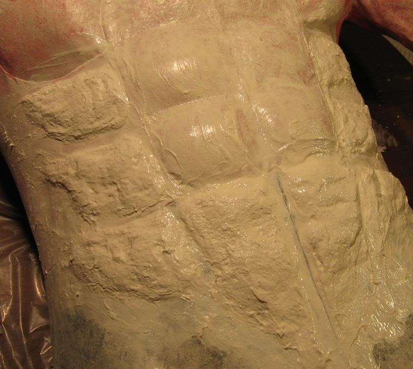

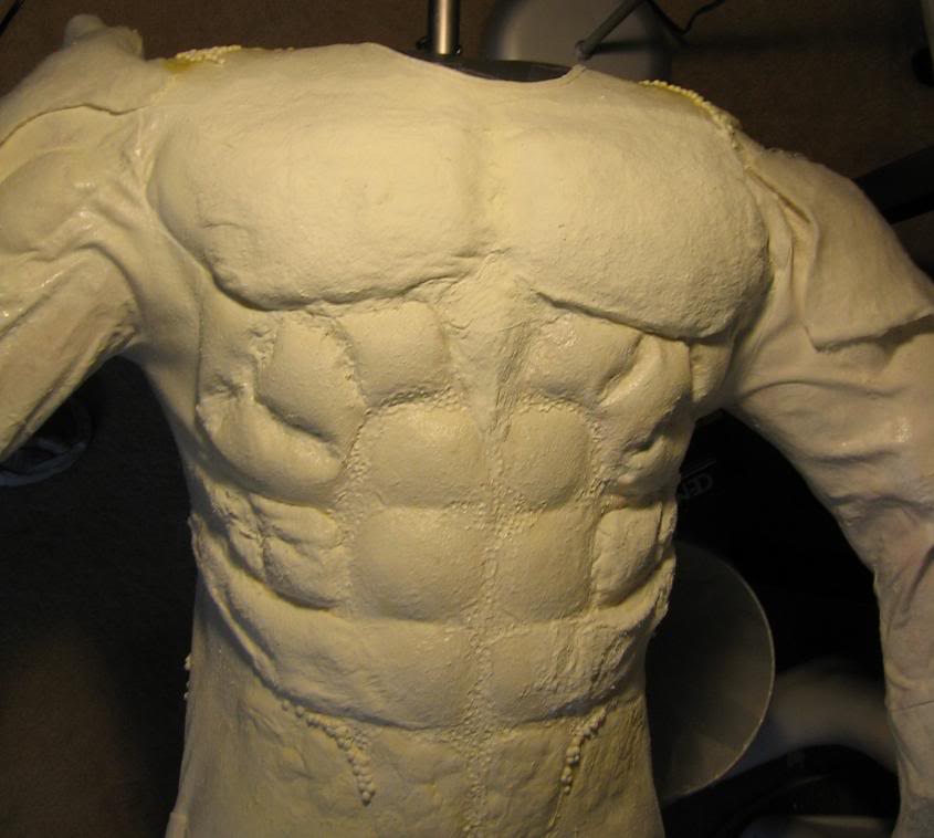

My suit after first layer of latex.

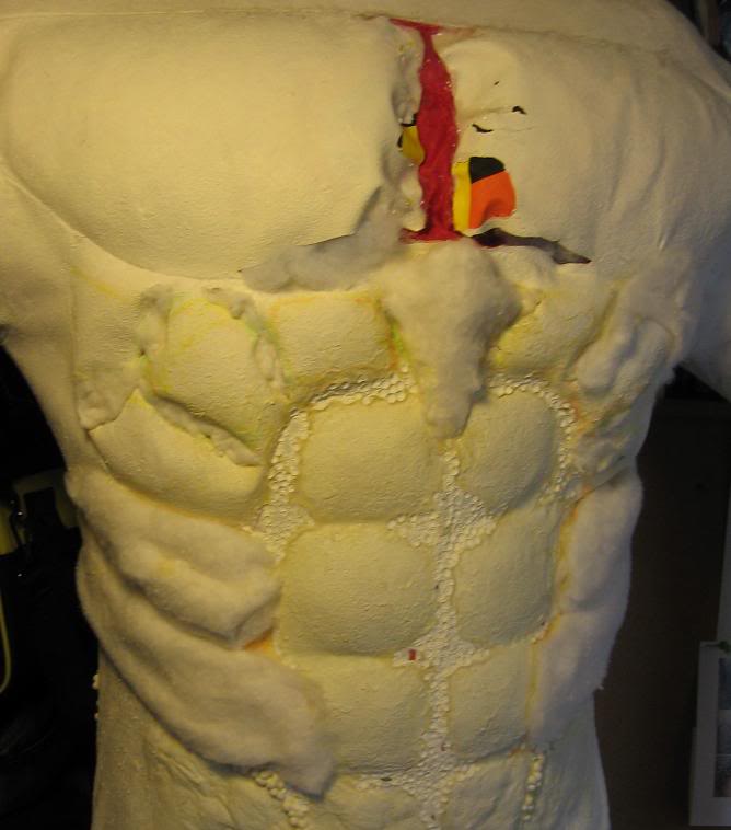

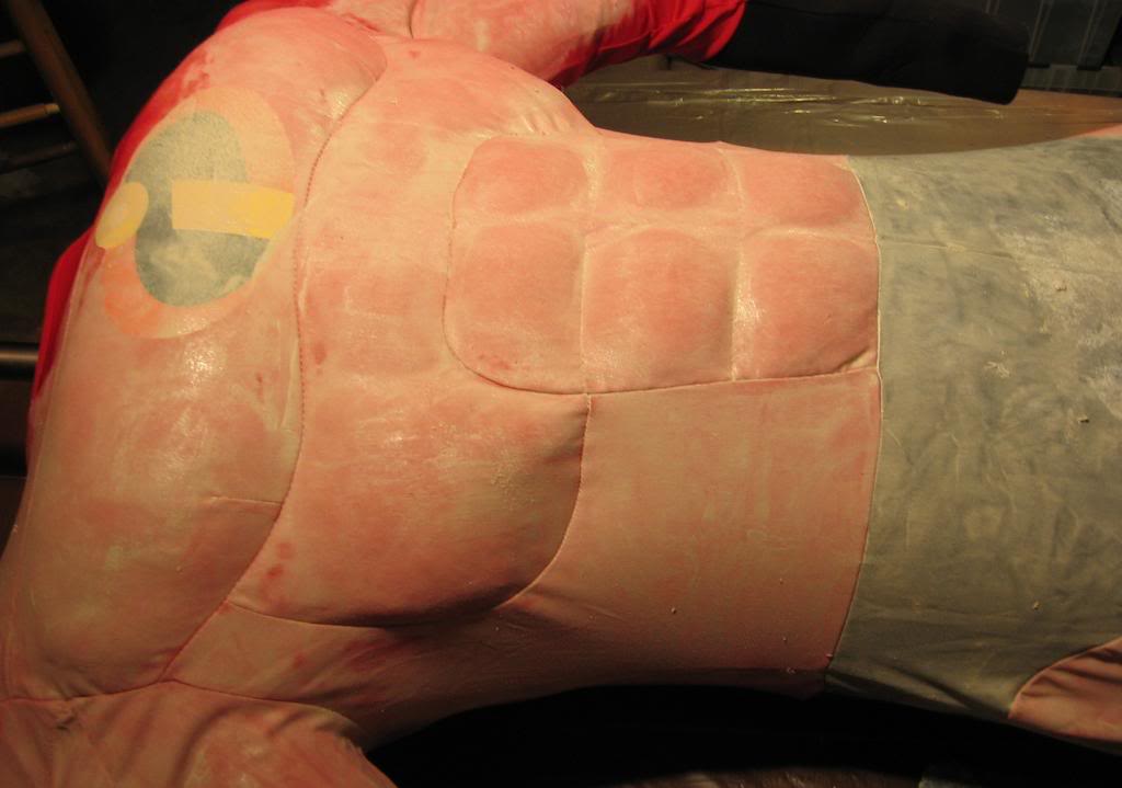

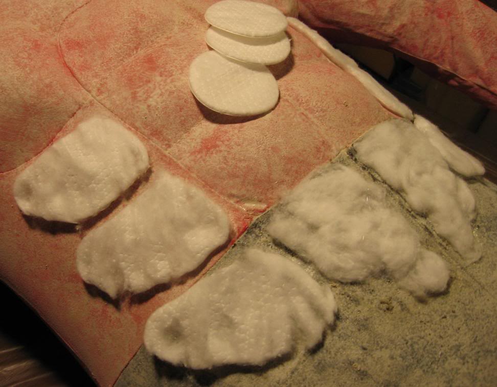

I used cotton pads to create better Predator-like abs. I found cotton pads were easier to work w/ than cotton balls.

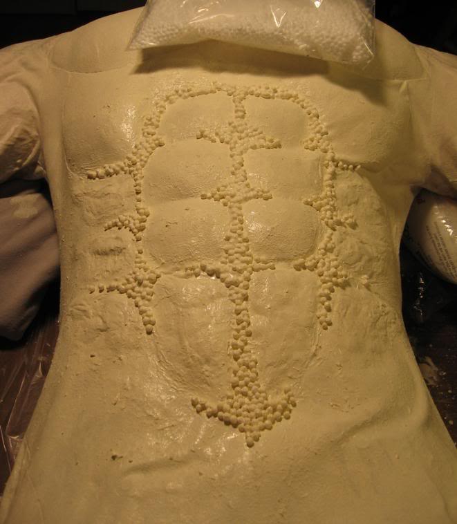

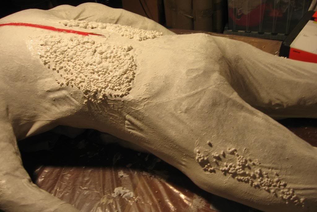

I'd added in some polystyrene beads to create a better look, but then later on it just didn't look right to me. So, I removed most of them w/ a razor blade & it left a bunch of small, cool looking recessed/dented in bubble-shapes that was unlike anything I'd seen before, but in a very VERY COOL WAY! *Check out what I mean by scrolling down a few pics!*
I also added some craft store pom-poms & more polystyrene beads to the back area and to the area around the leg muscles.

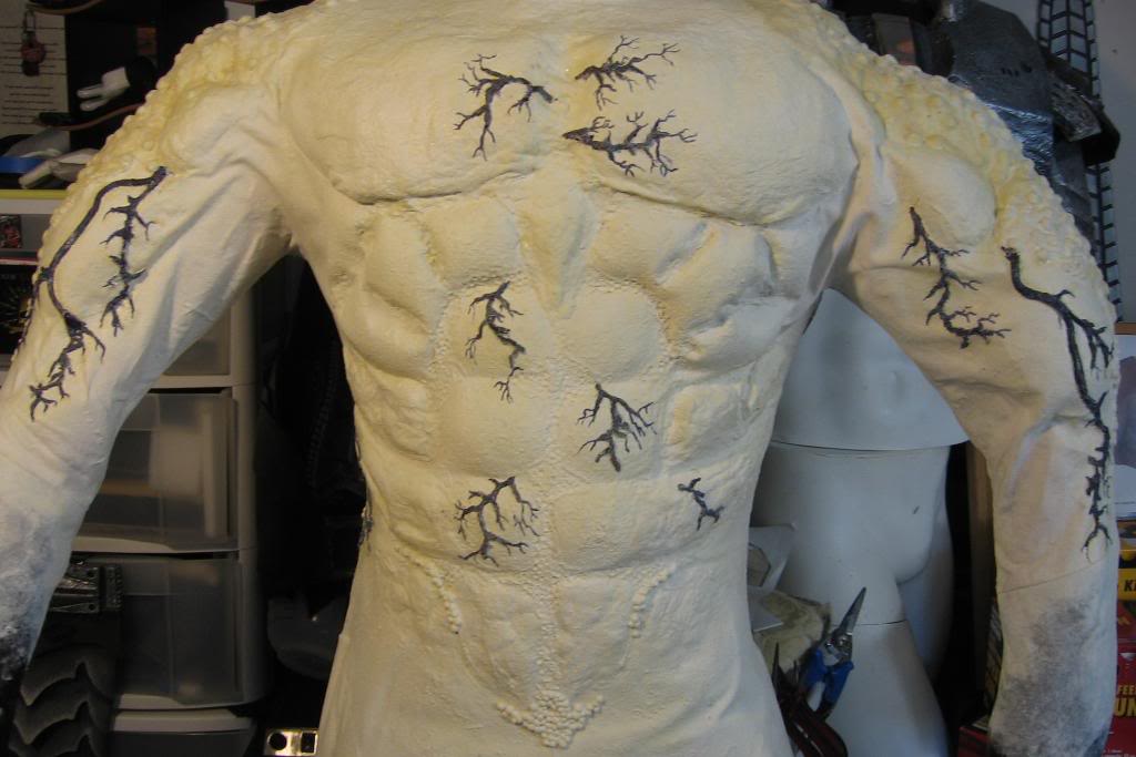

I spent a lot of time just staring at it, which helped me realize that I needed to get it as far away from the original look of the Mr. I suit as I possibly could. So, I then decided to make even further changes on the chest & abs to enhance more Pred-like features. I achieved this by adding pieces of cotton batting I'd cut into specific shapes & continued adding a few more thin layers of latex onto the entire suit.

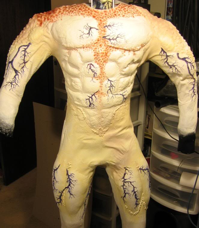

I then added pieces of yarn & small lengths of thin rope to create the appearance of bulging 3-D veins.

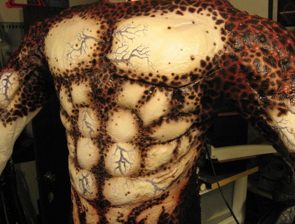

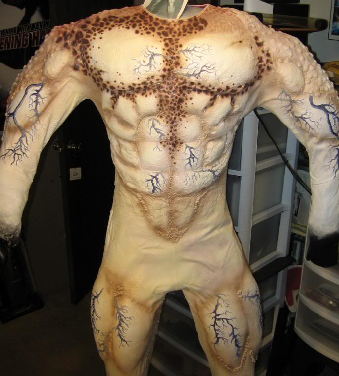

I painted the veins w/ a deep bluish purple before adding the final layers of latex which gave them a neat "under the skin" look. Although, after I'd been experimenting a bit, learning what I could do w/ my airbrush on a 3-D surface, I later white washed the entire suit & began a whole new paint scheme.

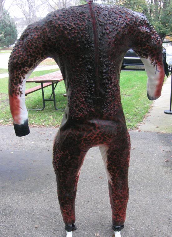

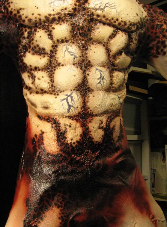

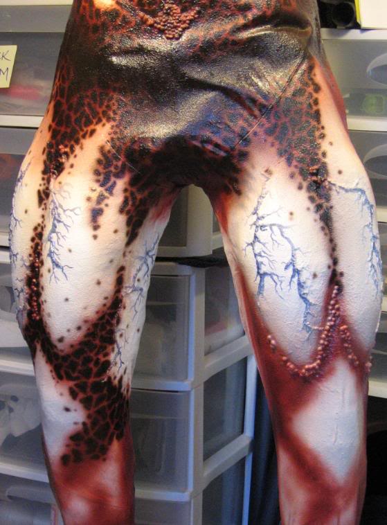

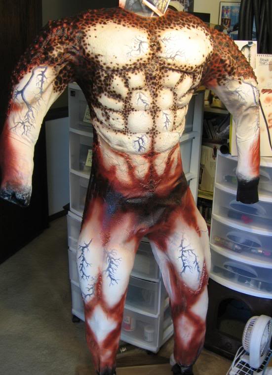

When I'd finally reached the painting step, I had still not fully decided on any "one" particular style or color pattern. So I'd sought out some tips & advice on painting from two of the best Predator painters I knew of, The Mortal Immortal & mangrasshopper (Joe D). Per their advice, I pretty much just continued spending many, many hours staring at it & every now & then I played around w/ a few different color shades & patterns until I discovered the "one" that it was meant to be. After that, the painting process seemed to fly by like nothing as the suit's pattern grew & soon became it's very own new skin. Thanks to everyone here in the lair who helped me out & kept me going throughout the entire process! Enjoy the rest of the pics!

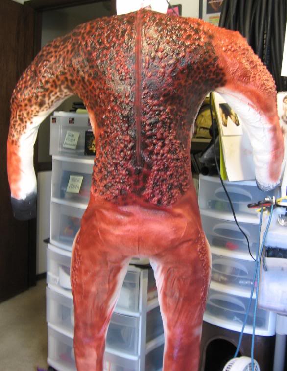

All of those many steps above, inevitably led me to what you see here below...MY FIRST FULL LATEX PREDATOR SKIN!!!

***PREP TIPS***

***PREP TIPS***
