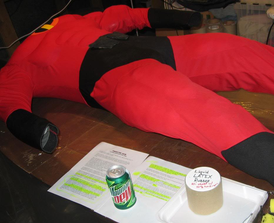

Lay suited Duct Tape Dummy onto the protected table surface. Keep a list of general notes & tips nearby for reference.
Here's the text form of the list which is seen on the table in the pic above. I got them all from researching as many posts as I could find here in the Lair & also directly from a few members. It's a random collection of all the tips & helpful info I'd thought would be useful to me along the way. I didn't need all of them but it was nice to see another's perspective & methods. So, absorb what is useful for you & more importantly, don't ever be afraid to try something new!

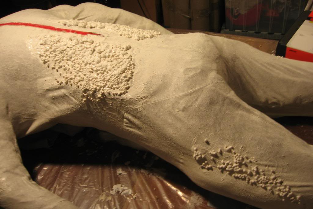

I'd added in some polystyrene beads to create a better look, but then later on it just didn't look right to me. So, I removed most of them w/ a razor blade & it left a bunch of small, cool looking recessed/dented in bubble-shapes that was unlike anything I'd seen before, but in a very VERY COOL WAY! *Check out what I mean by scrolling down a few pics!*
I also added some craft store pom-poms & more polystyrene beads to the back area and to the area around the leg muscles.

Mr. I suit on Duct Tape Dummy................CHECK!
Space to work uninterrupted.....................CHECK!
Table (protected w/ plastic cover).............CHECK!
1 gal of Monsterroom Latex..........................CHECK!
Plenty of different materials to experiment.....CHECK!
Although, I quickly learned these types of homemade sponges I'd made w/ pieces of foam cut into blocks (used for winterizing a/c units, found at any hardware store), textured by ripping out small bits w/ a pair of pliers & then hot glued pieces of a wooden dowel as a handle worked out BEST for stippling on the latex. Cheap & easy, since each sponge is only good for maybe 1 hour of use & then has to be tossed into the trash.
