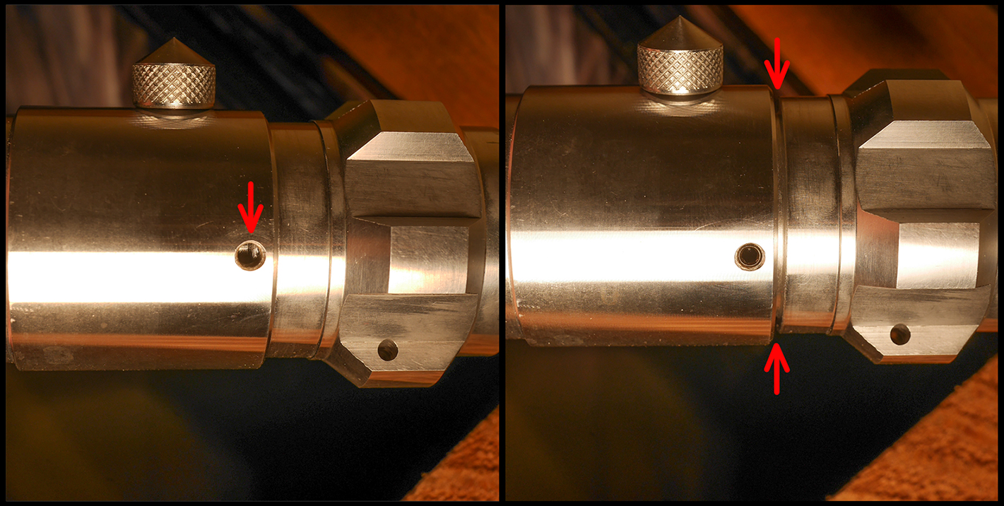

Um, is this normal? .... When I insert the pommel all the way, part of it obstructs the hole for the set screw. In order to insert the set screw I have to back the pommel out of the body more than a millimeter, creating a gap between the pommel and the body. Is everyone's saber like this and that gap is supposed to be there? Doesn't seem right.
normal, i asked the same question on the first run
