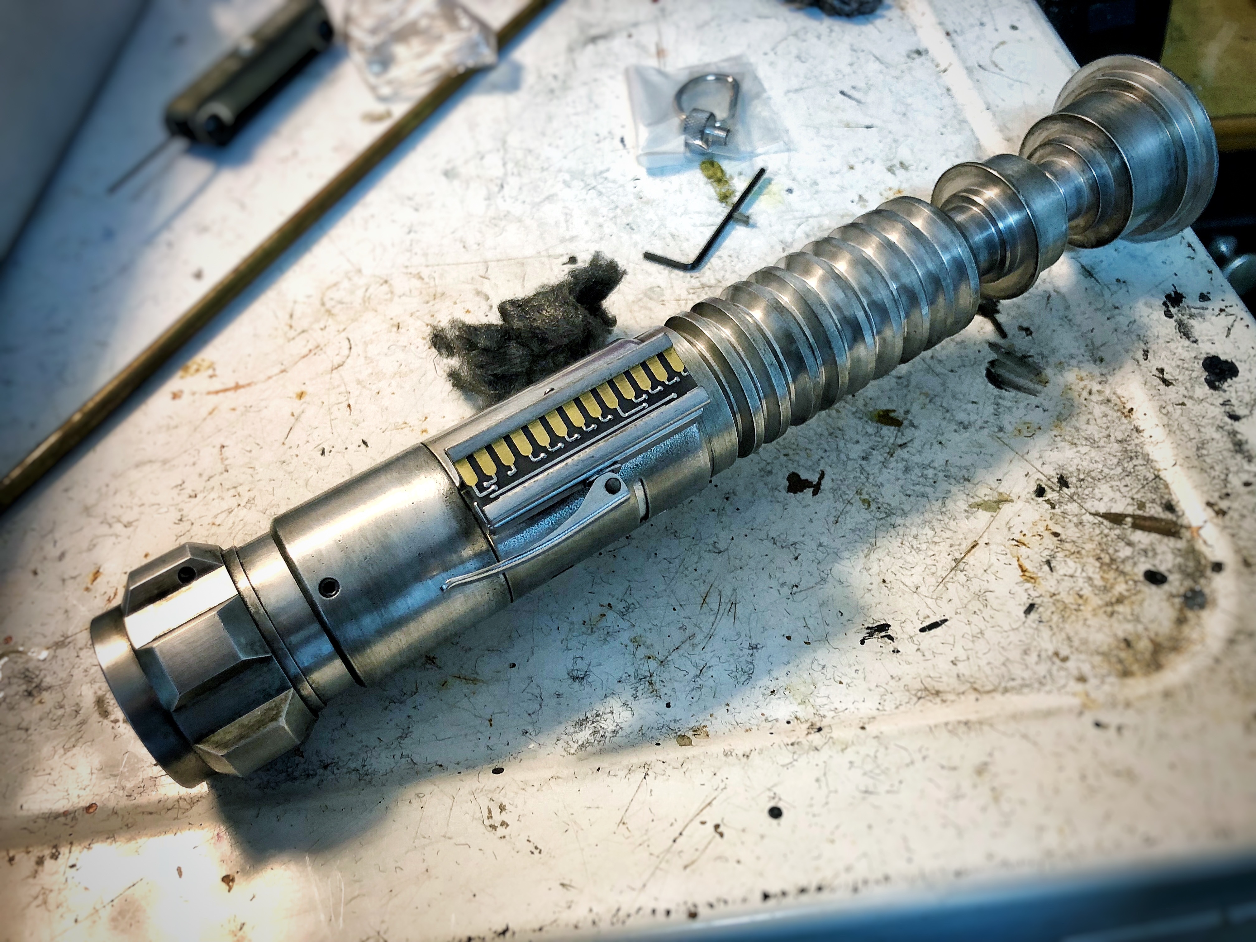

This is after about 2 hours in the 1 bleach: 2 water bath and then 45 minutes with 0000 steel wool and a Scotch Brite pad. I'm pretty pleased, there are some places where it came out a little splotchy but they're mostly in the rings and around the neck, which will be covered with paint anyway so who cares

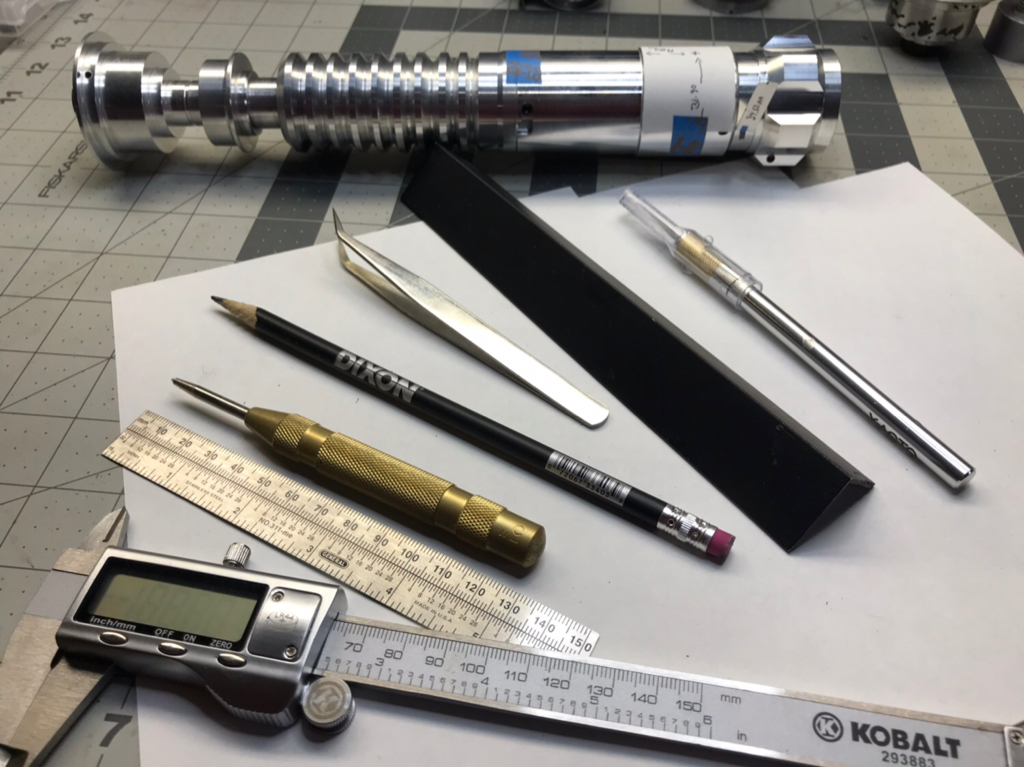

A little update guys, I was talking with trooper trent yesterday, showed him my plan. He came up with a much easier way, we are working together now to nail this in exact.
He actually gave me a task last night, I set everything up on my coffee table, and freak’n fell asleep...
I will have the templates done tonight and sent to trent for him to look over.
If there’s anyone who knows V2 circumference it’s him!
Sorry for the delay but we are almost there!!
I got the clamp from TGS clamp sale their having at the moment. as for the lever, there was someone on etsy selling them but i think they only had a few left. the weathering I did with several passes of aluminum black and 0000 steel wool. works great! I also dropped and dinged the pommel on purpose to get little pitts and dings on the aluminum and i left it roll down the street a few times just to get a nice "used and abused" look...turned out great but i did feel weird about doing that. lol
Can you link me to the Etsy shop, I did not know someone else is making levers... curious to see this...
On that subject - what are UK -based builders doing for clamps? Given the cost most of the reputable sellers charge for posting a single clamp over here, should we look at a group buy to keep postage down?
I can look into it if there's enough interest. For Roman's, for example, postage on one is $18.95, but only $60 for 10. However, that would probably attract a hefty VAT/duty payment....
The Graflex Shop is selling of 1st Generation blemished clamps for $25, or $20 if you order 10 or more. Mix of with/without text and no guarantee what you get.

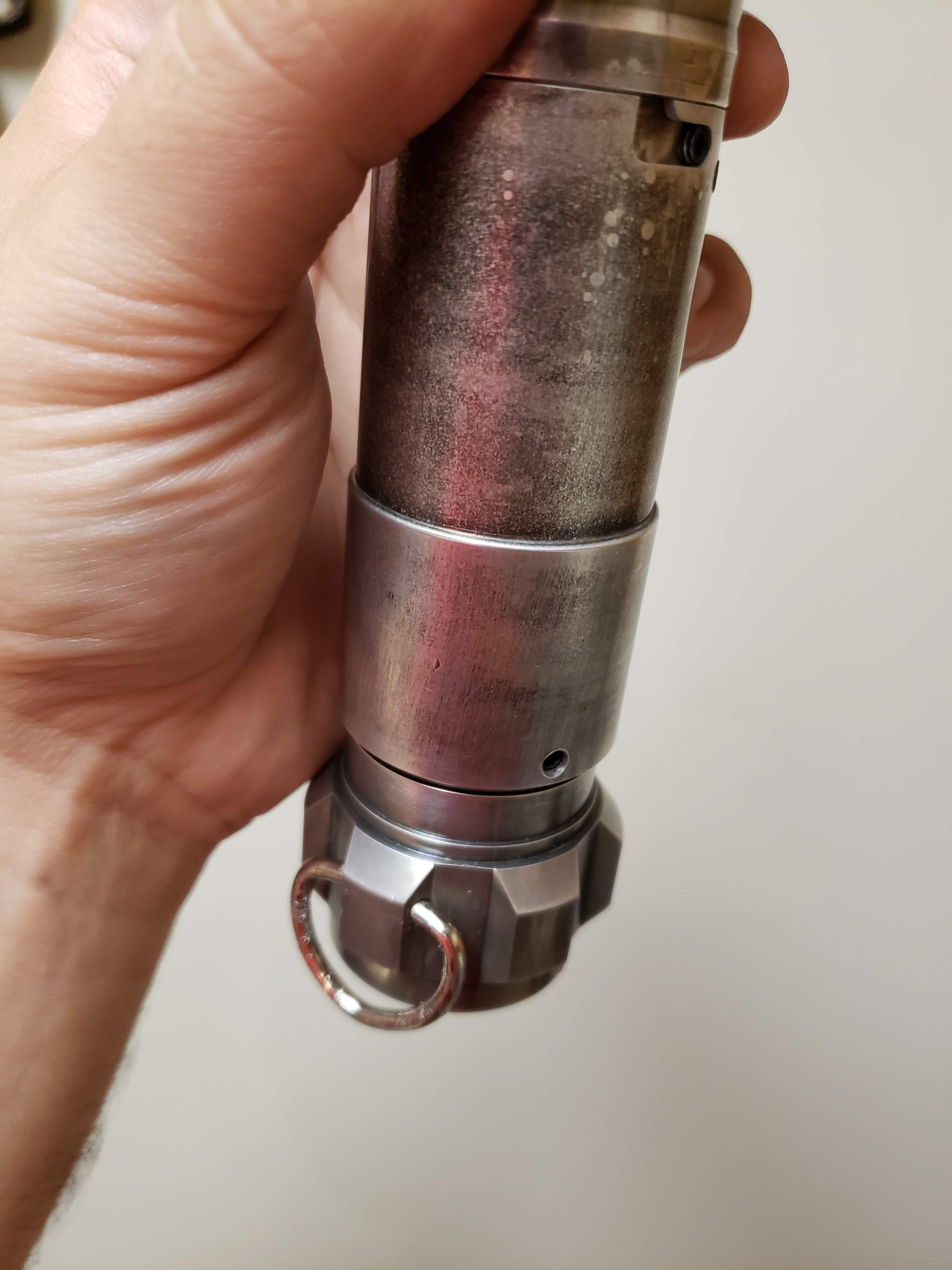

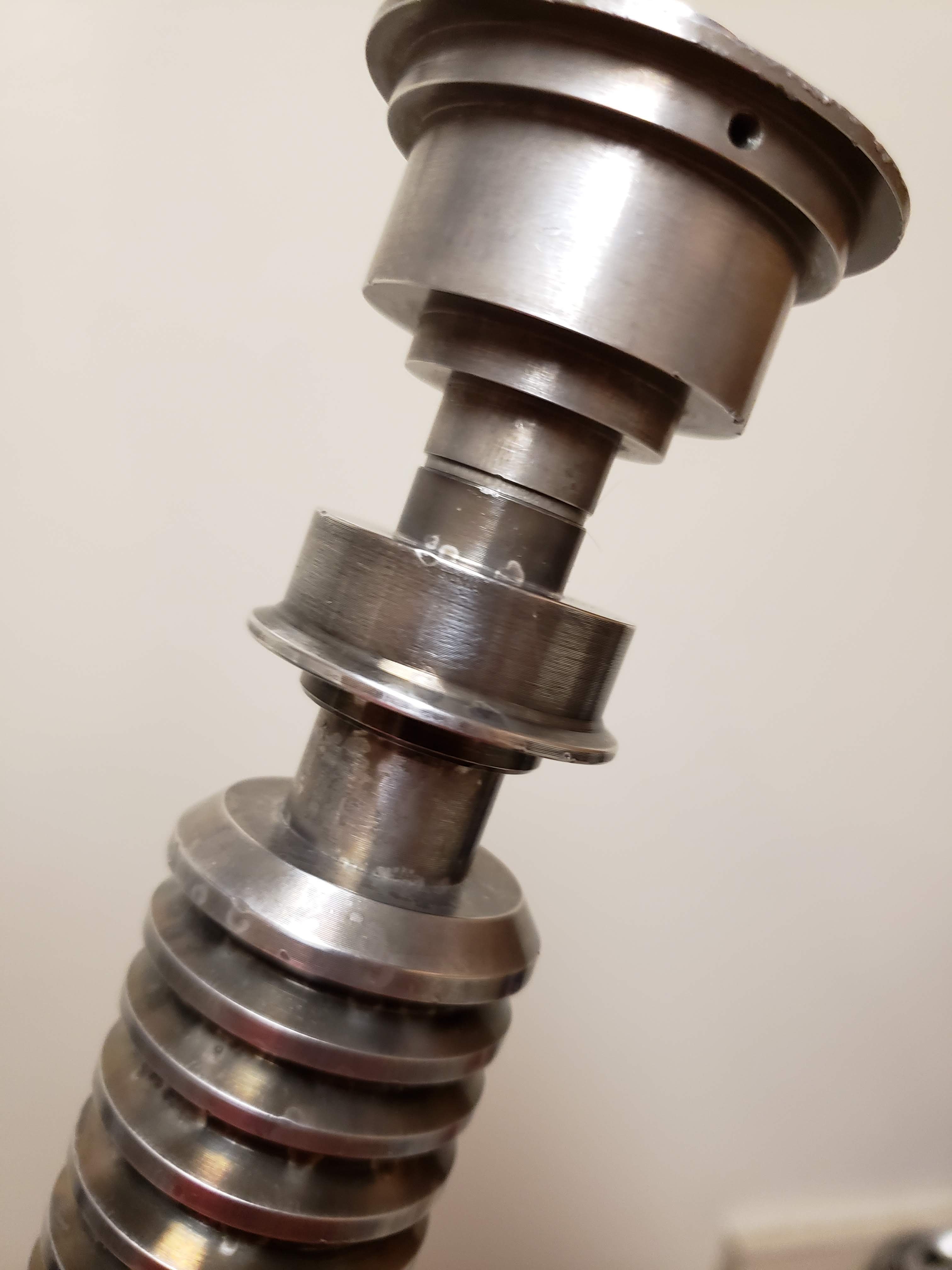

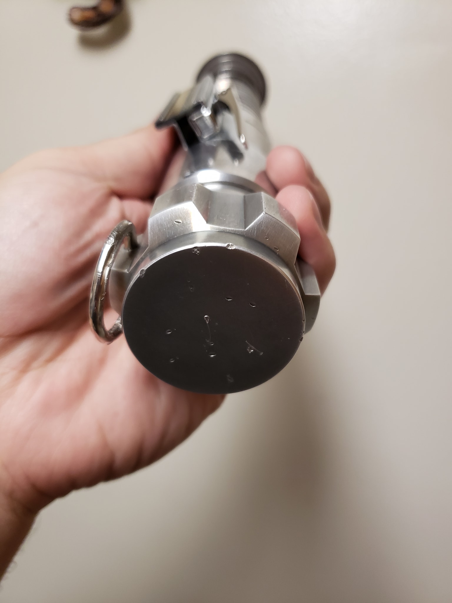

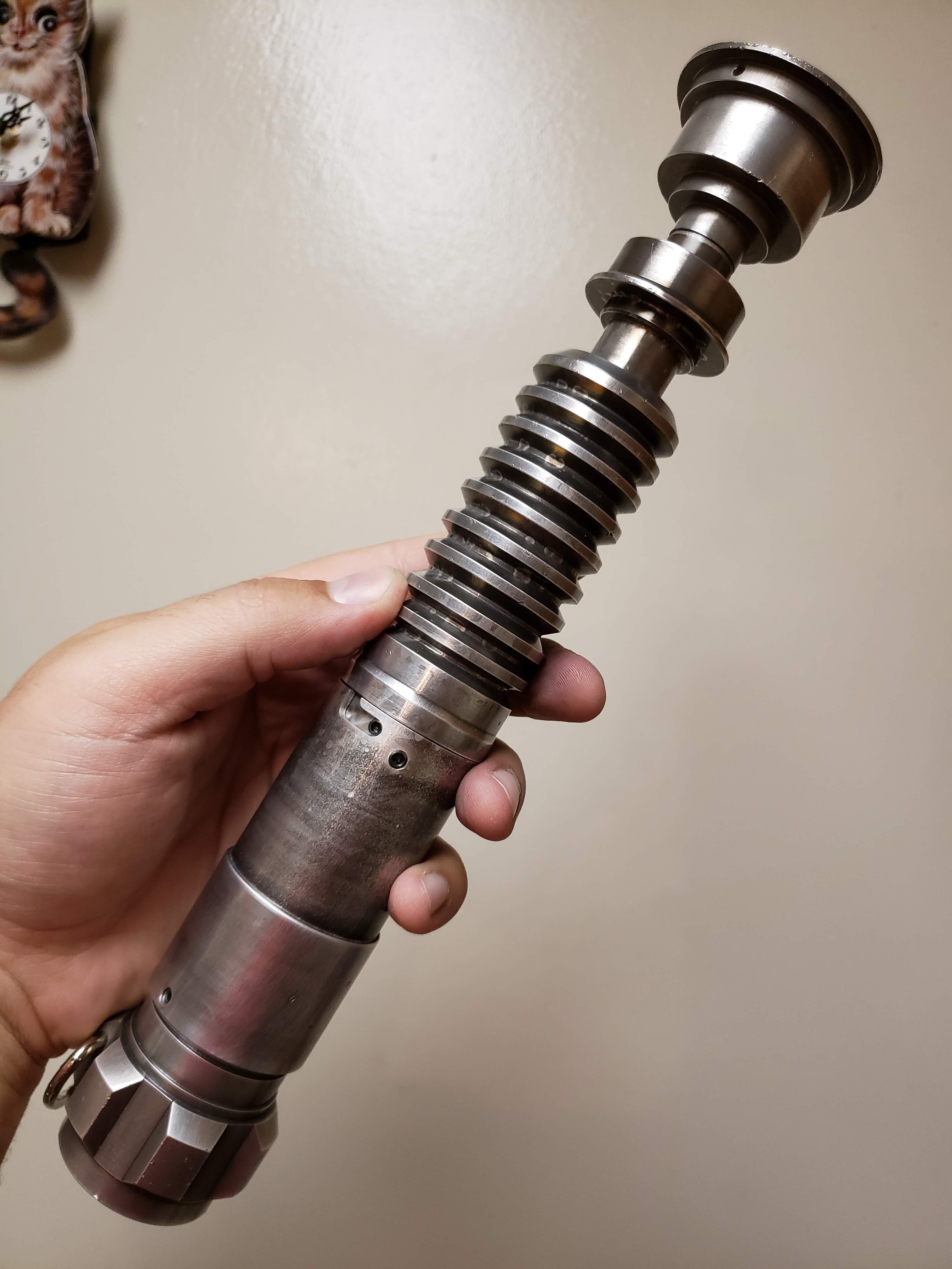

Finished weathering mine last night (the clamp is a Roman's, the TGS I ordered is going on my KR) and the stencils are coming today. Gonna try to paint it this weekend, if the weather holds. It's been damp and rainy and it's supposed to break Saturday, but we'll see.

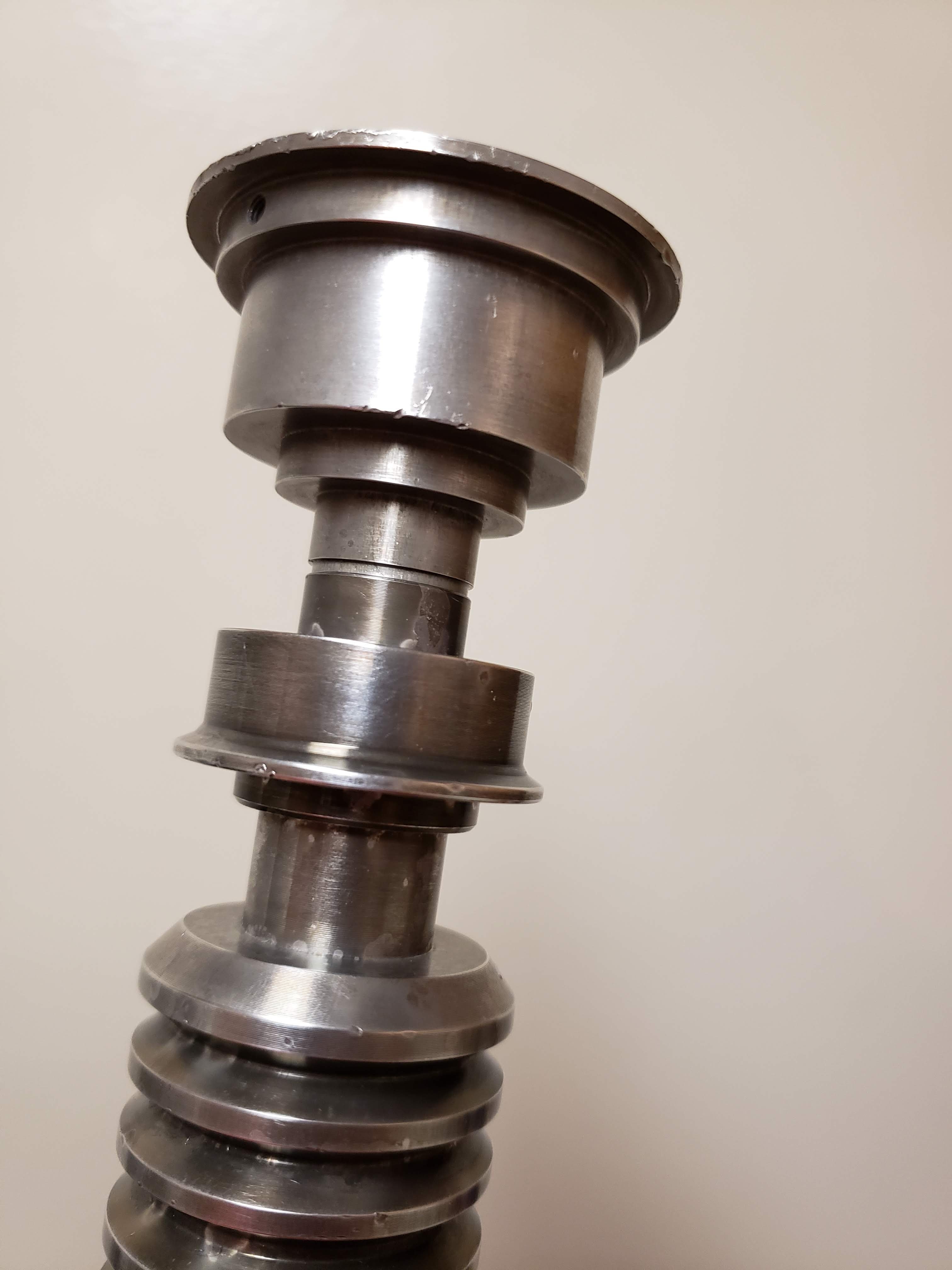

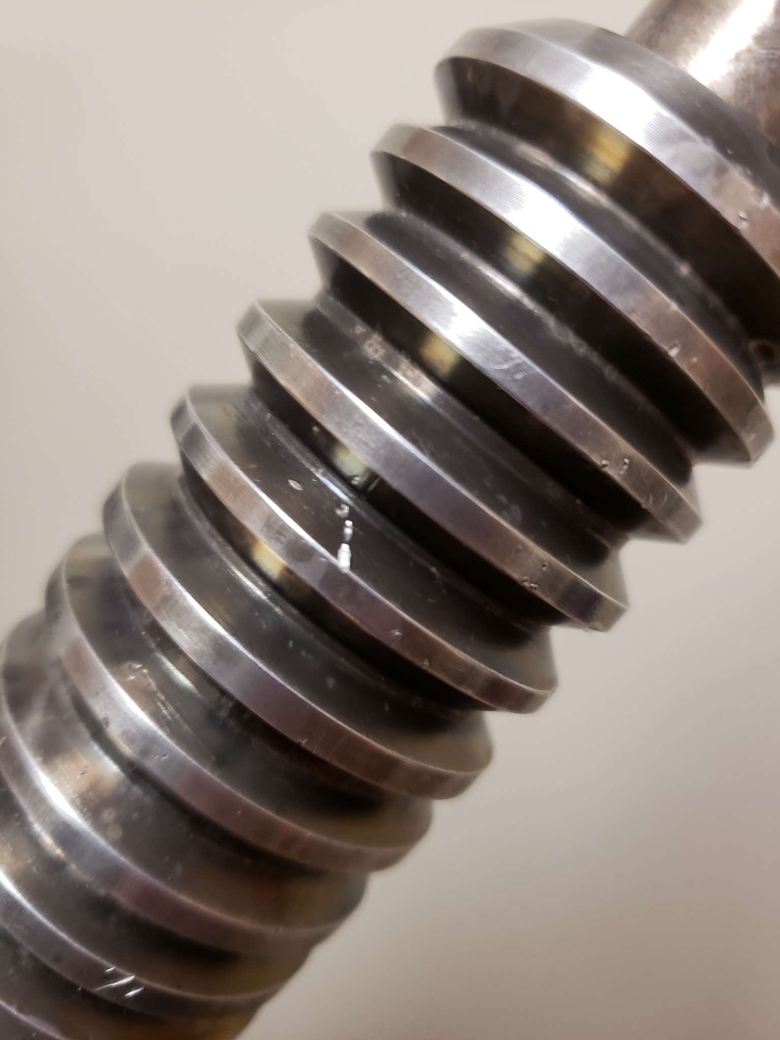

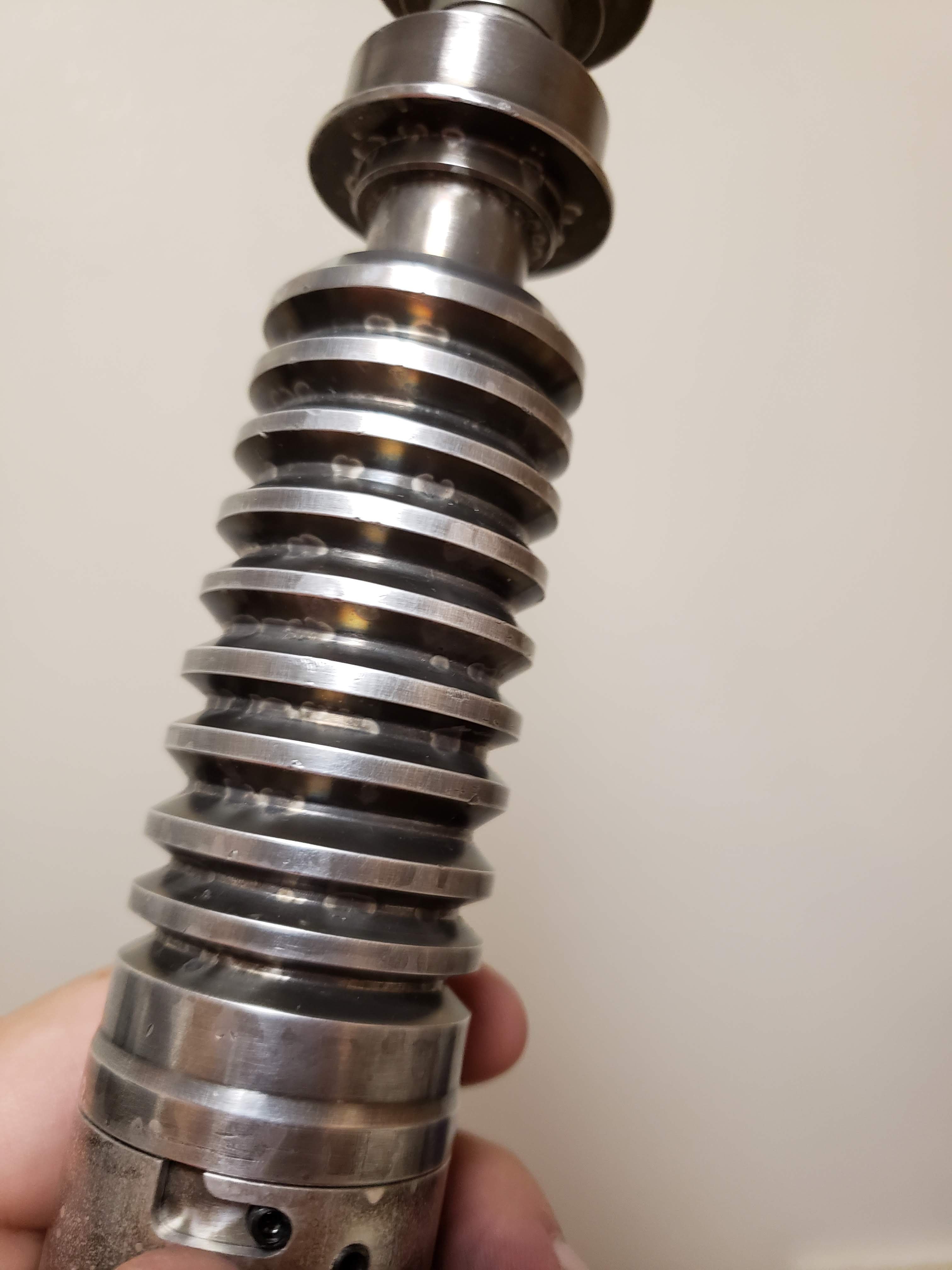

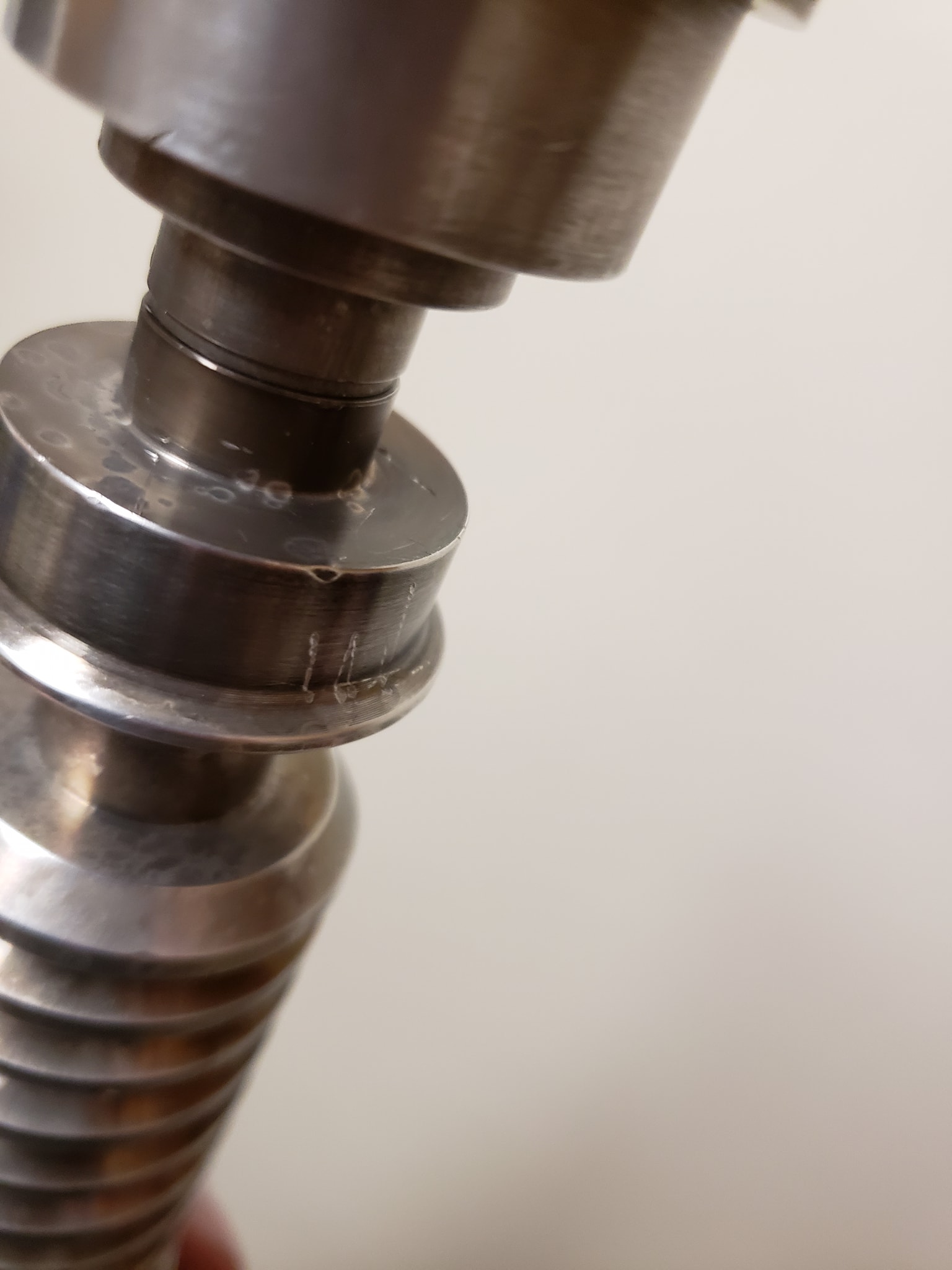

Here's some shots, with close-ups of most of my favorite dings:
