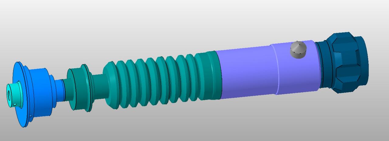

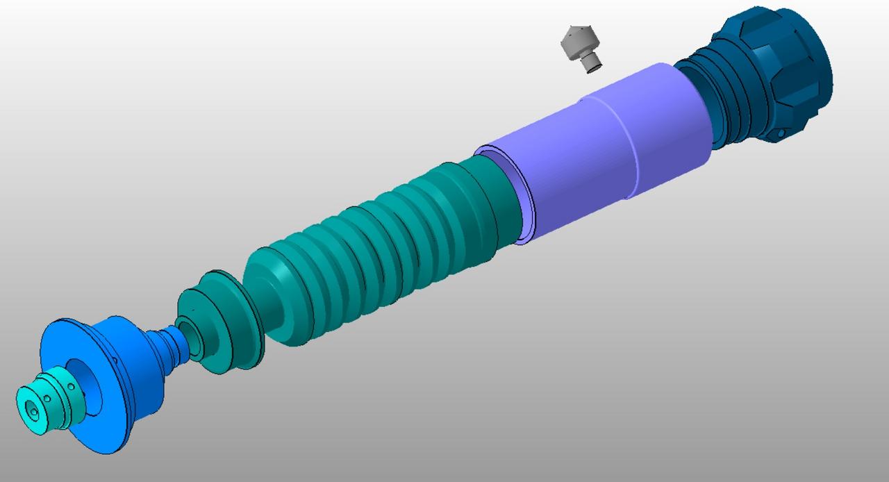

Almost every time I log onto the RPF, I see messages in my inbox asking me if I'll do another run of v2 sabers. Well, I caved and decided to do one more run, but this time it will be a little bit different and hopefully satisfy the requests of some people who couldn't get in on the last run. These "builders kits" will be nearly identical to the last run in terms of overall dimensions, but will have a simplified construction and a couple different assembly options so that you can choose which version of Luke's saber (V2, V2ANH, V3, V3post production) that you wan to tackle.
My goal with this run is to provide builders with options on which saber they want to build, and to offer a kit that is a bit more budget friendly than my last run.

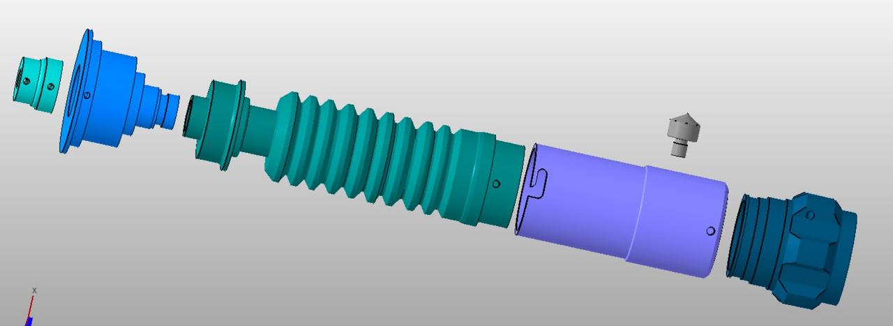

The kit will consist of an emitter blade plug, emitter, forward grip, clamp/booster section, pommel, and v2 knob.
Instead of having the 5 piece emitter construction of the previous run, this emitter will be solid, with the emitter nipple sliding into it as a blade plug. The builder will have the option of screwing the emitter into the saber neck and using it a a fx kit with a 7/8 blade. Or, you can cut the threading on the back of the emitter off, and have the emitter spin on a steel rod like the original.

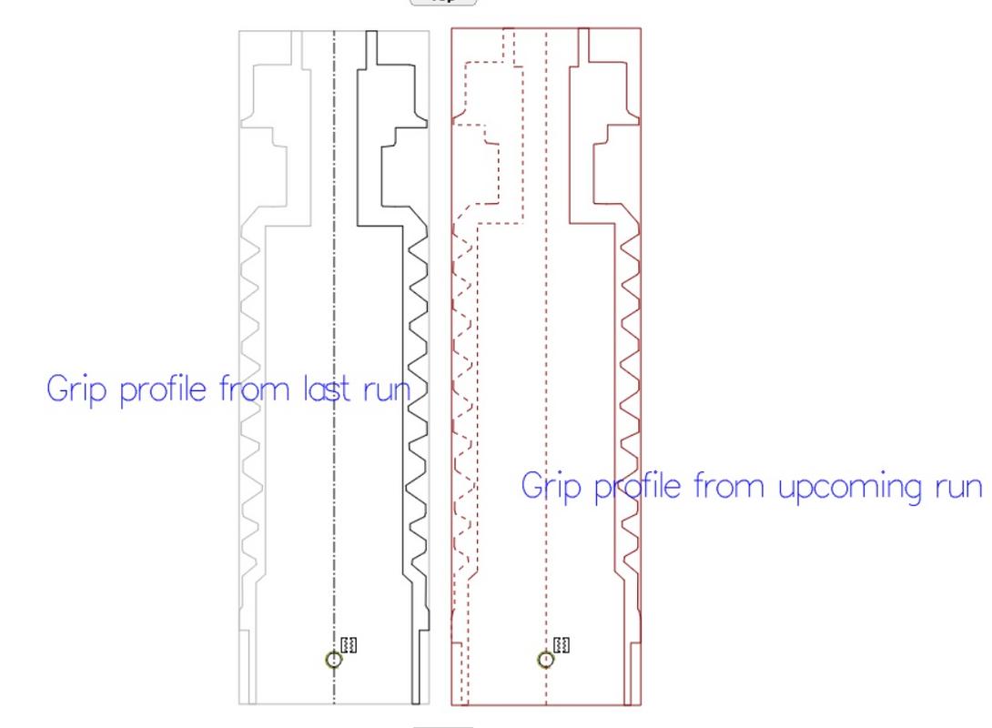

For the forgrip, I'll be using the leftover prototype grip parts that I got from the shop during the last run which. This part is the most expensive to machine. So using the extras that I have from the last run allows me to drastically reduce my price. These parts are almost identical to my previous run. the only difference is a 1mm difference in the bottom of the final ring and the slope of the towards the graflex clamp is a little steeper.
Here's a comparison
The clamp/booster section will dimensionally match the last run (but will be adjusted to fit the different forgrips)
However, the hole for the v2 knob will not be drilled. This will allow builders to make a v2 or a v3 version if they so choose. I will provide a tutorial on how to add the v2 knob if you wish to do so.The pommel will dimensionally match the last run. However, the shallow circular recess in the pommel cubes will not be present and the hole for the mystery chunk will not be drilled. This will allow builders to make a v2 or a v3 version if they so choose. I will provide a tutorial on how to add the circle in the pommel cubes and the hole for the mystery chunk if you wish to do so.
