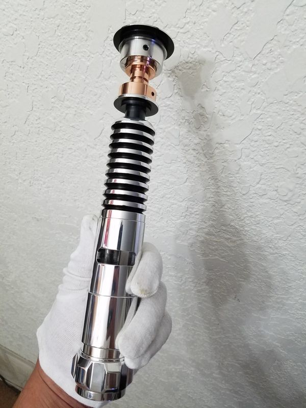

Mine arrived this morning. It looks amazing. I'm so happy. Thank you so much for this run :)

I recieved my my saber today. What a great job by Rudy! Thanks, man. Really, really nice.

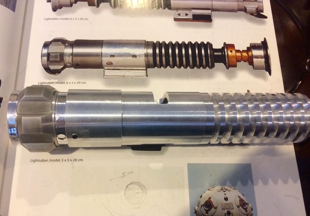

I got the paint job more or less finished. I did 3 or so rounds of oven cleaner and steel wool to dull the finish. The grenade section was primed then painted rattlecan satin black. I removed the paint from the rings with sandpaper. I then masked off the "seam lines", painted those, then took the opportunity to goop some paint I'm between the rings with a brush. After the paint dried, I took sand paper and knocked the painted seam lines back to be a bit more subtle.
I used aluminum tape on the pommel and emitter. The upper portion of the windvane section was covered in foil tape, too, before painting it all copper. I love the gunky texture in the crevices!
I marked and drilled the holes on the clamp before covering that in aluminum tape, too. I removed the side bars and covered them in separate pieces of tape. I may yet try to weather the clamp lever, too.
I've yet to install the d ring. That mother is tough! I can't seem to get it apart by conventional means; I may have to clamp it up in a vice or something. I'm also awaiting some 1/8" gold pinstripe tape in order top make an activation strip. Then it's on to the electronics [emoji15]
Sent from my SM-J700P using Tapatalk

Received mine today as well and quickly got to work...
So far, I've blackened the pommel cube ring and trimmed and placed the aluminum tape pieces on the pommel areas above and below the pommel cubes.
