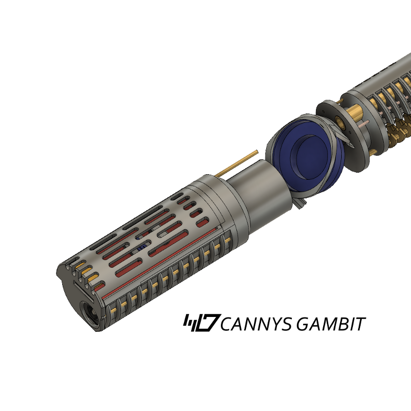

Funny you should say that a few pages back I have posted progress. Just waiting for the saber to arrive before I progress. Its also my current most checked thread!
Chassis - holds all the electronics in a tidy and organised location.
Chamber - ornamental bling of awesomeness that simulates the core of the lightsaber.
I am working on the chamber but that's a future development that involves more than just me (stay tuned). The plan is for a composite chamber consisting of machined alloy, 3d printed metal parts, and laser cut disks. I have already got the costs for the laser cut disks, they are defiantly a go.

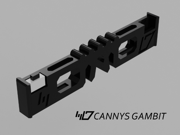

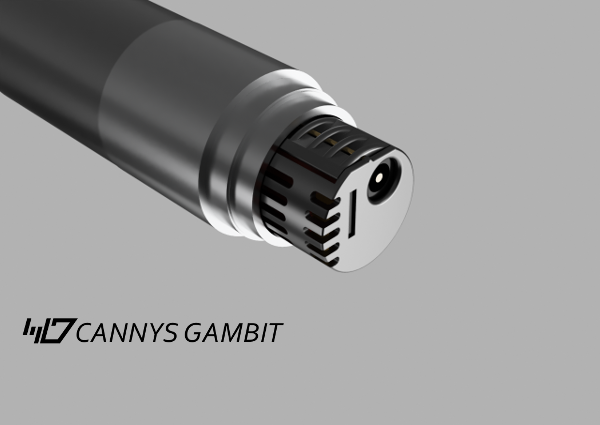

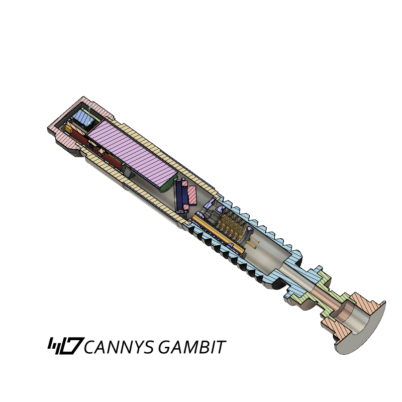

Chassis
Depending on how many are interested I will print at home. I can print them for a fraction of the price, I will use PLA. Shapeways run a business and have to pay overheads blah blah. I will load it to shapeways for people that choose to upgrade later.
A few have already messaged me about specs;
I will ensure it can hold a spark 2 or a Nano Biscotti. You will have to purchase either of these yourself.
I Import xpe2 LEDs from the states so your better to order them for yourself if your in the states.
Pack will include
28mm high quality speaker
2.1 recharge port
2x 2x4mm Micro tac/mom switch to fit in clamp
1x 3mm Green accent LED
Chassis for electronics
clamp switch holder
1.5 brass rod.
These are all designed to fit the chassis.
Graflex_Slot_switch_housing.pngOb1SS-CG-chassis.pngOB1SS-CGendcap.pngObiSS-CG-layout.png
I will make a separate thread in the next few days to post progress and designs updates. I guess its only a month or so away to get our hands on these!!
Re: Luke Shared stunt Version Lightsaber ( Pricing Now Uploaded )
It will not fit the Prizm and CF they are too wide. With the battery and card in the space available there is just not enough room, if you didnt want a chamber you could have the battery and card on top but this would reduce the plans for the chamber. How ever it will fit all of Naigons cards, eg spark2 and colour and igniter 2.
