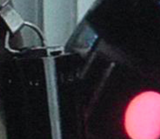

Okay whilest negotiating for a nice vintage ESB connector board I was send this picture along with some more by The RealMcFly ... thanks ... so this is how it appeared on the MoM exhibition ...
The question remains however was this done during filming or repaired with phillips head screws after production, whilest they also added a piece of that textured mylar tape?
Notice how the Kobold part is also adjusted in regards to the pictures presented by Kurtyboy in this thread?
-Chaim

Chaim also pointed out earlier the changing position of the Kobold D ring attachment. What if that early photo really does portray a broken grip that was replaced. Perhaps a shift in the replaced grips accounts for the descrepancy. Look again at the photo Chaim posted of the Philips heads and tell me you don't spot a weld on the Kobold part. Would they have reused the original rivet holes to secure this part and what is the proper orientation as it relates to the Graflex stamp on the bottom?

I think I just saw....both the Hoth Saber and the SRS have a silver bump to the right of the D Ring clip. It looks to be solder or some other silver material stuck to the bottom plate of the graflex.

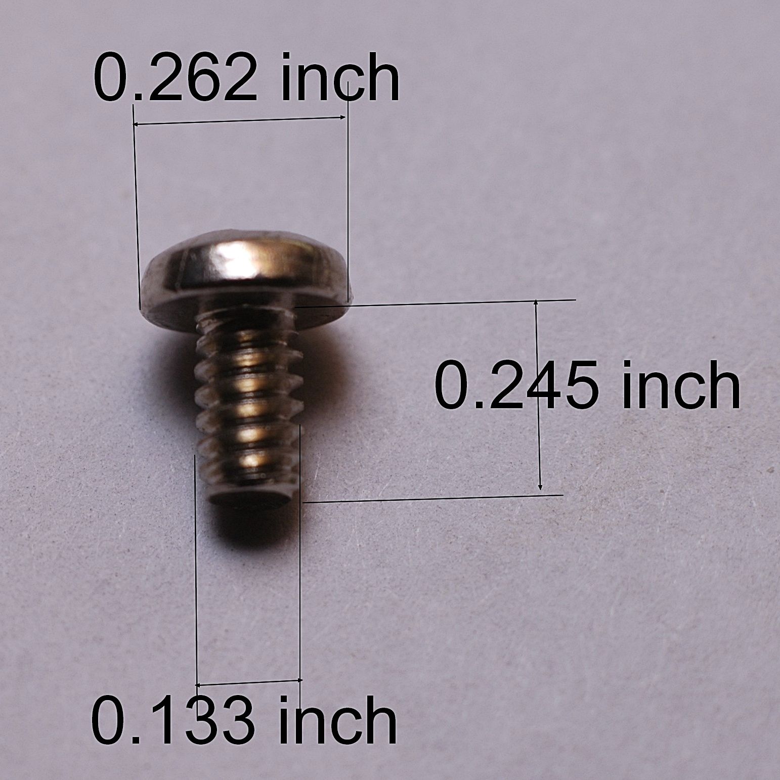

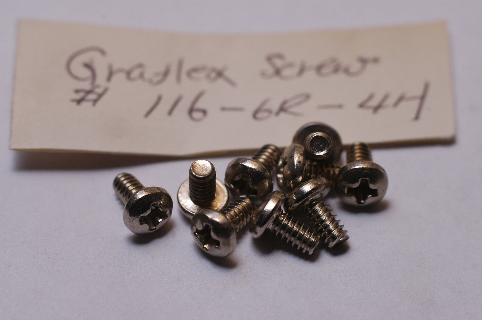

I thought, I'd go for screws and found some Graflex screws (Graflex Machine Screw Part # 116-6R-4H). Don't know if they are from Graflex flashes. But they have the right size I think.
