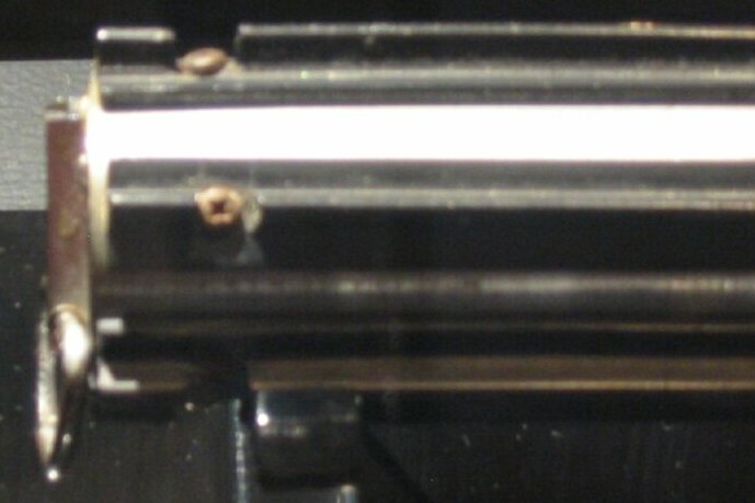

There are screws on the Ranch sabre which Gino showed. The others as far as I know had rivets. There were various sabers used in the film with minor differences to each one depending on the scene and it's use. If memory serves the ASAP PROP BOARD has an excellently researched thread about the ESB sabre and its variations.
If someone has a clear shot of any saber from the films using rivets, please post it up.
I don't have a scanner or i'd post it up, but I have the book mentioned in the second post. I found the shot - and the shot of the saber is vertical and is nearly the height of the entire page, probably about 8-9" tall. I can't see anything conclusive without a magnifying glass. Even with that, all you can see is a dark brown color (they're pretty rusty it seams), but on the screw on the left side, i can see a darker area in the middel of the head which reads fairly close to a phillips head cross. The photo isn't the clearest thing ever for those screws, but i'd be leaning towars the one of the left being a screw.
Here is that thread if you want to look at it:
Log into Yuku | Free forums, social networks, communities, chat rooms
The problem with a lot of picts showing the grips is that the detail is not clear and the "x" of the pan screw is blurred and therefore the fasteners tend look like rivets. That is assuming you believe that they are screws, which I do.
I've held that particular saber in my hands. They are most definitely philips head screws.
Well I stand corrected then. Screws it most probably is, depends on the version you want to recreate Hero, Dagobah, Hoth, Stunt etcetera. If I ever find absolute picture proove that rivets were used I'll definitely let you guys know.
Indeed the picture on page 33 in that book is not very clear. Also a regular tiny flat screw has been used to fix the clamp lever. Glad I haven't converted my designated ESB graflex yet :)
-Chaim
Thanks you guys for all the input.:thumbsup
Well, this had been fun and educational!
OK, so I need to completely ignore the lightsaber sold by PIH from Gary Kurtz as it had the wrong grips and rivets!(shame as I really liked the rivets)
Phillip head screws it is. Anyone conclusive about the size?:confused

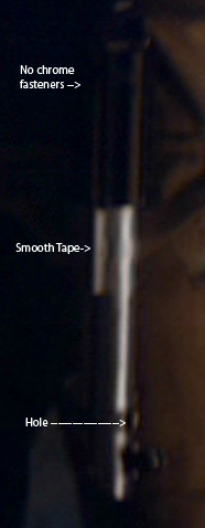

I beg to differ! There most certainly is a Dagobah saber that is missing the top button and has smooth tape on the clamp. Screencaps confirmed this. The textured tape is theorized to be added later along with the smaller screws in the grips becuse the vader saber had the same smaller screws.
