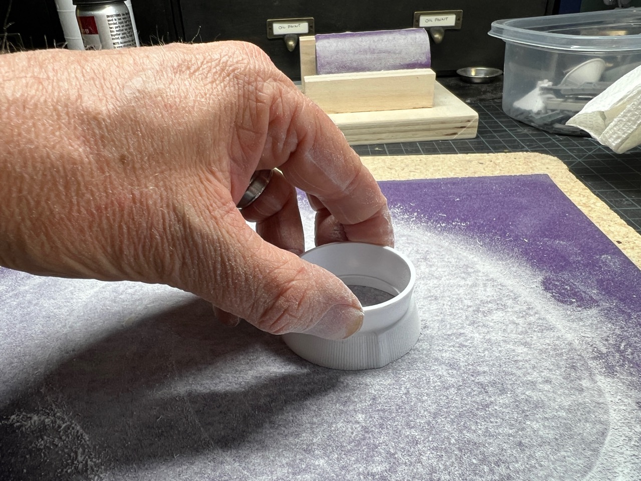

Using part 61 as a makeshift brace/grip I sanded the ring down to the correct diameter that matched the body tube and made a lot of dust in the process.
I then flipped the part over and continued to sand it to get the correct height. Around 8.5mm.

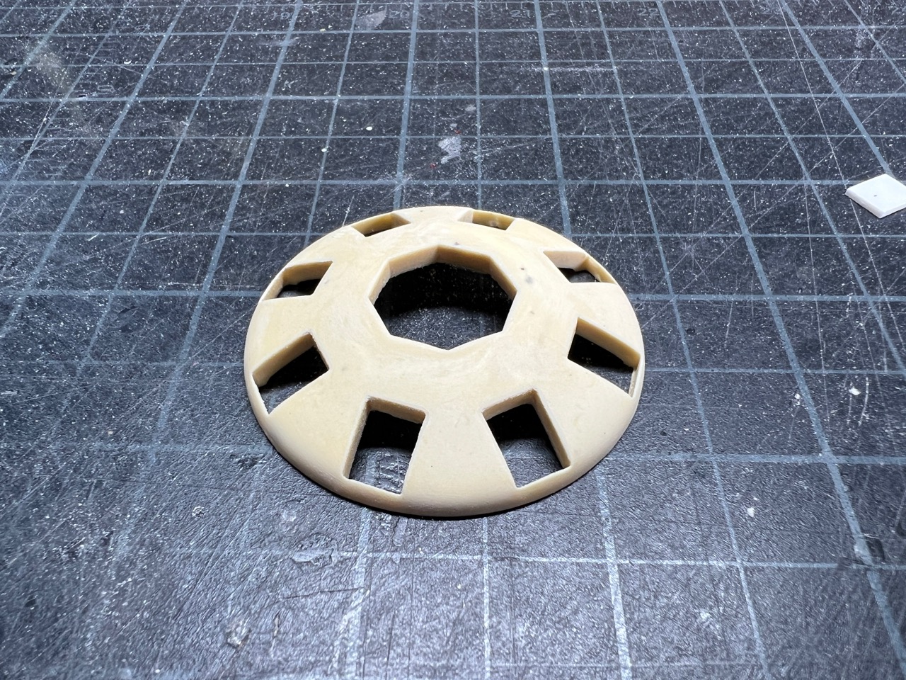

After cutting out the openings, I gave it a light sanding to clean it up.
The Prince of Wales parts needed to be sanded down on three sides to fit. I used a couple of actual kit parts and the rest were castings I made.
A piece of styrene strip was added to the back end of the PoW parts and they were glued in place.

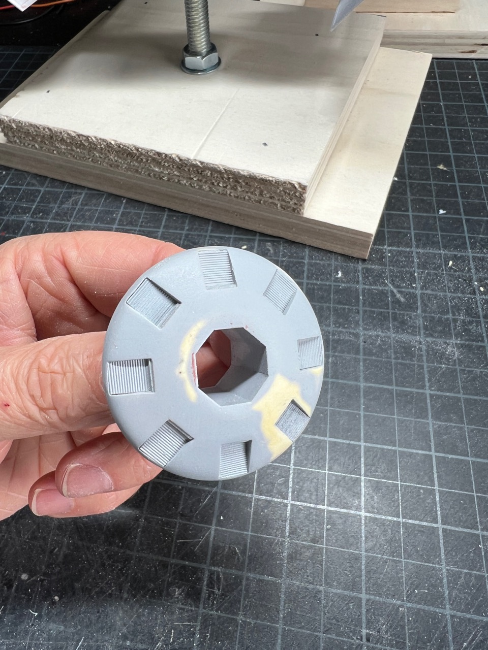

Moving onto the wings. I needed to add the half-round strips. I used .040" because that's what I had. The correct size is .030". So sue me. Anyway I drew a guideline to use as an approximation for placement.
From there I just started cutting and gluing. I would strongly recommend using reference photos and not the part map as a guide. There are a lot of subtle variations on positions of the rods that can get confusing depending on the angle of the photo. Also, I was able to create some nice miter joints by simply cutting pieces at an angle.
Before I knew it I was finished with one wing.

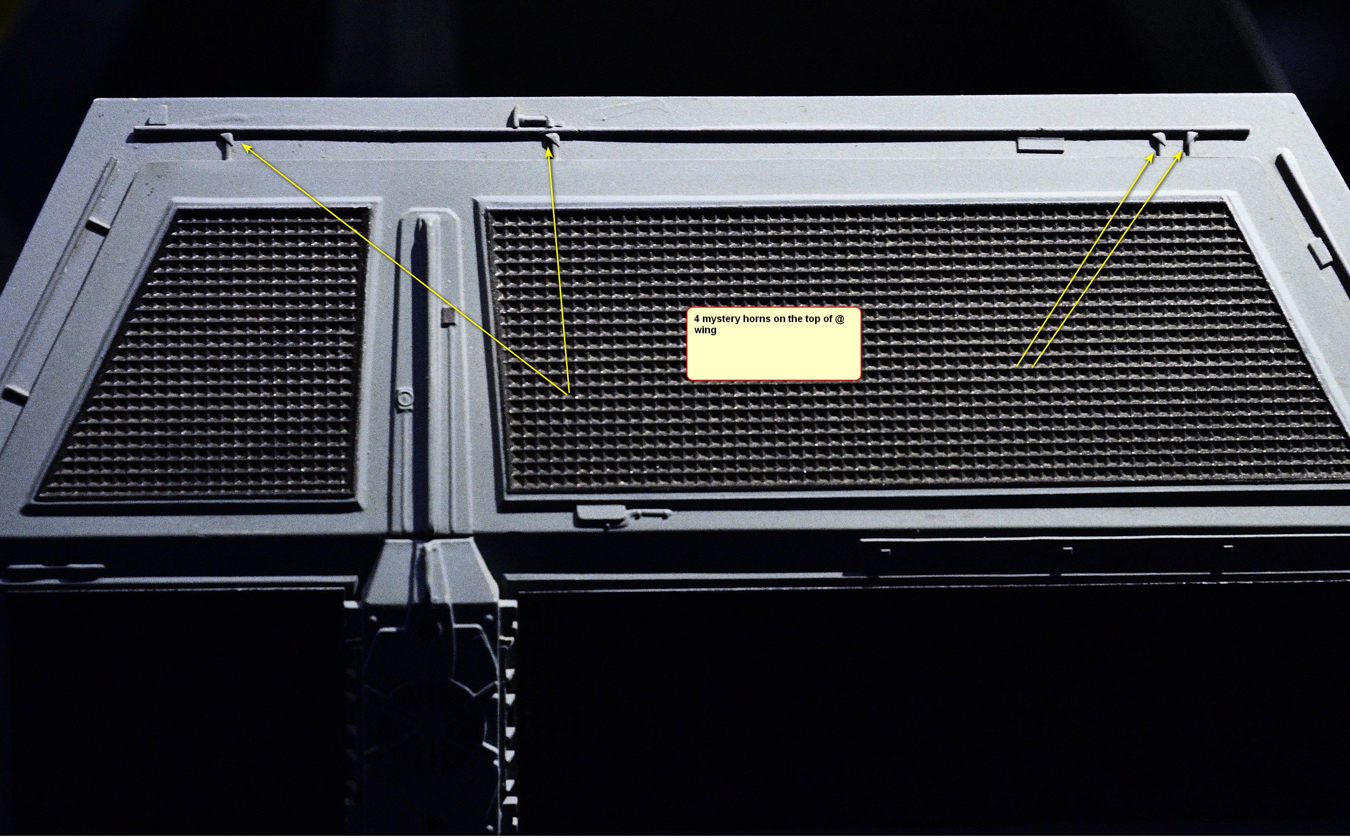

Bret what are you using for these mystery horns?
