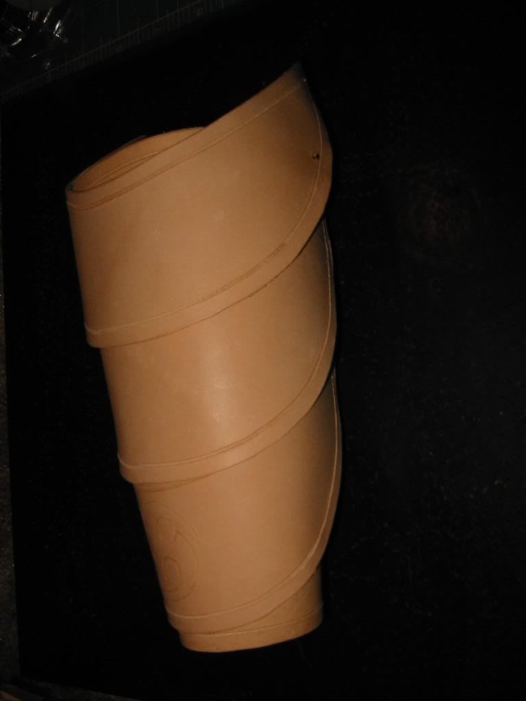

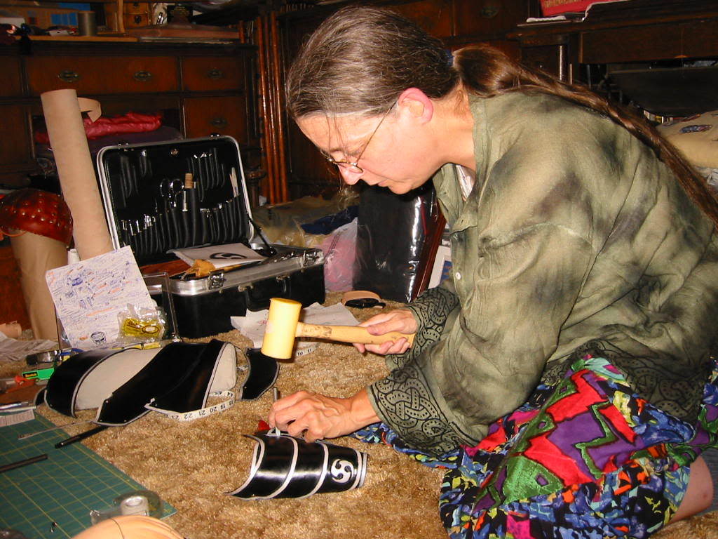

The costume has two sets of armguards, one set is flat and has no housings for blades or computer i.e. "dress uniform" set.
The other has room for the display and blades.
The "flat" armguard, no color yet

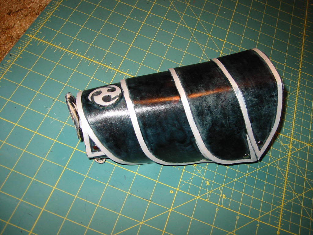

Putting it together after being colored

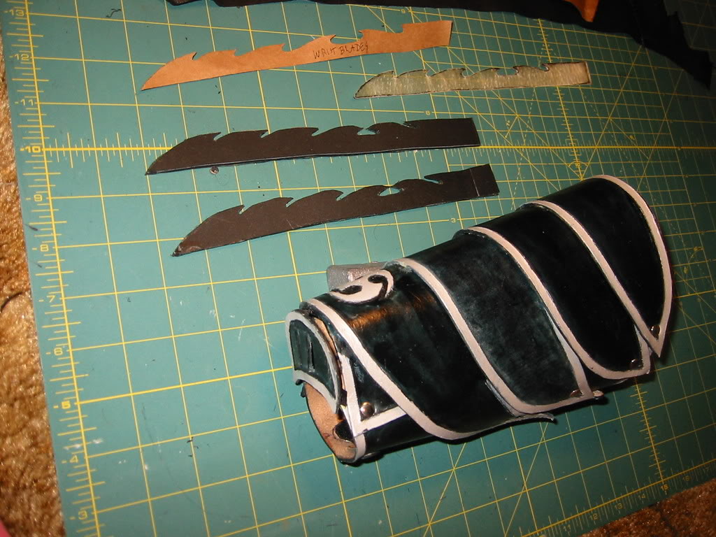

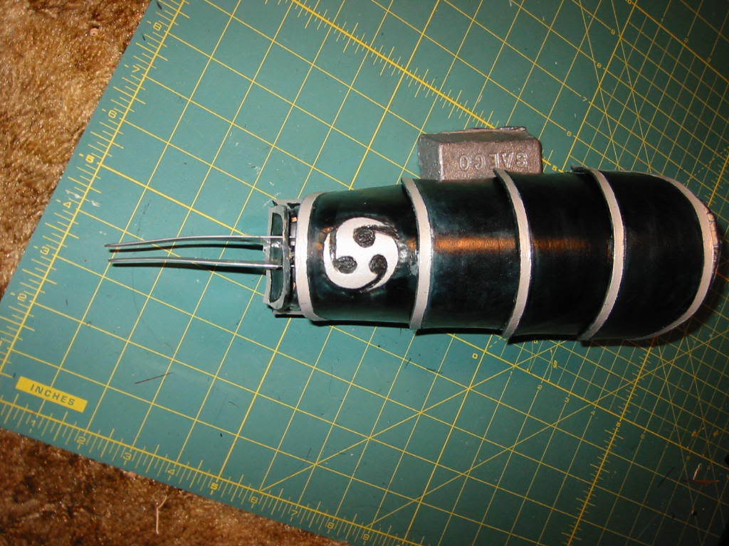

wristblades gauntlet with freddy fingers, will get an upgrade
wristcomputer gauntlet (front opens, not top)

All of its riveted, with a spot of glue under the overlaps to keep them in place, especially the blade and computer gaunts.
Those are three layers, the cone shape armguard piece, then an overlay to make the inside top of the gauntlet, then the scallop pieces over that.
The flat ones are just the cone shapes with scallop overlays, riveted at the scallop points and spot glued at the middle overlaps.
All the gaunts have velcro closures with snaps to ensure they don't come loose.
Many brown paper bags gave their all for this suit ;) trim and fit till it looks right, then layout on the leather and cut. Then tape pieces to check fit. Then make small holes where the rivets go and pin them (seen in the flat unpainted pix) to see how it will look before taking the plunge and making those rivet holes.
THEN color it, then make a lotta noise like Rosie the Riveter.

For now my upgrades are made out of stiff plastic from a car mudflap (cut with exactoknife) and then I will cover it with silver tape.
No more bendy Freddy Fingers :0
New blades to go in the wristblade gauntlet:

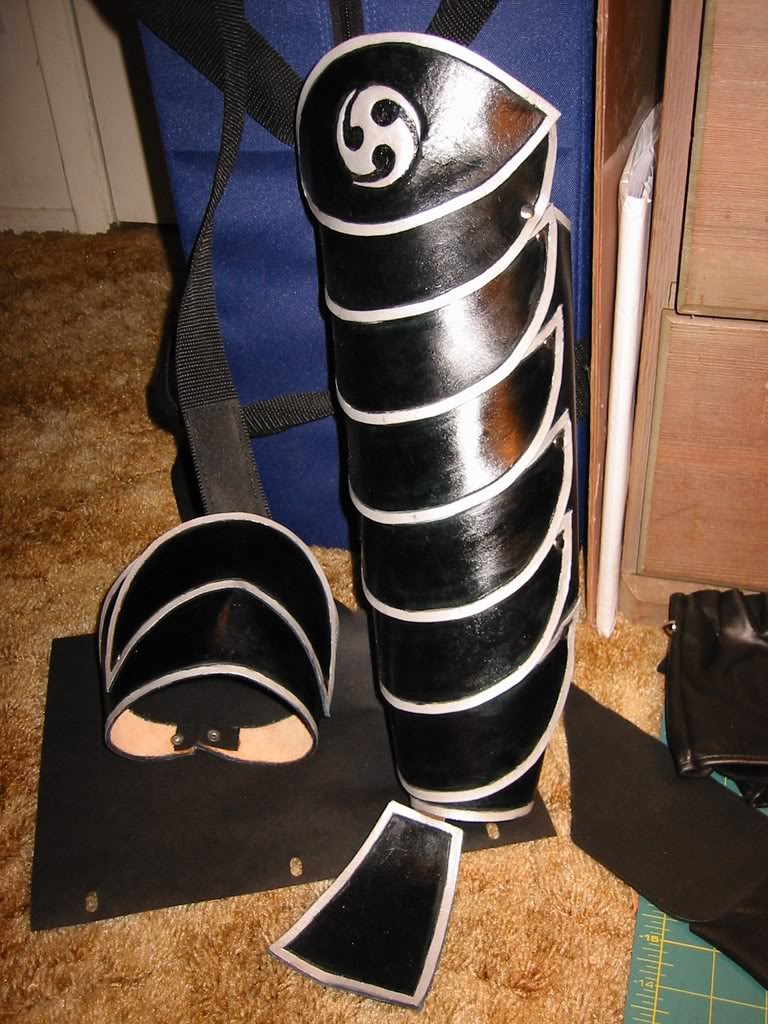

The shinguards, along with the kneeguard; the shinguard closure is the same as the wrist guards & gauntlets- velcro with snaps for insurance.

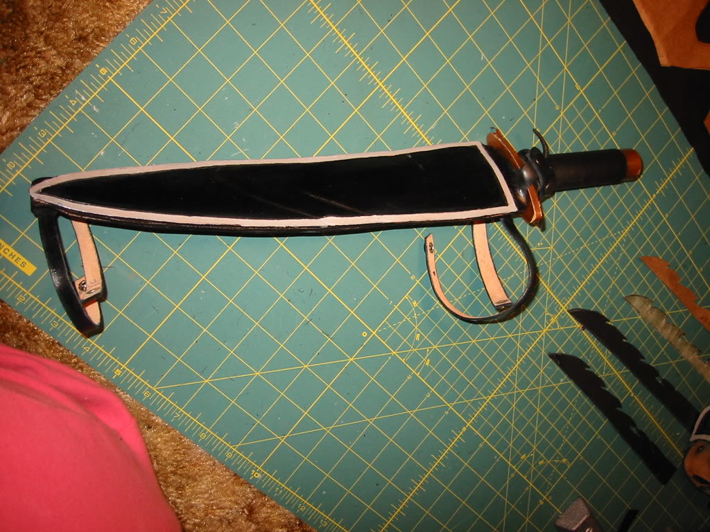

The knife that goes on the side of the shin guard; here there are snaps at knee and ankle which leave room for movement and allows for change if I get a different knife. The knife in there now was made from wood; the handle is a dowel, while the hilt and blade are thin wood. I covered the blade with silver tape, and the handle with thin leather; the pommel is copper tape.

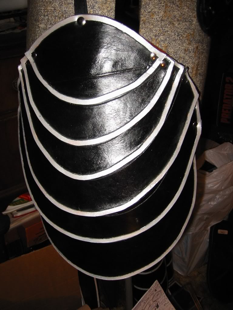

Then the thigh guards, they are backed with rust colored suede, over this is a layer of plain leather shaped to a curve to fit the thigh, then the crescentd shaped and overlapped on top. All three layers are rivetted. A strap goes around the leg, which is also rivetted.

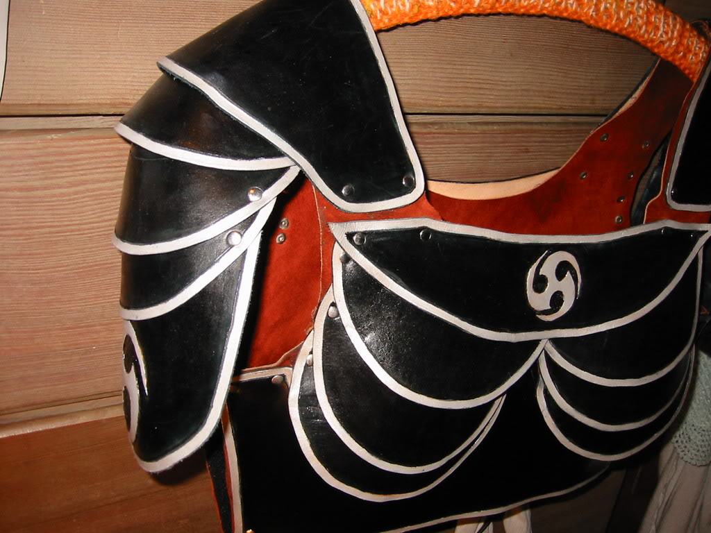

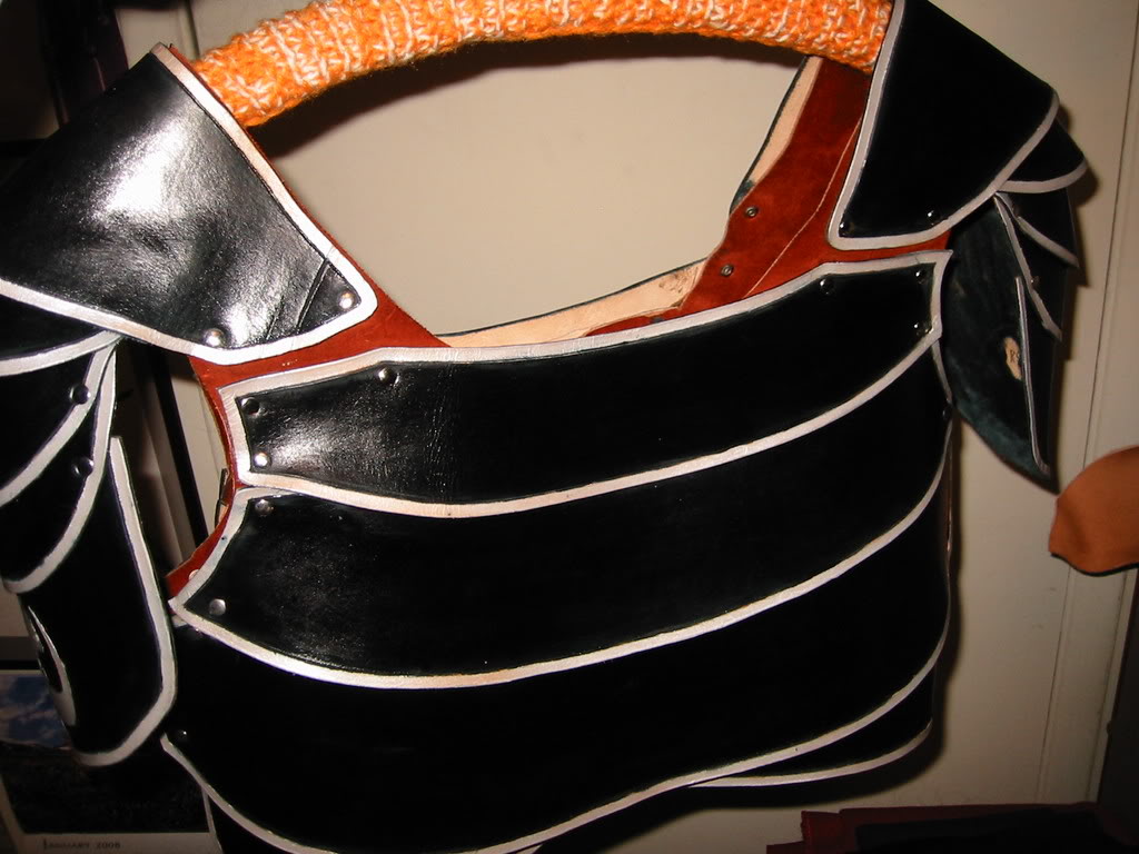

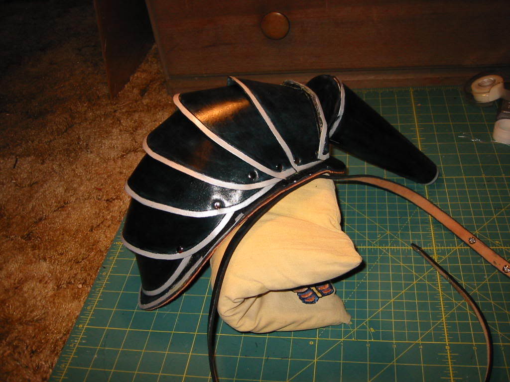

OK, more pix; here's the vest front and back, you can see the spaulder and pauldron:
the pieces are attached to a suede vest; it is sewn at the shoulders and left side, with a velcro closure at the right side.

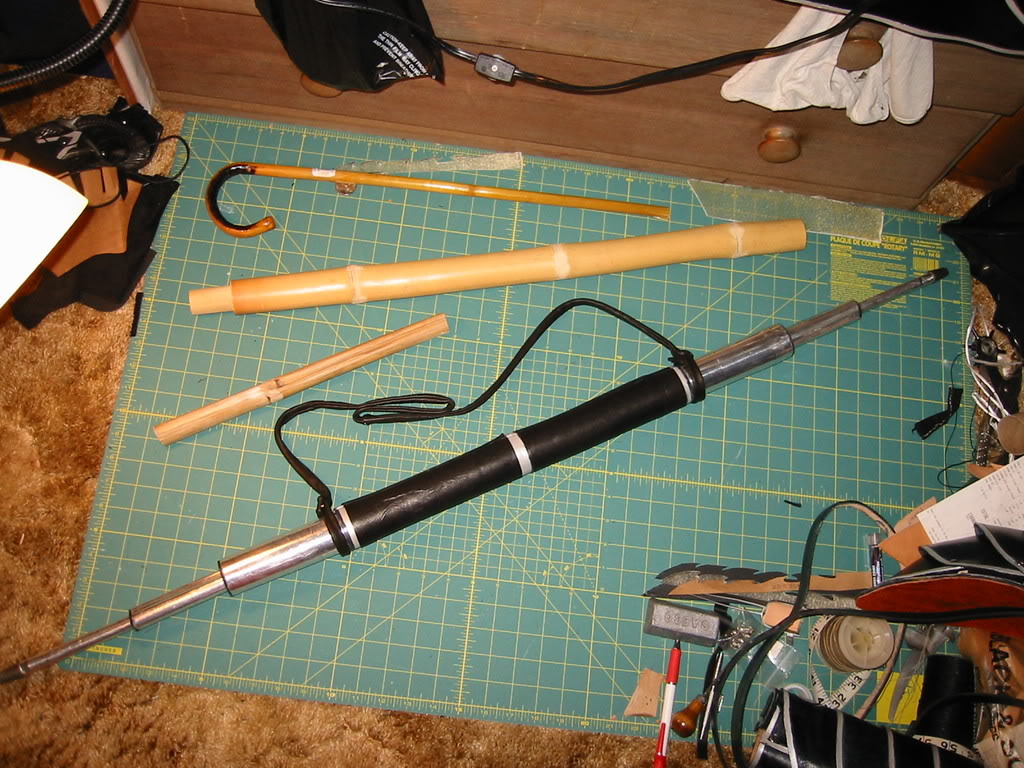

The combistick is made out of three sizes of bamboo that fit inside one another.
Largest piece is a limbo stick, the next largest is a broom stick, and the smallest is the straight part of a cane, cut so the metal tip is used.
The largest pieces' segments were drilled out then the smaller pieces cut so they stuck out some; inner washers and outer washers glued to the sections keep them from sliding out.
Each piece has silver tape on it, and the largest section is covered with leather for a grip.

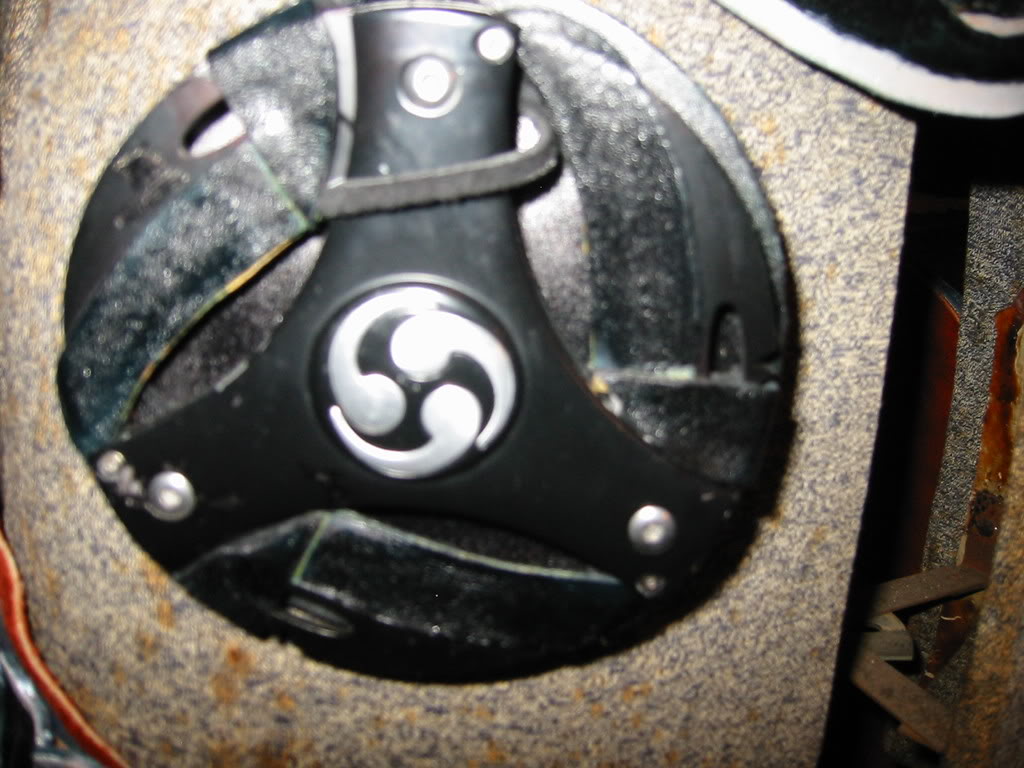

The shuriken is a three bladed knife I got at Frank & Sons Collectibles; no scabbard so I added the blade covers and made the holder with belt loop (apologies for the blurring; too close :p ):

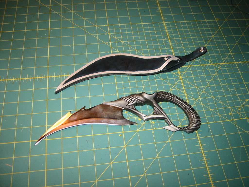

The belt knife I also got at Frank and Sons, it also didn't have a scabbard so I made that... the handle looks like a xeno face, head, and tail, so I said I GOTTA HAVE IT
