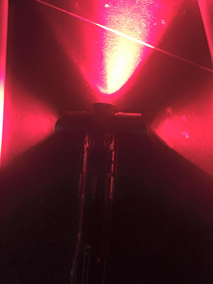

Boom! Did the upgrade to Luxeon tonight, CRAZY bright now, need to figure out the blade diffusion as it's a bit weak right now!
Use clear cellophane to diffuse the blade and make it more even, 6-10' should do the trick nicely. You can get a roll of clear gift wrap material at Michael's for $10 and you'll have plenty left over to do more blades in the future.

Yeah was planning on giving that a go today, do you just roll it tight and stick it in the blade?

Yes I use a skinny dowel rod to wrap the cellophane around then insert it into the blade and trim the excess length with an exacto knife I usually put a small bead of hot glue at the open end as well so that the cellophane can't just slide out, don't glue the actual cellophane in just put a bit of hot glue at the inside edge of the blade to act as a stop.
