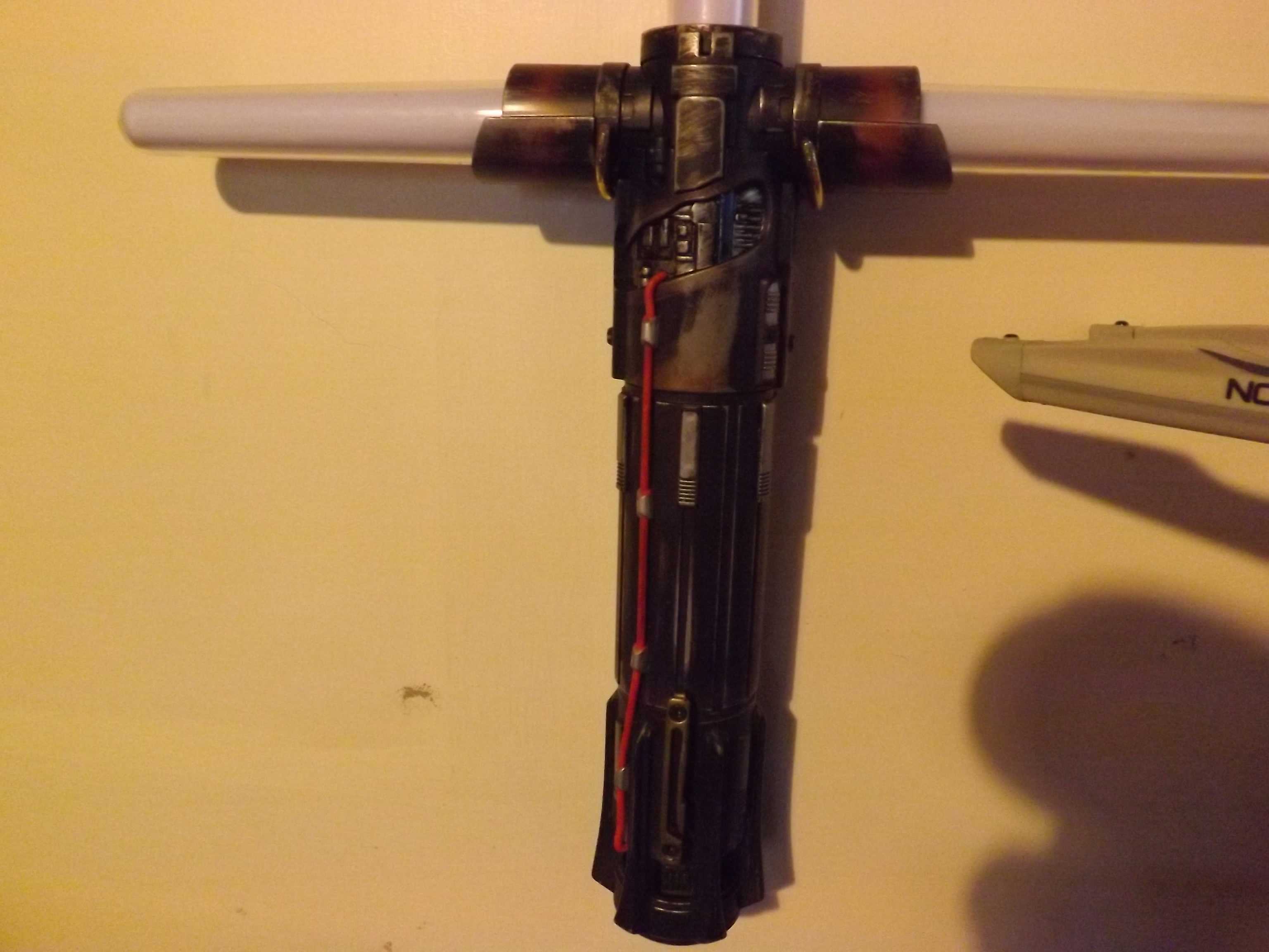

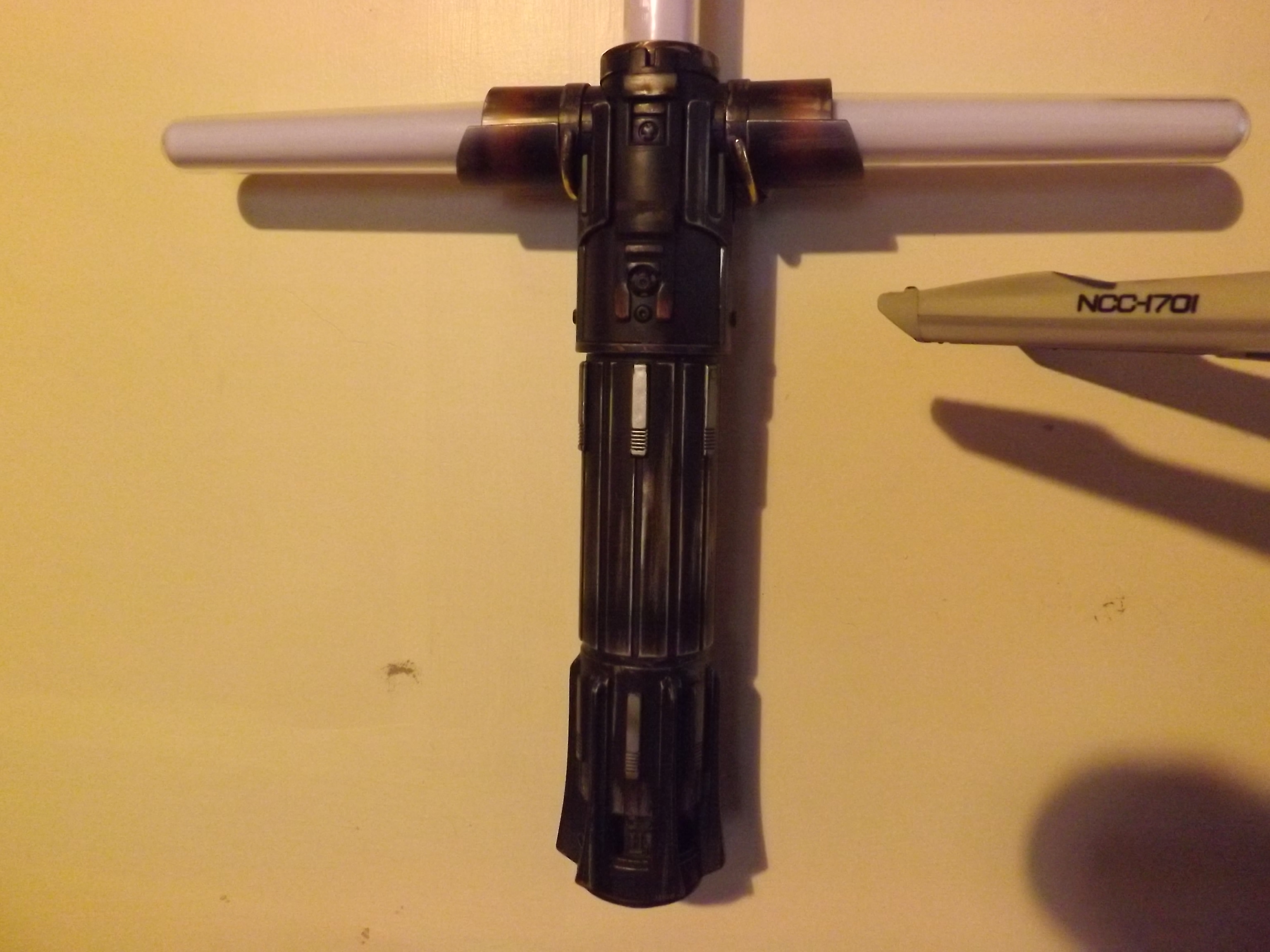

I really like my Force FX Kylo saber......yes, it's a little bit big, yes, the quillons are a bit stumpy, but i feel it captures the screen saber really well.
RichView attachment 592780View attachment 592780View attachment 592781
