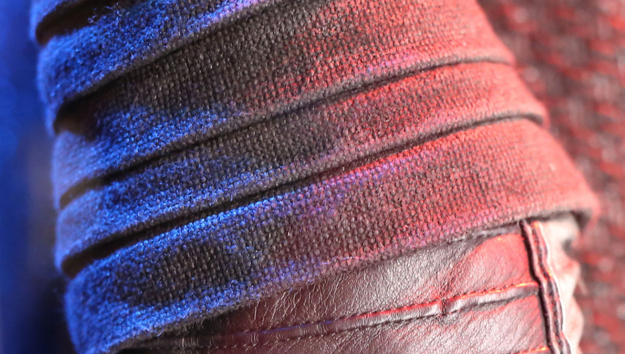

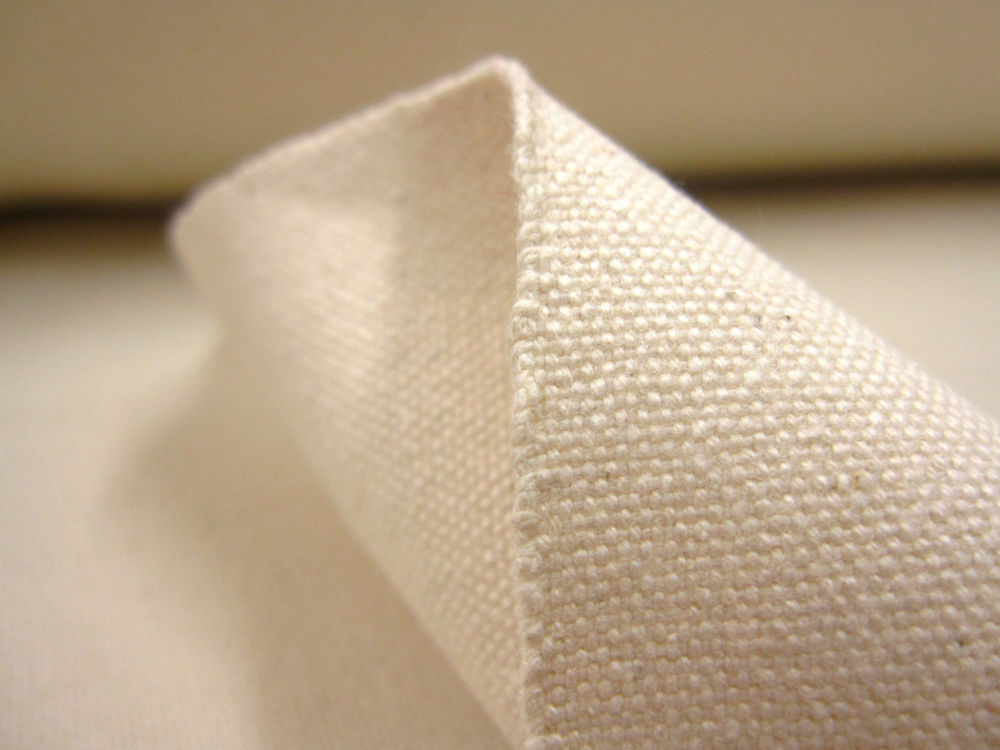

hey guys i think i tracked down the correct sleev fabric today
Cotton Duck Canvas
the weave is consistent with the Exhibit and i know duck canvas to wear sin a similar fashion and go a shade lighter under wear (as seen on the edges of the pleats where the shading is slightly lighter
i have four weights on order as a sample 10, 12, 16 and 21 oz
I'll let you know how they feel when they arrive:
Image is to show the weave only (correct is obviously black)
This seems accurate. The display had it a bit worn, Maybe weather it a bit by ironing and light sanding? Following your threads religiously
Yes it's waxed afterwards BTW. It's done after the sleeves are made :)

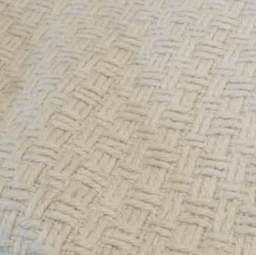

this is certainly not the right fabric yet (wrong weave 3/2) but it's certainly close just awaiting a sample! it has the right interfacing layer from the looks just needs to loose one weft thread haha (which i may just pull out from this if it works hahaha)
For those of us on a budget for the first costume revision, if dyed, would this be alright though for non-upclose looks? Do you remember where you found the fabric by chance??
