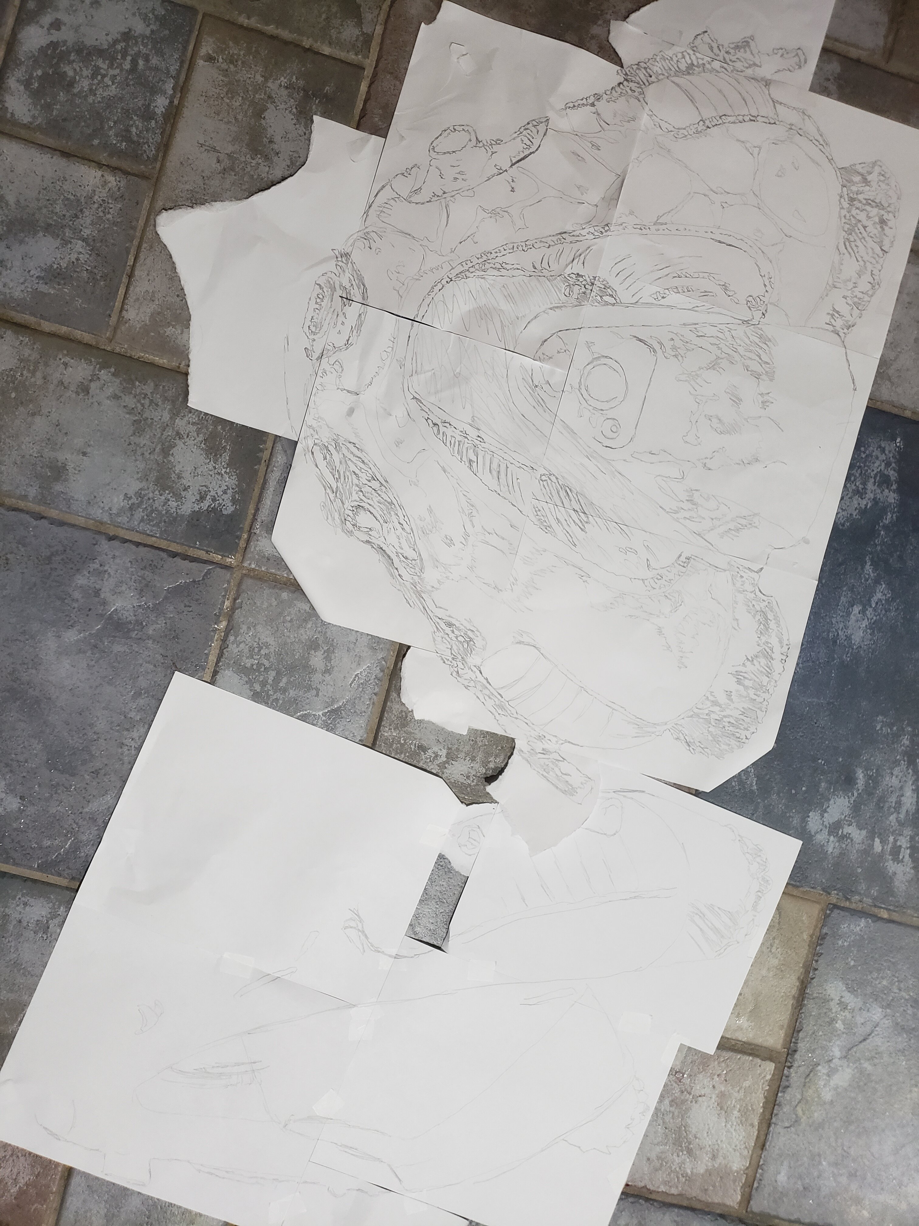

Start off with lotsa reference pics and I made a designation of partnames
Next, I took pics with humans and used the reference of their face and body parts vs mine to enlarge that pic on a tv screen.
Next, place paper on the tv and trace out two pics, front and side view for reference.
I used lotsa FreeForm AIr. I covered reference tracings with plastic wrap and then placed FreeFormAir within the dimensions.

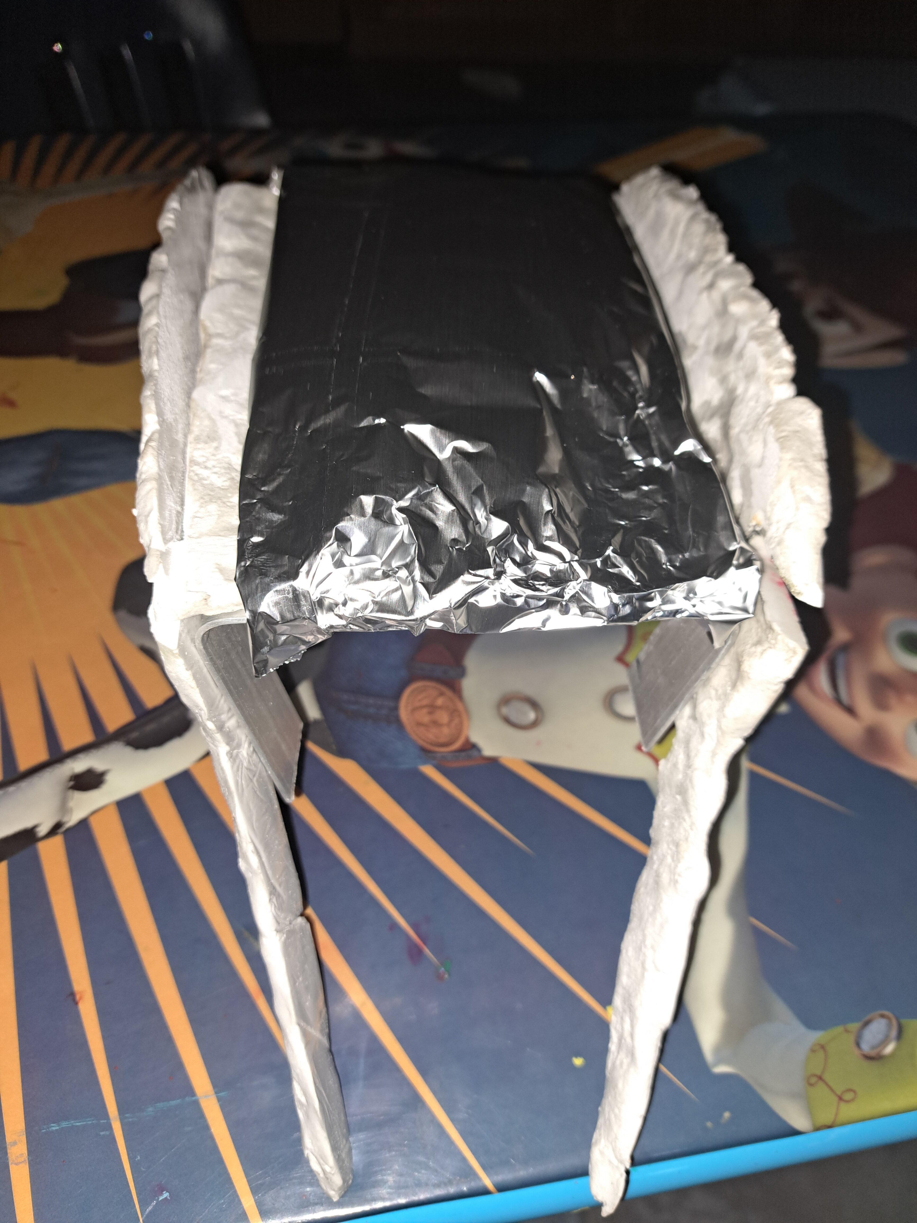

So, file down tabs on the side/profile pieces and use the correct length and width pieces to make da basic hed
Since each side/profile piece seems to come down at a 70 degree angle, I bent a 0.06 piece of aluminum to hold them at the proper angle.
Why the aluminum foil?
Well, it helps make a foundation to keep the FreeForm Air from drooping. Since I have the side curve from the profile and I have a good front-to-back view, I can get the curves right.
Gloop on dat FreeFrorm Air!

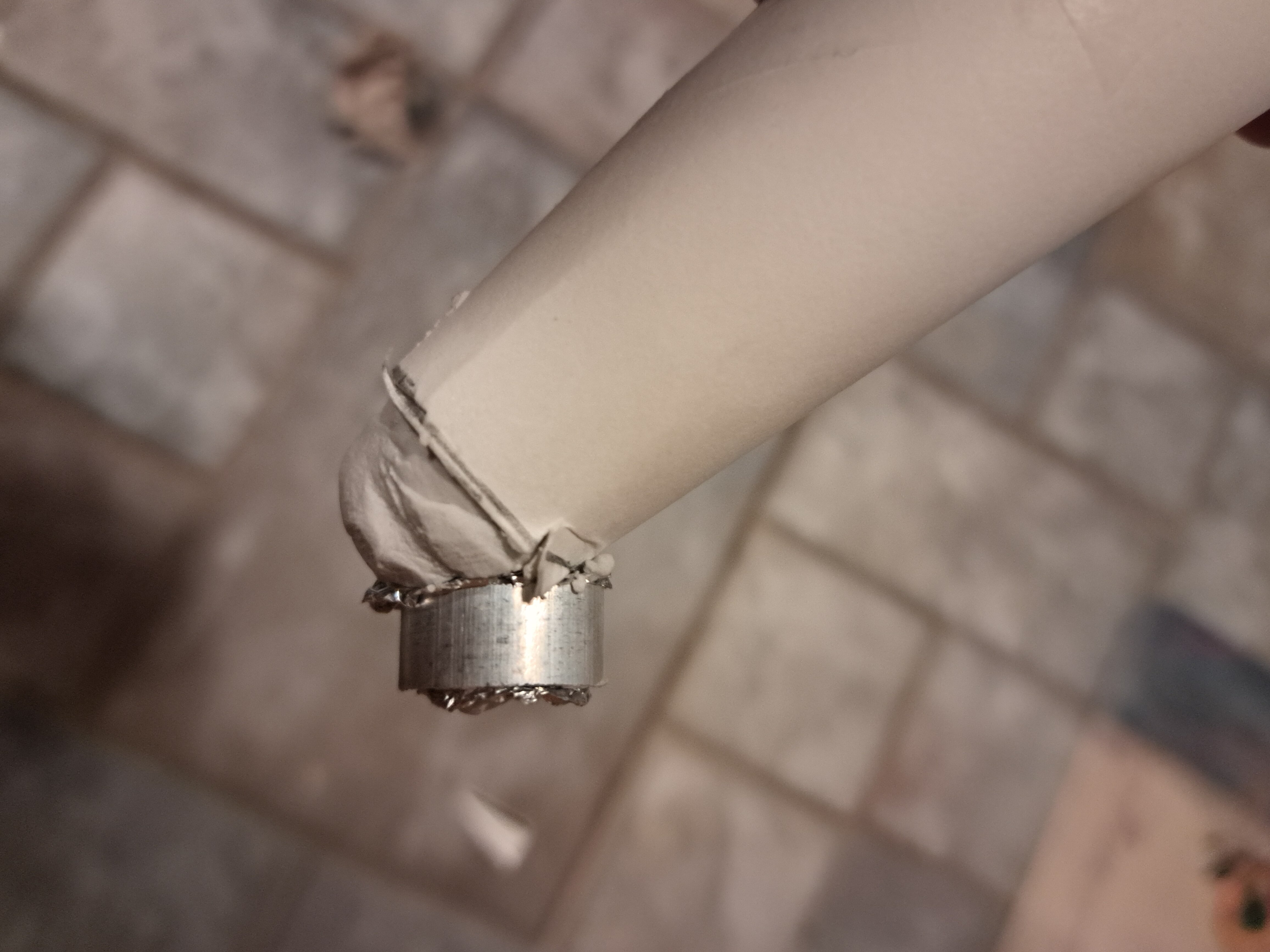

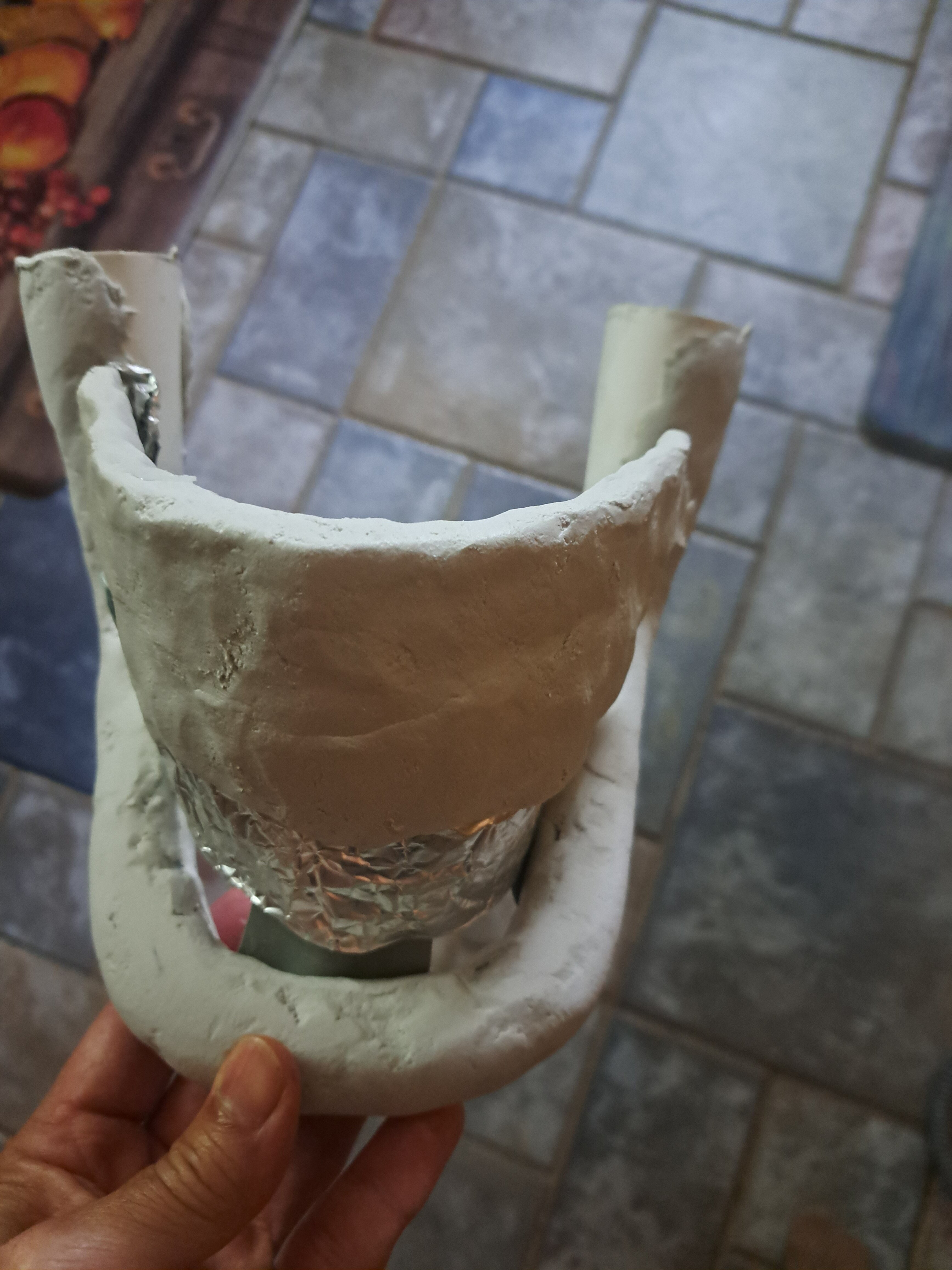

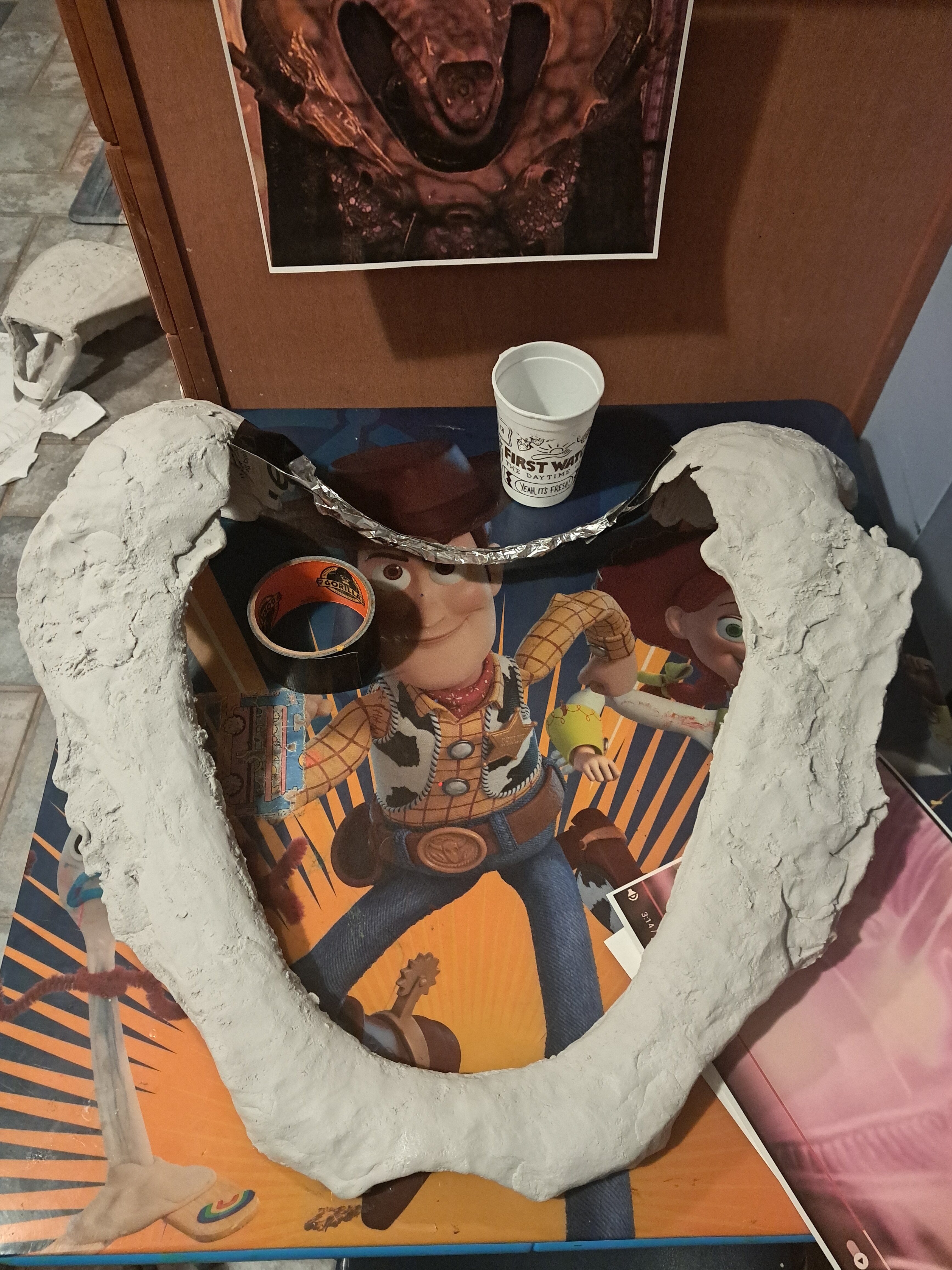

For the mandible part, I started with a pipe, not realizing I totally underestimated the diameter of the mandible, I also had in my head that the horizontal top part of the mandible was an expanding, horn-like shape. So, I cut a pipe 3/4 of the way through and then coated in --YOU GUESSED IT-- FreeForm Air. The trumpet's diameter, I rolled up paper and used a circle template to get the size and taper I wanted.
The ends of the trumpet I covered in aluminum foil then put them in parts of the reference pipe, that way, when it hardens, it will fit perfectly into the pipe I used for the lower part of front of the mandible.

So, the cones with FreeForm Air stuffed into foil-covered pipes created nice interlocking system for the cones to the U shaped part of the mandible.

Sculpting the rest of the mandible
