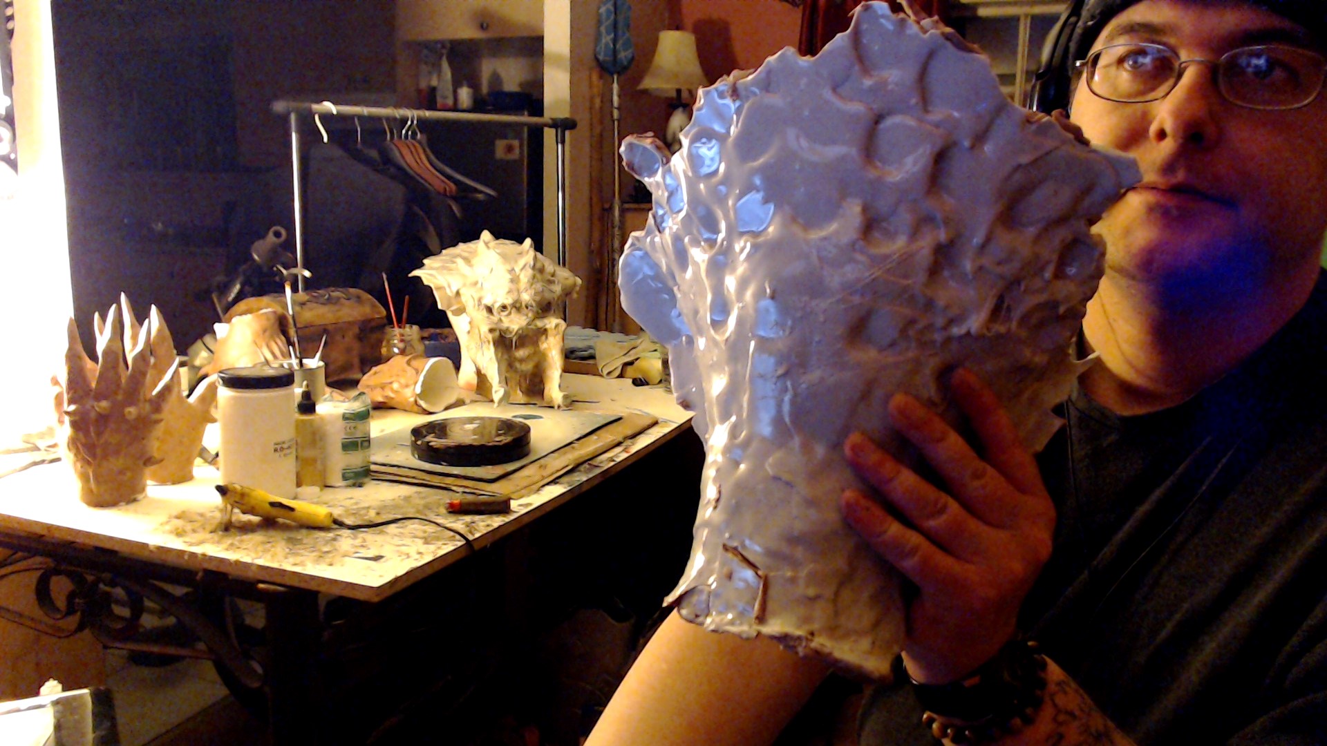

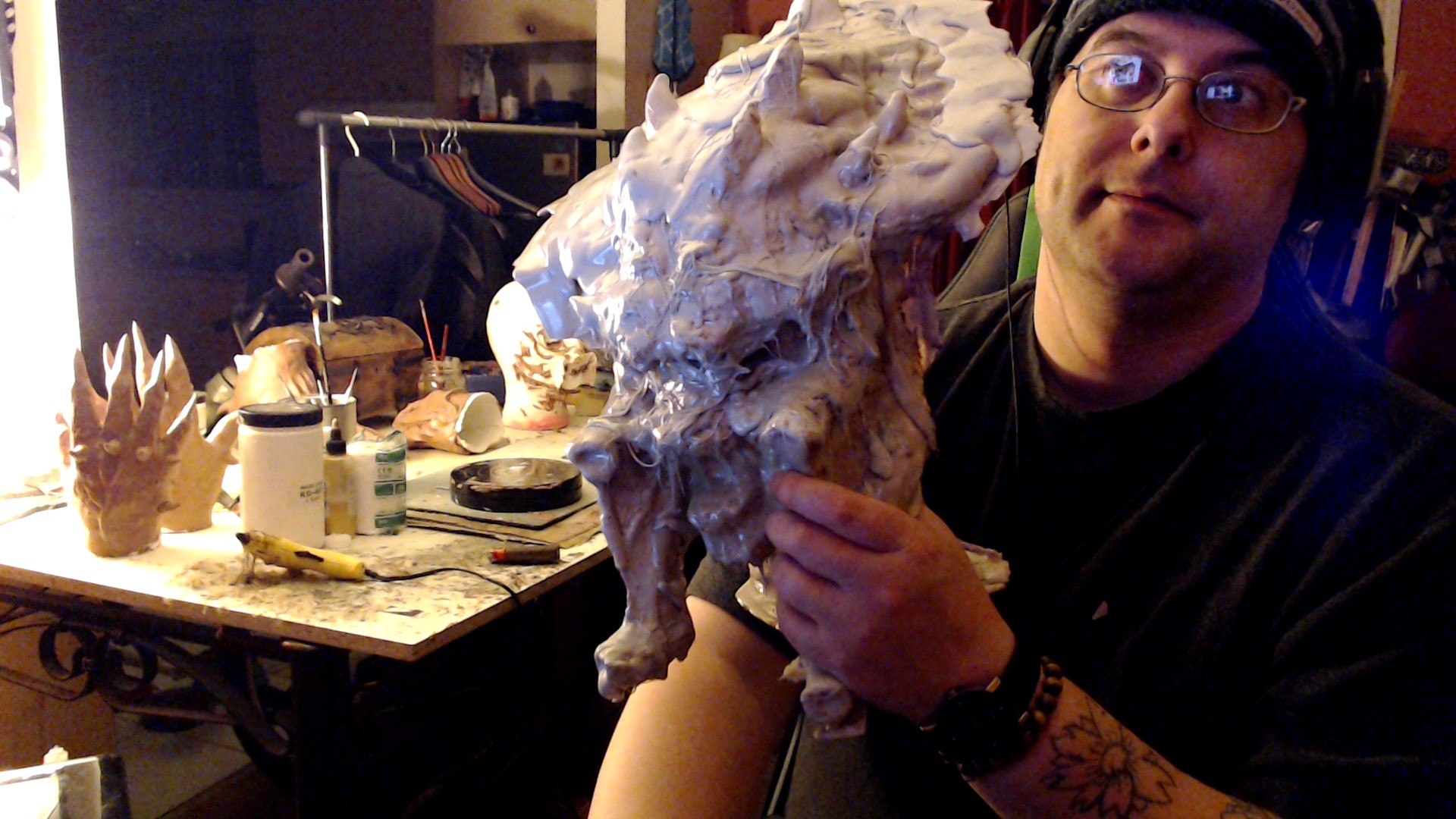

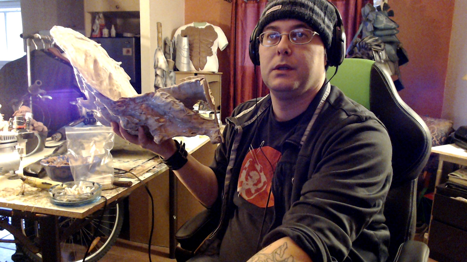

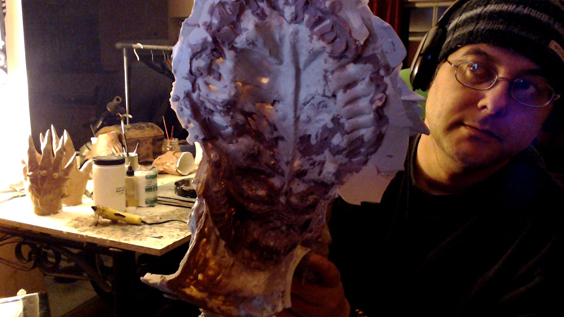

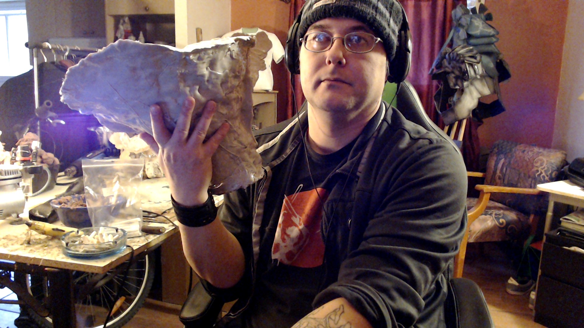

Well yay, i succeed at making my first polyurethane Mold of Predator....I STILL HAVE MAJOR repairs to do on the back of the mold but we can say it is a success!!! Oh and yes remove the left over monster clay ;)
Great job shogun!
Btw if the back of your head mold ended up broke or with too many problems I have a little tip.
On my very first mold, I made the back to thin and it shattered. Made a pull from the front part that was still in tact, and hot glued upholstery foam to it in the shape of the back of a Predator head. Covered that in latex and made x-cuts for the dreads, painted it, and it worked out well :)

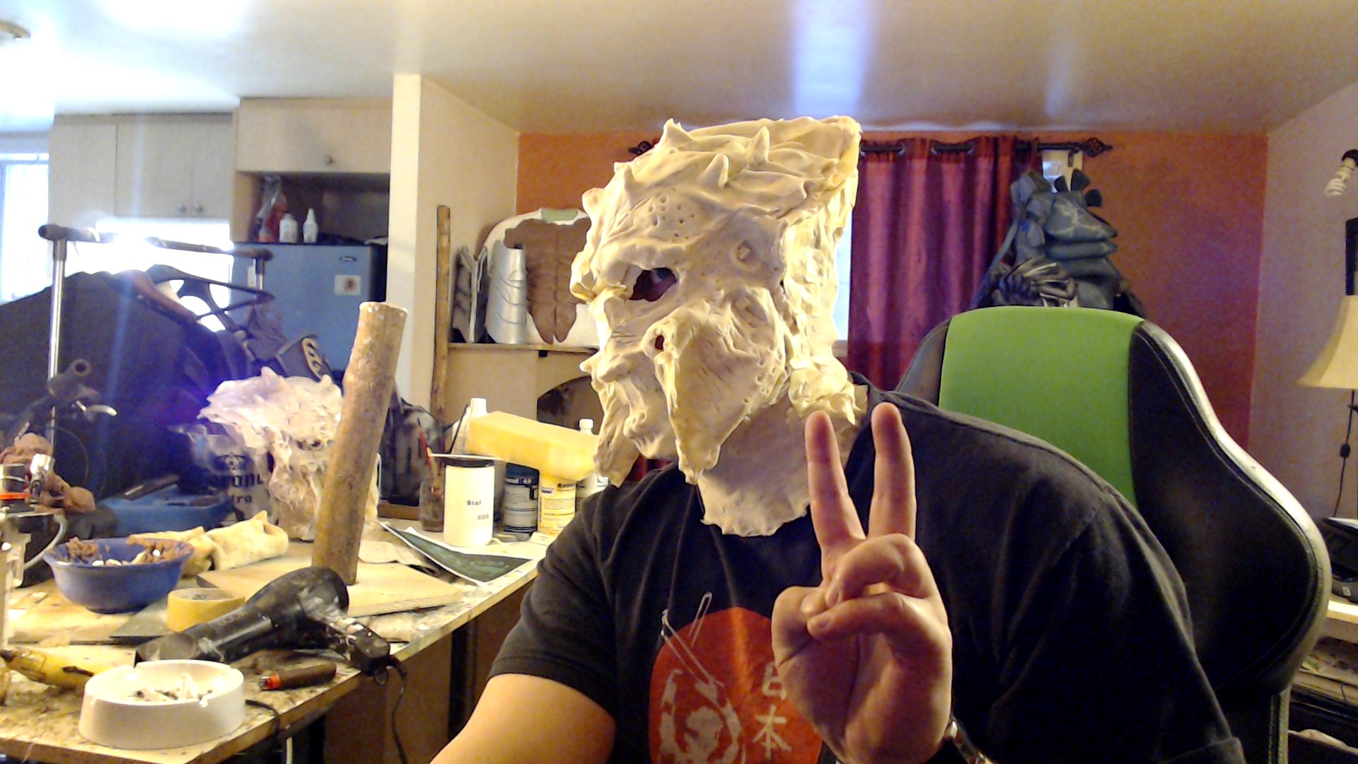

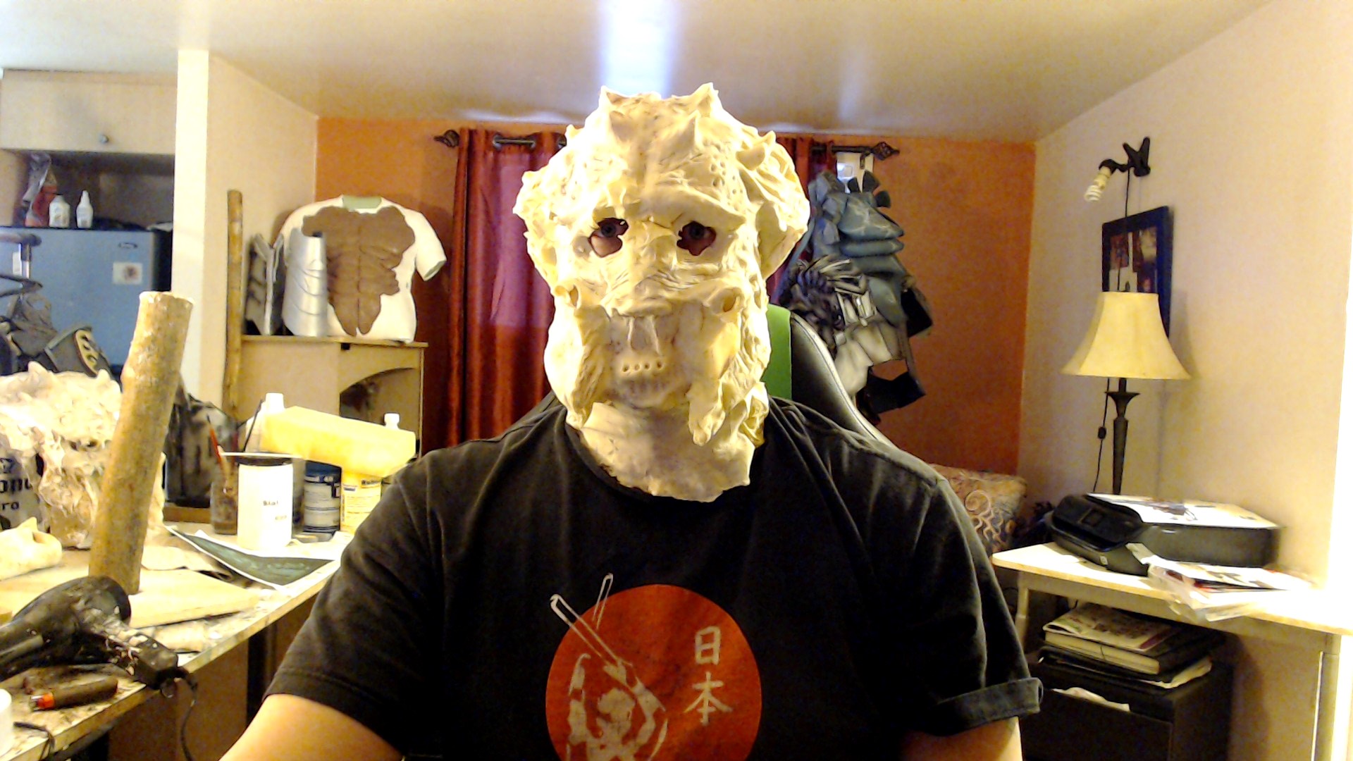

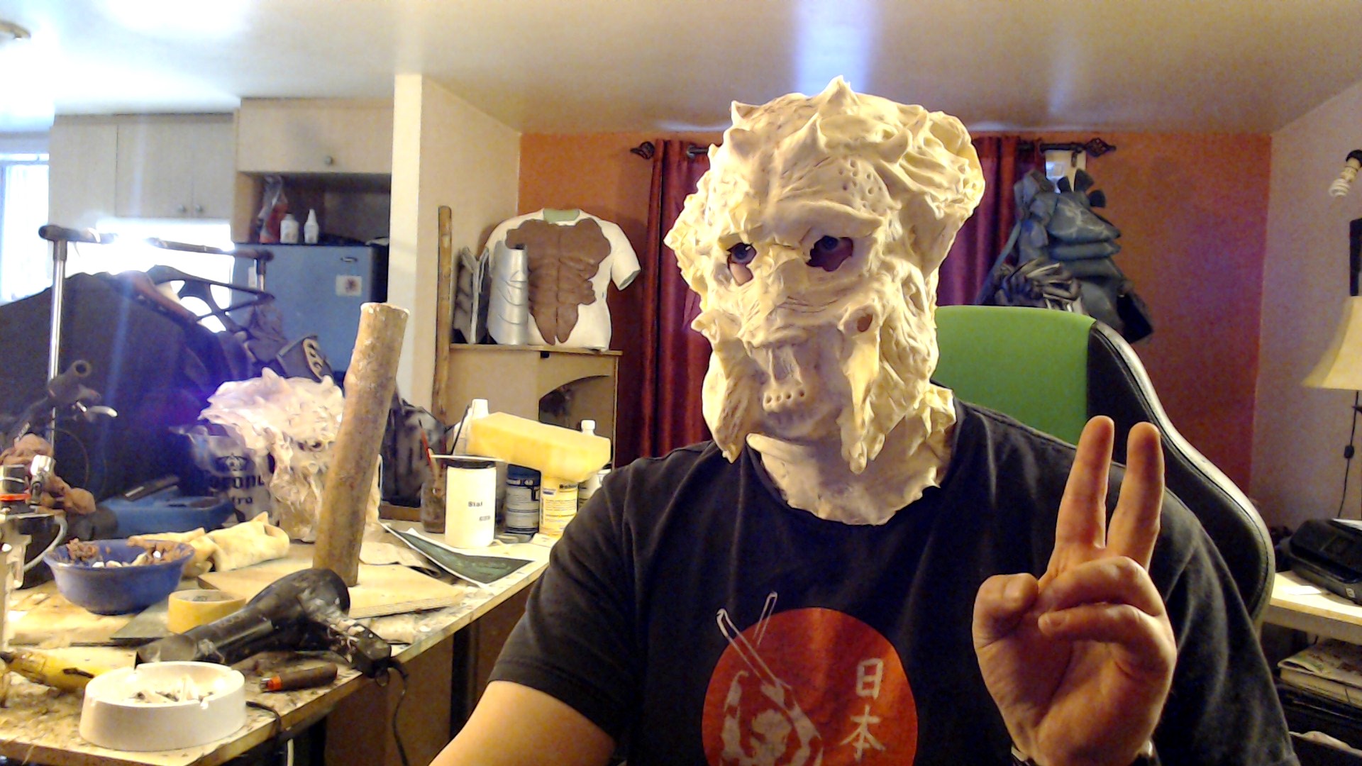

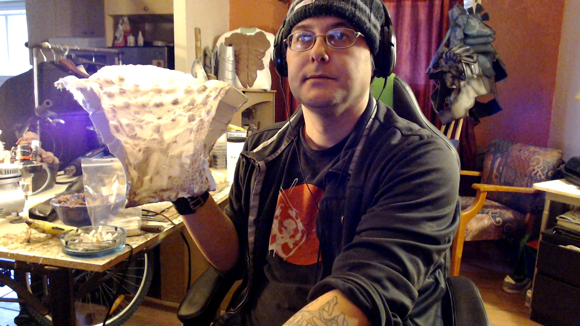

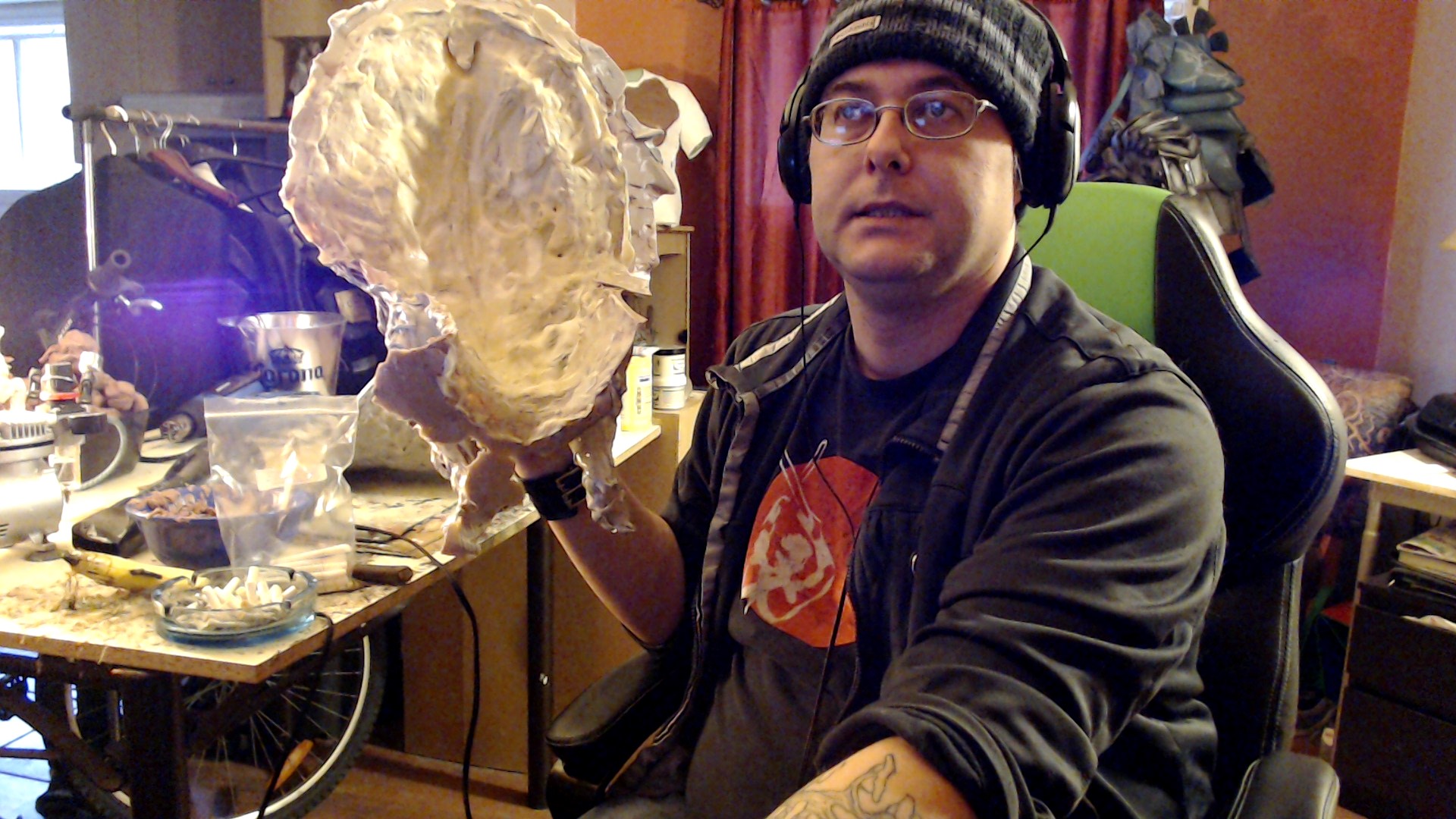

OK well I had a deception tonight because of my impatience .....85 % of the seam of my mask did not cured and I removed the mask from the mold too quickly....I also did not put mold release agents. Another problem was that I lacked of Latex.... so I puted some tape temporarily until I repair it with Contact glue..... or super glue. I also need to fill the mask with memory foam once i get it repaired.... I am NOT a mask specialist as you can see....
