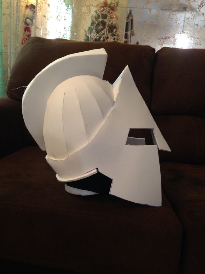

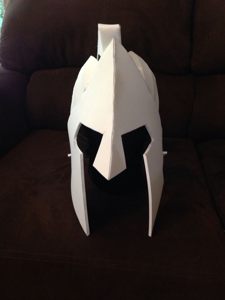

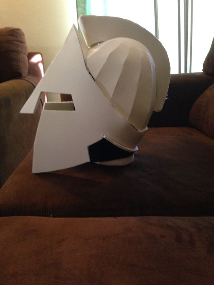

I resolved the problem lol i was placing the parts upsidedown since am not used to making armor with one piece parts. Just glueing part by part. Thanks for the help though both of you. Well i didnt finished it because i didnt want to bother since the dome is funny looking and the mohawk will not look good, the helmet is a complete mess but it will look good on my desk lol. I didnt even bother scaling it either so its tremendously huge. But failing at this helmet made me understand a hole lot on how you guys pull this off. I guess ill have to try again then lol. 1499532_10153661388065002_1494164385_n.jpg1479095_10153661388055002_1796768684_n.jpg1504109_10153661388060002_2138557961_n.jpg

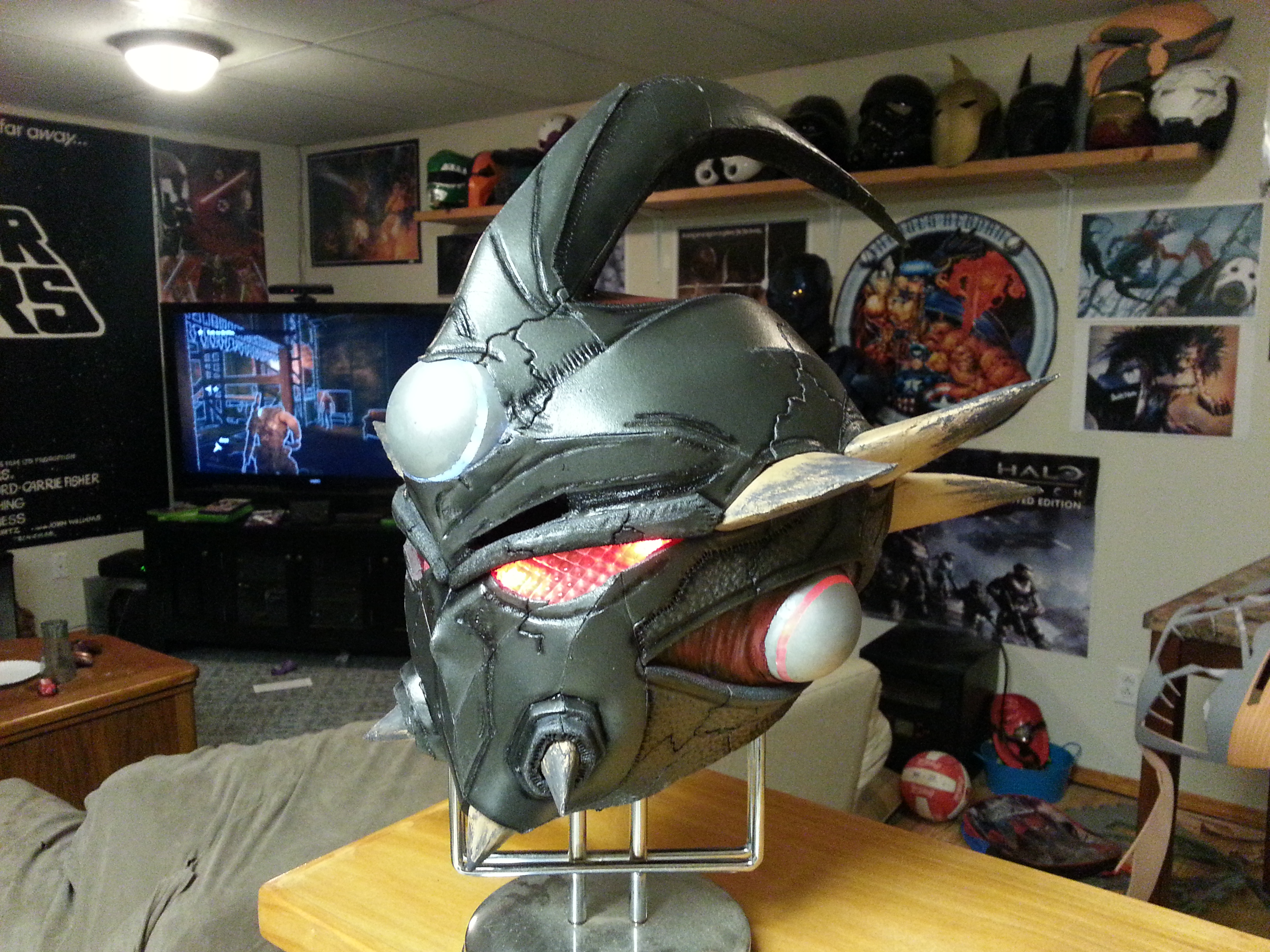

If you are talking about the Guvyer 3 - I used 477 for the height and it fits like a glove.... literally... not a lot of room to breathe if you are claustrophobic. I was surprised with the width but when you throw it on it's a very snug fit front to back and I have a small/medium head.

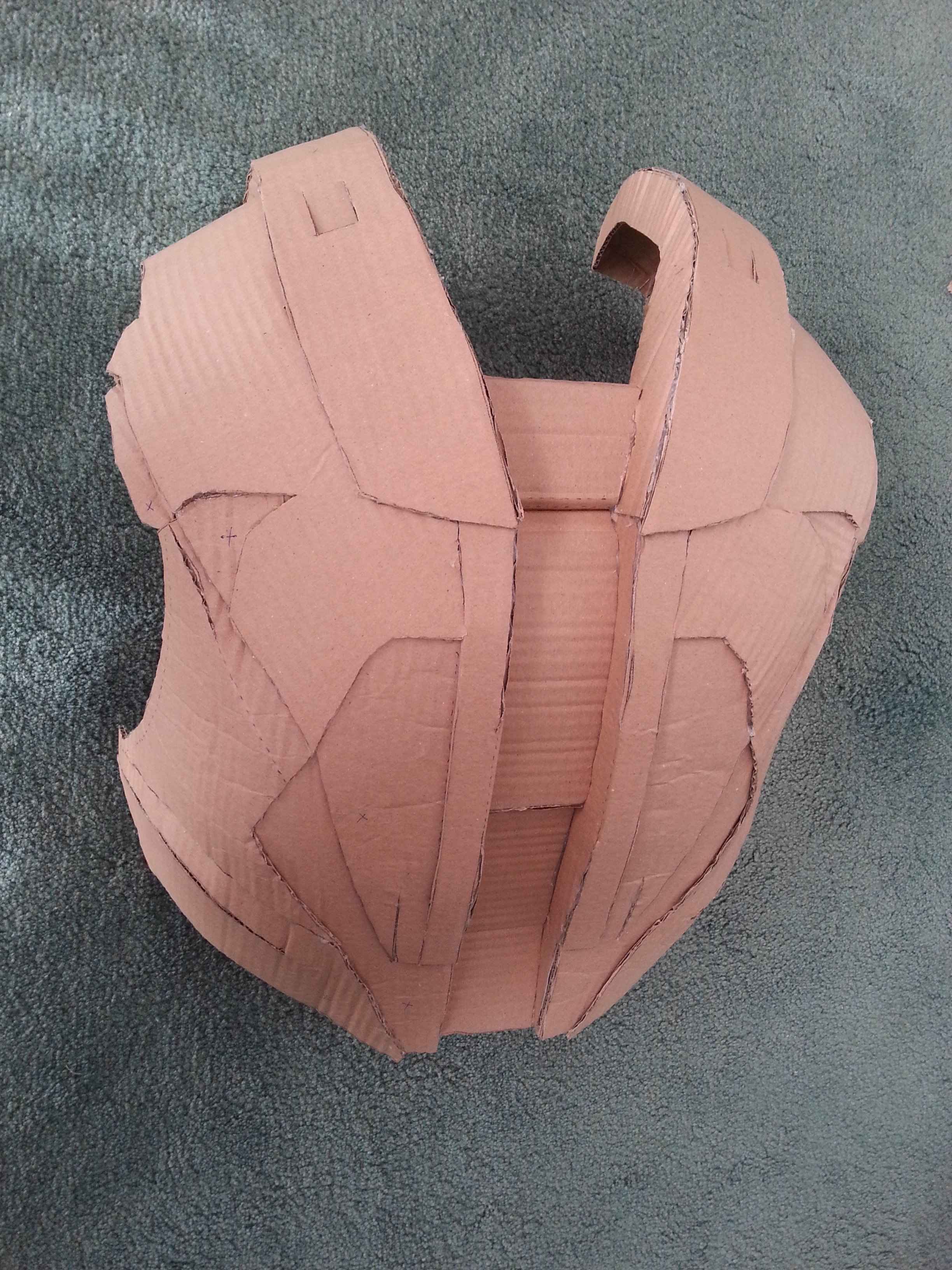

ok, after a couple bicep failure on my mark VII, I put him aside and started JF's mark IV foam unfold using cardboard.
Much easier to work with, needs some layers to make the exact gaps but its sweet !
