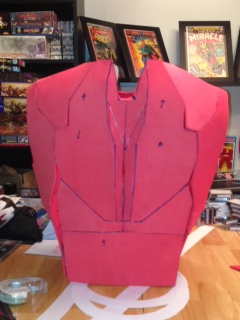

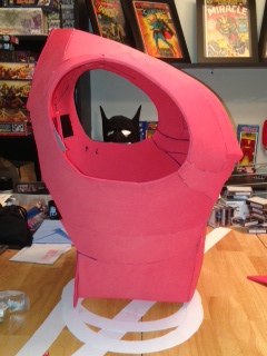

Had a bit of a set back last night got the abs (which by the way look awesome using these files :D) and the cod piece done but connecting what I have together with tape I now relise I've made the chest and back to small :( the abs would sit in chest piece properly !!! grrrrr lol so will have to rebuild the chest and back tonight.
Perhaps I should start with the chest on my builds better to do the cod piece and the abs first huh

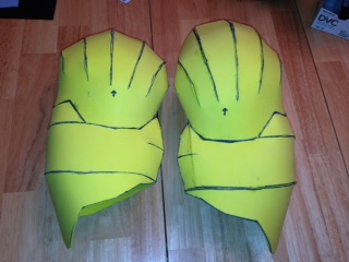

finished JF'sCap helm, learnt a lot, glueing is getting better, made this from 2mm foam as it's what I had available and it was more an excercise rather than for actually using or wearing
gonna do the IP helmet next, in 6mm

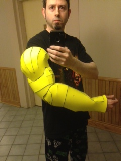

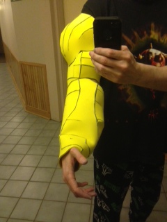

Heya guys. Here is my WIP of the classic Iron Man build. These peps were originally Eye of Saurons but JF was kind enough to start converting them for foam ( and I begged a lot). Im a big fan of the classic build and nobody was doing it. The files are not complete. JF is a very busy man and I am waiting patiently for the rest. He was kind enough to convert the ones I have. Let me know what you think and let JF know. Or if someone would like to help tackle the project that would rock too. The Legs, Boots and Side pods still have yet to be done. Let me know what you think. Its my first foam project so be kind. :) And as always thanks JF. classic iron man arm 2.JPGclassic iron man arm 1.JPGiron man bicep 2.JPGiron man chest 1.JPGiron man chestplate back.JPGchestplate 2.JPG
