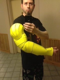

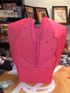

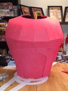

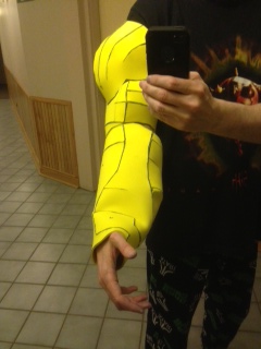

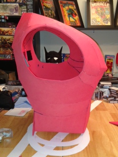

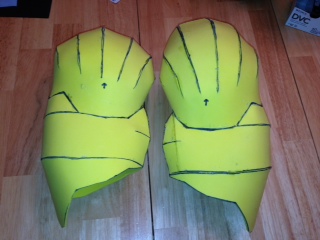

Heya guys. Here is my WIP of the classic Iron Man build. These peps were originally Eye of Saurons but JF was kind enough to start converting them for foam ( and I begged a lot). Im a big fan of the classic build and nobody was doing it. The files are not complete. JF is a very busy man and I am waiting patiently for the rest. He was kind enough to convert the ones I have. Let me know what you think and let JF know. Or if someone would like to help tackle the project that would rock too. The Legs, Boots and Side pods still have yet to be done. Let me know what you think. Its my first foam project so be kind. :) And as always thanks JF. View attachment 183527View attachment 183528View attachment 183529View attachment 183530View attachment 183531View attachment 183533
I've actually got the chest and abs of this build done! but i'm doing it in paper! still looks awesome man!
