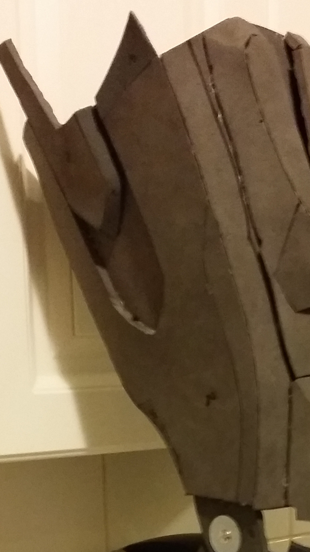

This is my second Arkham attempt. I have always wanted a Reevesfx version but I be poor. So I used JFcustom's hills and valleys trick under the foam to add some details to the cowl.
Just cut a piece of foam big enough to cover that space snd glue it to the insideI have a few questions. I am building a foam Iron Man Mark VII using JFcustom's unfold of Darkside501st's files. On the thigh, there is a piece that is not shown on the template.
