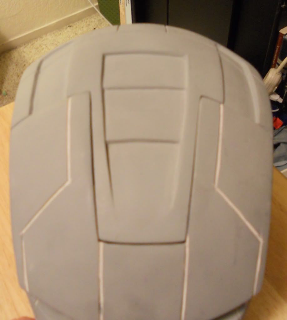

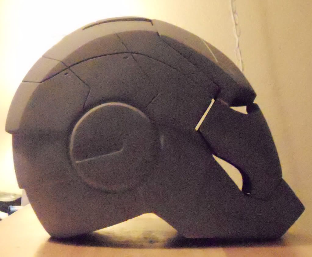

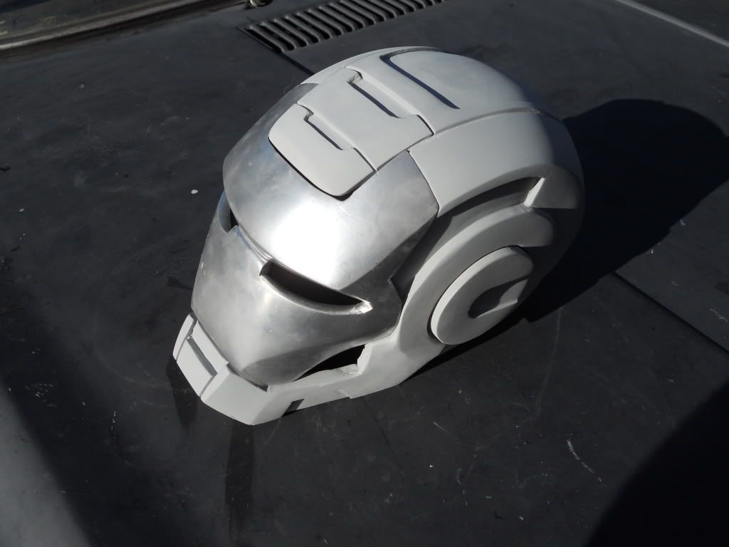

So here is the new styled helmet. Spent a lot of time detailing it and adding more "movie accurate" details.
Also have been working on a new hinge system.. Heres a pic of the prototypes

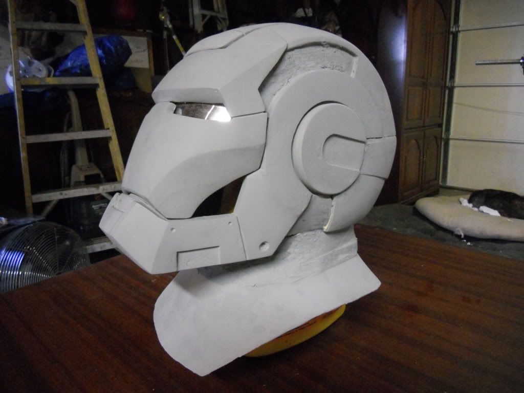

Small update.
First pull of the new mold.

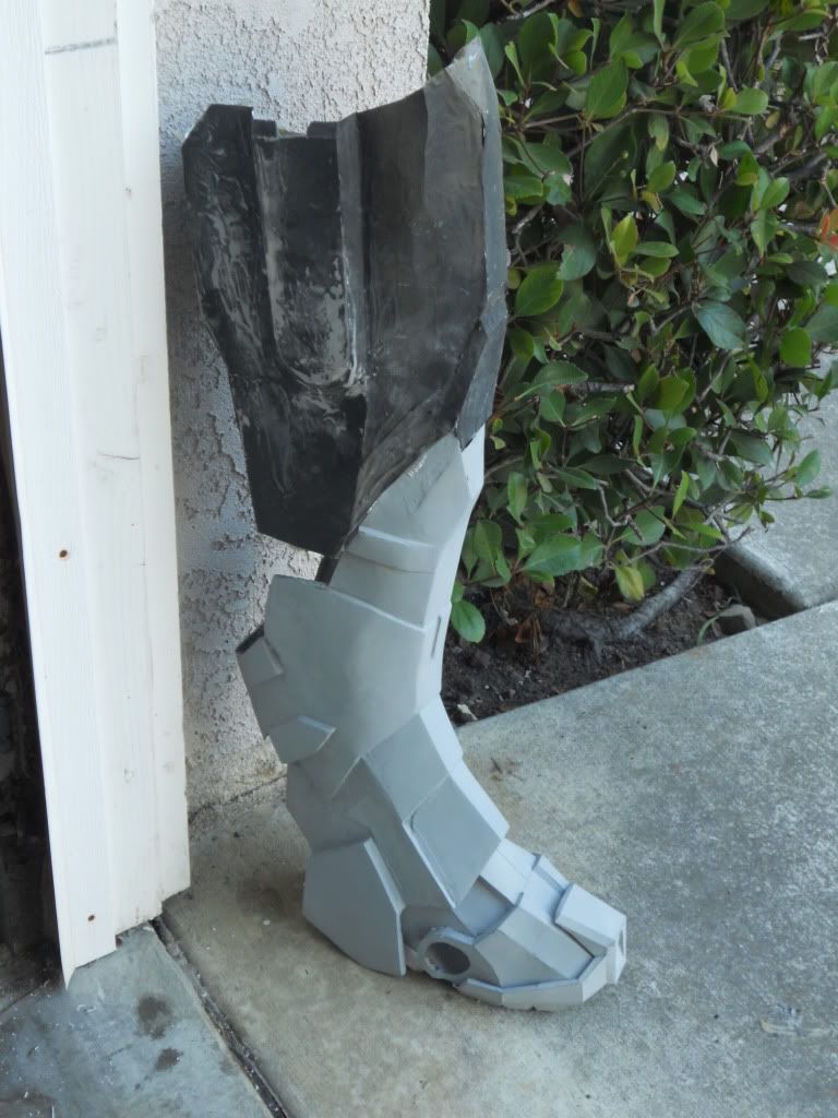

Quick Update!
Right leg is almost done.
Im using Juice's pep files (unfold by Dubean/Bimmer)
Shoes are Robo's
I started glassing the rest of the pep armor I've got. Cod piece is due for a glassing tonight and the forearms. Then I have to start detailing it.. :lol

Okay new helmet to show off. :lol:
Pretty close to accurate, but if you can see anything that needs to be changed please let me know! Critiques are more then welcome!!!
I think I've got the faceplate animation like the move figured out. It would involve a pack of linear actuators in a pack located right below the shoulder line and an aluminum cast faceplate. More details on that as I develop them.

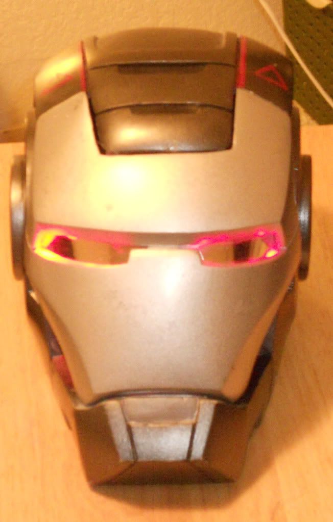

Re: JAM Designs War Machine: Peppers ghost eye lighting
So I've been hella busy recently and to boot my laptop gave up the ghost. Hence the occasional postings that I've done on from my PSP. Worse then trying to text message I tell ya!
Anyways, I decided to try and work on the lighting for the eyes..
Thats only 6 Super Bright LEDS, and you can see through it!
I need to add some plastic to diffuse the lights from the LEDs.
The battery is in the chin and currently wired to contact points in the jaw so that when the faceplate closes the lights come on. I wanna eventually use the MagSafe connectors that they use on the mac laptops.
I'm using the "peppers ghost" lighting and vision effect. Since the lighting on the outside of the reflective film is brighter all you see is the reflection from the LEDS on the outside, thus allowing you to see through it from inside the darkened helmet. I'll try and post some pics of the inside of the faceplate when I get a chance to again...

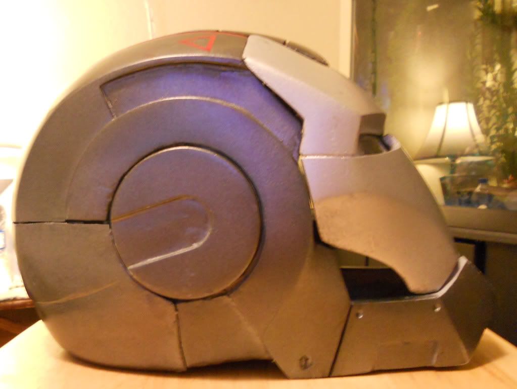

Here are some updated pics of the helmet! Sorry its a bit scuffed as it got used over the weekend.
