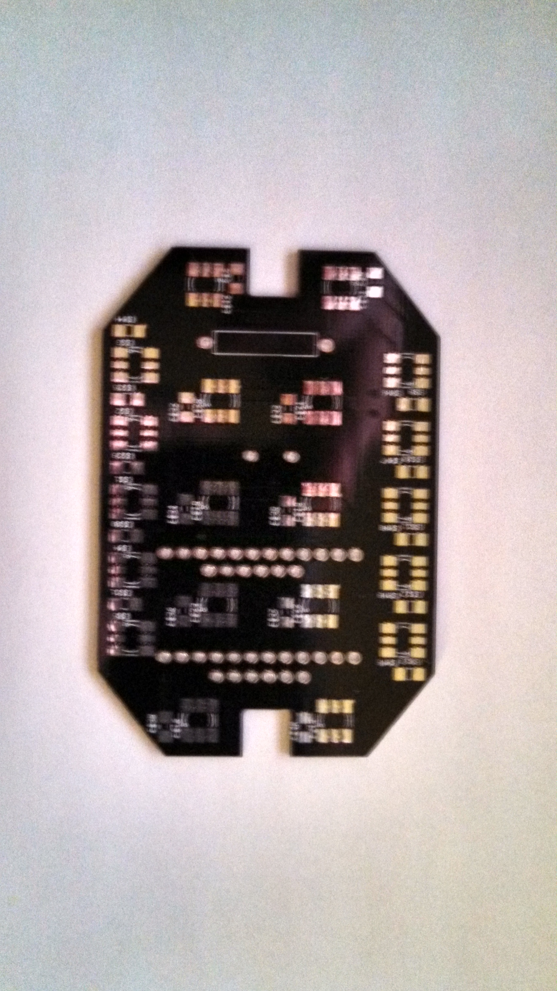

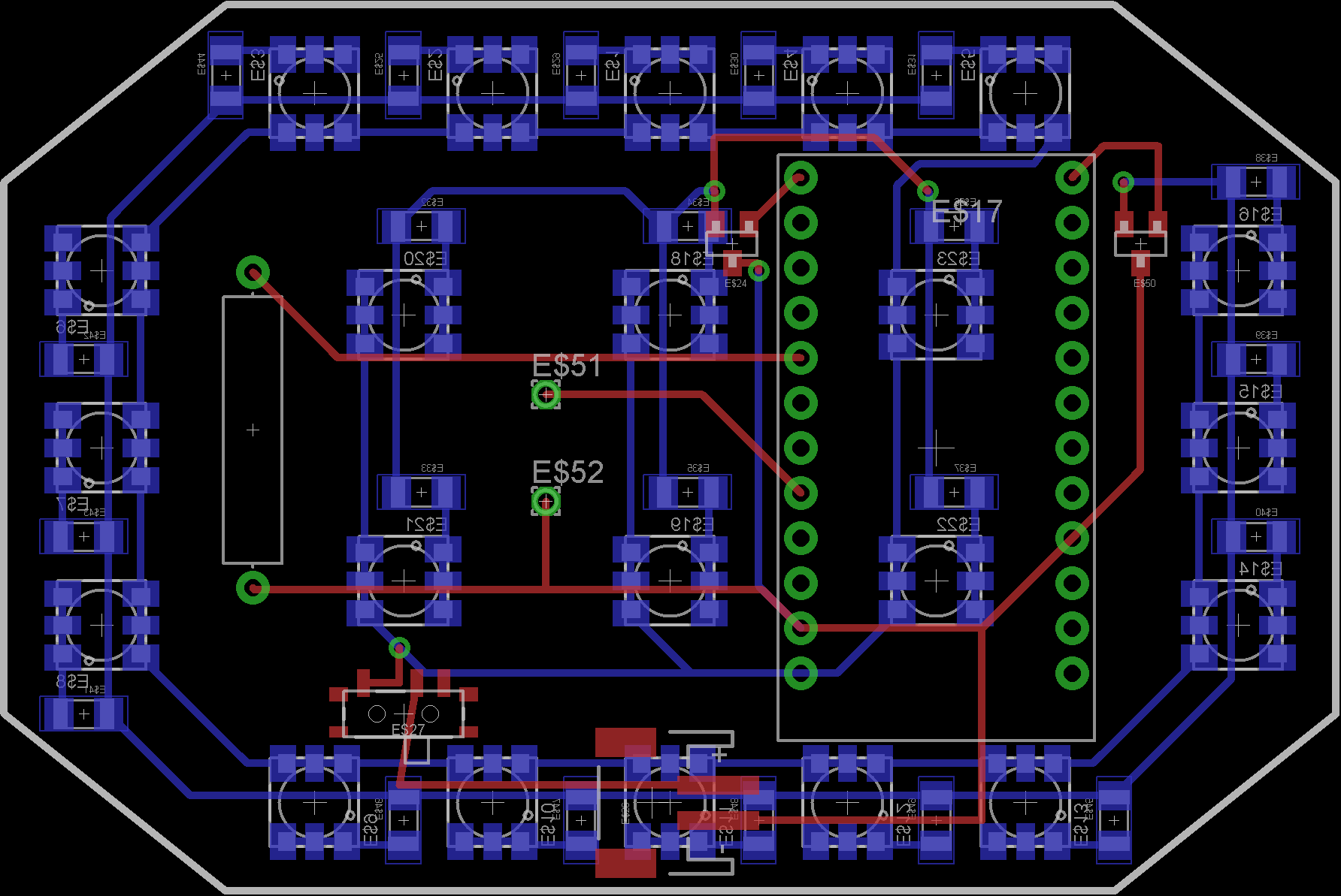

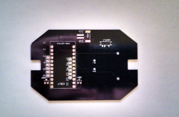

For starters, and just a little tease for everyone here, myself and therealstark had designed a board for the arc reactor in the IP suit. It is just like all the others ones that he had made for the Warmachine 2.0 Arc Reactor, but with some revisions on it. Here are some pics of the board. All in all it the electronics to put on the custom board is under $50. After i make the first one, and if all goes well. i will make these on demand for who ever wants one. Since i finally finished up school this week, and my next Bachelor's degree im going for is all online, i will have bookoo time to put into this IP MKII of mine. Anyway, enough rambling, here are the pics.
Arc Reactor diagram.JPGArcReactorBoard.pngIMG_20130928_213944_328.jpgCapture.PNG
One of the cool features in this bad boy is a UniBeam blast. I know that IP in the IM3 movie did not use it, and we don't even know if he has this ability, but i put it in there to use. The read strip that detects a magnet to set it off is detachable. Meaning, you can externally wire the read strip to be accessible from anywhere in the suit making it easier and customizable to use. My idea was to have it mounted within the glove, then all i have to do is press a magnet on my finger to the tip of one of the fingers in the glove, and boom.
There is another way to go, and i just might do it. Sparkfun has a new product that uses sensors that detect impulse from the human body. This can be used to place sensors on the back, and then when you flex your back muscles to push out your chest, it would trigger the UniBeam to fire. Just a thought.

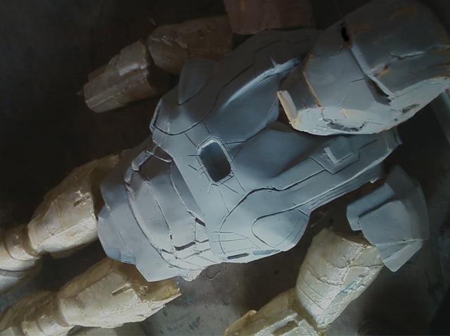

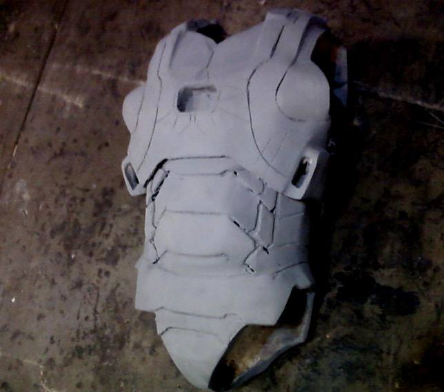

I am getting close to completing this. my goal is to have it finished by Halloween. although, I am running into a few problems.
Helmet : im lost on how to get the faceplate hinged right. is the hinge the same for an iron man helmet ? it looks like the opening angle needs to be different.
Torso: Complete, just need to finish some detail work and paint
Abs and Cod Piece: its a tight fit, I can barely squeeze into it, but once im in, it fits. so im thinking about cutting it in half and doing a hinge latch set up. (which I did a hinge latch set up on the torso.) another thought is just to remake this piece out of foam for more flexibility. not sure.
Shoulders: Done, just need more sanding paint and mount to the torso
Biceps: They seem to big, they wont fit into the shoulder pieces. so I am going to remake these out of foam. using foam for these since I have done other armor and the biceps always want to seem to slide down even with foam. foam will make thim lighter and have a better fit.
Elbows: just need to sand and paint
Forearms: Done, just need paint
Thighs: need to apply bodyfiller, sand, paint

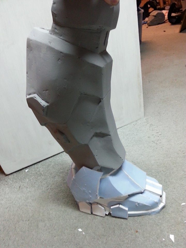

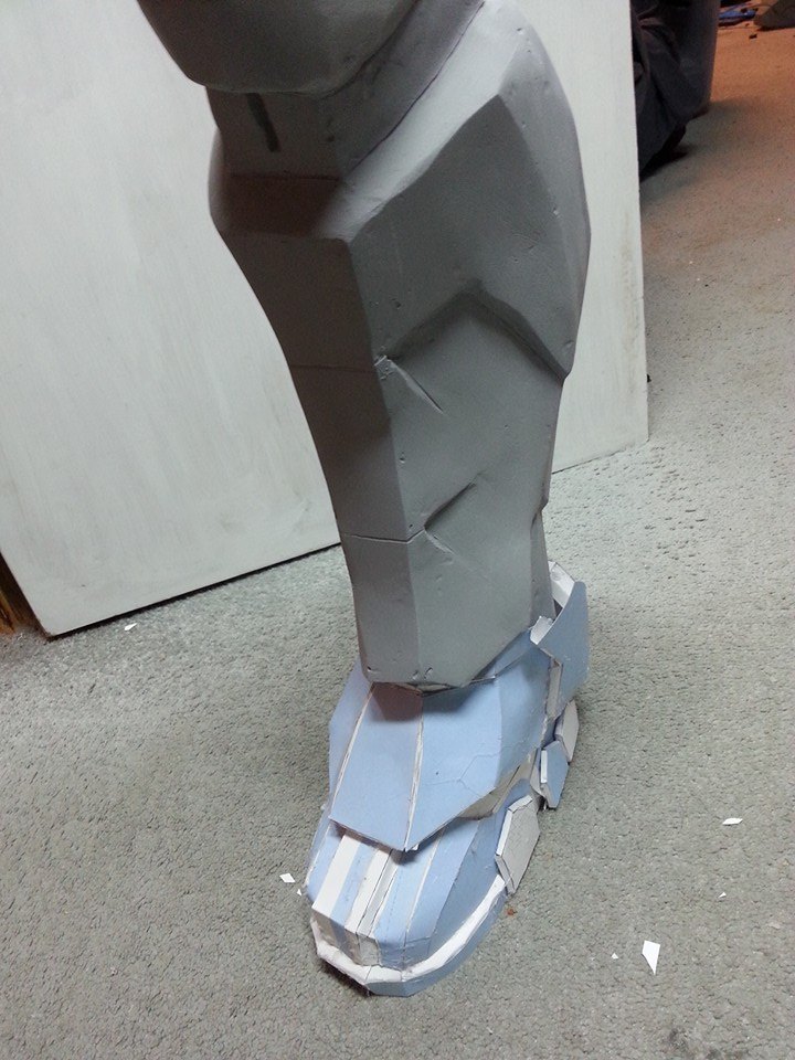

Shins: Done just need to paint
Boots: haven't even started them !
Neck : will make out of foam, haven't started
Gloves: going to use the ones I made from my ironman costume
Cannon : I have the mount built to the torso, I have an electric motor with remote to control it, I am going to build the cannon out of foam to keep it light weight for the motor.
to my problem areas: helmet, abs, cod, biceps any suggestions , comments, or ideas would be a big help !

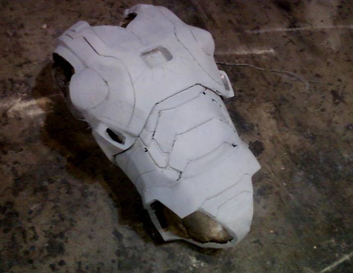

well now im getting somewhere ! got some more sanding done on the abs and codpiece. put a light coat of primer on it just to see how it looks. im glad everything fits up and lines together. I even extended the side "air intakes vents" to make them look more realistic. the way they came out from just doing the pep seems a little to small to me.
also to keelanmasterson, this is not a foam build. its a fiberglass build. but when I built my last iron man I used EVA foam which is the floor mats that look like puzzle pieces, you can get at a menards, farm and fleet, home depot, any hardware/construction type of store.
ok I took a daring step today, I hope it works out. I cut the abs and cod piece in half down the sides. I plan on putting 2 buckles on each side. I am going to rivet the buckles on . that way it will be a lot easier to take on and off. I just hope the buckle Idea works.
here is some pics of the abs cut in half, and I have attached the buckles today. just got some small screws, nuts, and washers, I couldn't find the right size rivets, which this works better. its actually really easy to put on and take off. I know its not movie accurate, but sometimes you have to lose a little accuracy to make it more wearable .

ok I plan on working on the boots next. I see they are in a smaller scale (332.774273) when I open them up in pepakura. so far I have scaled everything at 387 , should I continue to do this with the boots ?
ok I just read , ealier in the post its ok to have the boots scaled down from the shin. so I will go with the default scale of the boots at 332.774273, just for the sake that there will be no pieces that are bigger than 1 sheet of paper. I have smaller feet so it should be ok. I just know I want to have a few coats of resin and fiberglass on these to make them strong and rigid, because I know they will get beat up from the shins resting on them.
I would open the boot in Pepakura and get a measurement from front to back with the point-to-point measure tool. 332 is a pretty big jump down, I'd guess you want at least 1" (25.4 mm) of space between the heel and toe walls and your shoe length to account for finishing and wall thickness. The scale can vary quite a bit between the boot and the shin, but you don't want to be building a boot that's not going to fit you. I've done that. It sucks. :lol
well im almost done with one boot in the pep stage. what I ended up doing was using a foam template version of the pep file. I knew that was close to the right size I needed, and plus its more of a simple piece to put together, however I had to free hand a lot of the edges and detail since paper doesn't have the thickness of foam. I think its turning out alright.
now are people making the upper part of the boot , attached to the lower part of the boot ? is it hinged or anything ?

having some slight problems with the boots and ankle pieces. at first I made them one piece (boot and ankle together) I tried it on, and nothing seem to fit right with the shin. plus it made the shin sit way to high . so I did some trimming to the top of the ankle, and also cut the ankle off the boot, test fitted again, and it looks better, also have more mobility. after doing some research, I have decided to mount the ankle piece on the shin, and have the front of the ankle be a moving part , so it will bend with my foot. basically what this guy did in this video : Fan Made IRON MAN MARK 6 - Costume Overview - Pre-Suit Up - Delray aka BlackDynamo1 - YouTube
i will get some pics on here when i get it done. man Halloween is going to come quick !
