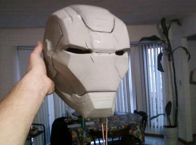

Awesome! Great job! I've considered making the entire suit, but don't know if I could. I guess you never know til you try! Anyway, this is my helmet, I dont know if I should add on though. Thanks for looking!

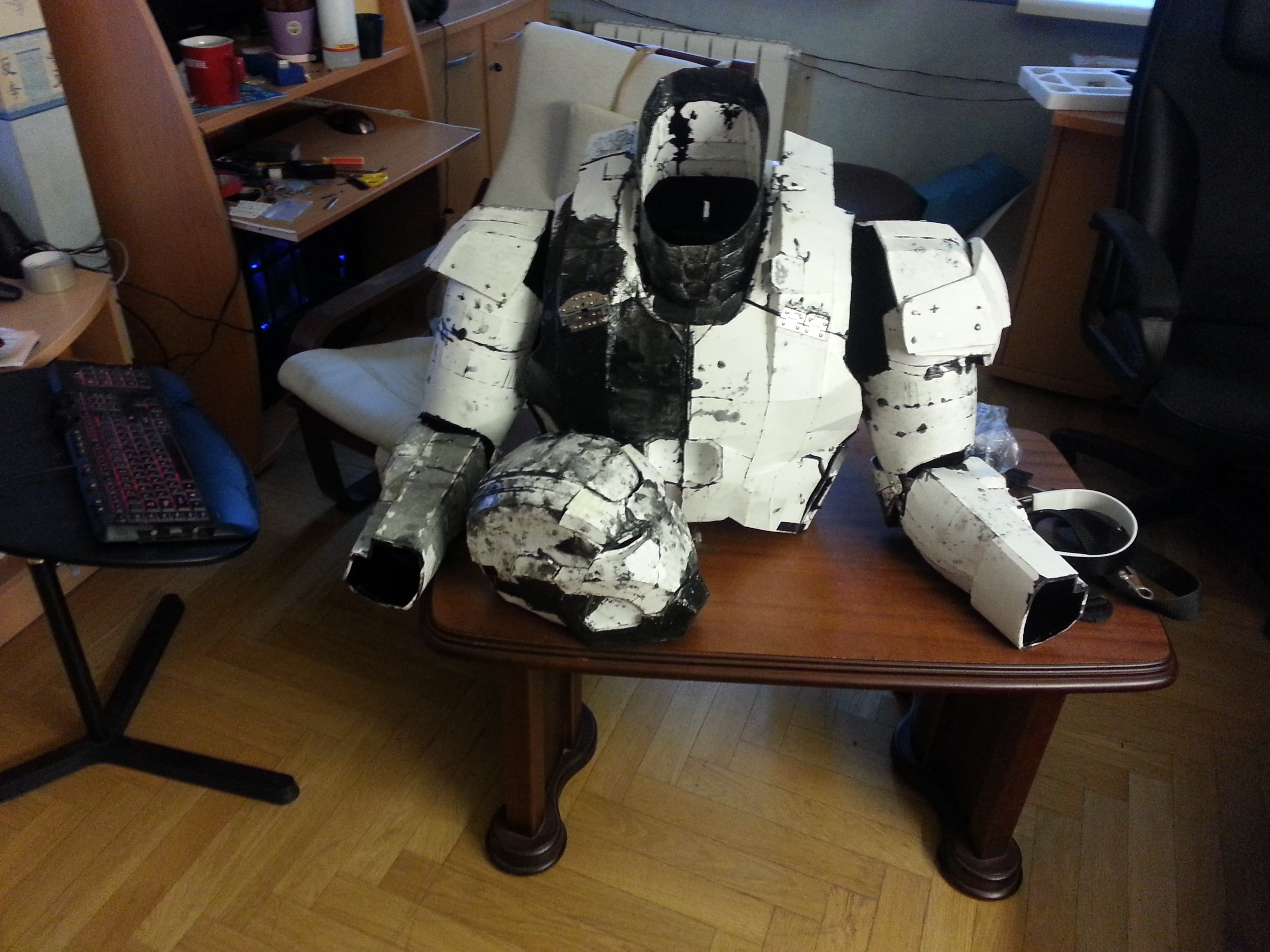

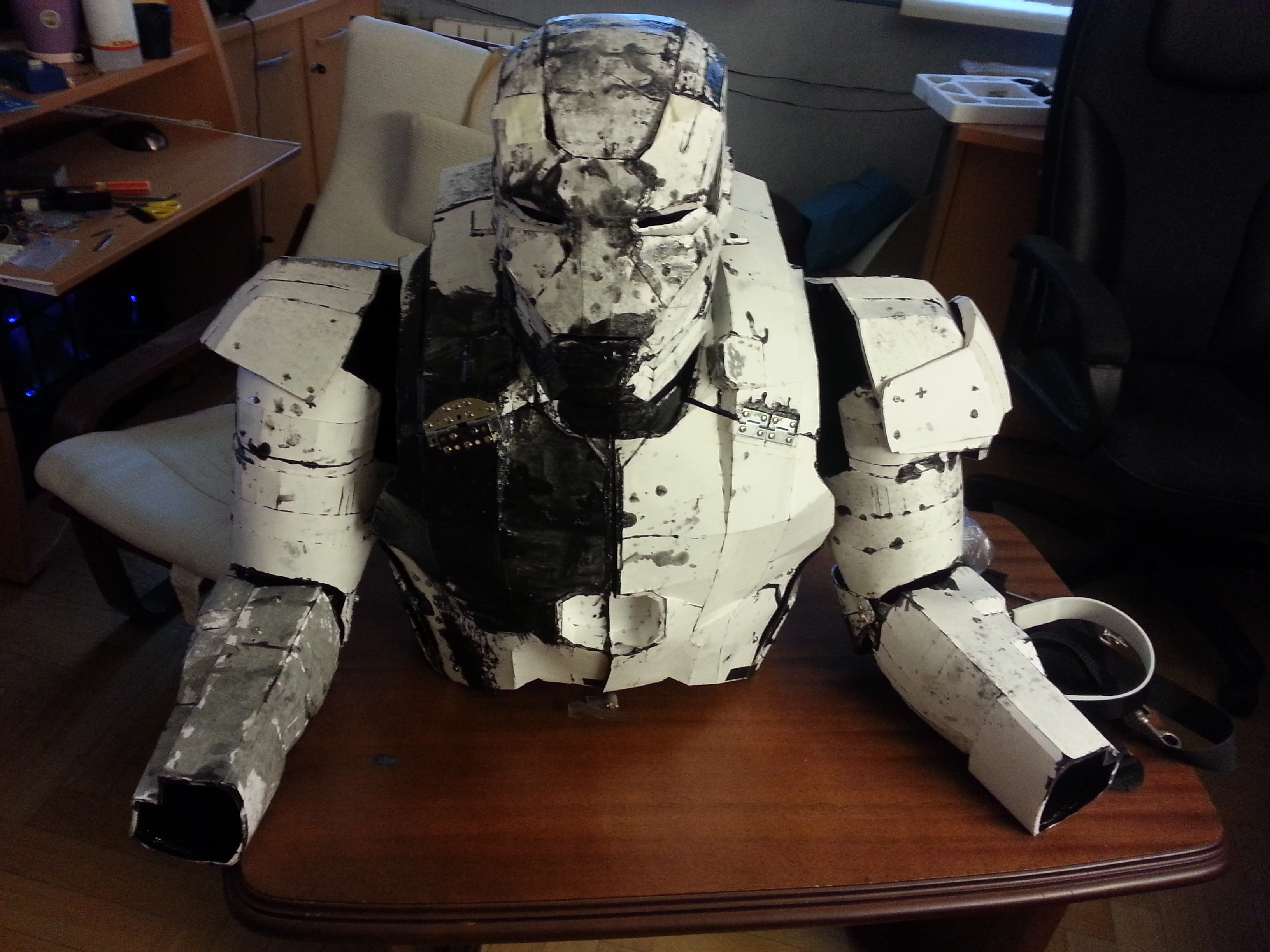

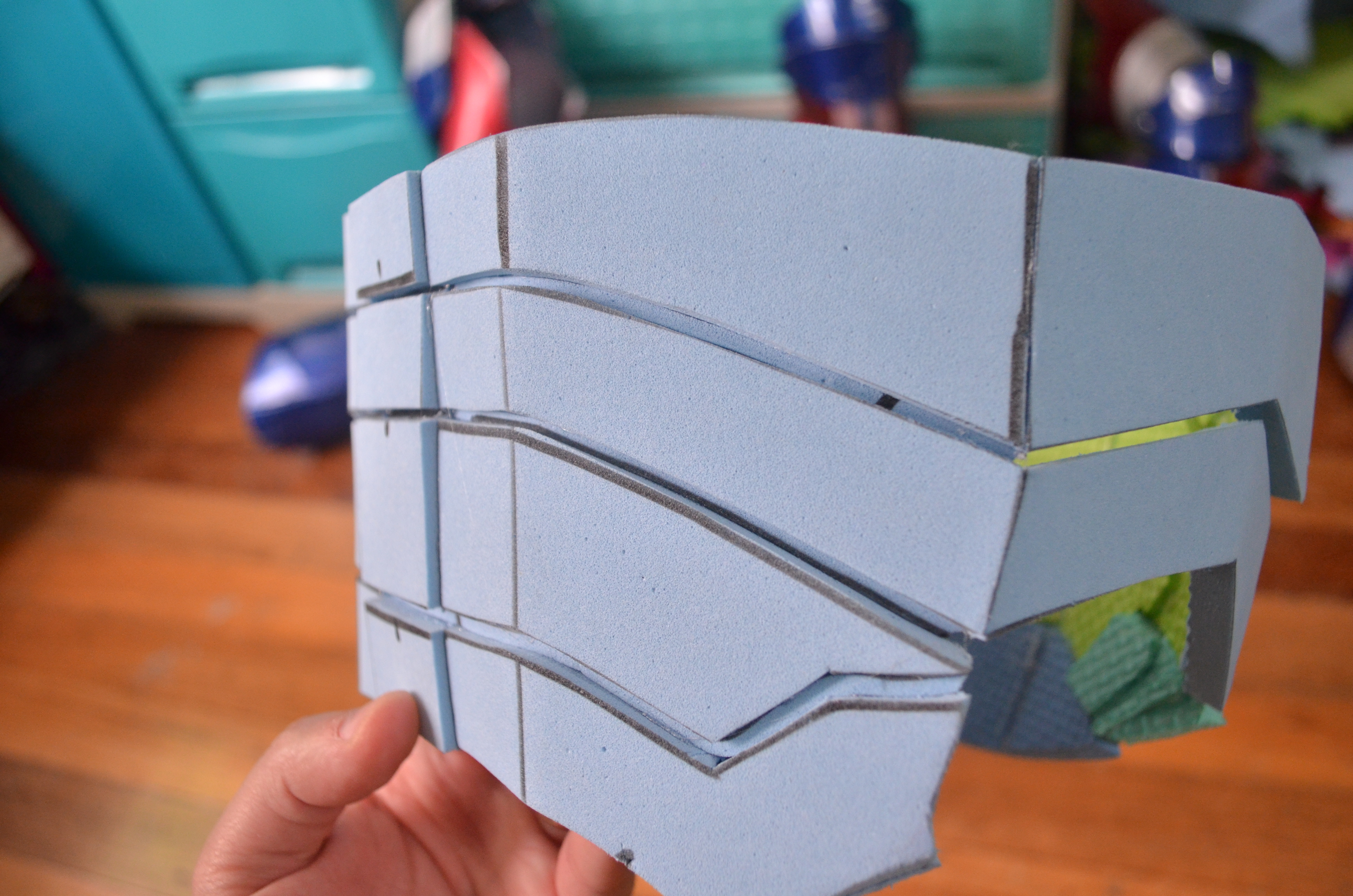

Hi, everyone again. I've just wanted to share my current IM2 progress.
And i have a question - how you join arms to the chest\shoudler? I've tried join them with screws, but with this tactics it was pretty uncomfortable to move.:facepalm
Its looking good so far!

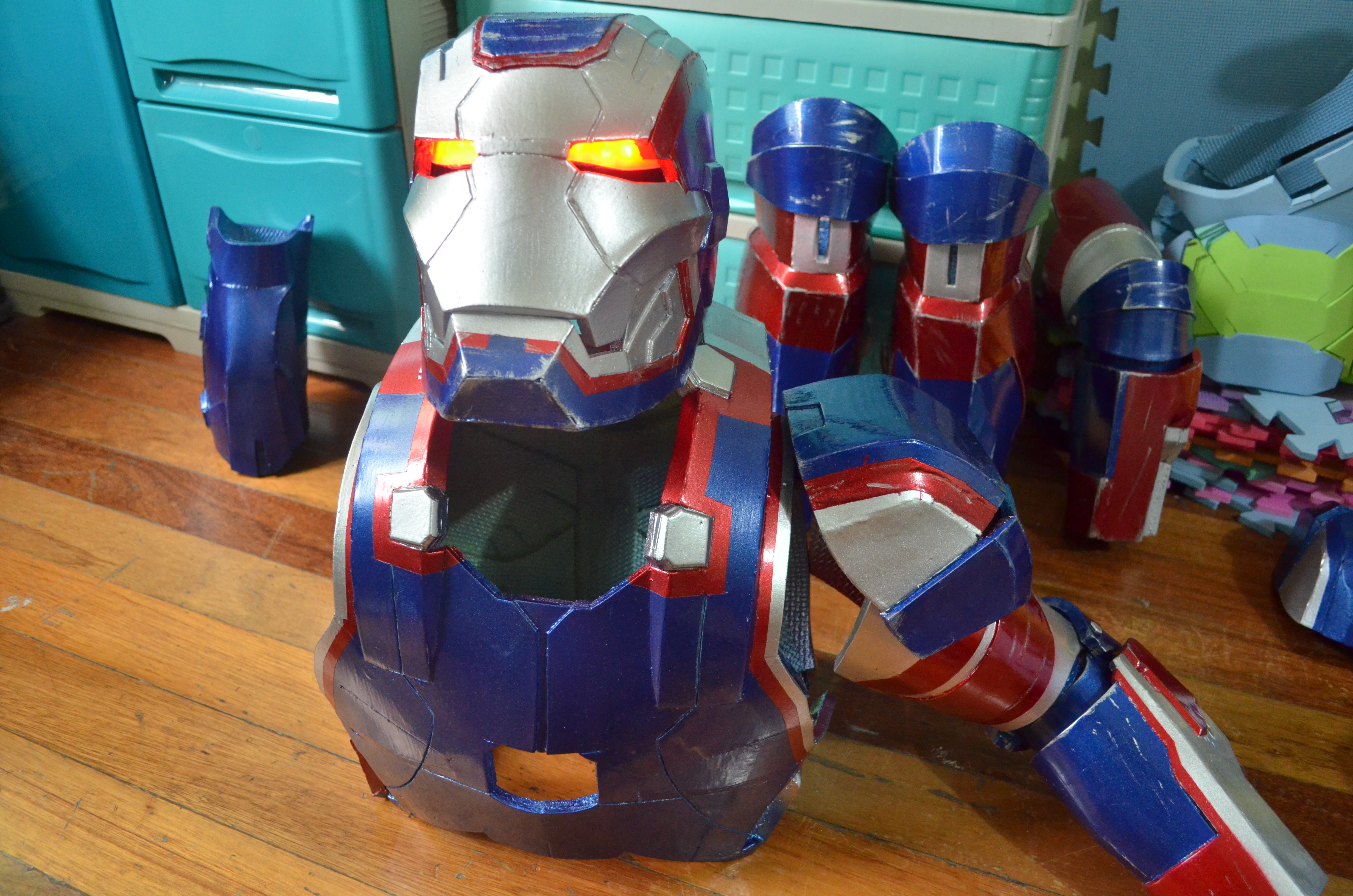

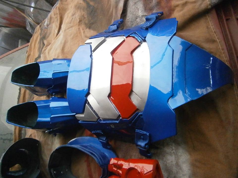

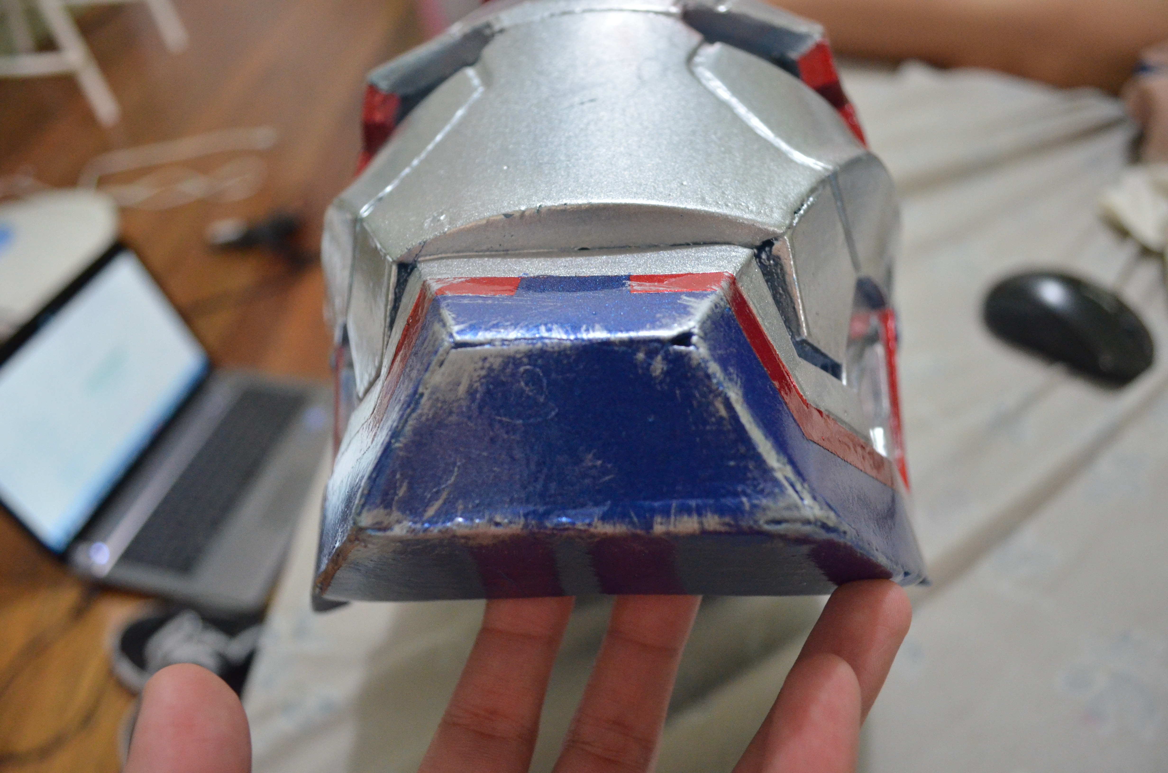

I repainted the entire suit, with a darker metallic blue and red, overall I'm pretty happy with the results. Not bad for my first time using foam (I think:D).
Anyway, I "attempted" to dry brush some damage/weathering on the suit. I used silver paint to put scratches on the blue and red parts but don"t know how to simulate damage on the silver sections. The silver parts just look a little too clean to me. Any tips on how I go about that?
I got a bunch of pics posted, any kind of feedback or advice on how to improve my work would be much appreciated.
Comment on, and again thanks to everyone that takes the time to share and help out :)

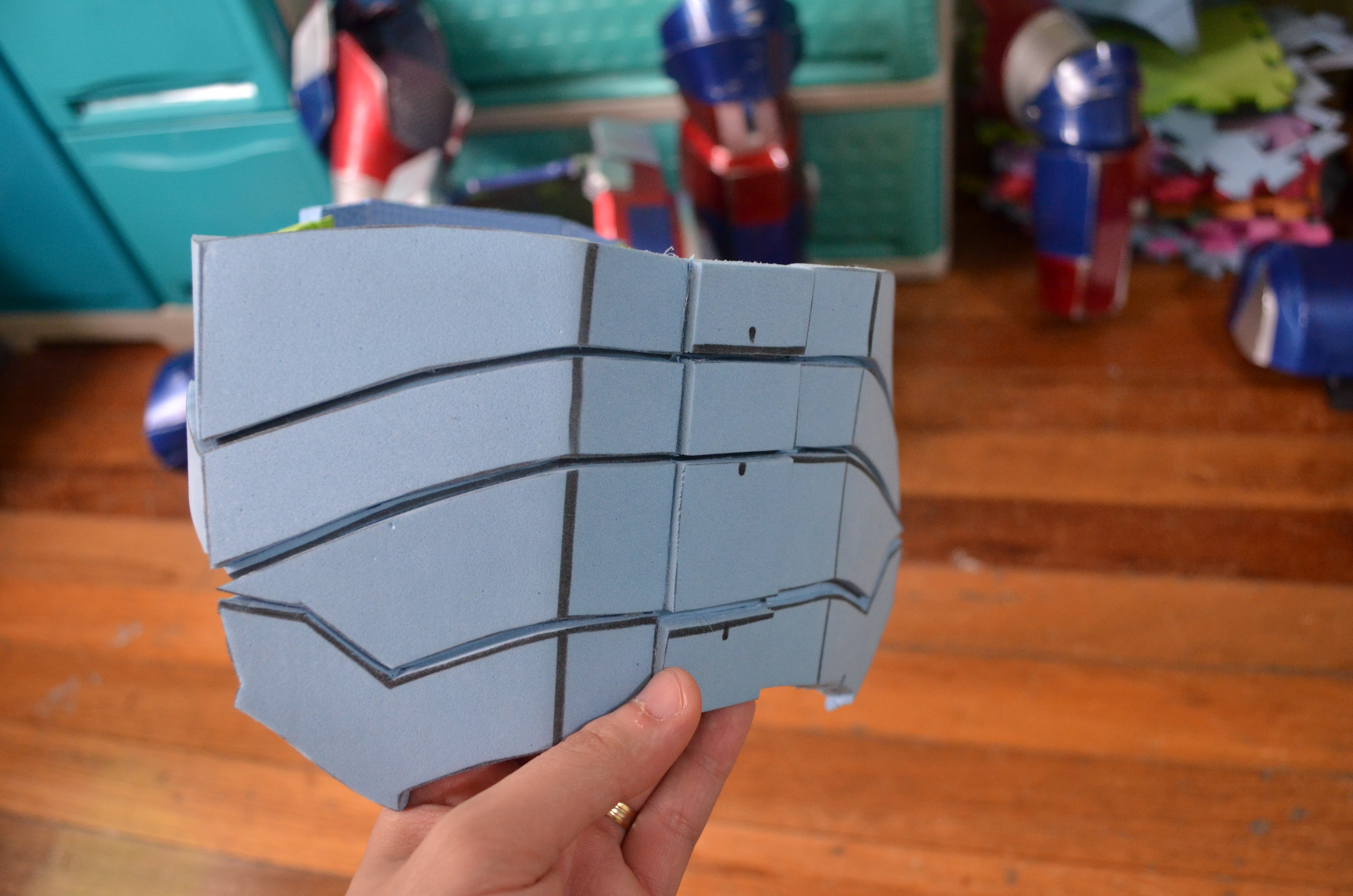

I put some pics of the abs, as this is my cleanest work from this build any am pretty proud of it lol
I know the eyes are either white or a lighter red, but my son wanted red to make it look "angrier".
Lookin pretty sweet! I love Mini Patriots! :D
That's looking too awesome!

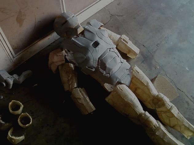

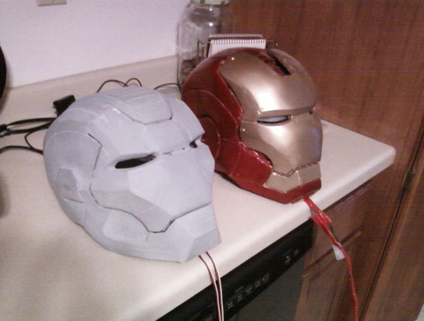

hey guys, I haven't posted on this thread yet, but I have been lurking around on here for some time now. I have been working on my own Iron Patriot pepakura, fiberglass, bodyfiller costume.
I am getting close to completing this. my goal is to have it finished by Halloween. although, I am running into a few problems.

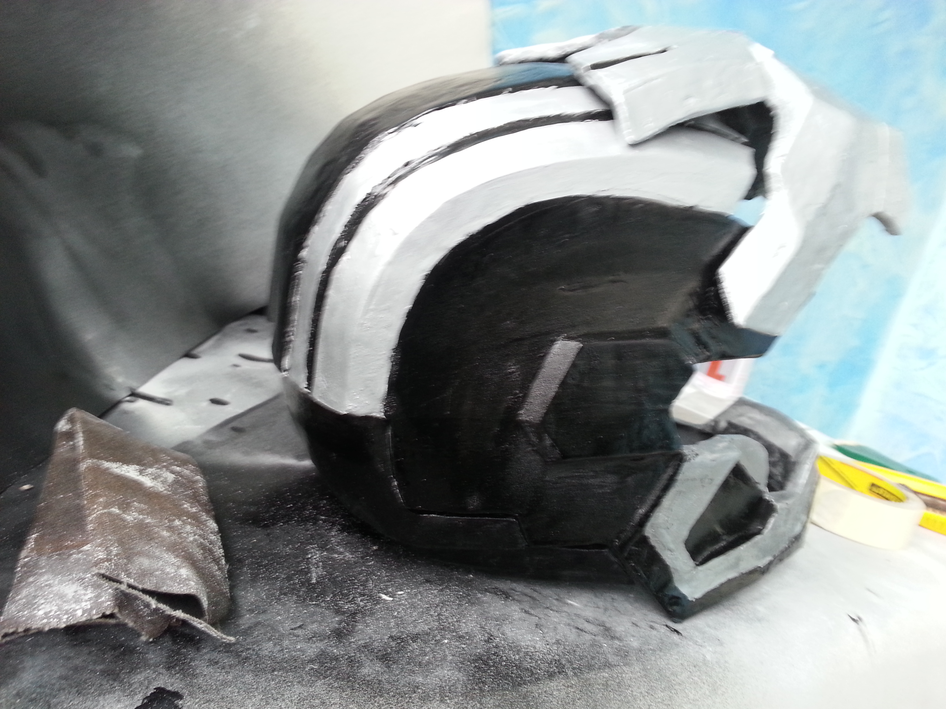

Helmet : im lost on how to get the faceplate hinged right. is the hinge the same for an iron man helmet ? it looks like the opening angle needs to be different.

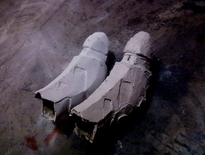

Biceps: They seem to big, they wont fit into the shoulder pieces. so I am going to remake these out of foam. using foam for these since I have done other armor and the biceps always want to seem to slide down even with foam. foam will make thim lighter and have a better fit.

to my problem areas: helmet, abs, cod, biceps any suggestions , comments, or ideas would be a big help !
Helmet hinge system is essentially the same, people usually are going with a four-point hinge on each side (or of course just the magnetic removable)
As for the abs, tough call. It looks like your abs are all in one piece? If they fit once you're in them, I'd leave them the way they are even if it's a hassle to get into it. Once you start sectioning those, you have to deal with your own movements putting a lot of stress and strain to move the pieces (even if latched or elastic-ed together) around. The finish will also damage more easily from flexing. Long story short, if you have OK mobility once you're in it, leave it as is. You know that a one-piece fiberglass ab isn't going to crease/bunch/look *******y after a bit of wearing, keep in mind though that'll be because your body underneath is what's creasing and bunching instead lol. Just my opinion, if anything try it on, walk around,see if you can sit, see if it's cutting into your ribs or anything, and decide. You can always bang out abs of foam in less than a day if not.
Biceps- If the biceps fit well, you could just make bigger shoulder bells instead. In the end there's not a lot of clearance around the opening of the bells anyways. I would look into having your biceps connected to the top inside of your torso arm opening with straps and clips; the strapping is hidden under your bells, and one strap keeps your mobility while preventing the 'slide'.
Just my thoughts. In a pinch you can always replace stuff that doesn't work with foam, I just say use the fiberglass since you've already got it.... That, and I just think fiberglass builds kick ass. :thumbsup
is their a drawing, or plans of this 4 point hinge system for the faceplate ? i just cut the faceplate out of the helmet today after work. so im ready to hook this up !
i did my ironman helmet last year different. i used 2 servos with a middle hinge on the face plate, works fine, so i think ill try that again.
i just cleaned up the edges on the faceplate and helmet cut area on the iron patriot and it seams to come off and on with no binding, but thats with no hinge at all.
so im off to buy some servos, and a hinge and try to get this done by the end of the day ! wish me luck !
i think i got it ! batteries died ... got to recharge, and i have to sand a little off the lip area, it was getting caught once in a while, but for the most part it was working smooth.
I did cut my face plate a little differently then screen accurate, I left some of the side of the eyes intact, and I didn't cut the "wing" all the way to the ears, I figured that might get stuck a lot with it.
