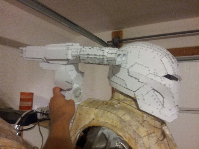

jackieisrockin , you wouldn't happen to have the original for the hexagon shaped things on the shoulder rails, would you? I'm looking at the pep file and I already know it's going to look bad if I try to make it by hand, I'm thinking I might 3D print them. Thoughts?
I've been discussing animatronic plans with a friend of mine, he's really experienced with robotics and Arudino and he wants to help me with the shoulder gun motorization. We were kicking around some ideas on how to get the gun to swivel from one shoulder to the other, and I've come up with these vectors for the U shaped shoulder rail that I'm going to get laser cut:
If anyone has suggestions or is attempting something similar, please share your info! This is still pretty new territory for me.
