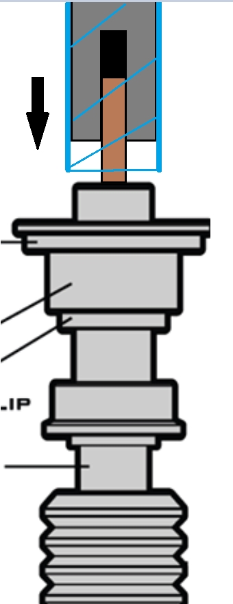

I had a thought this morning about how to solve the perceived contradiction of the emitter and nipple being one piece (Brandon says that is evidenced by looking down the shaft and there are no breaks)
If the nipple is permanently attached (and we do see it in some stills of ANH) but see the blade spinning while the emitter (and therefore the nipple) locked, how was that accomplished?
Could it be as simple as the reflective tape having been rewound around the blade as it was already mounted to the hilt? and it was wound down far enough that it wrapped the nipple, albeit loosely? If the blade was attached to the motor shaft (rod) but rotated, the tape could have come loose at the nipple so that it could spin, but still hide it. I realize I'm doing a poor job of explaining so I'll try another diagram.
But that would explain why you see the blade clearly rotating while the emitter isn't (and can't see the nipple at all).
Edit:
Here's what I mean. The blue line represents the reflective tape. It could have been wound down past the nipple all the way to the plate but broke loose when the motor was turned on, allowing it to spin around the nipple. The video even shows what might be the tail of the tape rotating around where the nipple should be. Just a thought.

As I keep trying to get across the above scenario requires the emitter to be held by AG & in at least one view his hand position makes this questionable. Also the position of the distinguishing marks on the emitter remain the same in relation to Alec G's hand position, across all shots. How likely is this to happen between takes if the emitter/nipple is free to rotate.
Again - it is clear from the BTS photo's from ESB - that the luke/ vader shared stunt was altered post ANH, switch & wires gone, likely the motor too but we can't tell from the photo's. For the V2 - as it is now - Brandon states there is evidence of something having been mounted inside & this is most likely a motor, I can't think of what else it could have been, so it is highly likely it was an ANH motorised stunt which has clearly been altered post ANH with no documentation - again - as what the former set was.
There is no film sequence that kurtyboy nor I have been able to find that shows the slightest bit of rotation of the emitter. We have specifically looked for rotation but only ever find it stationary. Neither do I get the apparent need to have a link between the current V2 set up and the ANH set up.
It makes no logical sense to me. Doesn't stop the V2 having been in ANH.
Just realised that you mean that the tape is wound on to the blade spiral fashion? That's not the case - fabric is on in a lengthwise strip in order to give the observed black stripe. (from end that same sequence - & I agree it is seen peeling off & flapping about in various views).
