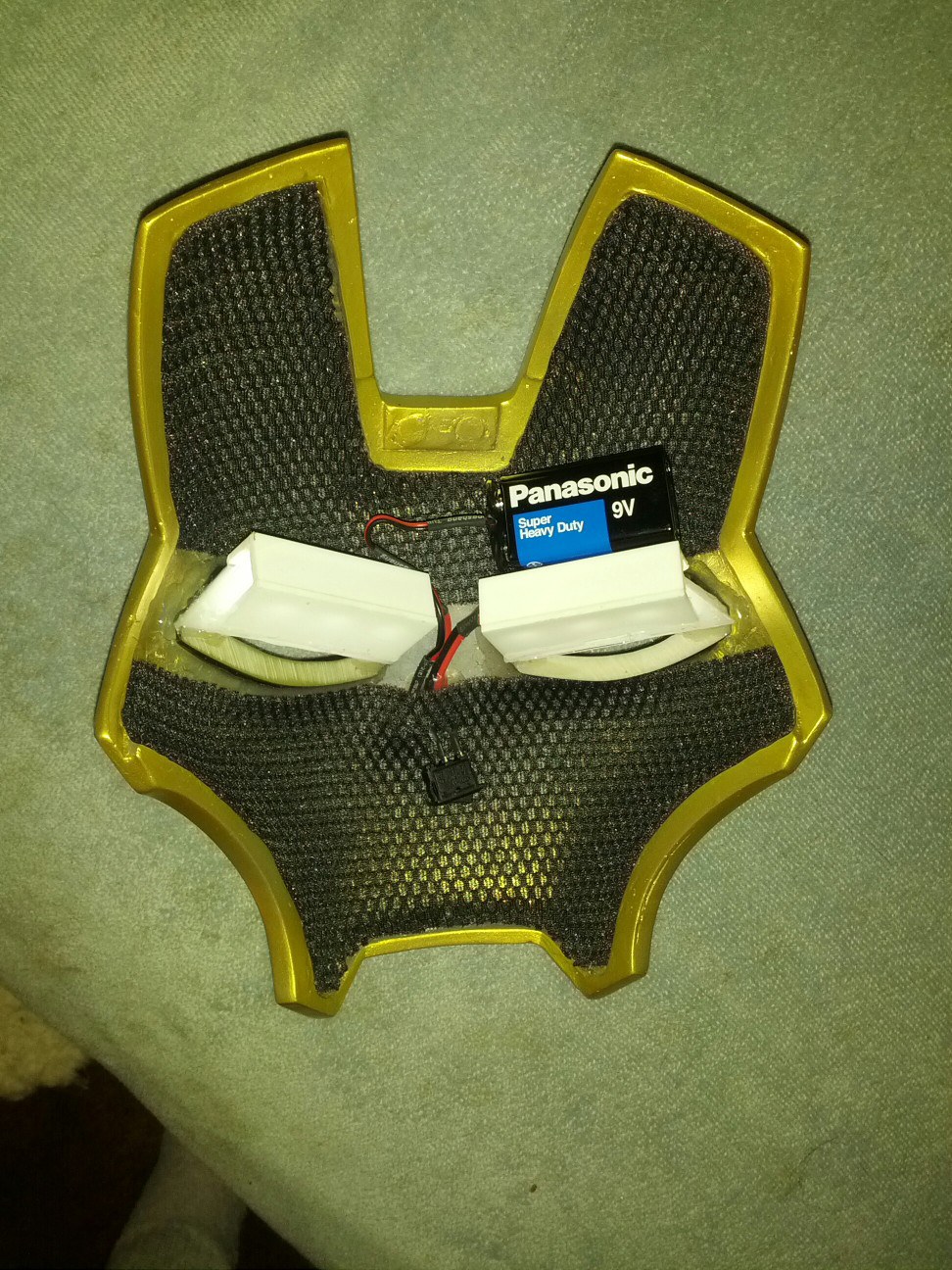

Question on the helmet to you and even Steve or anyone else who has one of Leslees amazing gear, do you find the light boxes for the eyes to be in the way? The white ones behind the black box eye lenses, I mean. I'm considering gently removing them and modifying the LED strip to sit closer to the eye-light-lense so I can not just see better but not have the white boxes cut into my face. Or are those boxes just on this helmet because it's meant to be more of a display piece since when ordering a suit, you order a helmet to go with it?
Please forgive the odd tint to the image. Didn't take the pic in the best light, but you can see the big white boxes I'm talking about that house the LED light strip.
Thoughts?

Hey there J... they do cut into my face as well :( The boxes on this new helmet are setup quite differently then my old helmet.. I may have to remove them as well and re-adjust how they sit... then glue them back on.. that was one thing I noticed that was different from the first Mark IV/VI helmet I bought from Leslee. I will post pictures of how the old faceplate's eyes are attached as well.. that faceplate was much more comfortable. I didn't get any pictures taken tonight and thrown up but I will take a few tomorrow morning and add them to the ones that will be going up tomorrow night with the joints installed in the legs... Hope this answers your question.. Let me know if you need to know anything else.

J, I took pictures of my old helmet from Leslee and the new helmet that came with the suit... these are both the same model but the way the leds and eye boxes were installed is different. The faceplate on the left is the new one and the right is the old. It appears on the old one that Leslee installed the light strips on top of the eye lens which gives the entire setup of the helmet a more comfortable fit after you add padding to the helmet to cushion your head. On the new helmet, he installed the lights in the back and installed a bigger box inside the helmet... so they push right up against your forehead/eyebrows, I'll agree with you, it is extremely uncomfortable.. Here's what I plan to do. I plan on taking my dremel tool and cutting the boxes out.. removing the top white strip and then flipping the box so the led strip sits on top of the eye lens... the light will still shine down onto the lens and it may give a less brighten view, but in all it will be the same exact setup that his original mark IV/VI Helmets had and fit more comfortably on my noggin. :D Let me know if you need any other pointers.
Thoughts?

Yeah the boxes that house the LED's have changed but not massively, if you can , very carefuly remove the bottom ledge of the box this will help . and then the back wall of the box that's nearest to your face trim it up slightly with a sanding wheel. Both of these jobs will give your face more room and then when your doe, paint the back box matt black on the outside, this will stop light bouncing back in your face.
