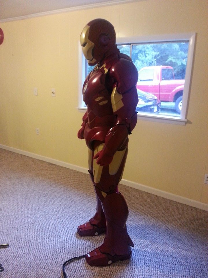

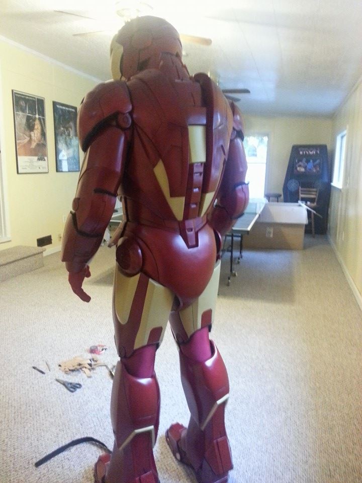

I'm not exactly sure what the shade of red is.. It's whatever red Leslee is using on his new IM suits, I'll probably end up getting the color scanned at my local paint store though. Leslee was kind enough to send me extra paint a couple times to keep the suit touched up nice. I'm finishing up on all my hinges in the next few weeks and I'll see if I can't get a paint code for you

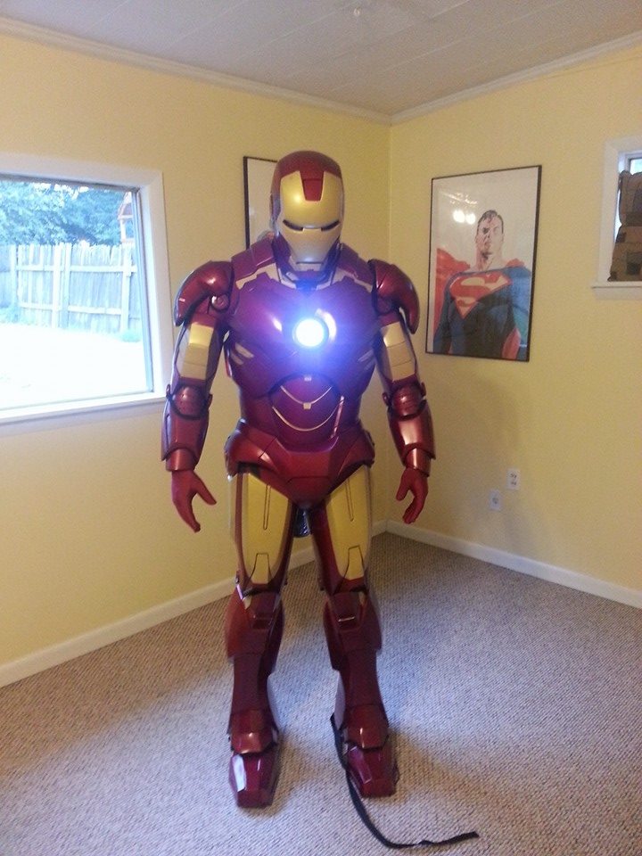

When you order one from Leslee I believe you can pay a little extra to have one sent with it, but all it is, is the halo led rings I pictured, I'm actually still hunting around for a good lightsource.. i have one already that works for now but I know I can improve the size and performance.

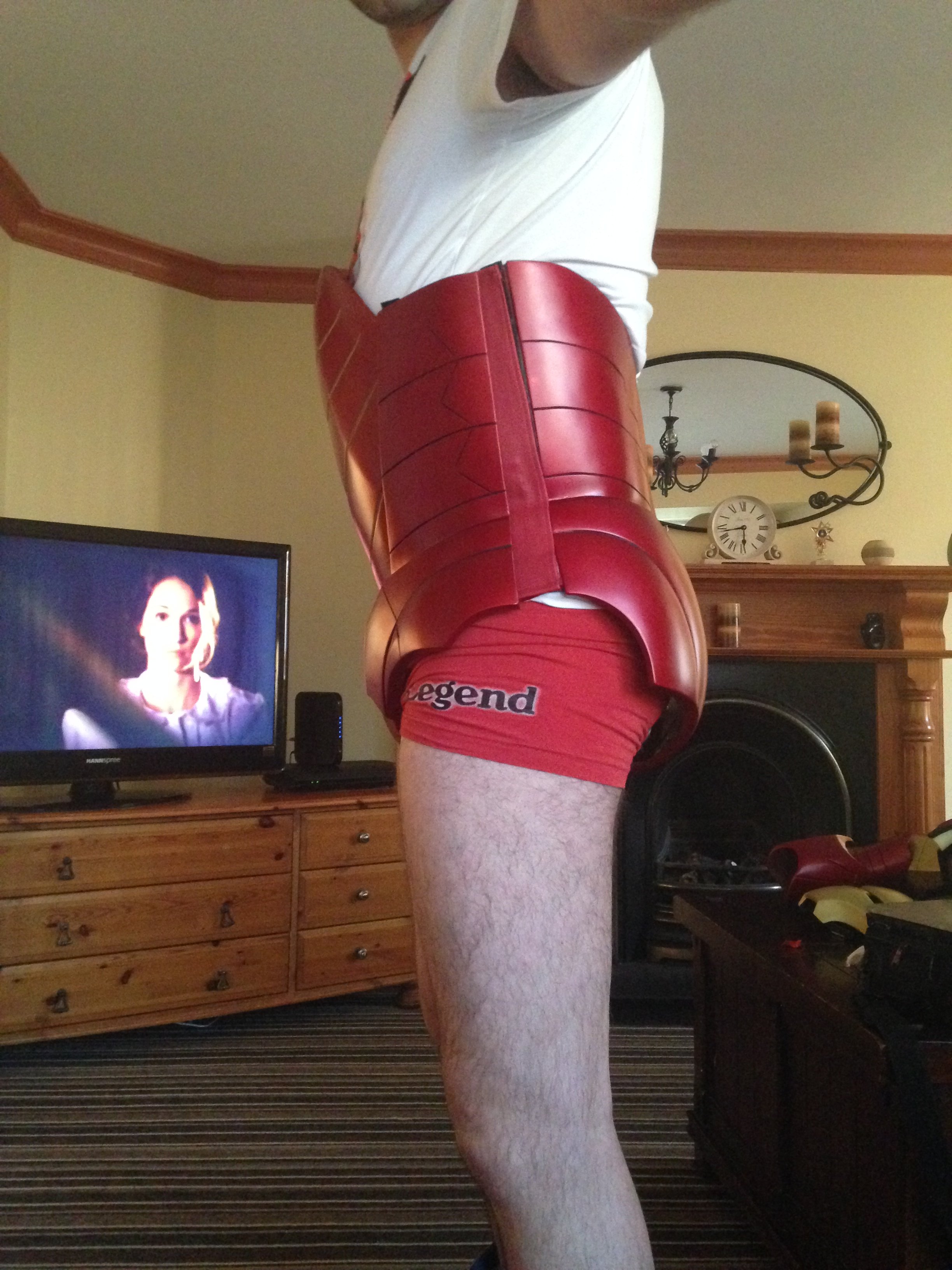

corset1.JPG Hi guys, This thread has been brilliant! I just got my MR suit about 2 weeks ago, from a guy in germany who had it on once. some of it was strapped already but I have been working on alot of issues over the last 2 weeks, firstly....im a bit to heavy to get it closed around the mid rift lol so i made this out of leatherette, while im on a serious diet. im a 36 wait and im about an inch two wide around the love handle area. but it gets me out and about in the suit. I also removed the eyes that came with the suit and made my own which I can see through (pics to follow) my only issue is walking in it, my knees and shin piece seem to be grinding and restricting movement, i seen the hinges that you made...where they any good? could you actually walk close to normal? also the other issue is the gloves. my suit came with different gloves (not MR GLOVES) 501 gloves (i think?) anyone know where you can buy a set right now with repulsers built in that are good quality? perferable with fingers that dont fall off and that you can slide your hand into easily? I also were 3 and a half inch platforms inside the shoes, im 6ft 2 but i just couldnt fill the legs, so the platforms really help, needed to do a fair amount of trimming though to get them to fit inside the IM shoe, but i think a 6ft 5 ironman looks even more epic! lol

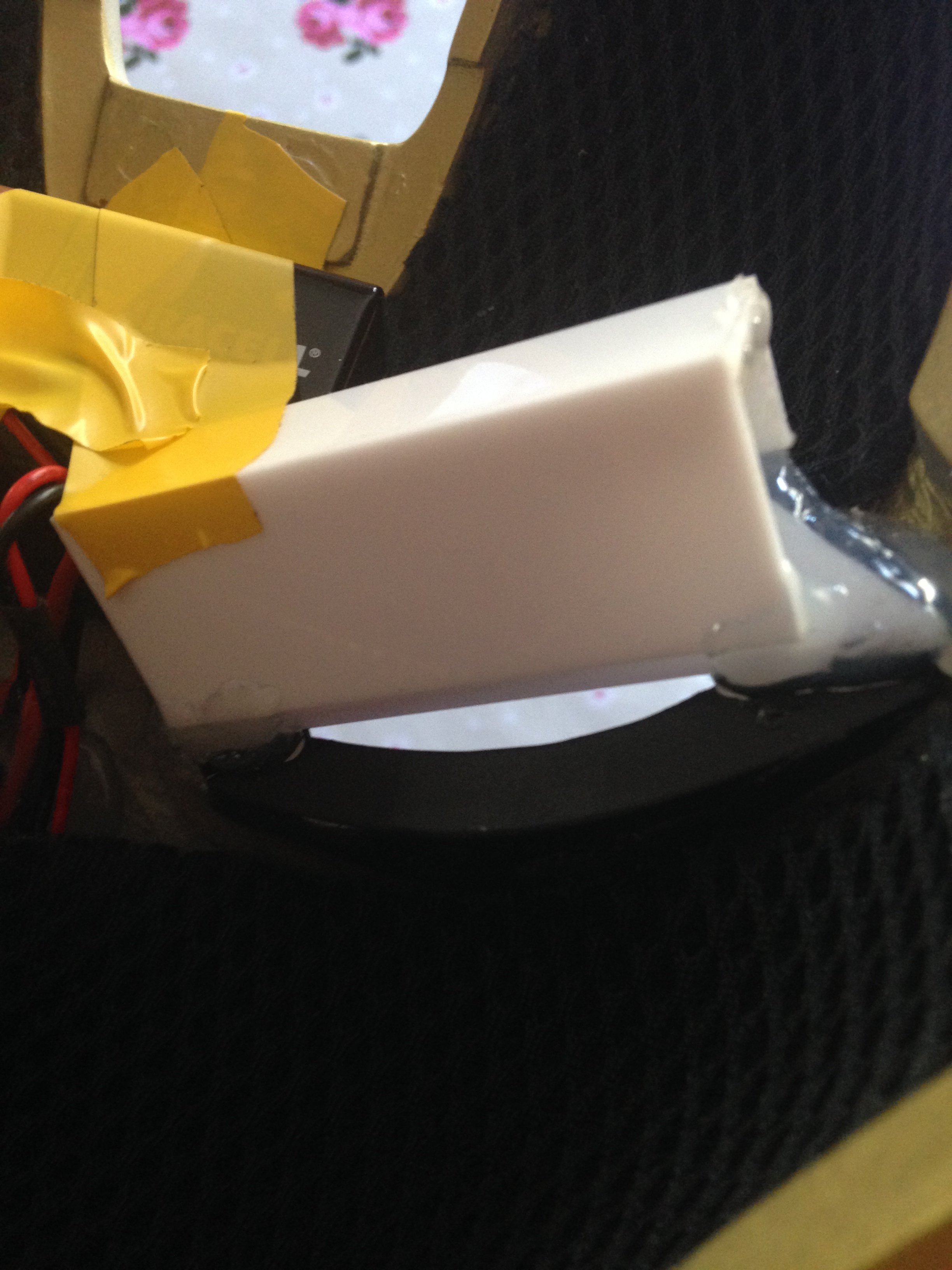

eyes 1.JPGthe eyes have a very limited view when you get the suit (excuse the tape, i just used it to hold the battery in place while i was testing them out) i will also post up a pic of the new eyes and how i made them, you get to be able to see out of the full eye slot then.
