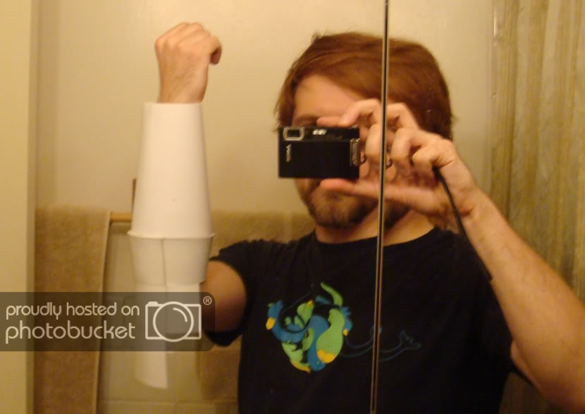

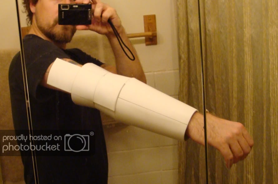

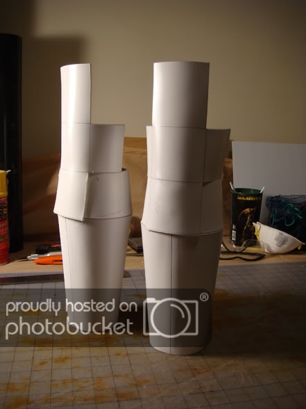

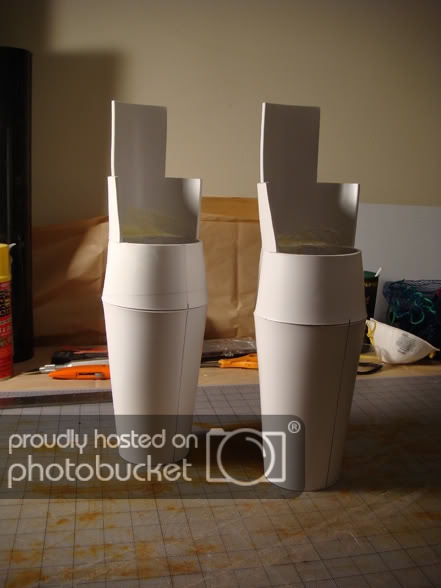

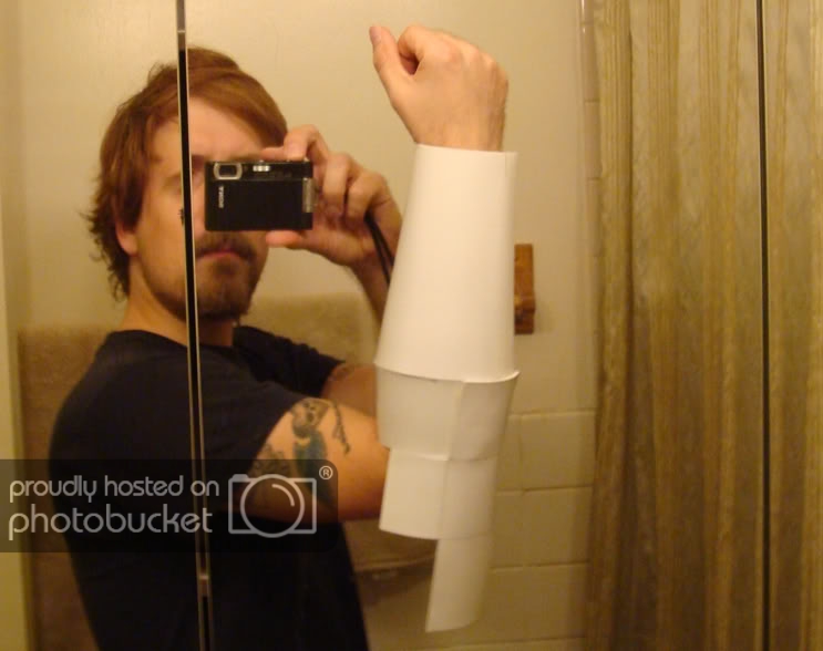

Ugh. What a weekend. I hate leaving this stuff to the last minute because when stuff goes wrong you can't really figure it out, you just have to try something else. So, the original forearm pieces I made ended up too short due to bad measurements. So I ended up using them to make the smaller cone on the elbow side and remade the front forearm portion. Cutting the sintra way to long so I would have the extra material to cut away and make it flat and symetrical. I spent all day today working on this. Left the TV on FX all day and saw Ray and Walk The Line in a row without noticing. Here's what the final assembly ended up looking like:
I really pulled this out of my ass. Sometimes you get strokes of genius when you're pushed. I'm happy with how these assembled. I still have a lot of work to do. I am going to let the epoxy cure until tomorrow night. The I have to prep sand then Bondo. Then sand down to filler. I still need to prime them, spot fill them, add the top coat, and then weather. It'll take all week and then next weekend is my final paint and weathering time. Hopefully I'll have my chest and shoulder armor to work on this week.

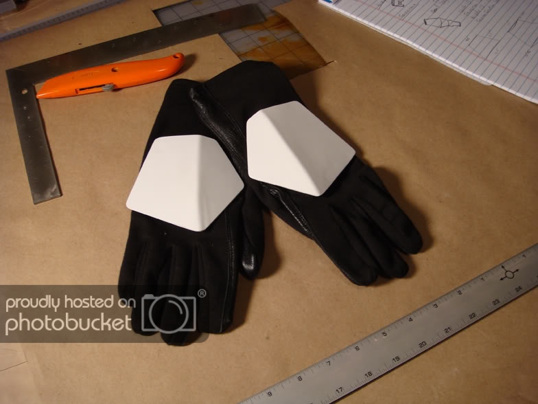

Here's the Nomex gloves and hand guards, from my Clone Wars Microseries Volume II costume, I'll be using. Been done for a while just never photographed them. All they need is weathering.

Can I ask what you used to heat up the plastic? Did you do the round curve free-hand or wrap it around something?
~ BC
I have a Black and Decker heat gun. Put the pieces on an old cotton blanket while I warmed them.
The tubular parts were just wrapped around to meet the edges then monkeyed with a bit. Then I epozied the edges together. Then after the epoxy cured I would heat the whole thing up and get it as round as I could.
The elbow extension I just did by hand. I molded the lower most part to the forearm obviously but the rest i just would heat in sections and mess around with.
