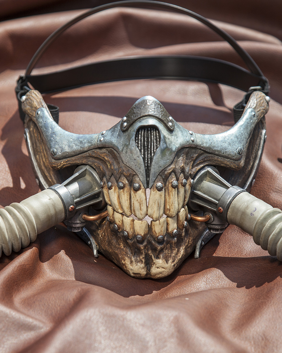

I'd be interested in any painting tips you guys might have for the mask, particularly the metallics. The film one looks to me like weathered and cloudy chrome, which is a horrifying thing to try and recreate.
Not really. I'm more in the mindset that the film's was painted chrome for shooting and then the finish dulled over production on set because images of the thing now, it's completely flat. There's plenty of times in the film where the sheen on that thing varies from shot to shot.
How I did it was take chrome spray paint, spayed the thing down, and then gave it a shot of clear coat to "gray" it down a bit.
Logan completed my mask over the weekend and sent me some shots, holy crap does this thing look amazing! I can't wait for this beautiful mask to arrive! Thanks again Logan!

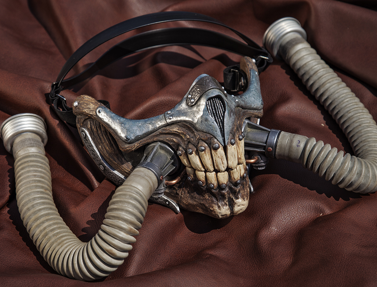

Hey all - just wanted to get some thoughts on how you're painting this baby. Are you masking off everything but the metal bits and spraying silver first, then hand-painting everything else? Or a bone-colored base over everything before the silver goes on?
I hand paint bone color first, then the brown washes, then mask all but the metal bits and spray gloss black, then chrome - preferably with a day between each step. I'm using acrylics for the 'organic' stuff.
Same on my end, I did the metal bits last. The bone bits were the toughest for me to do because nailing the color was a chore. It's not a completely flat brown (its got shades of green, too) and to get highlights on the raised areas without taking so much of the areas around it off required some experimenting on my end.
For the most part, jaw and cheeks were done with several layers of various shades of brown dry-brushed on top of each other (all on top of a black base coat and an "antique white" color to simulate bone) and then lightly buffed with a towel. Then, on top of that, went on several washes to get into the recessed areas. Those areas were then masked off to do the metal bits and that was fairly straight forward: mask off, spray with chrome colored paints, darken with inks, and dirty with washes. Seal the whole thing off with some crystal clear.

Thanks for the tips, folks! I've followed the advice in this thread and I think my mask has turned out just peachy (if maybe a bit darker/browner than other folks' interpretations).
Next question: is there a trick to fitting the copper tubing between the teeth, or do I just need to drill a little hole behind the teeth for it to slide into?
Looks good man! Yeah just drill a hole behind the teeth, start with a smaller bit to really nail the placement and keep it under control. Use the hose connector as well to help judge exactly where it goes. PM me if you want a longer explanation!
