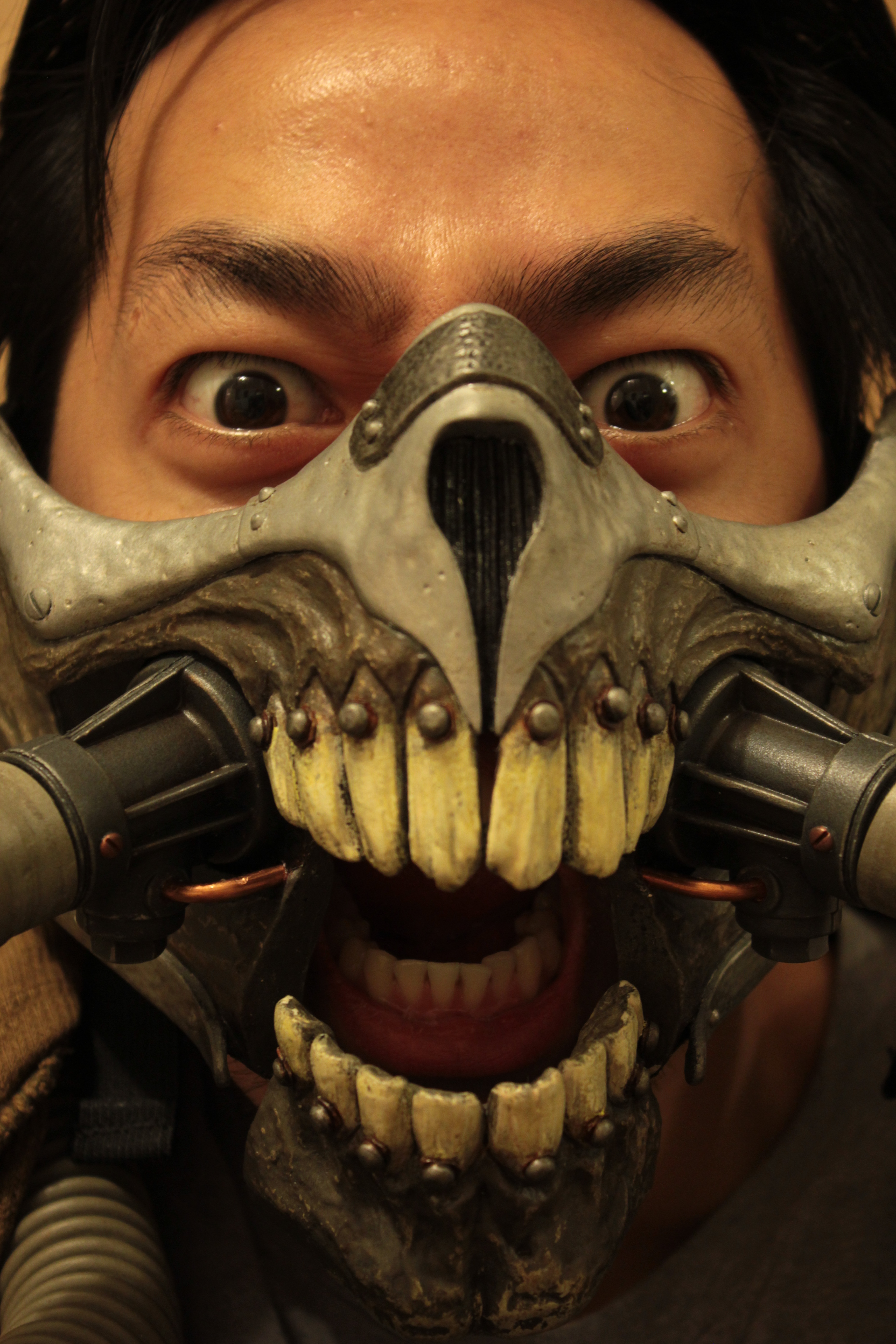

@logan74k - Yep, I used the photo Ein just posted and followed this thing as closely as I could and worked the look of it into my "mechanism" to make the jaw move. Though, looking at it now, I should've used thicker gauge copper wire (I bought 5 gauge to mimic the ones that come with the kit but I'm thinking it's more like 7/8 gauge) and shaved the insides of the mouth down if I really wanted to get that exact look, but, the hell with it. Looks good enough for me.
As far as the braces in the mask go, it's some aluminium stock I had around that I cut up and joined together. It's double jointed with somewhat tightened with nuts to keep the mouth piece in place but not stiff enough that it won't move. The front joint actually slides a little bit up and down the long brace so it can move up and down and mimic the film's function. It doesn't technically "slide" the mouth down, so much as it extends it forward enough for it to move. Also, beyond sliding the mouth down, it also helps to hide the rest of the system. It's a pretty simple, ghetto set-up. The rubber bands provides enough resistance to keep the thing in place. The real trick was bending all the metal to get it to lay within the inside of the mask so it doesn't push it so far away from the face. Regardless of its finicky-ness, it works.
