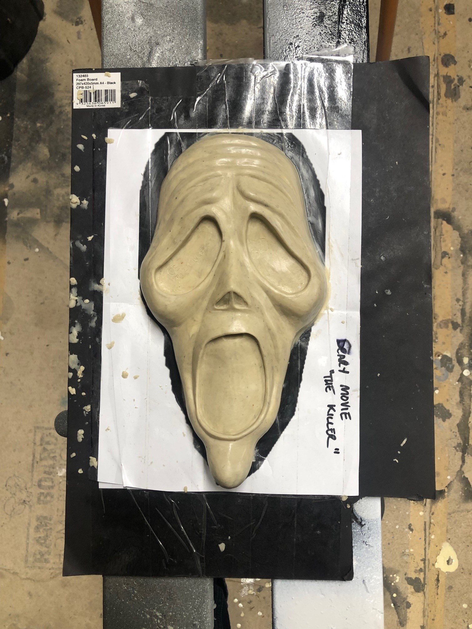

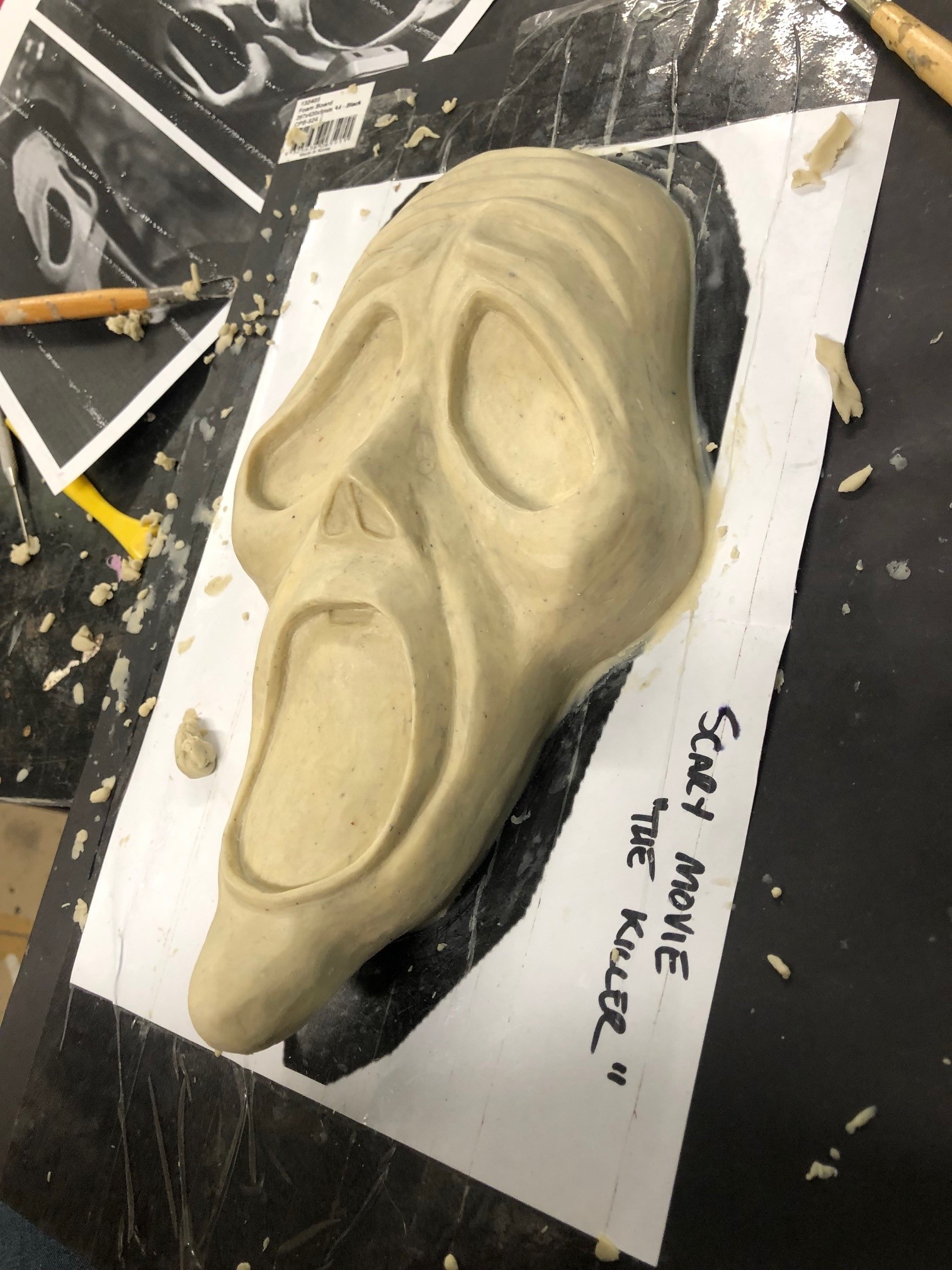

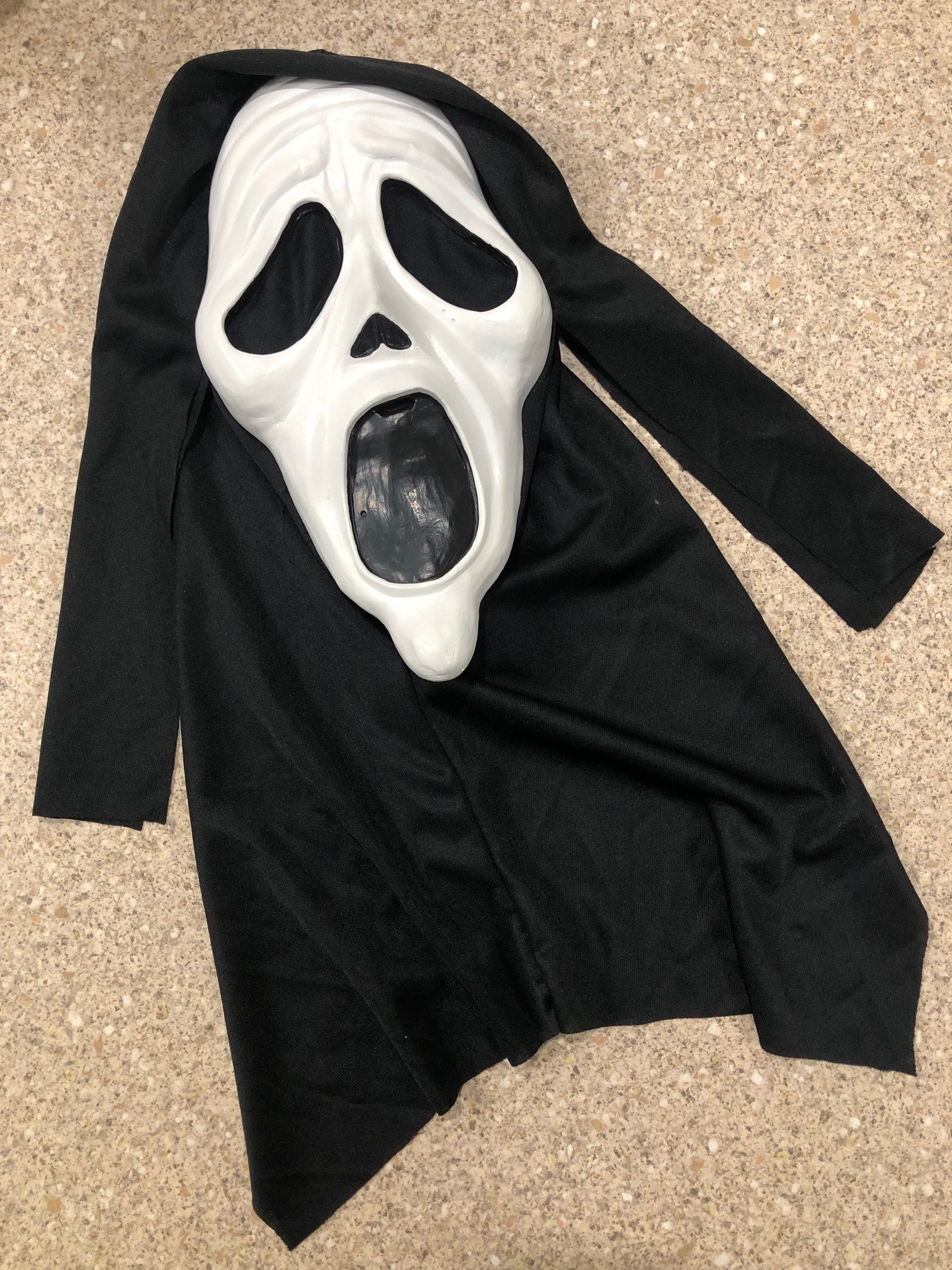

As a long time collector of Scream and Ghostface masks, I've always wanted a proper "The Killer" mask replica to round out my set. I've got the official Fun World ones, but I've never seen a replica that I really liked.
This is the look I really wanted. "Hello Drew" has stuck in my mind since I first saw the movie, so off I went with a big lump of claymate oil based clay.

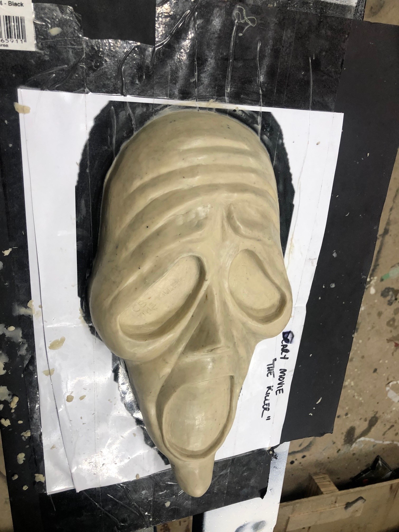

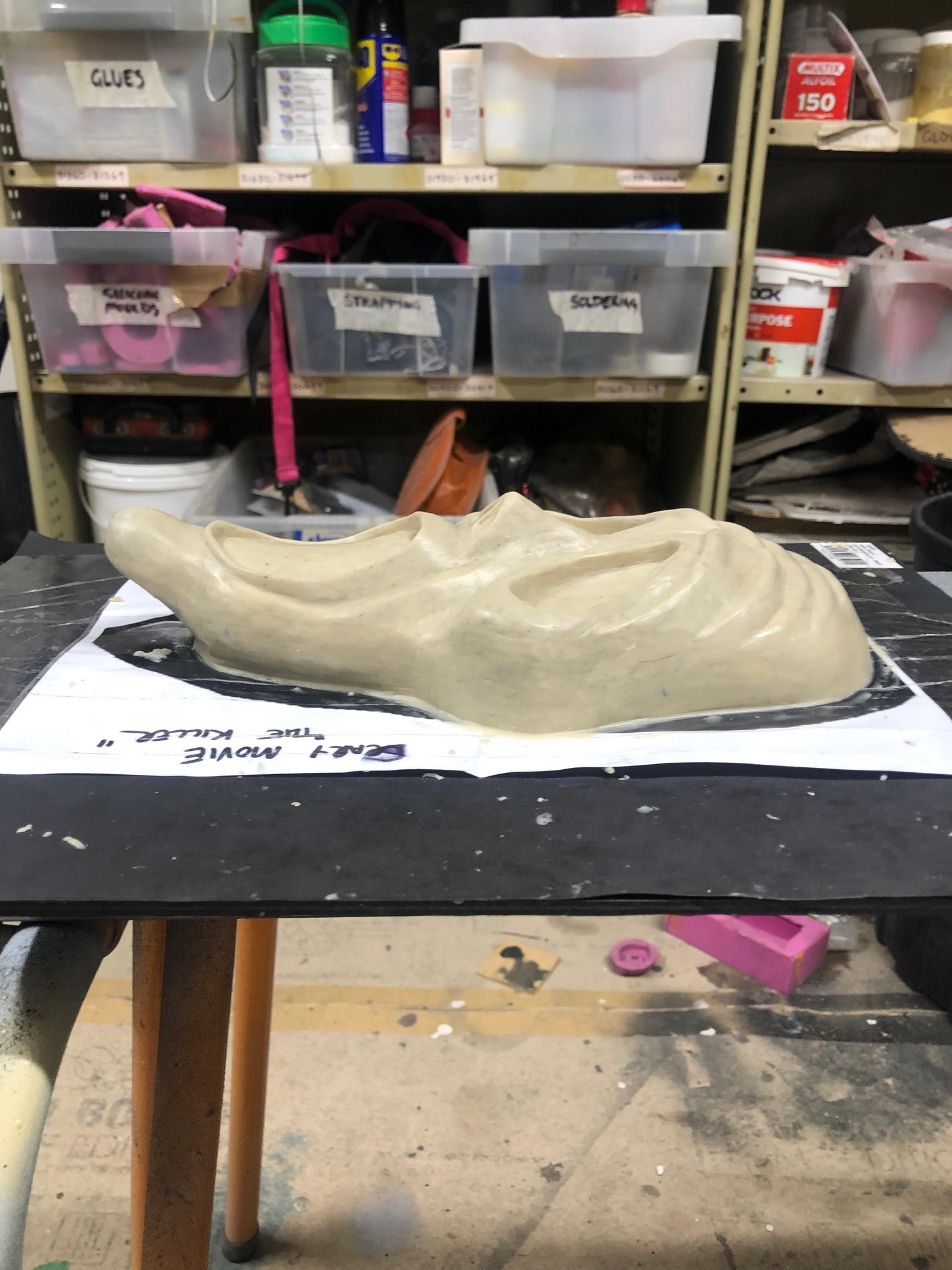

I don't have a whole lot of work in progress images as I tend to zone out as I start, but I'd roughly scaled the mask in the above image to full size, and stuck it down to my board, this gave me a base shape and proportions to work from, and I built up from there

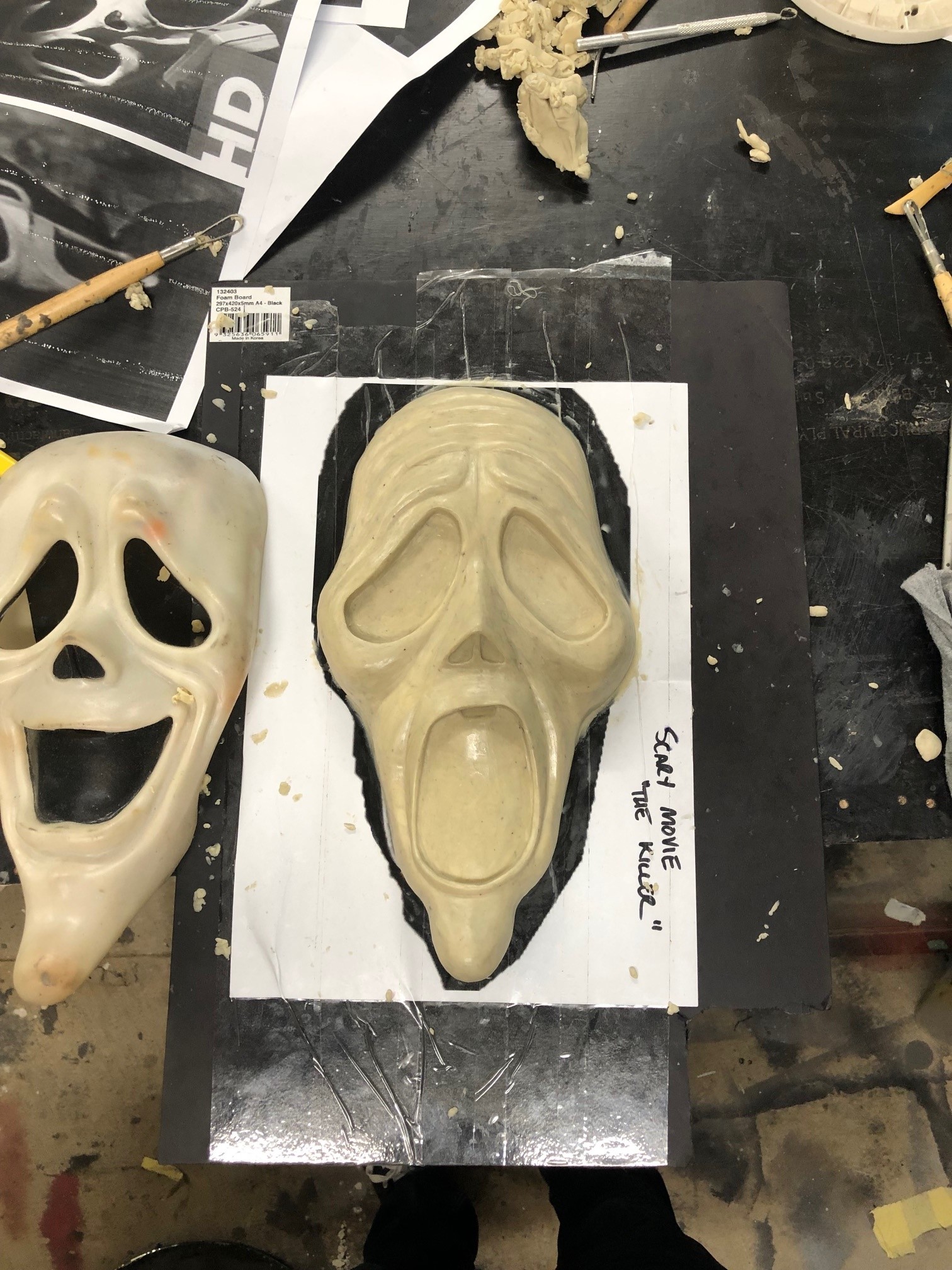

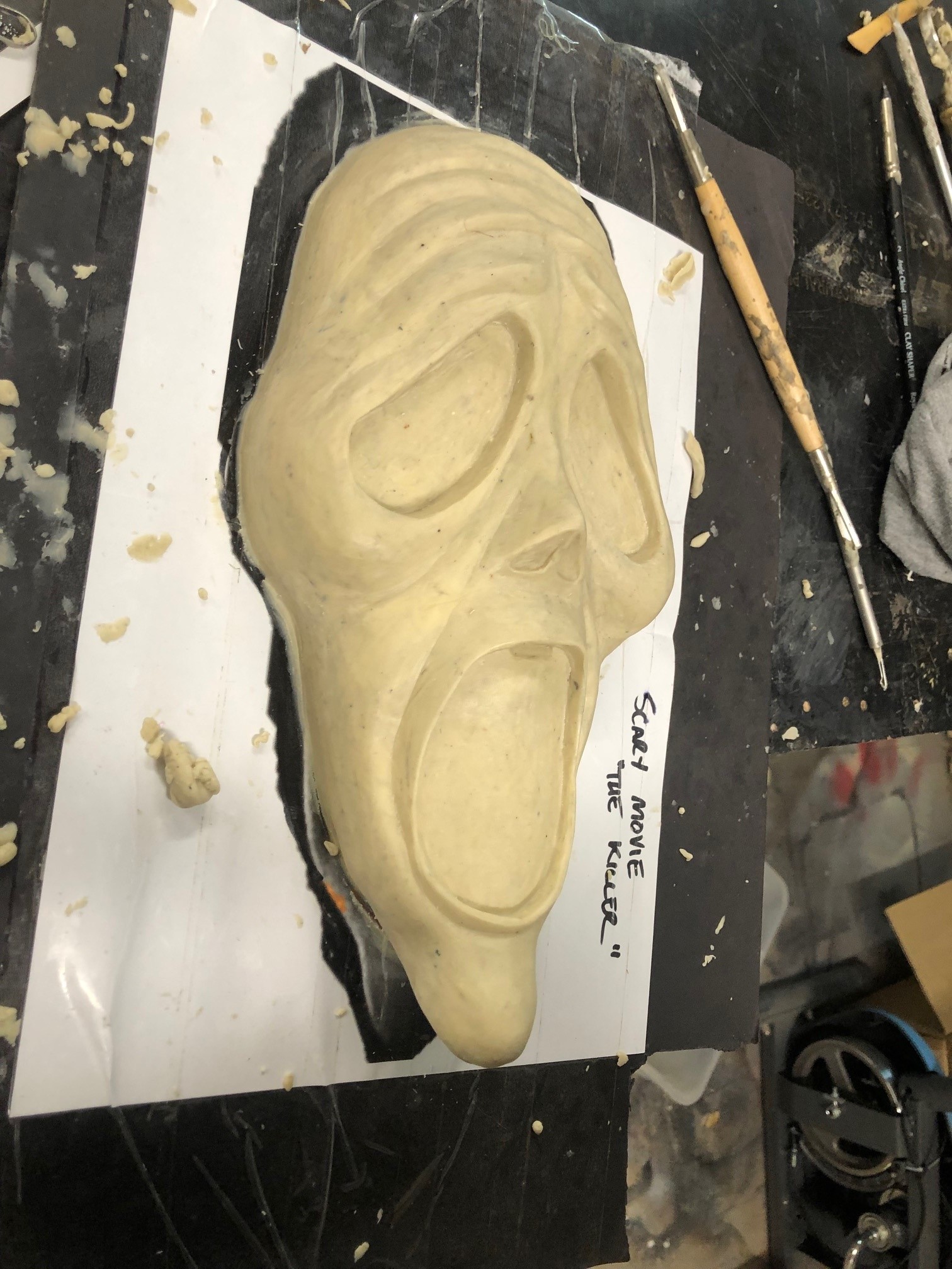

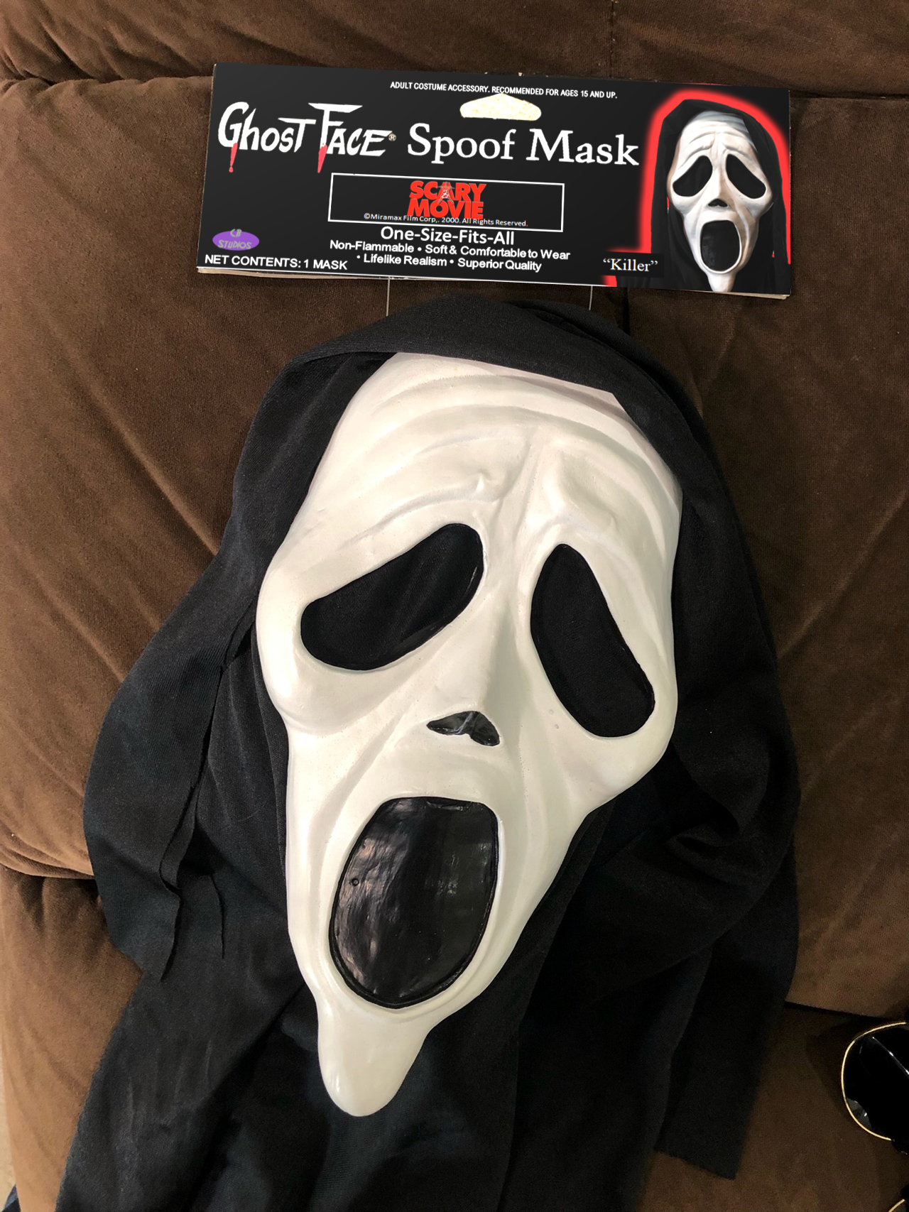

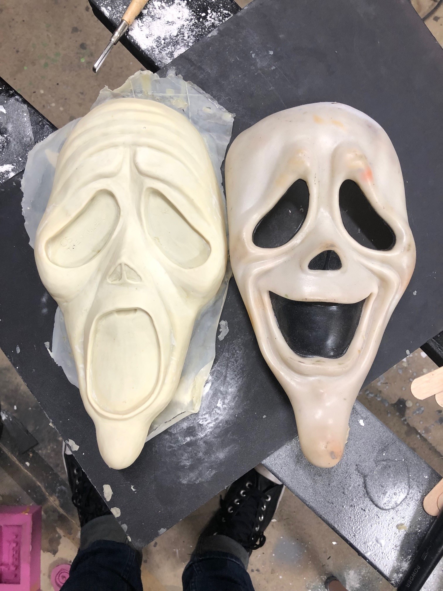

After 4 or so hours of blocking out, checking reference and using an EU mold mask and a official Smiley mask as visual reference, we had something close to what I wanted.

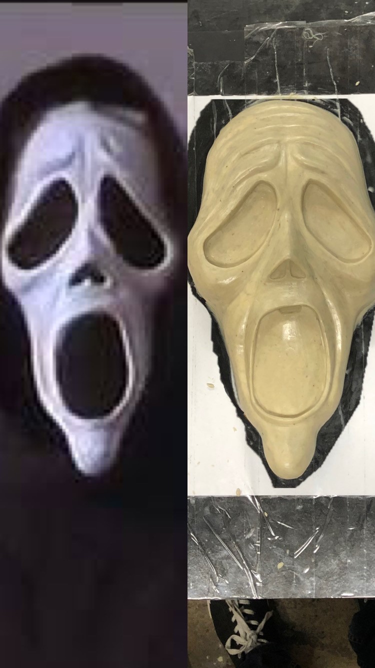

A quick side-by-side showed that the eyes and the jaw still needed some tweaking. Every single reference photo of this mask looks different, so I had to pick one look and go with that.
If you've stared at the screen used mask as long as I have, you'll notice that the mouth of the mask isn't rubber like the standard Ghostface masks, but is the same fabric as the eye mesh. I've decided to sculpt the mouth solid with the little Funworld breathing hole at the top, so it will visually match the licenced pieces. I may do a mesh one for screen accuracy, but this way I can have either or.

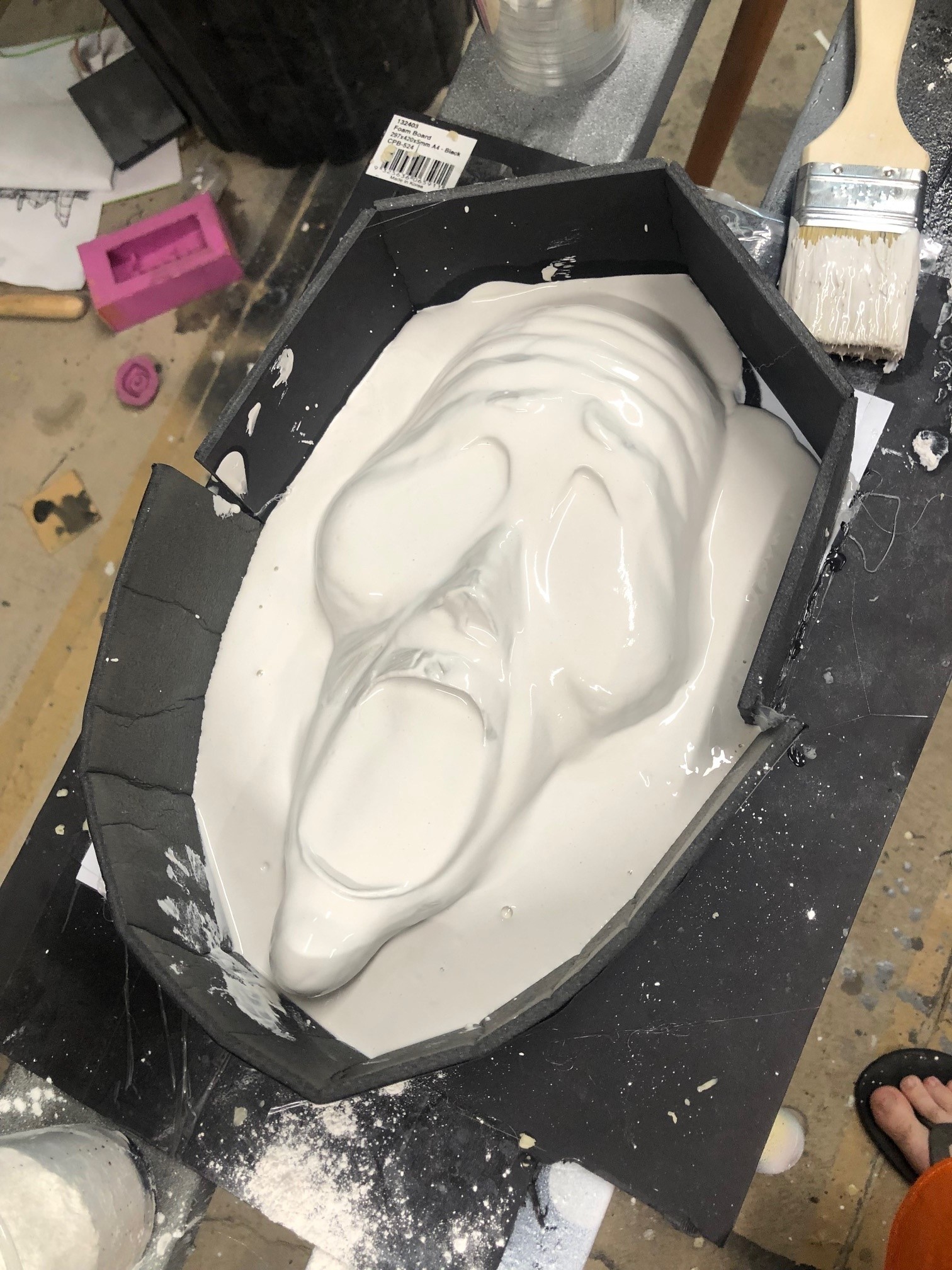

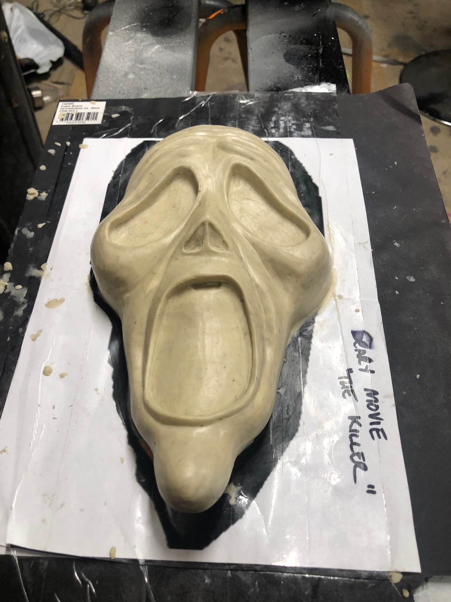

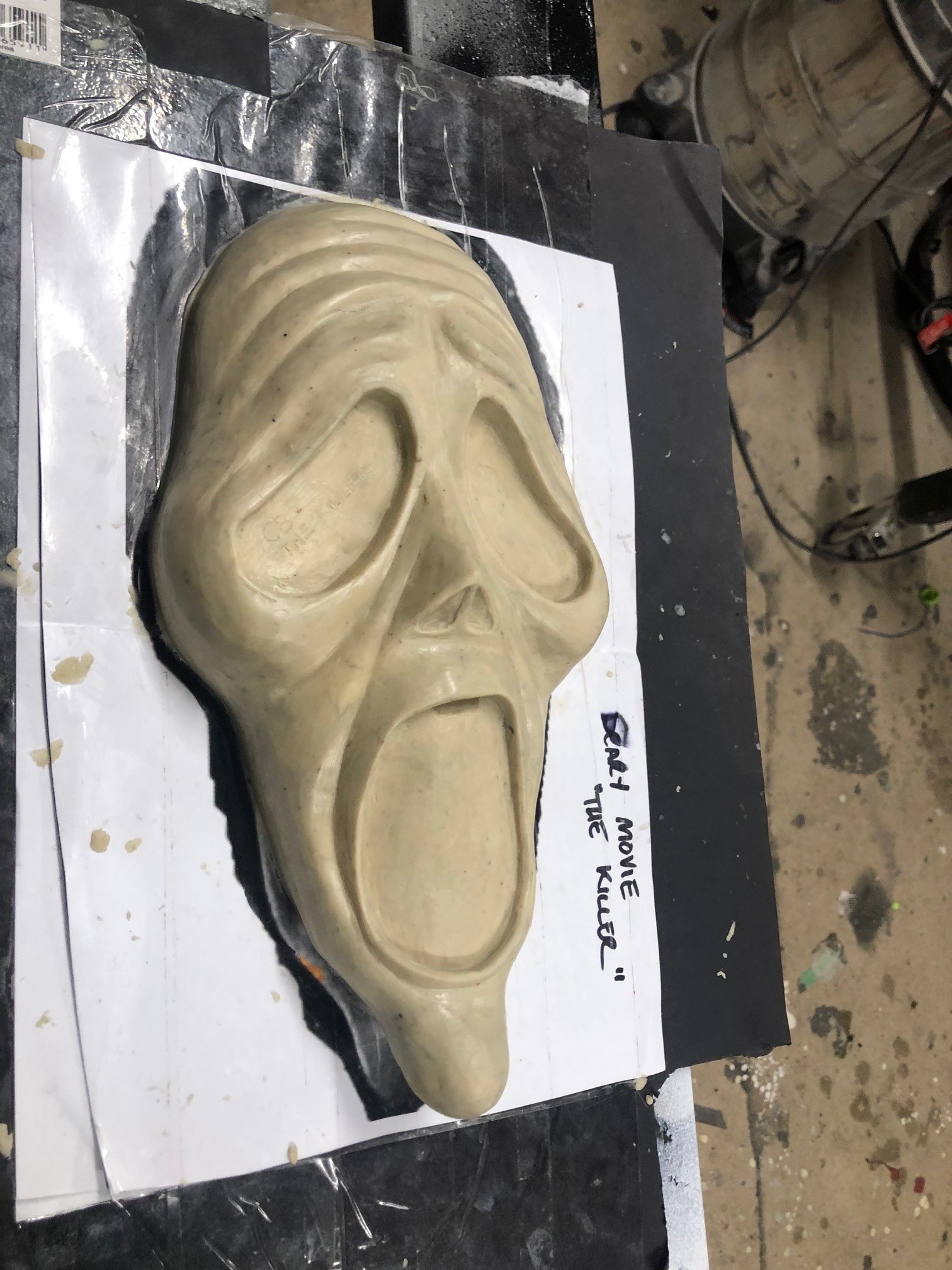

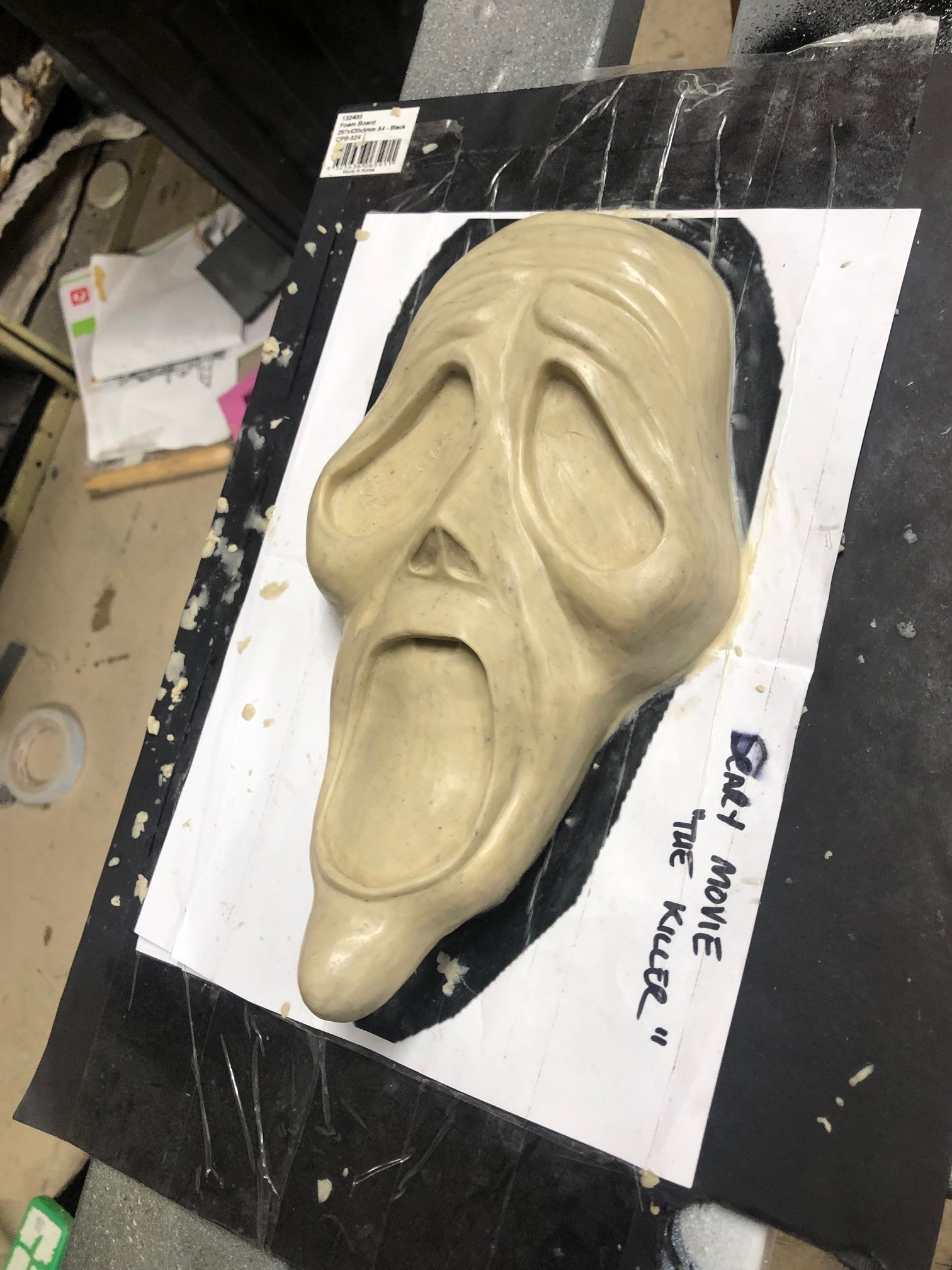

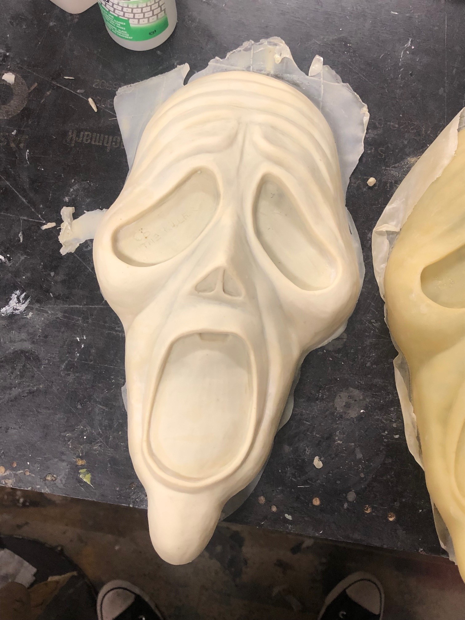

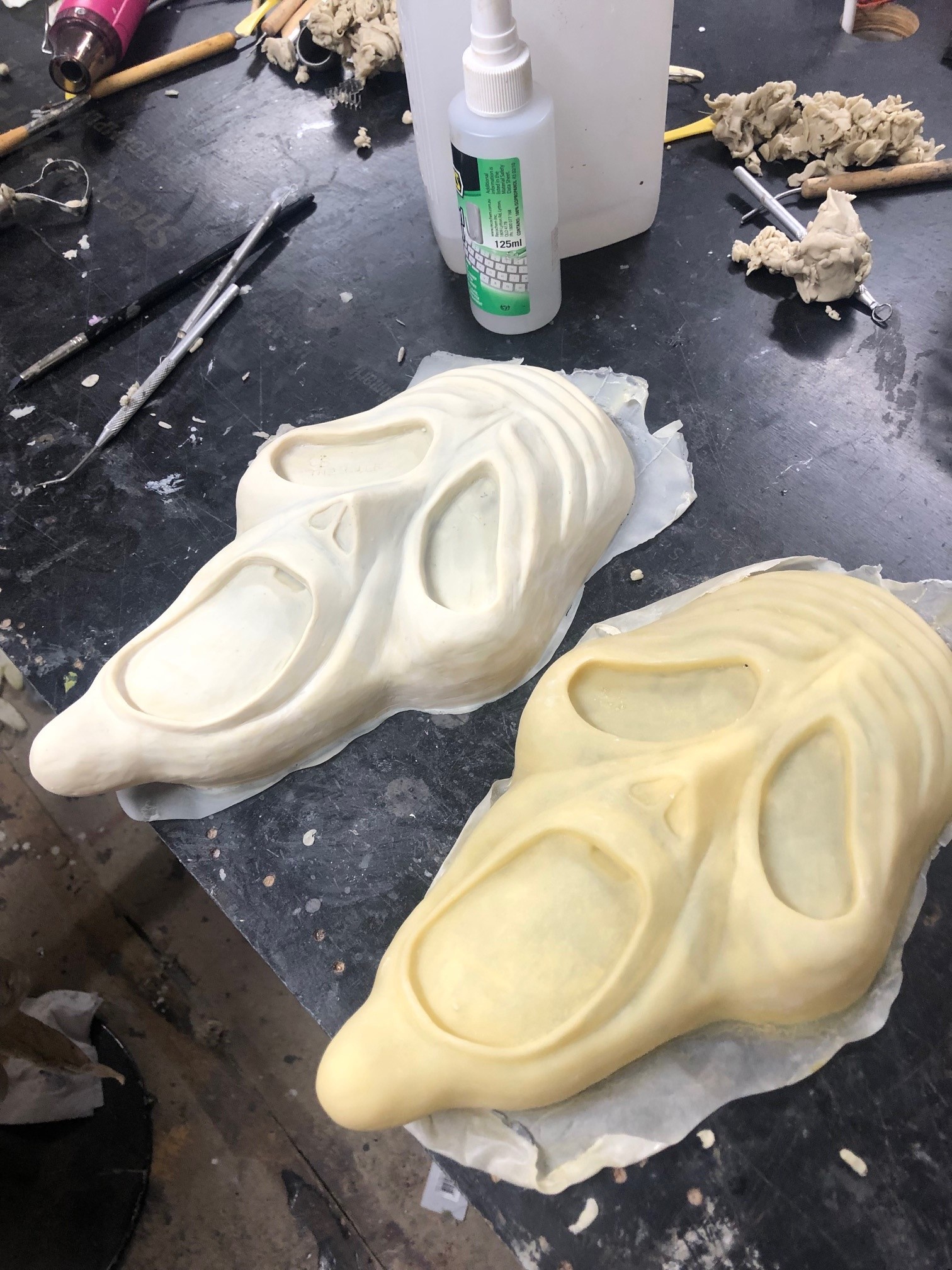

Sculpting finished, and surface smoothed and refined. Next up he sleeps with the Hydrocal fishes.

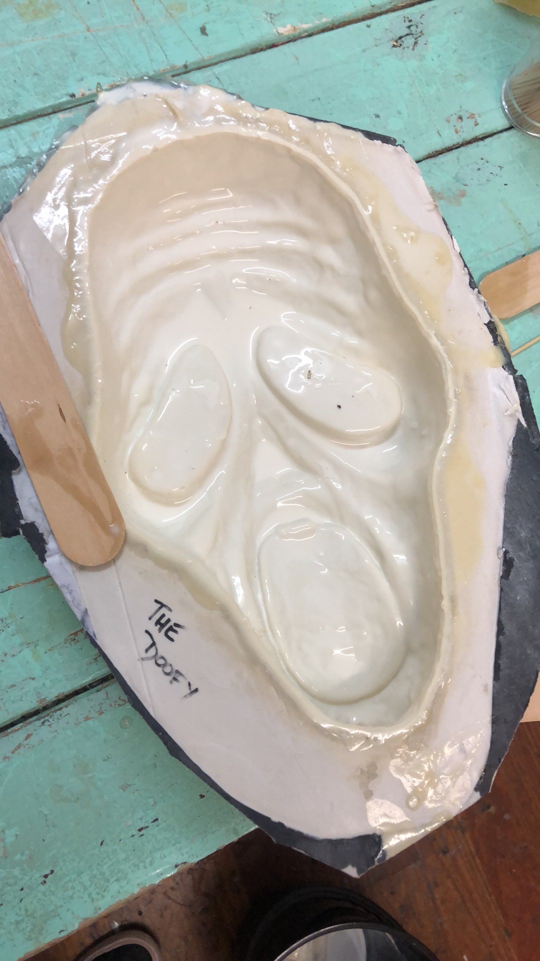

Time for a splash of that ol' white.

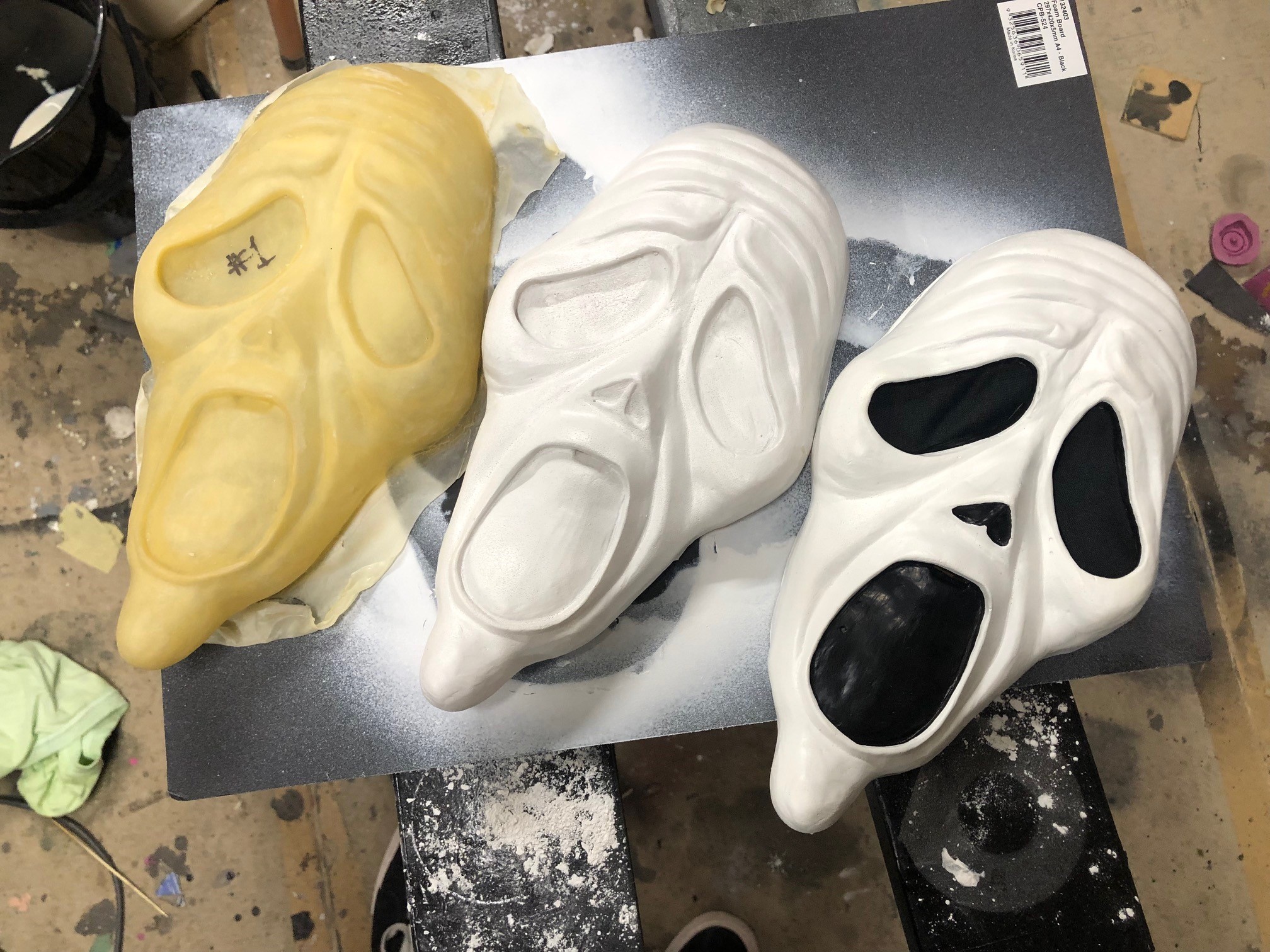

And then the exciting part, I ran a cleaner pull in some spare latex, and got to see how it looked in rubber. This shot next to a busted 2000's smiley I'm whitening and repairing shows the overall scale and size well. I'm super happy with this.
and finally, some shots of my test casts. Working out the dwell time for the thickness I want is important, as I want these to feel as legit as possible.
Next post will hopefully have some painted whites and blacks, and maybe even some hood construction.
An important thing to note is that I'm NOT making these to sell, this is purely a personal project so no blanks or finished masks are gonna leave my workshop.
stay tuned for more!

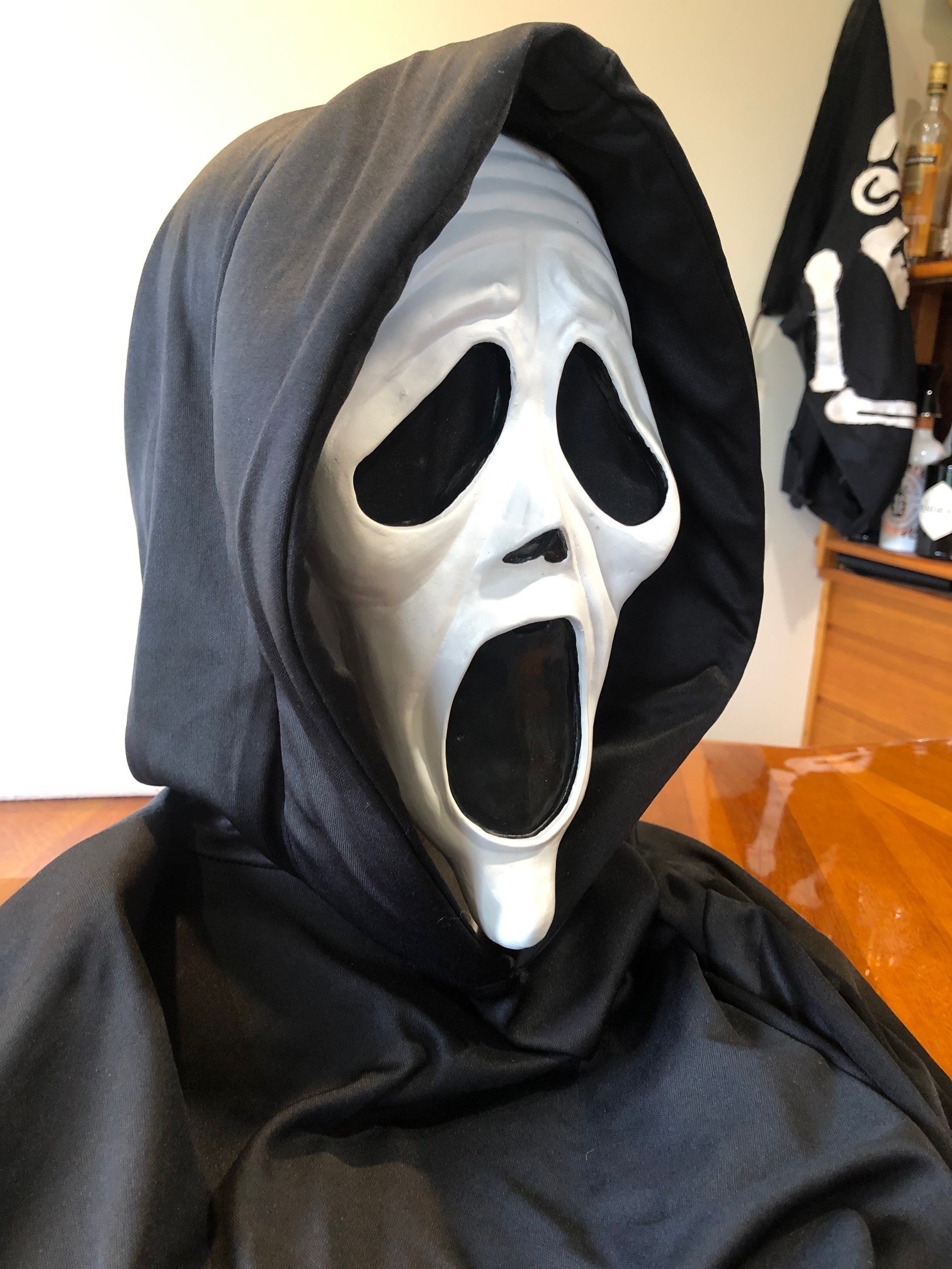

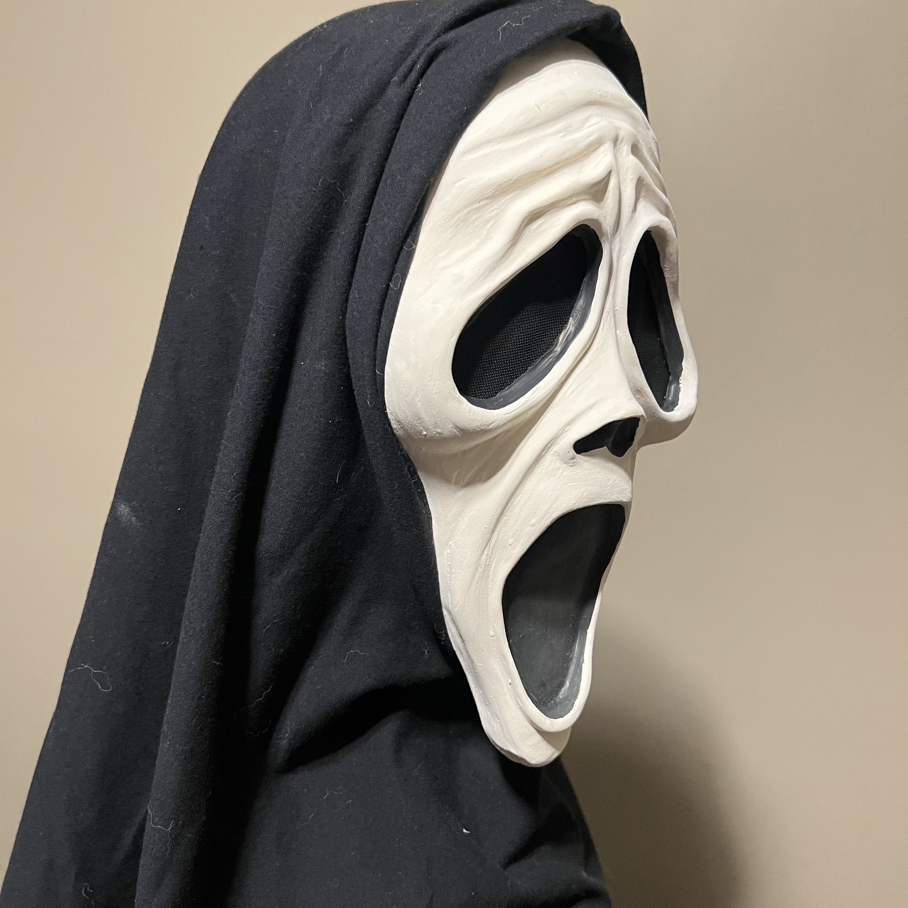

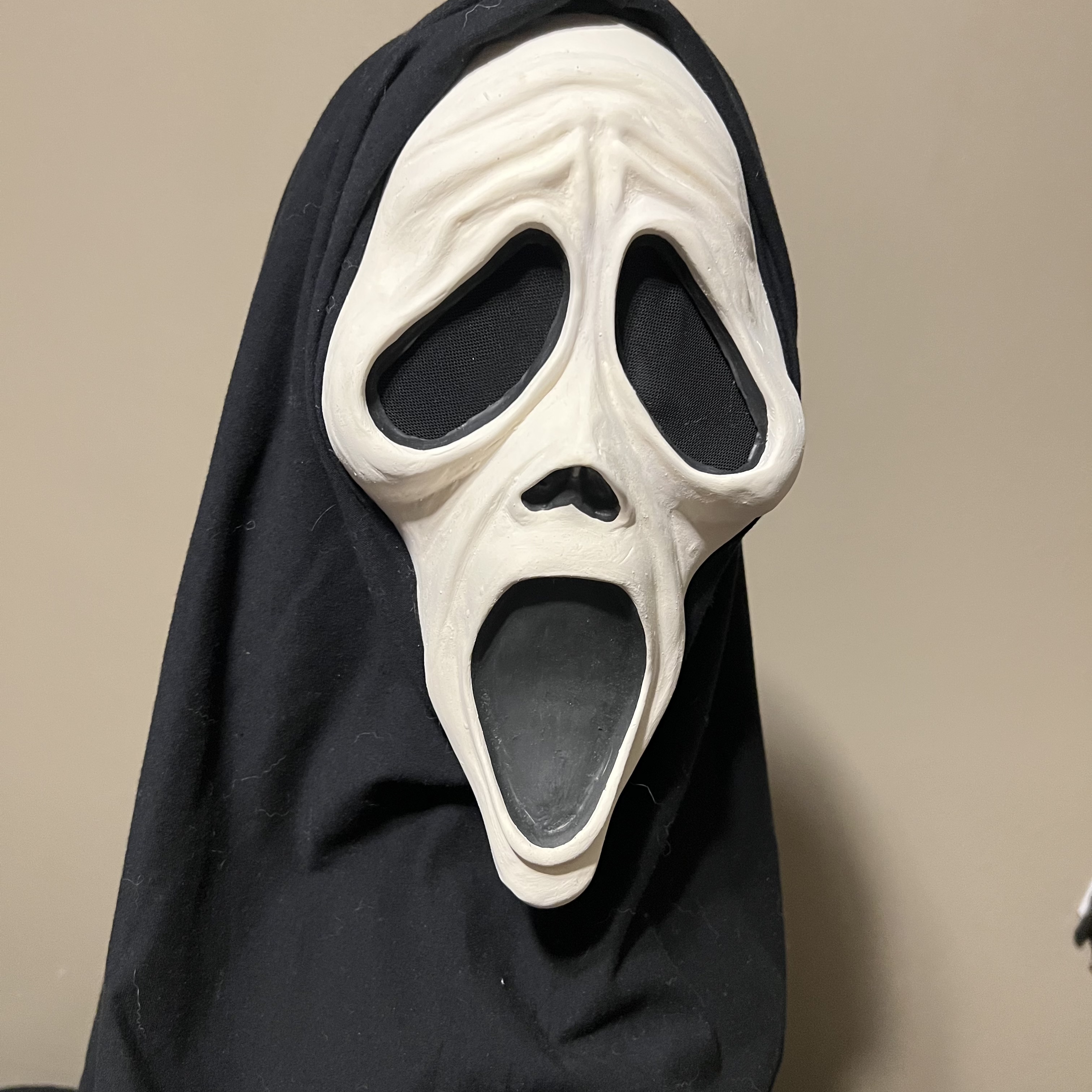

Ok, so some progess.

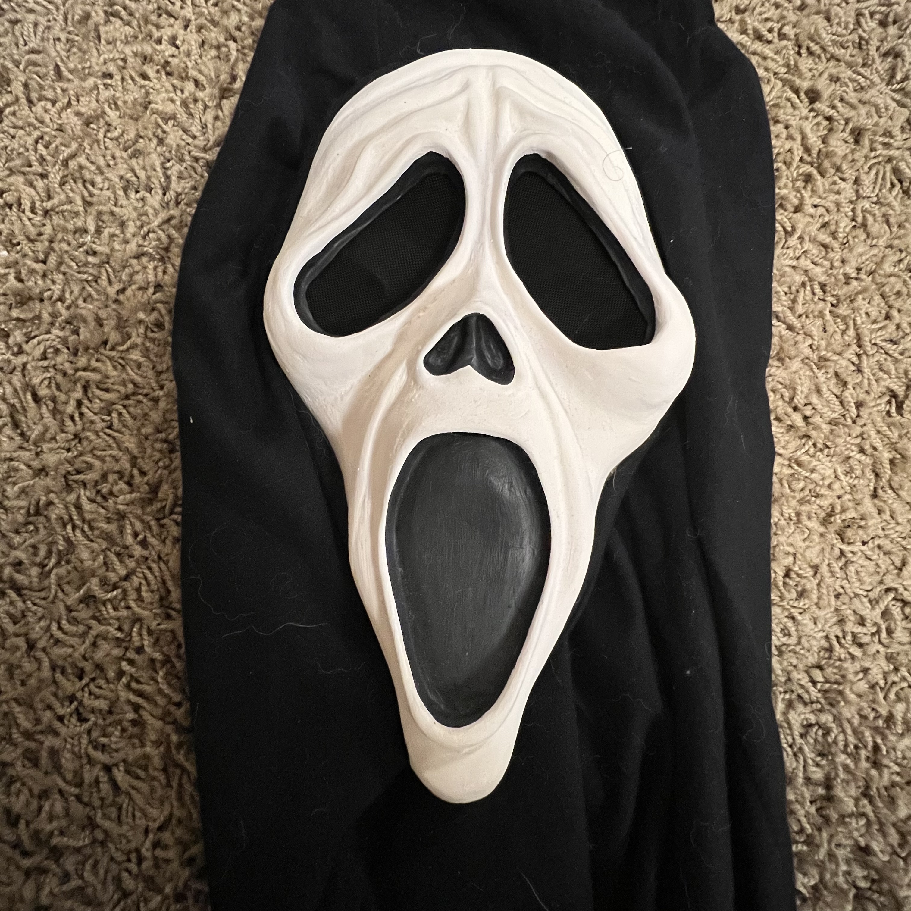

Here's a lovely shot of some curing latex in the hydrocal mould. I found that dwelling it for 2.5 hours was about right for what I needed thickness wise.

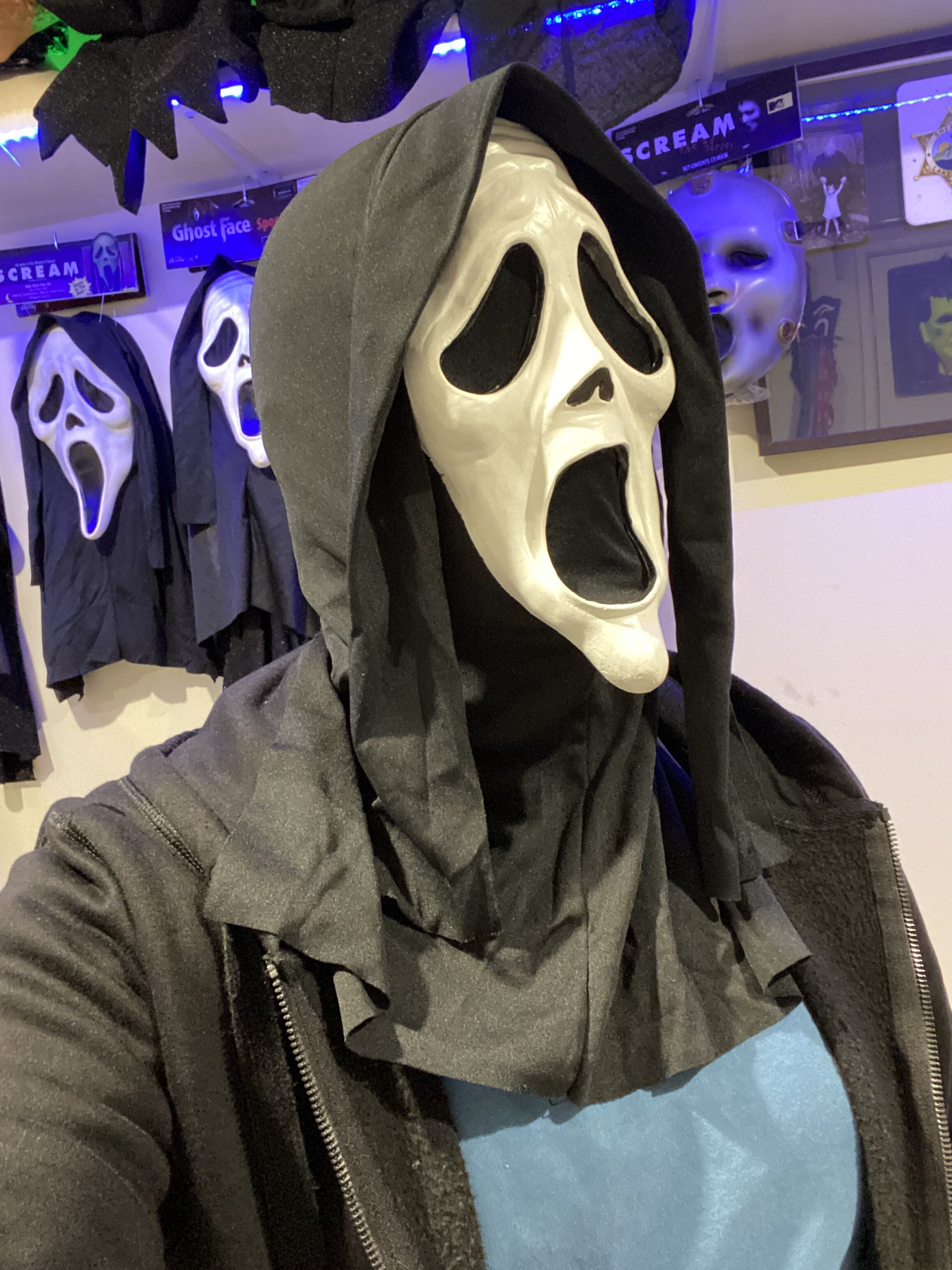

Once I'd gotten a cast I was happy with, I shot it with two even coats of White Plasti-dip. This stuff bonds great to latex, protects against UV pretty well and gives a great even cover. Its pricey as **** here in Aus, but sucks to suck I guess. The eyeliner, nose and mouth paint was also done in Plasti-dip but hand brushed. I trimmed some nylon for the eye mesh and stuck it in with e6000.
A test fit in a Fun World robe, looking REALLY good now.

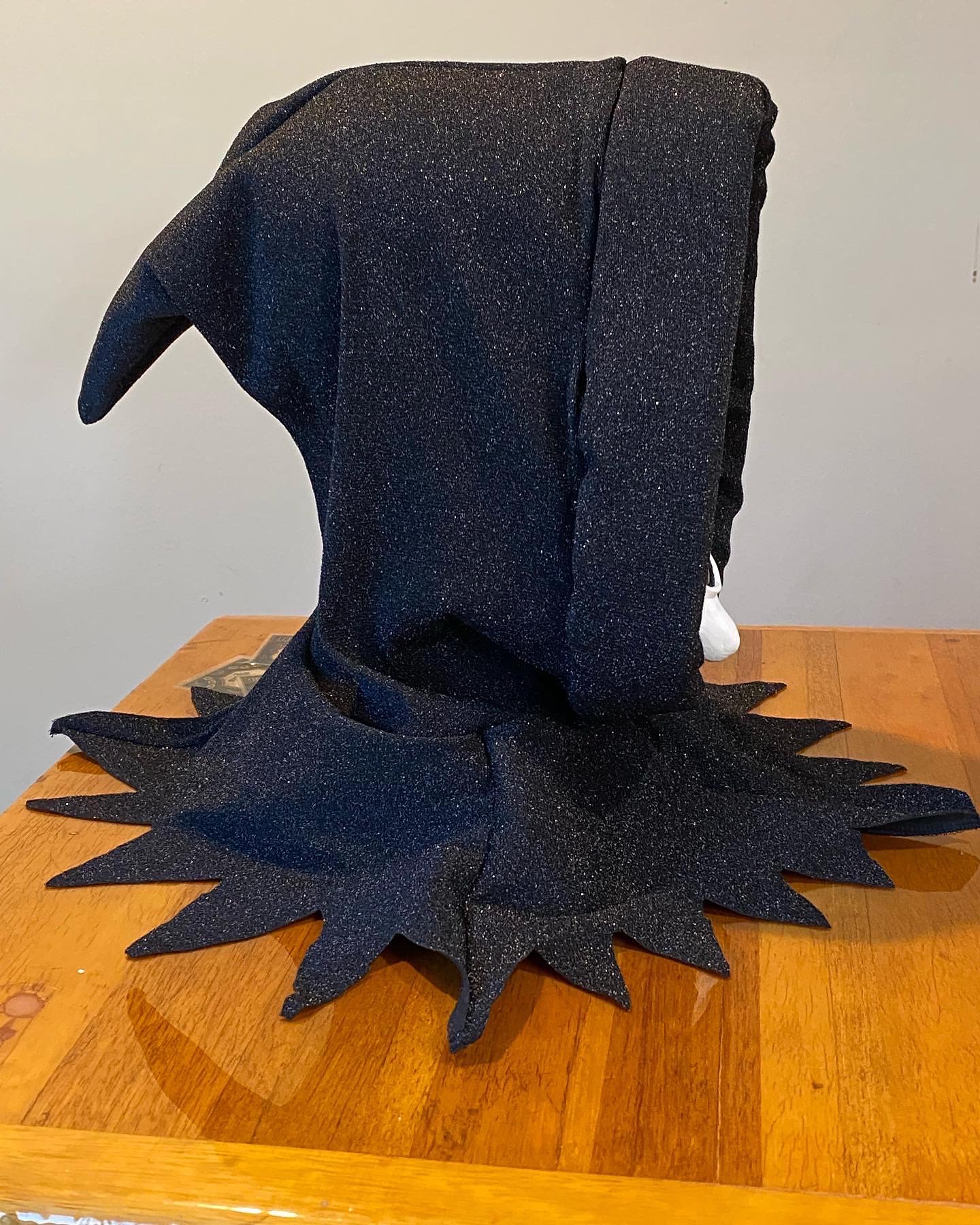

I used some fabric from a halloween Ghostface style costume I've had kicking around in the shop, and sewed up a rough shroud to mimic what the Funworld masks have, complete with tassels, and stitched it to the latex face. Its a bit rough as its only a test, but looked pretty great to me.
and Finally, a shot with a digitally mocked up tag.

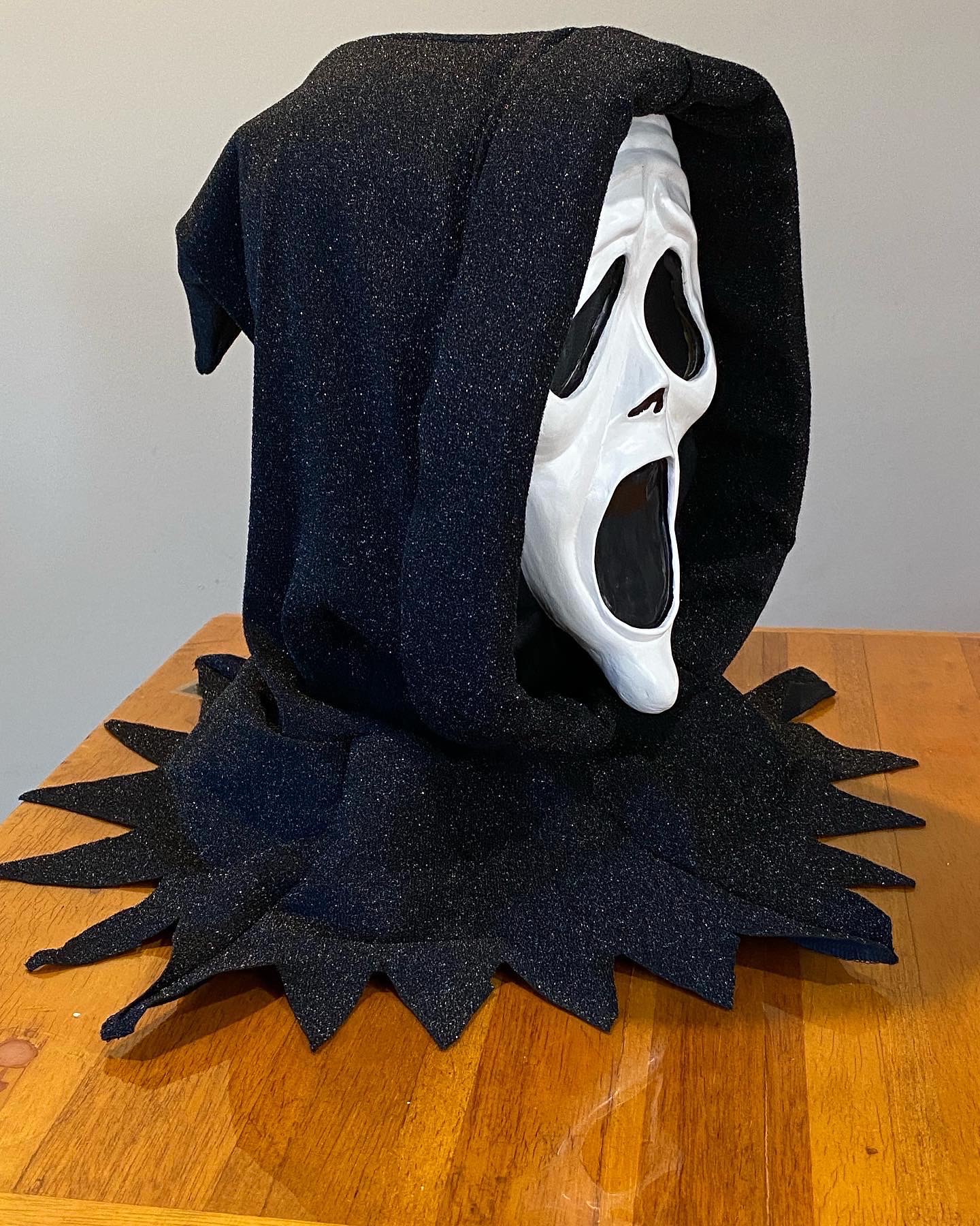

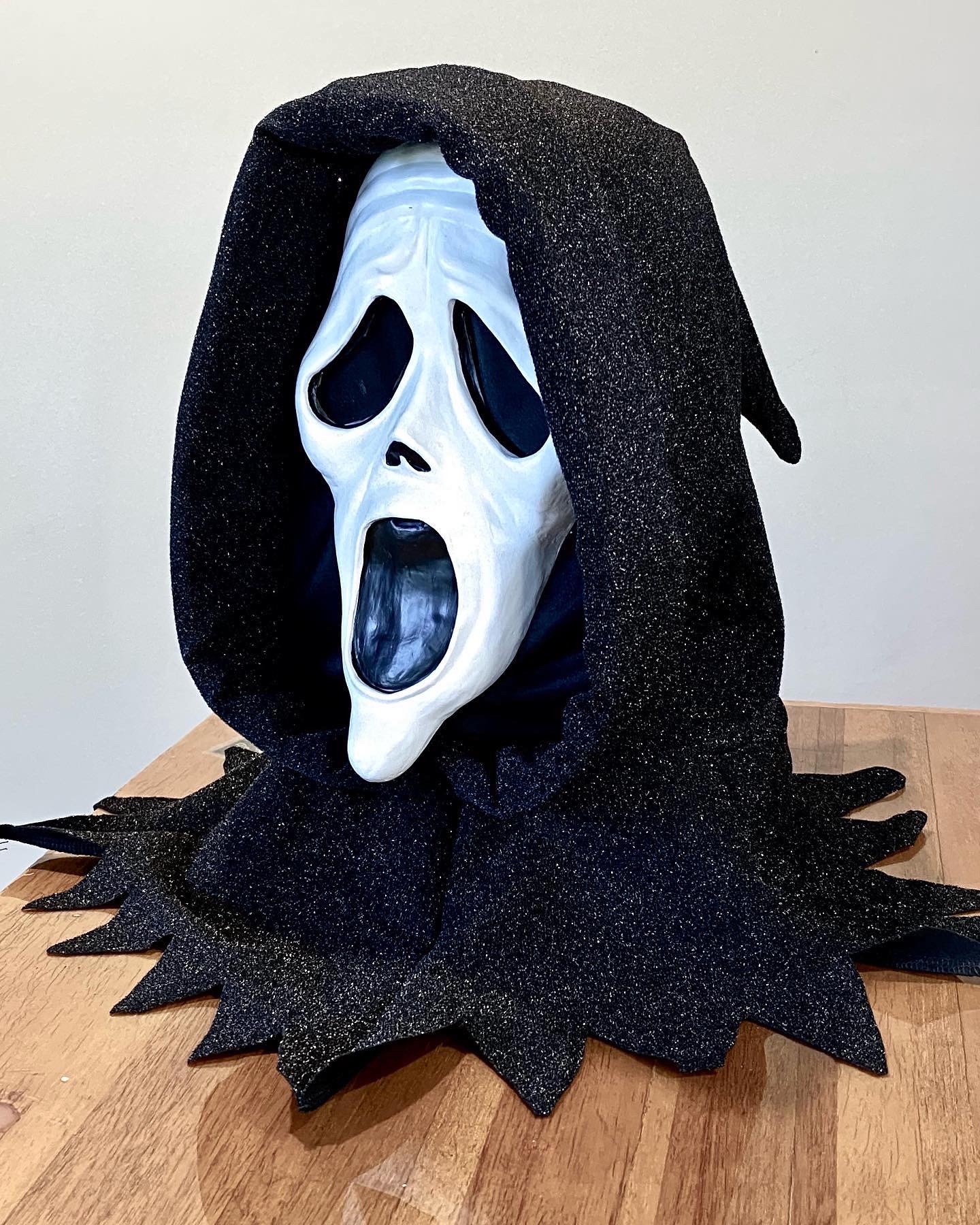

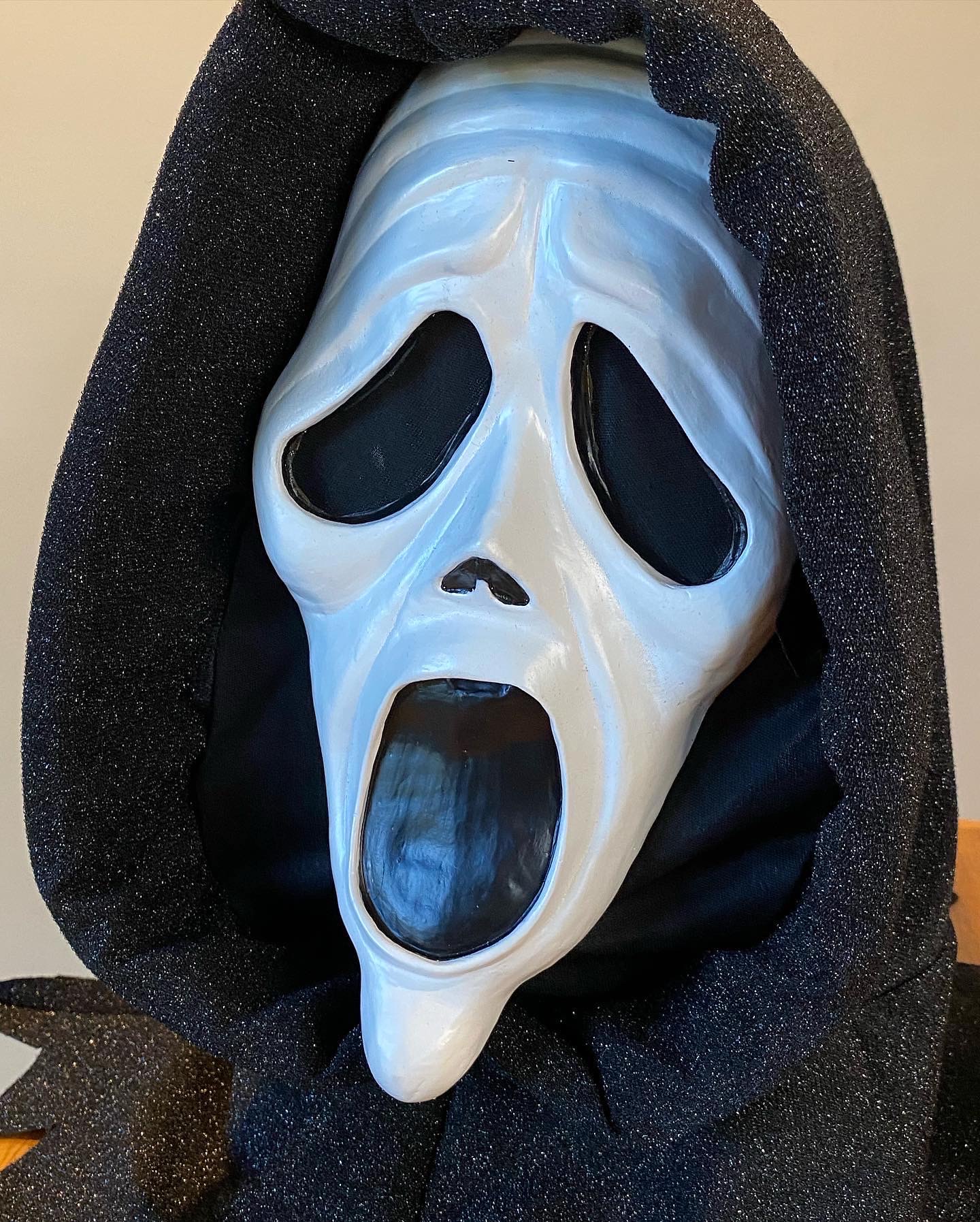

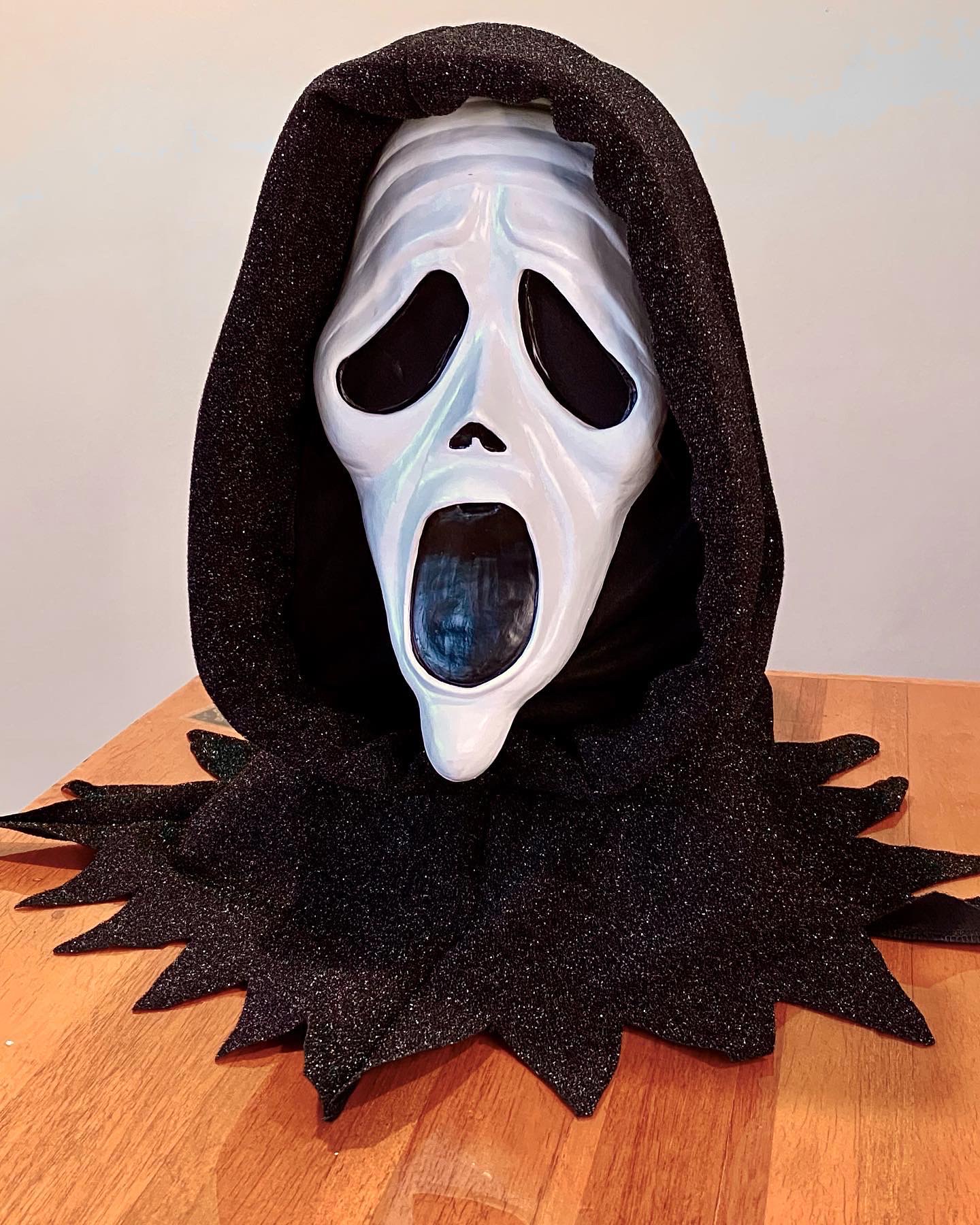

Just a little update, I made a 25th Anniversary style Sparkle hood for one of my doofy casts, i decided to name it the Doofus Deluxe, and I've now got a youtube video showing both these masks off!

Is this the right section? Is a mask a prop or a costume? Has god forsaken us? Whats your favourite scary movie? I have the answers to only one of those questions.
View attachment 1542069View attachment 1542070View attachment 1542071
View attachment 1542073View attachment 1542074View attachment 1542075View attachment 1542076View attachment 1542077View attachment 1542078

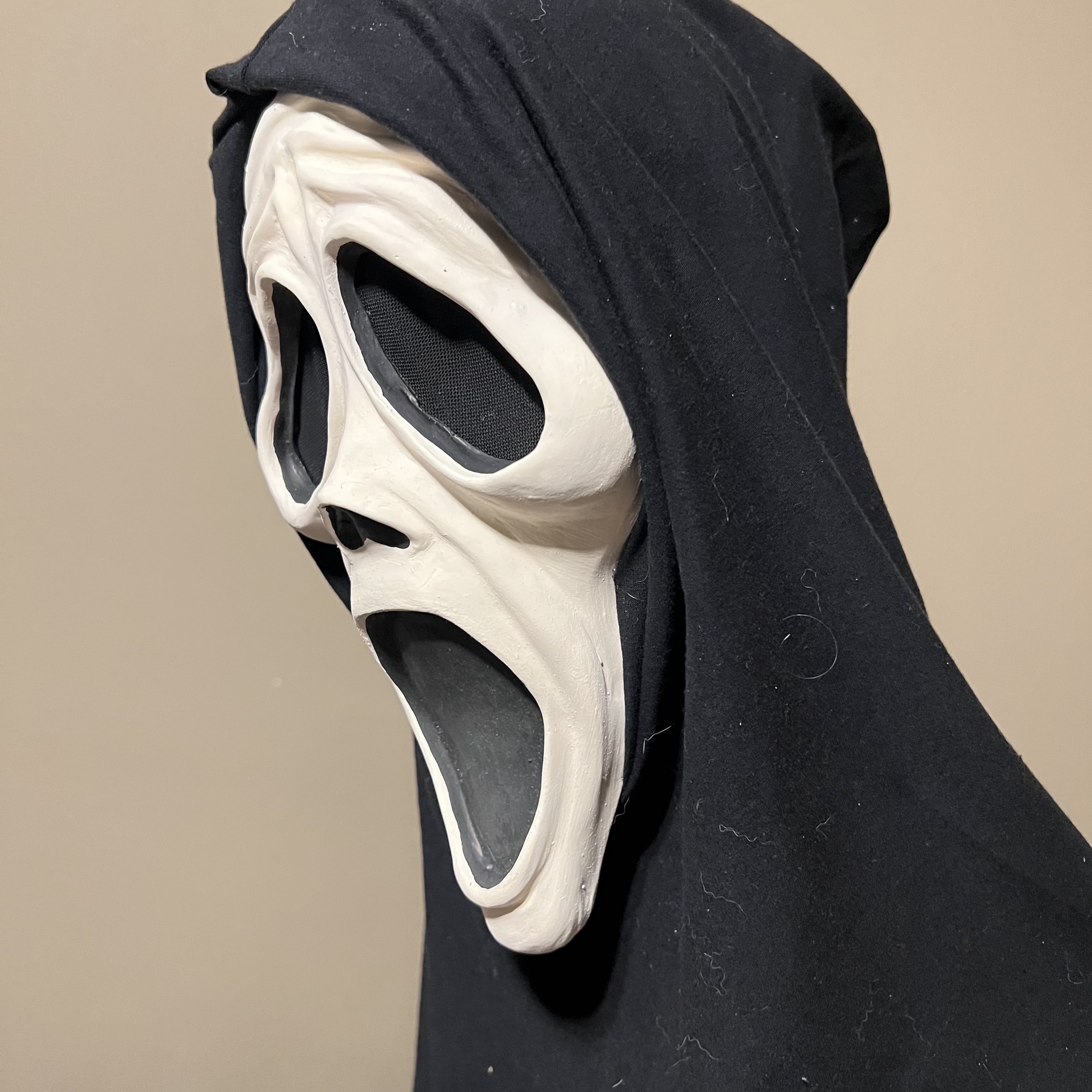

View attachment 1542081View attachment 1542082

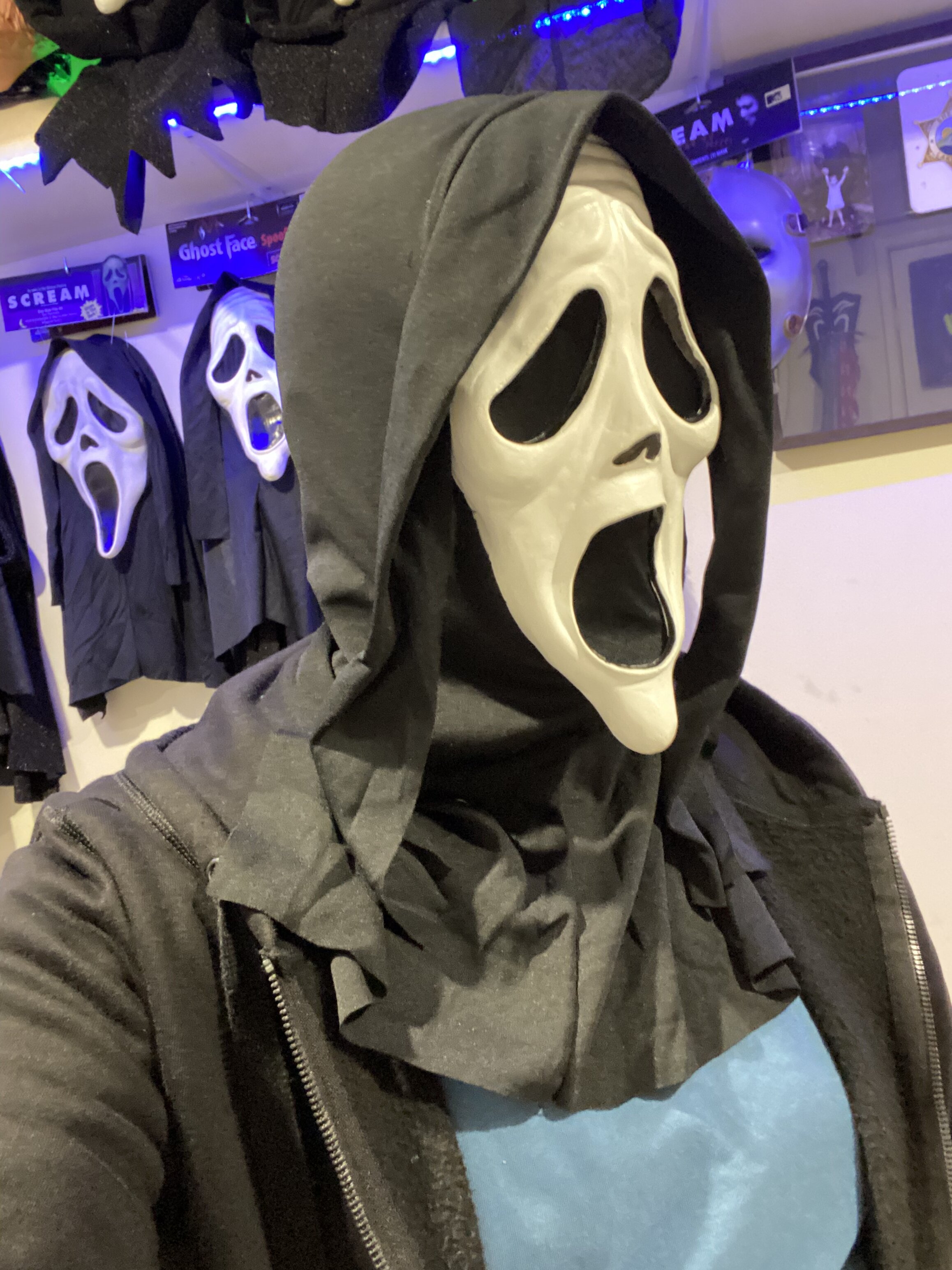

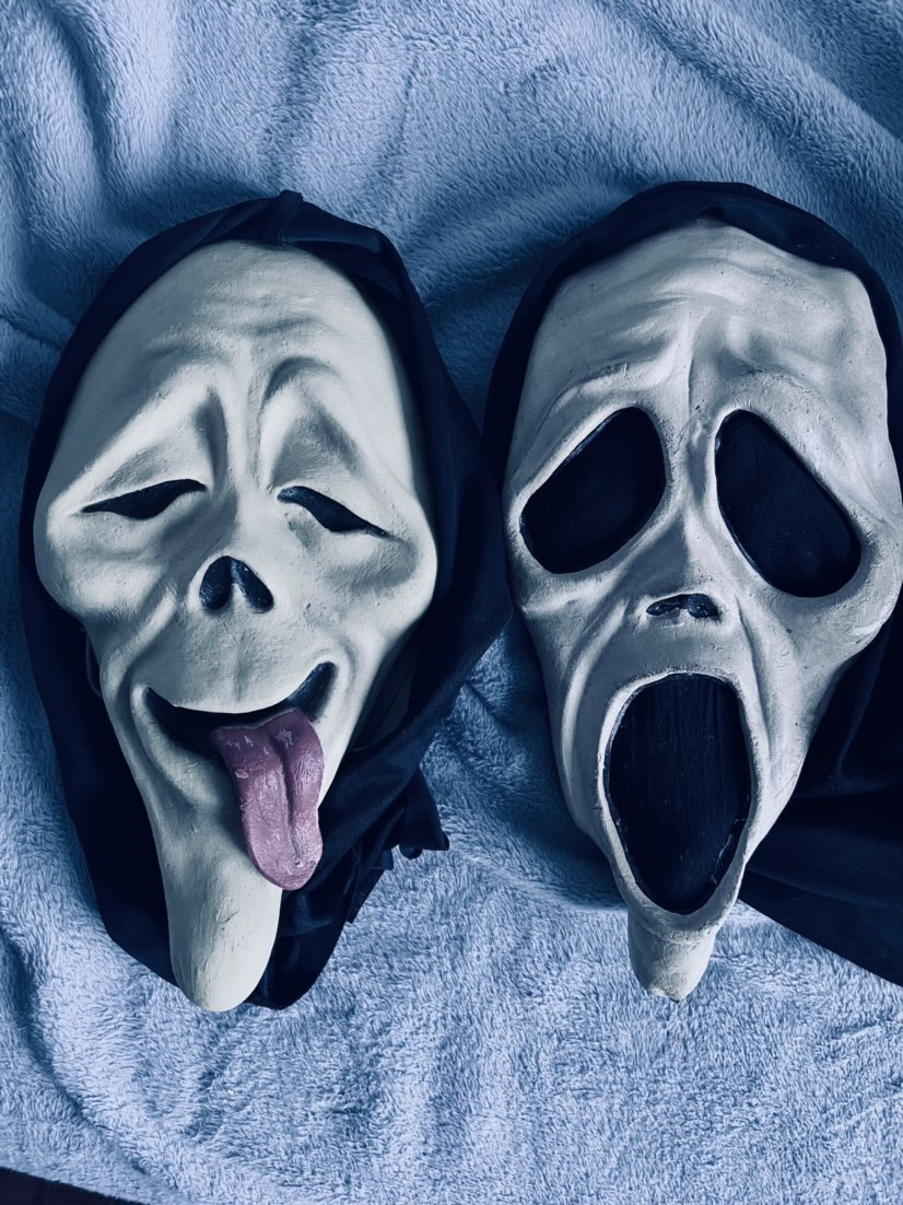

I own both of my screen worn masks. The reason the mouth is fabric is because I did the voice live and improved most of it. So we cut the og foam latext mouth and places fabric. This altered the shape of the mouth (and overall mask) the solid mouth original look and shape of mask was closer to Scream GF - it is only featured me wearing it in one seen outside the school standing by the tree- you will see what the mask looked like before we cut the mouth out and I also pulled/tied the masked tight- (resulting in altering, stretching the mouth wider)) so that it would not shift during any of my fighting or physical comedy scenes.

I didn’t post pics, not sure why, but I made a custom sparkle hood like the new 25th anniversary Ghostface masks and it looks like a million bucks. Ghostfaced I think you may have seen these on my ghostfacedownunder instagram.
