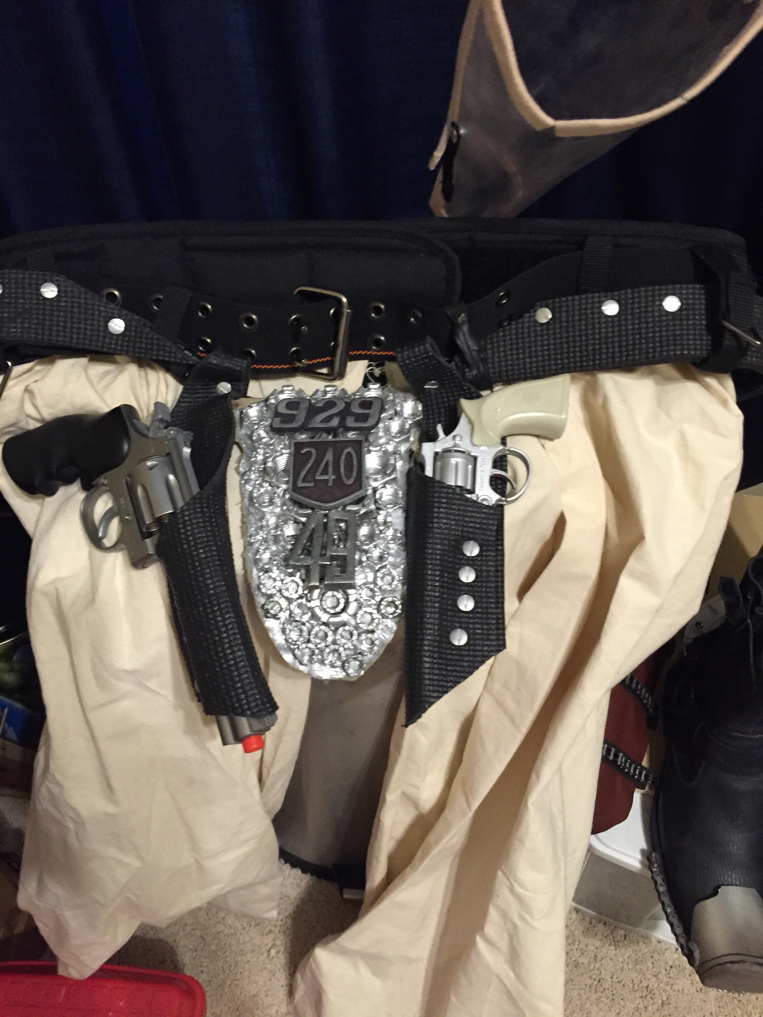

Everything looks good but your 929 and 240 badges are missing the black on them. Both have a black background around raised chrome numbers and edges. Just take a gloss black paint and a small brush to fix it.
Also your 500 chest badge should be gold or brass colored as the background with the 500 silver. Small things but easy to fix. Otherwise really good looking.
