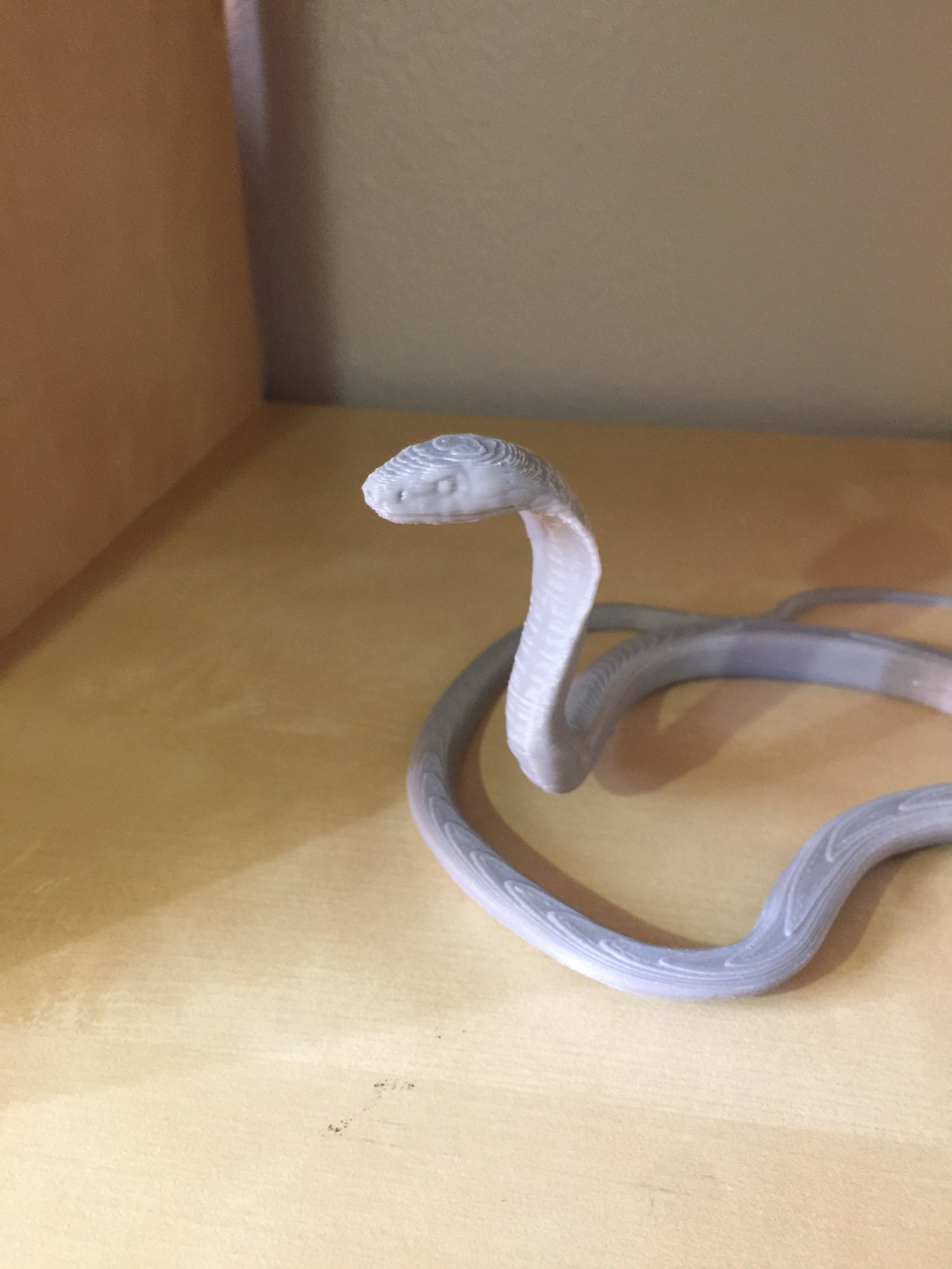

Ok, like I said, I’m not that great at documenting my projects, so sorry for the wait.
So in the last few days, I’ve printed a spool holder, a horse, a slug, and a snake. The horse was my first print that needed supports, and I learned that I need to fiddle with settings in cura to get my supports to work better. They stick so badly that the legs of the horse broke off and I had to glue them back on. The slug, spool holder, and snake were all from thingiverse, and mostly printed ok. The spool holder warped a little, but I found that I all I needed was better adhesion. The slug printed seamlessly, and I used supports for the snake, and they still stuck pretty badly. So quick question, If anyone has cura, what settings do you use on the supports?
The snake is about 4 inches tall, the horse is about 2 inches tall, and the slug is about 4 inches long.

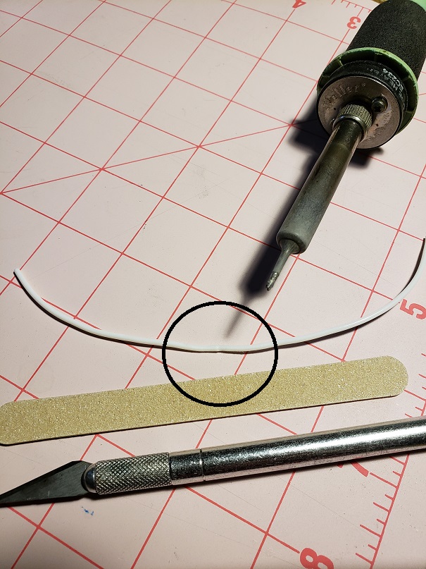

For me, the best way to adhere a new filament roll to another is to use a Hot Iron and fuse them together to make one.
I cut both ends very flat and even so they will melt together well.
NOTE: Be absolutely sure you do not let go of the end of the filament of the NEW roll because if it coils back in and goes under another twist of the filament, it will be tied in a knot and will not come off the spool properly and will bind.
After the filament ends are heated at the same time and just to the melting point, I press them together (EVENLY) and then cut off the mushroomed effect area.
Then sand with a nail file until the correct diameter is achieved so it will fit in the Boden tube without binding.

Whenever I tried that, the filament always broke apart. I tried cutting it at an angle to have more surface area but as soon as I try and trim down the mushroom, it breaks apart easily. I'm using CCTREE filament. I tried a soldering iron, and a candleflame, but it was the same result.
