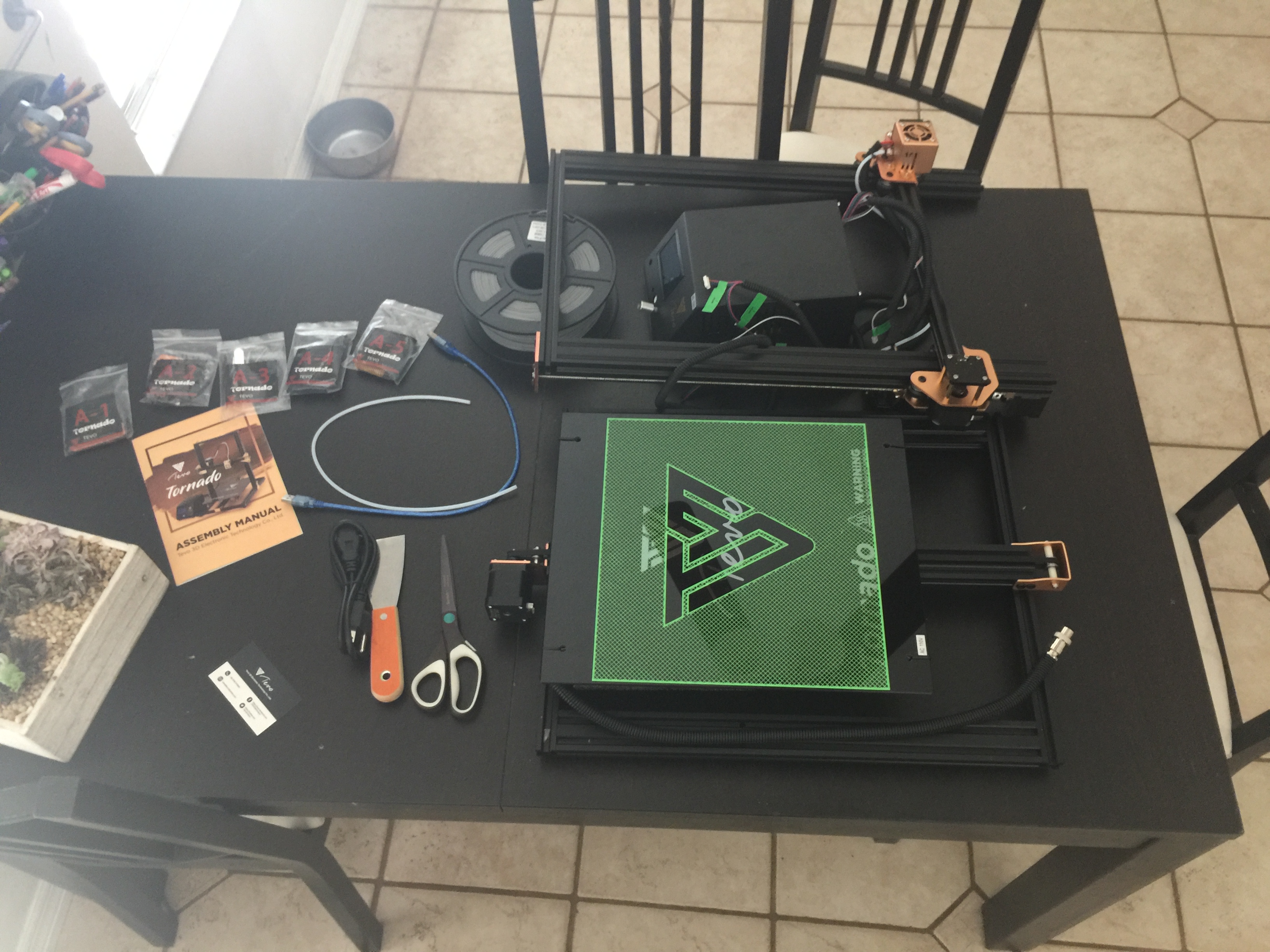

The Tornado arrived today, and I got it set up in about 10 ish minutes, but I was leveling the bed for almost an hour and a half. Afterwards, I printed the tevo test print that came on the sd card. There was also a pre printed tevo test that came on the bed to begin with. I’ve been busy since after that, so right now, I only have a picture of the unboxing. The filament that I ordered also came today, so I have a picture of that, too.
AEDDBE98-CC86-468F-8C82-002E4263EAE6.jpeg 921C2BB8-60A8-4526-A5A3-06903927945F.jpeg
Consider me jealous! I was hoping to get one for my birthday today, but no such luck.. Maybe Santa will get the hint
So, your first printings went well?
Also, does this version come with a DUAL Z screw drive?
What is your table (print surface) dimensions?
Post pictures of your prints when you can :)
