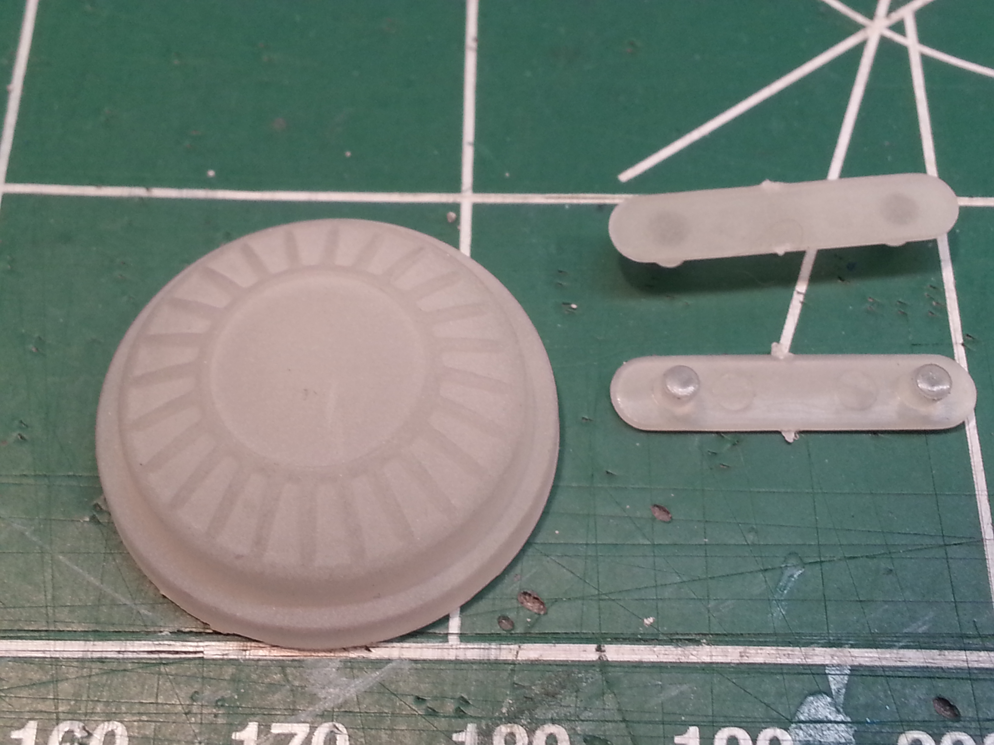

Looking good! How did you you frost the clear bits?
--Alex
Re: I AM A GLUTTON FOR PUNISHMENT!! - Dual 1/350 Refit build
Yep...same question...how do you frost the clear bits and do you do both sides?
Whenever I 'frost' my clear elements i just use a very fine grade sandpaper and only ever do the smooth inside, it always seems to do the job.
my trick involves sand, but not sandpaper. sandpaper leaves swirls & lines.
it depends on the piece, most of the time I do both sides.
So you don't want to share your method? I imagine you may be sand blasting or something lol.
Put the part in a bag of sand and shake it?

Ok, ok... Thanks for the interest, but please keep in mind that this is what I do for a living & some of these are trade secrets. Most of the time I will give hints to lead you in a direction.
This time I'll give it. Bradicus was correct, SANDBLASTER!
Nice. I figured you used a sandblaster. I have access to a sandblaster also in my line of work and I use it to frost clear parts. Yours had that look.
--Alex
--Alex
It's the only way to get that true frosted look with proper light diffusion.
Matte coats get it close & it looks kind of frosted, but the parts still never get good light diffusion.
Sandpaper might leave circles & lines that can be really visible when light shines through the part. This can be avoided by wet sanding with 800-1200 grit wet/dry paper. It does take some time to get the frosting even & it will never get into the nooks of small parts.
Most of the time I will frost both sides, especially if it's being painted for light blocking. Here's where sandblasting really wins out. It gives the surface a "tooth" for paint to grab on & flow evenly across.
If I want a window glass look with an even glow behind, just the back will be frosted.
Here's a good example:
These should look familiar as the impulse crystal, & part 256 E-hull windows.
Since the impulse crystal will have a painted frame & I want an super even glow both sides were frosted.
On the window I still want the glossy "glass" look, so just the back was frosted.
