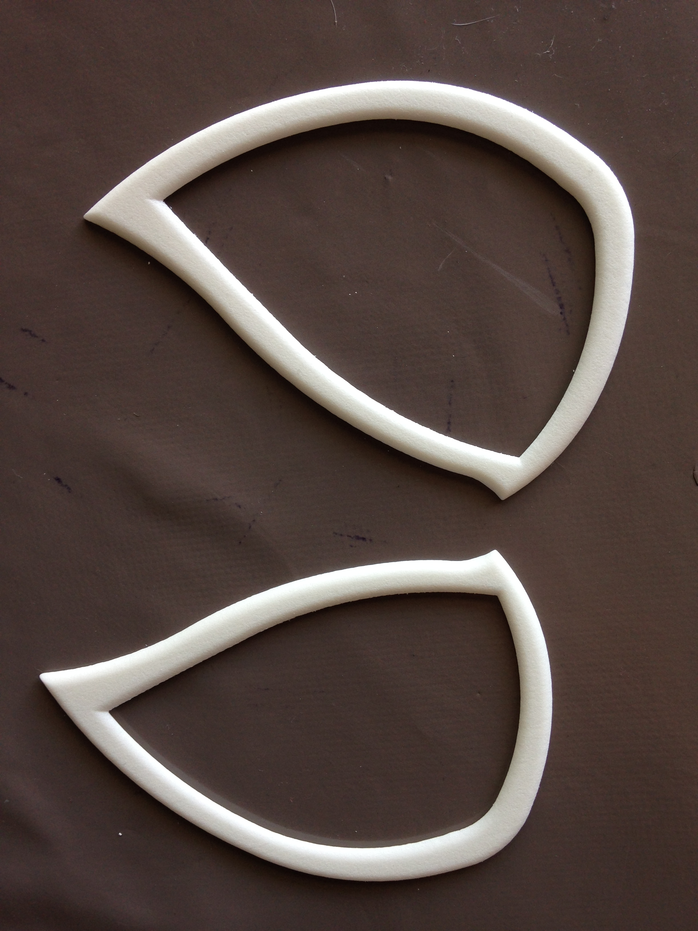

the frame : ( I take mine on shapeways ( thank to kelandrum )
Tasm2 Lenses by Lightman on Shapeways

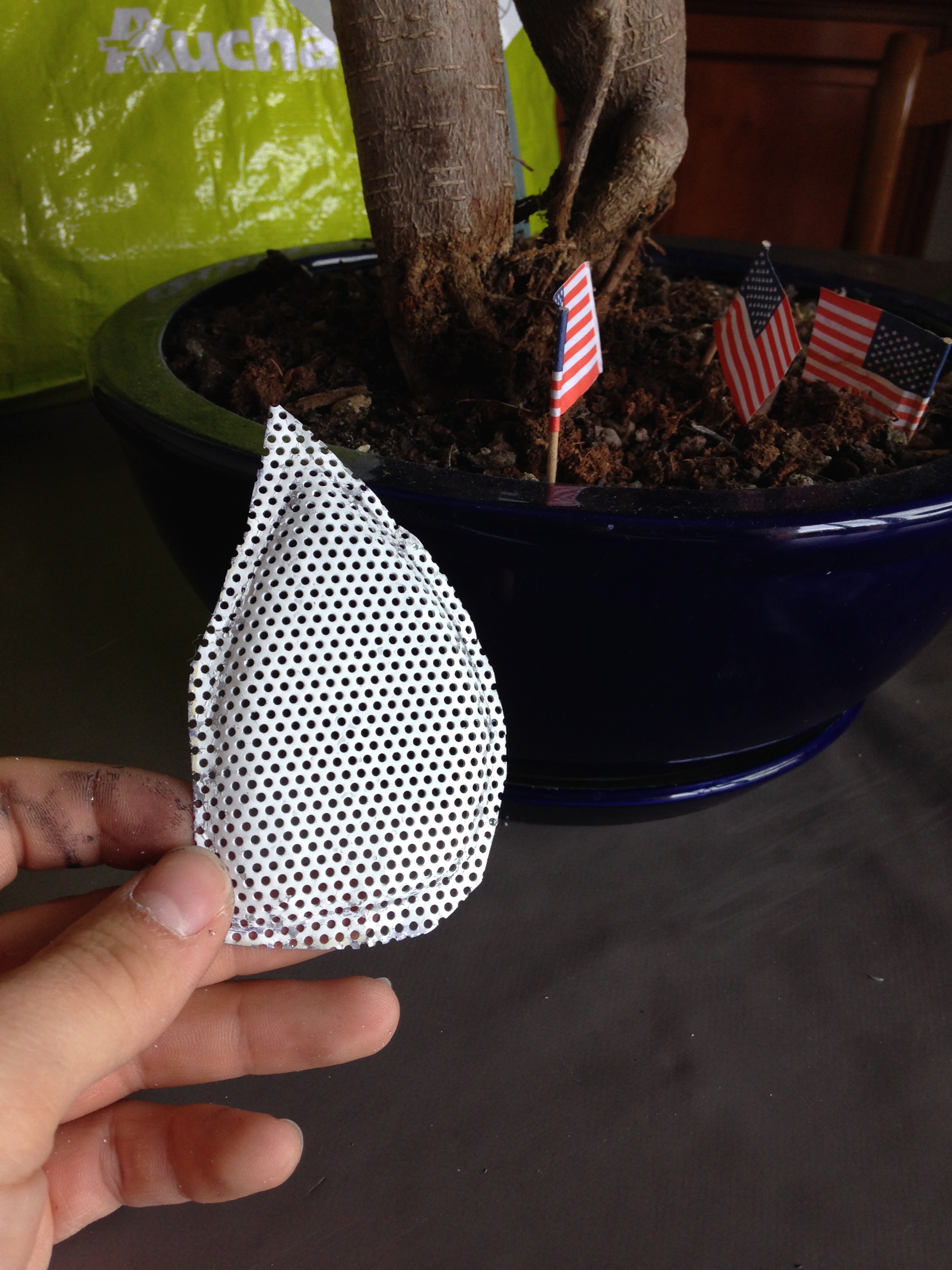

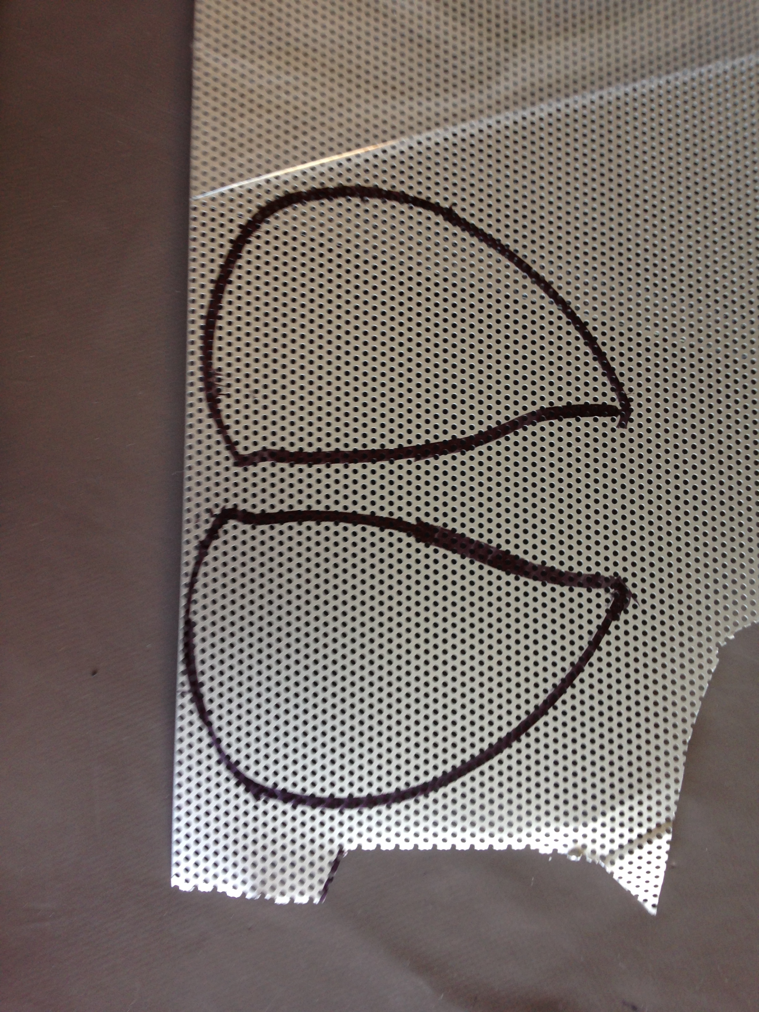

1 ) The metal lenses
draw the lenses on the metal and cut it with a simple scissor.
take you tool key, put the metal on the frame and support the metal on the frame and apply the shape to metal ( be careful during this step ! )
After that, paint the metal in white !

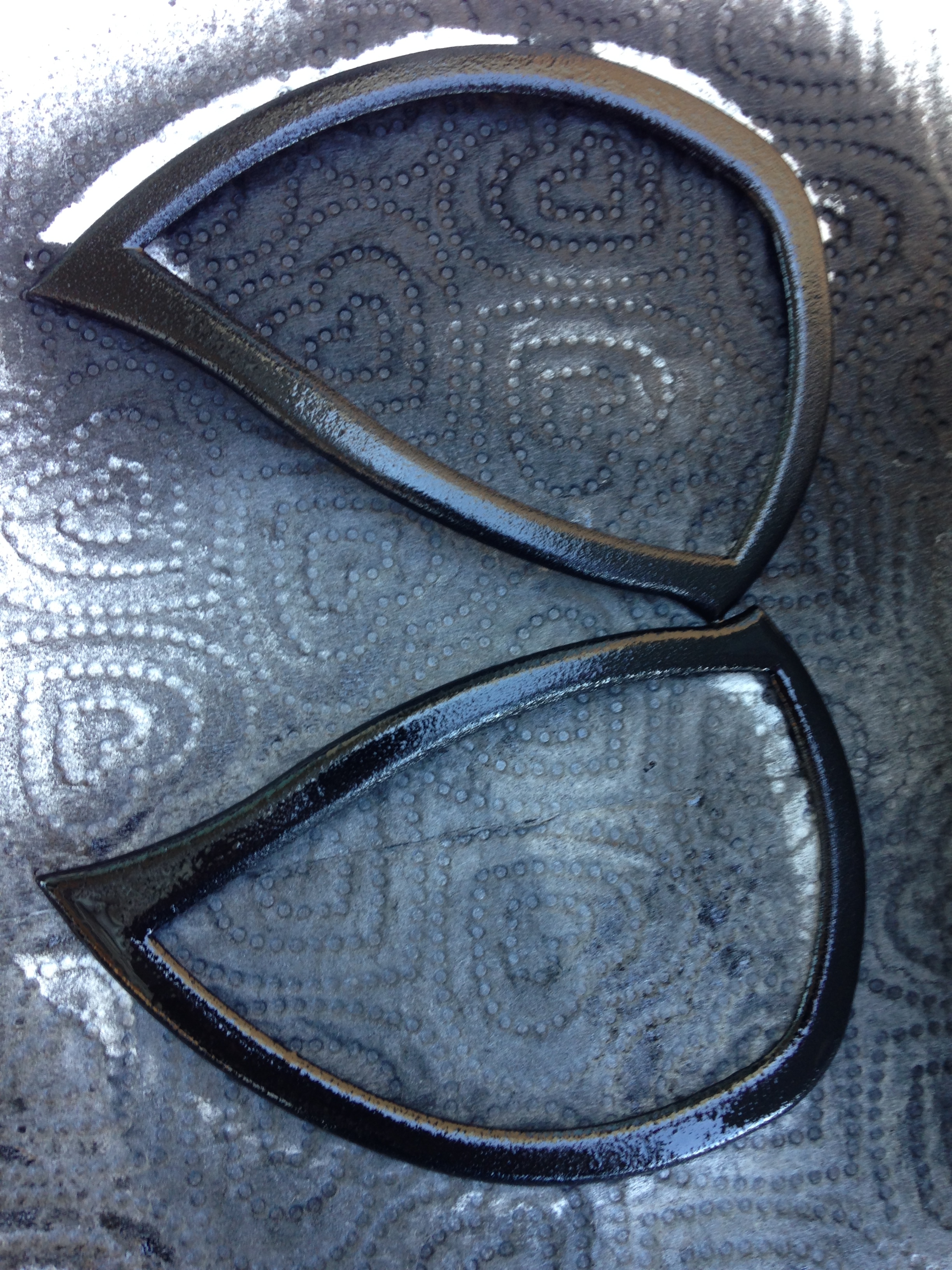

2 ) The Frame
If you use a faceshel, put it in boiling water or use a hair dryer !
Paint the frame in black IMG_3169.jpg.

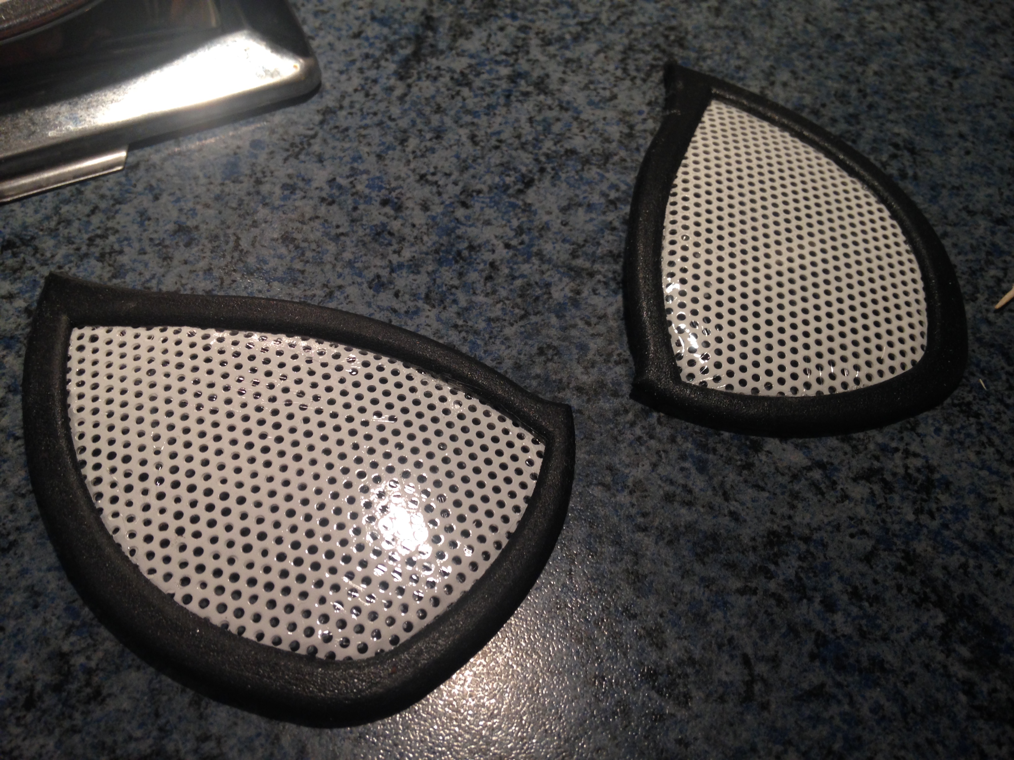

3 ) The reflective effect.
Take your screen guard and cut to the dimension of metal, and apply on the protection to the metal.

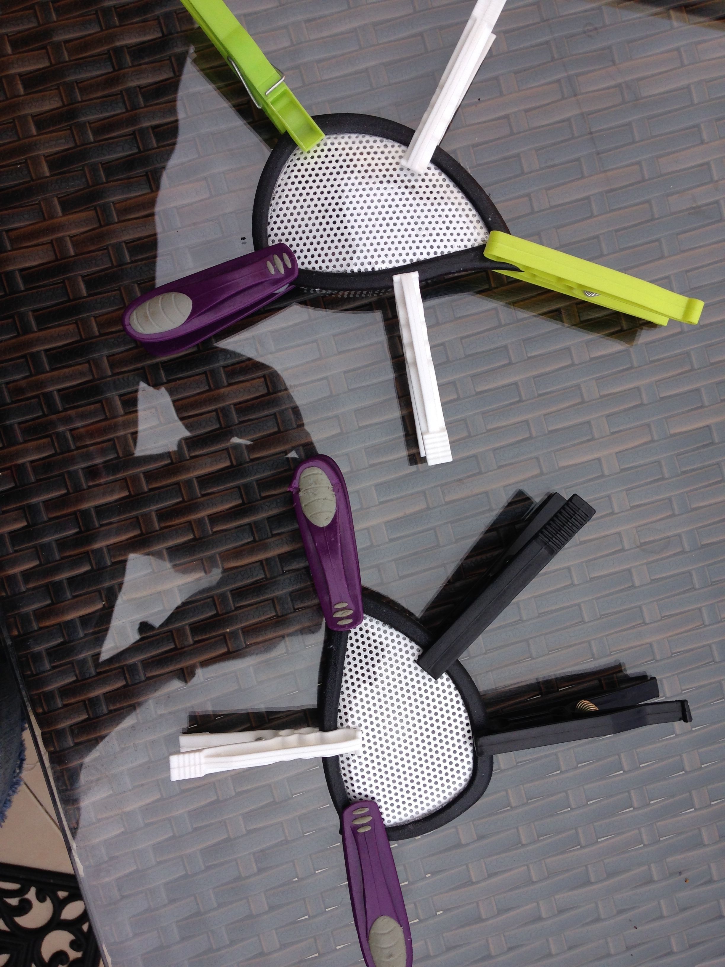

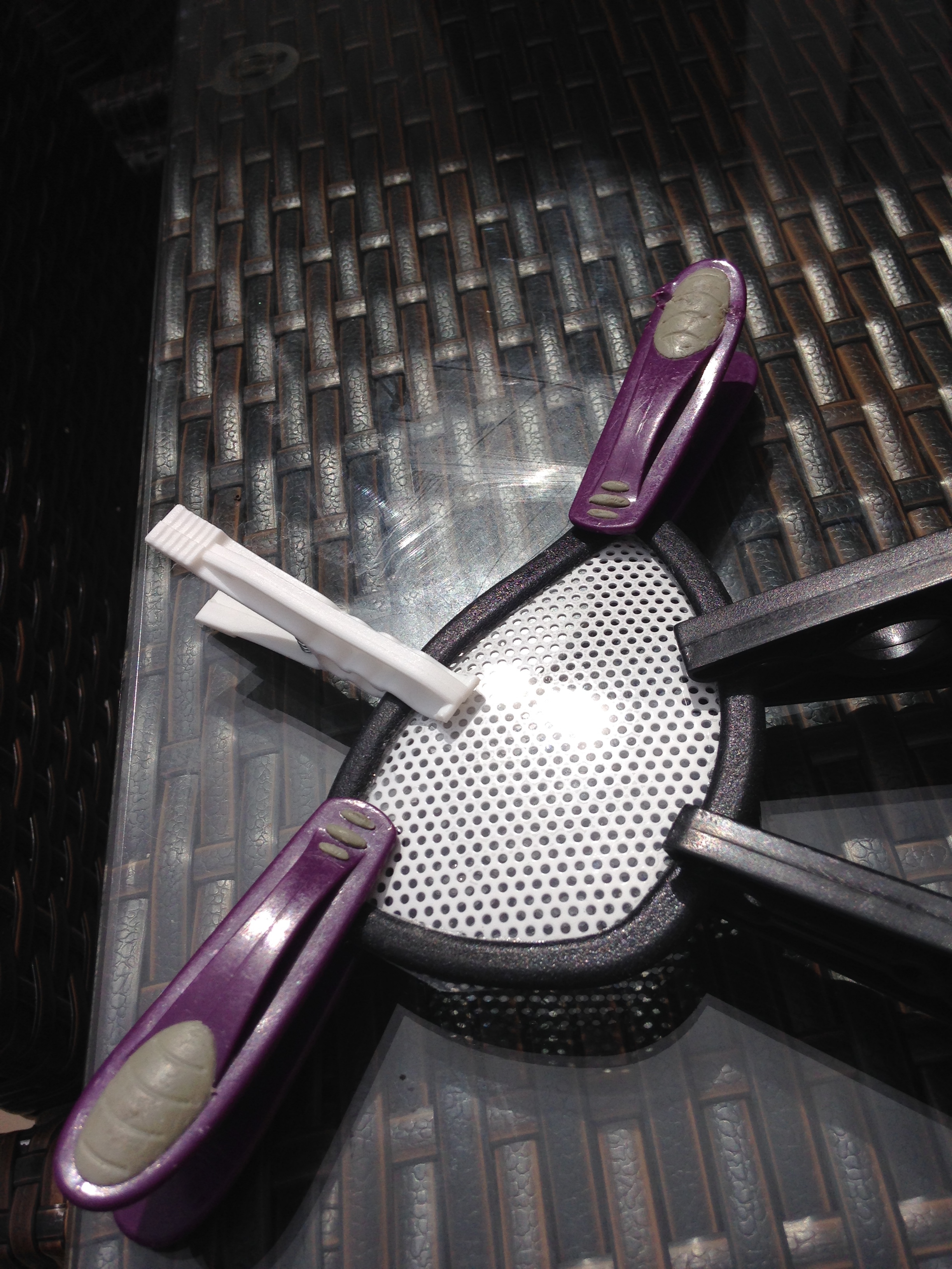

4 ) Glued the melal lenses to the frame ( i have used neoprene glue ) and use clips to keep glued and wait to totally dry

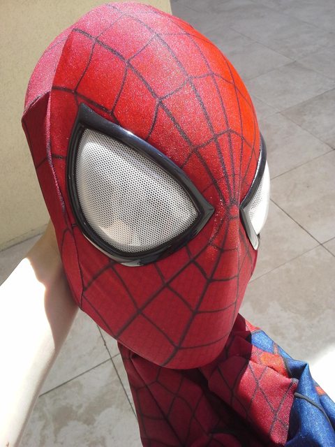

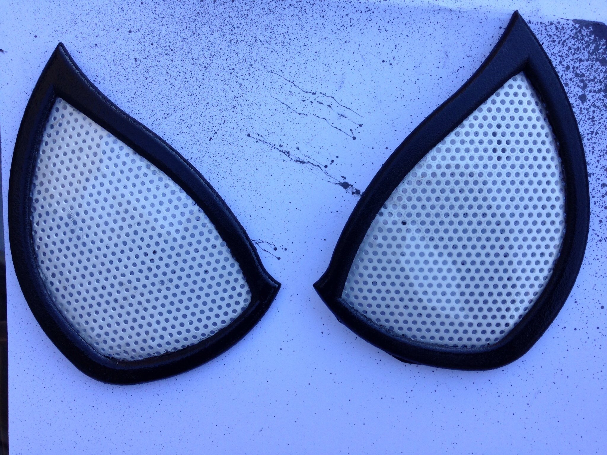

It's over for your new lenses ! Its not really easy to make my lenses, but believe me the result look very cool !
Some pics !
If you have any question, let me free to know! Good luck, may the force be with you!

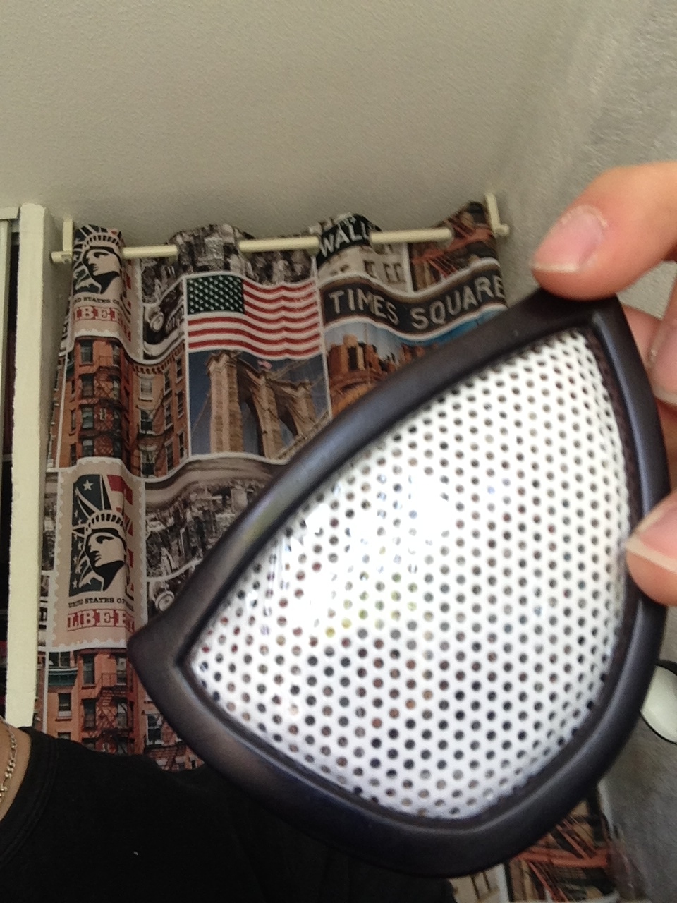

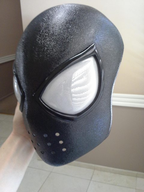

Here is a pic of tjack combo faceshell, the lense look mufh different to every lense when we bend it to glue to faceshell
This lense ussing magnet but when it put on the faceshell, look way more different than other normal lense using magnet

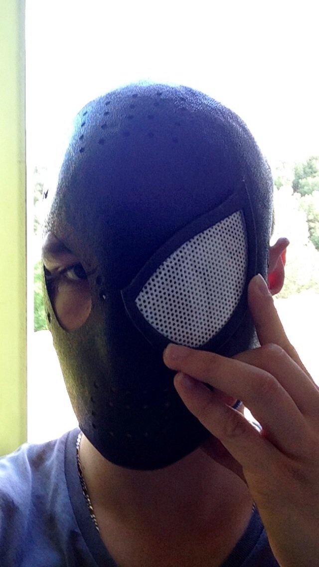

I just have my ASM spidey suit, and the lenses is glued on it !
So I just have my faceshell for show you !
