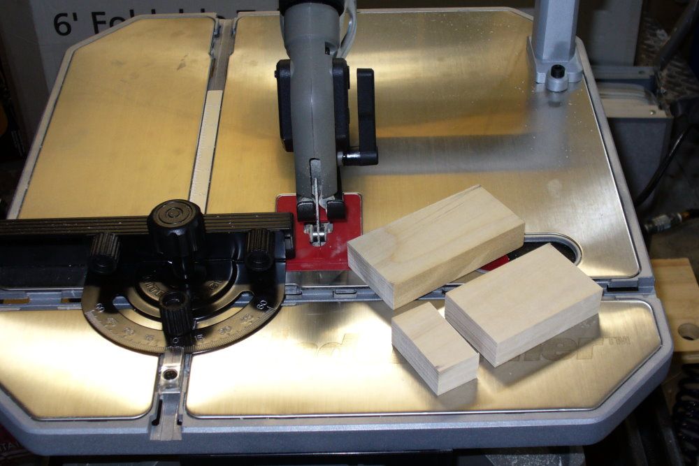

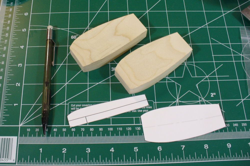

Back to work! I cut two pieces of poplar for the P1. The bottom piece was cut in two at the separation line, then the two parts were taped together with double sided tape. This will allow me to shape it properly while maintaining a clean cut line.
I did the rough shaping on a bench sander.
I'll round over the corners with my Dremel, then finish by hand sanding. More tomorrow.
