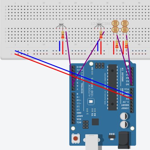

As near as I can figure, here's the layout of the board. Please excuse the crudity of the design, but I hope it makes sense. The two LEDs on the left side of the board represent the LED rings from Adafruit, which feature a data in, out, power, and ground outlets. The two photo cells represent the flex sensors, and the purple leads represent data input/output wires. The MP3 shield appears to just sit on top of the arduino itsself, and should not interferre with port availabilty.
Quick thoughts (not guaranteed to be correct) --
1) Check the pinout for the MP3 shield. Most shields will indicate in the documentation which ports are active for that shield, and which are available for through use.
2) Neopixels can be daisy-chained. As I recall, they are fairly sensitive to serial timing so multiple instances of soft serial might be a problem. Safer to have them all off a single serial port and then code which set you want to be changing.
3) Hardware proof-of-concept like this is GREAT idea. Just remember the data write to the neopixels is a very different animal from the digital on/off you'll write to the test LEDs.
Actually, I would modify in one way; go ahead and use the test LEDs as described and keep them there as blinkenlights as you build and trouble-shoot the rest of the circuit. Just use a different port (or ports) for the neos, and each time you call the neos, call the LEDs as well. That will give you direct visual confirmation that your code is at least trying to do something LED-like at that moment.
