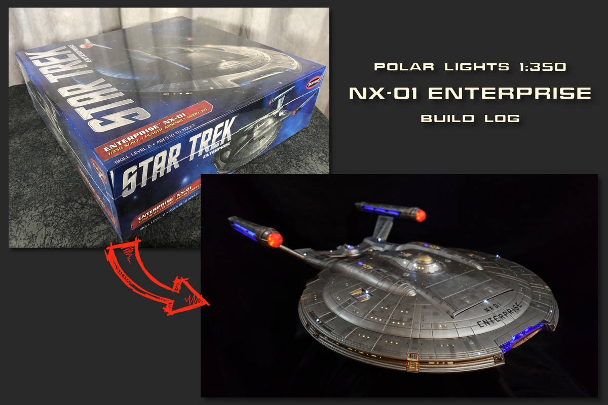

My 1:350 Enterprise NX-01 build with custom 24-channel lighting system

I finally have a log of the full build adventure online here: NX-01 Build Gallery
There were a lot of unusual aspects to this build, and hopefully you'll find something useful in there if you're planning on building your own.
