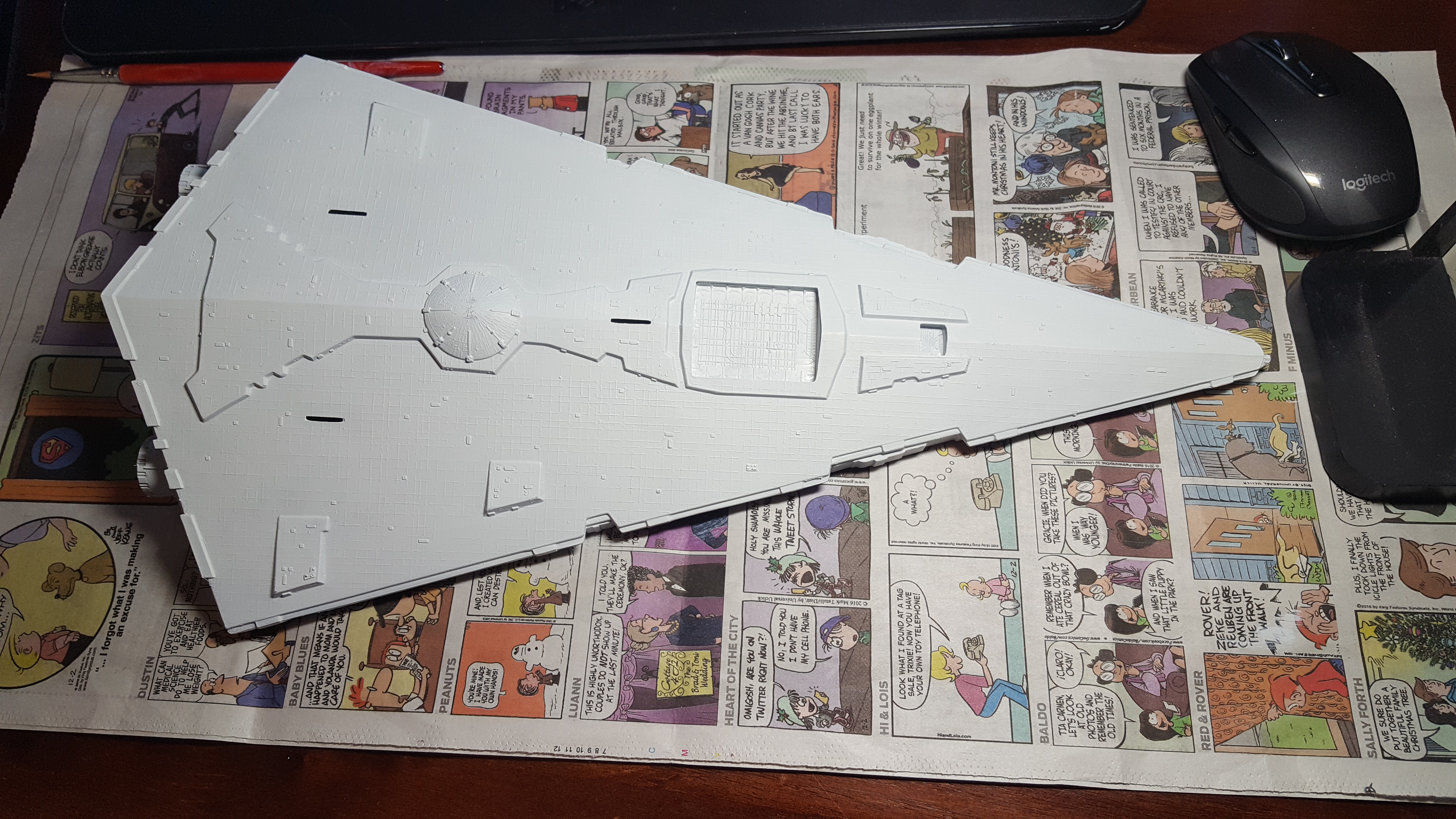

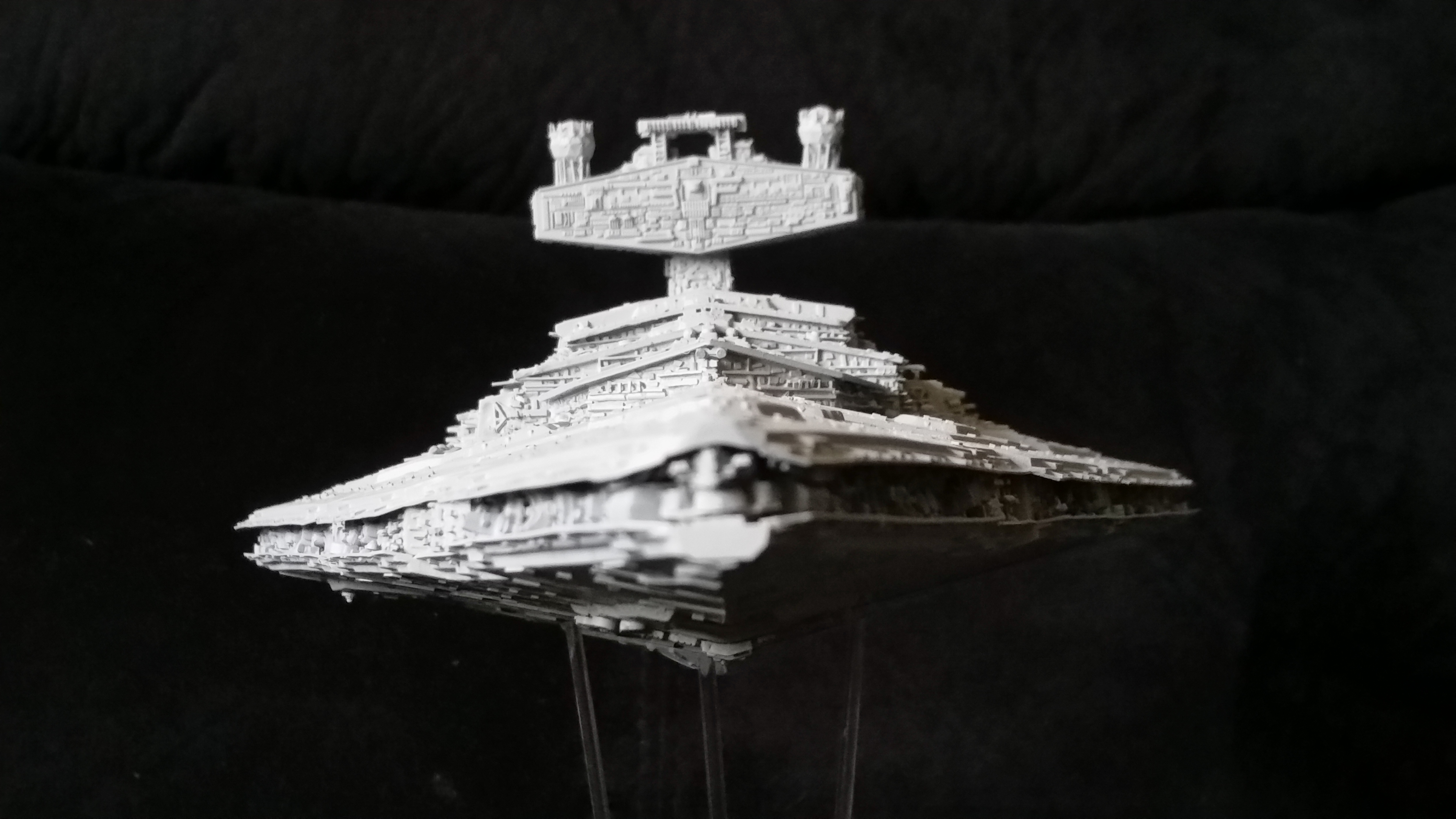

Here's my base coat. I used advice from steven giunta to mix vallejo acrylic white with a little bit of olive drab. I did a coat before this one but it was too thick and covered a good bit of the almost nonexistent detail so I removed that coat and added another with some acrylic thinner hoping it wouldn't glob up on the fine details.
Any criticisms or advice is much appreciated. Like what do yall mean by paneling?

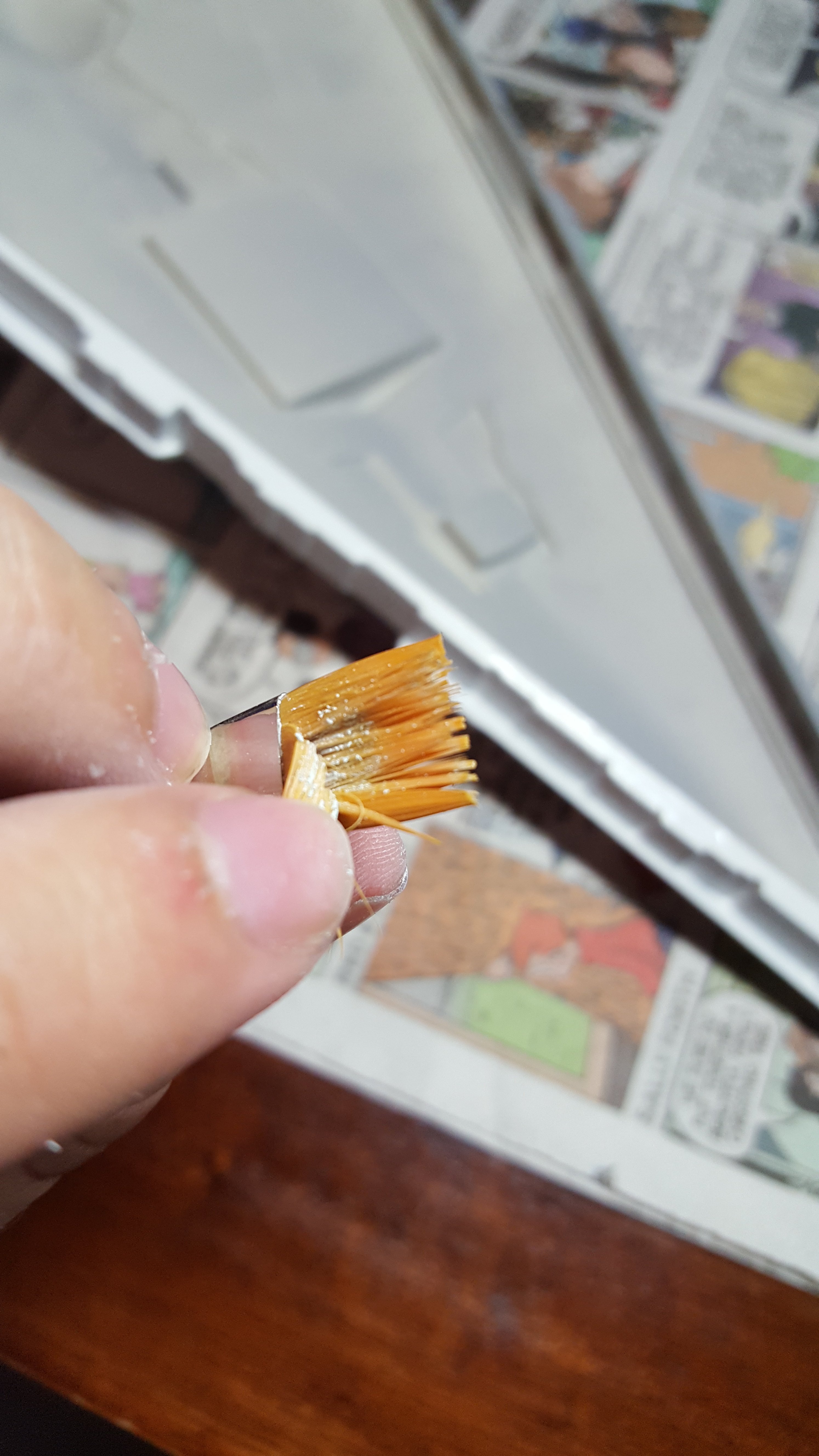

Also any advice on preventing this build up in the middle of my brush?

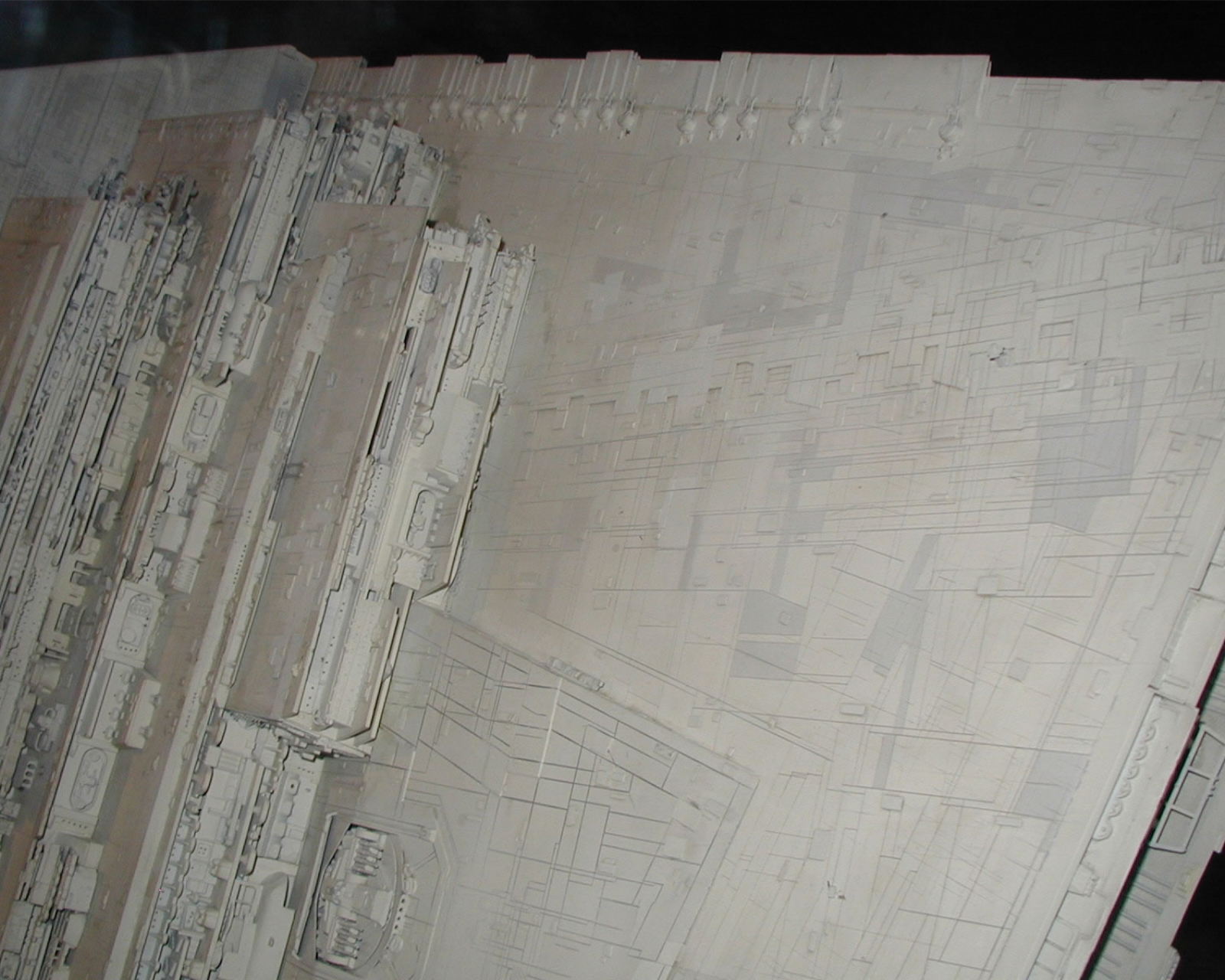

You can see in this photo, the slightly different colors in odd geometric shapes.
How do I go about getting such straight lines? Is there some sort of masking tape ideal for models?
I used just painters blue tape, it's not super tacky. Follow any natural lines the model may provide.

The paneling should only be a little bit darker then the rest of the hull so a very thin coat hand painted should work, and that
will help to keep any paint from leaking under the masking tape.
Start with less is more thinking. The paneling has always been subtle on the Star Destroyers.

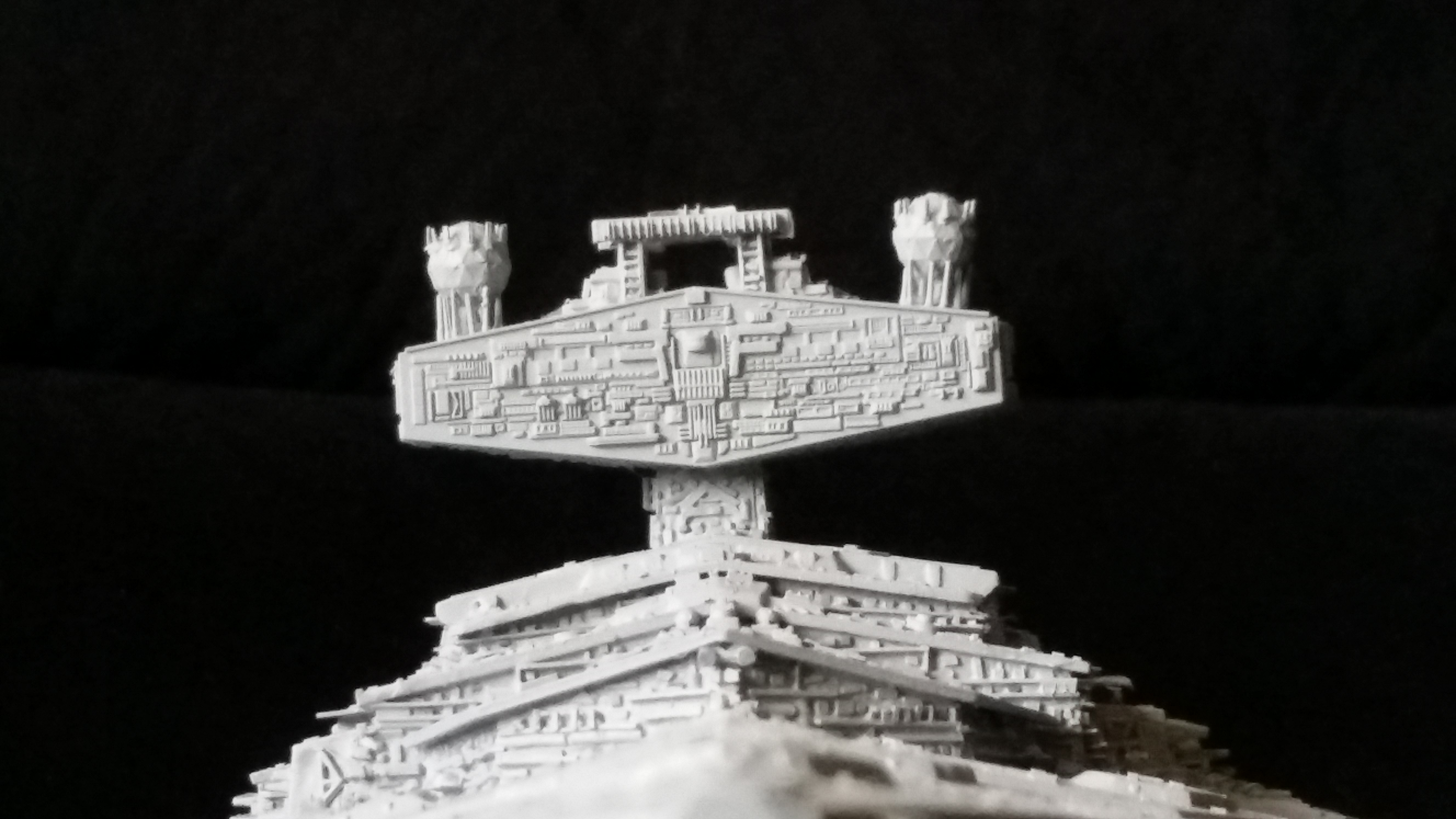

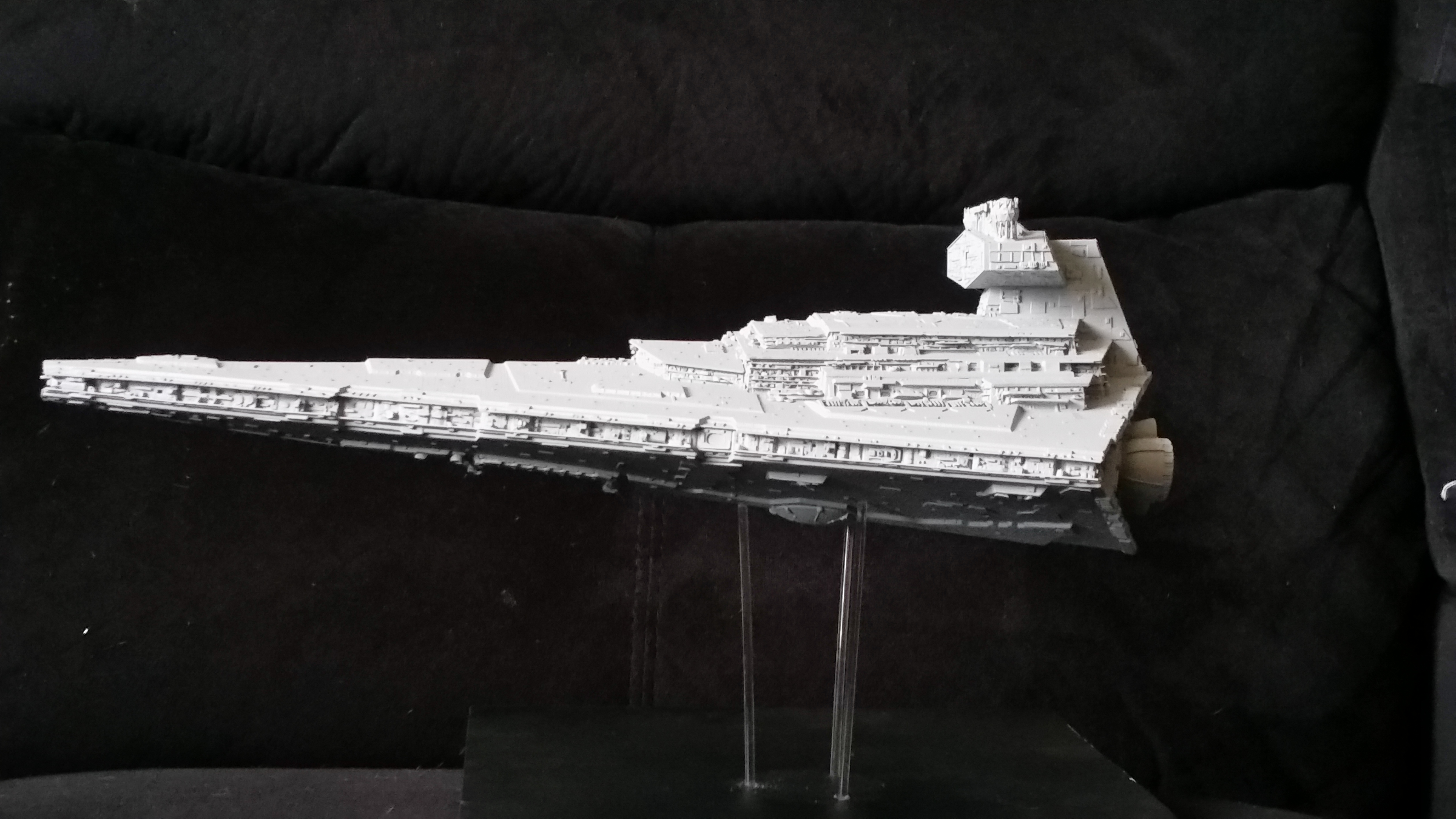

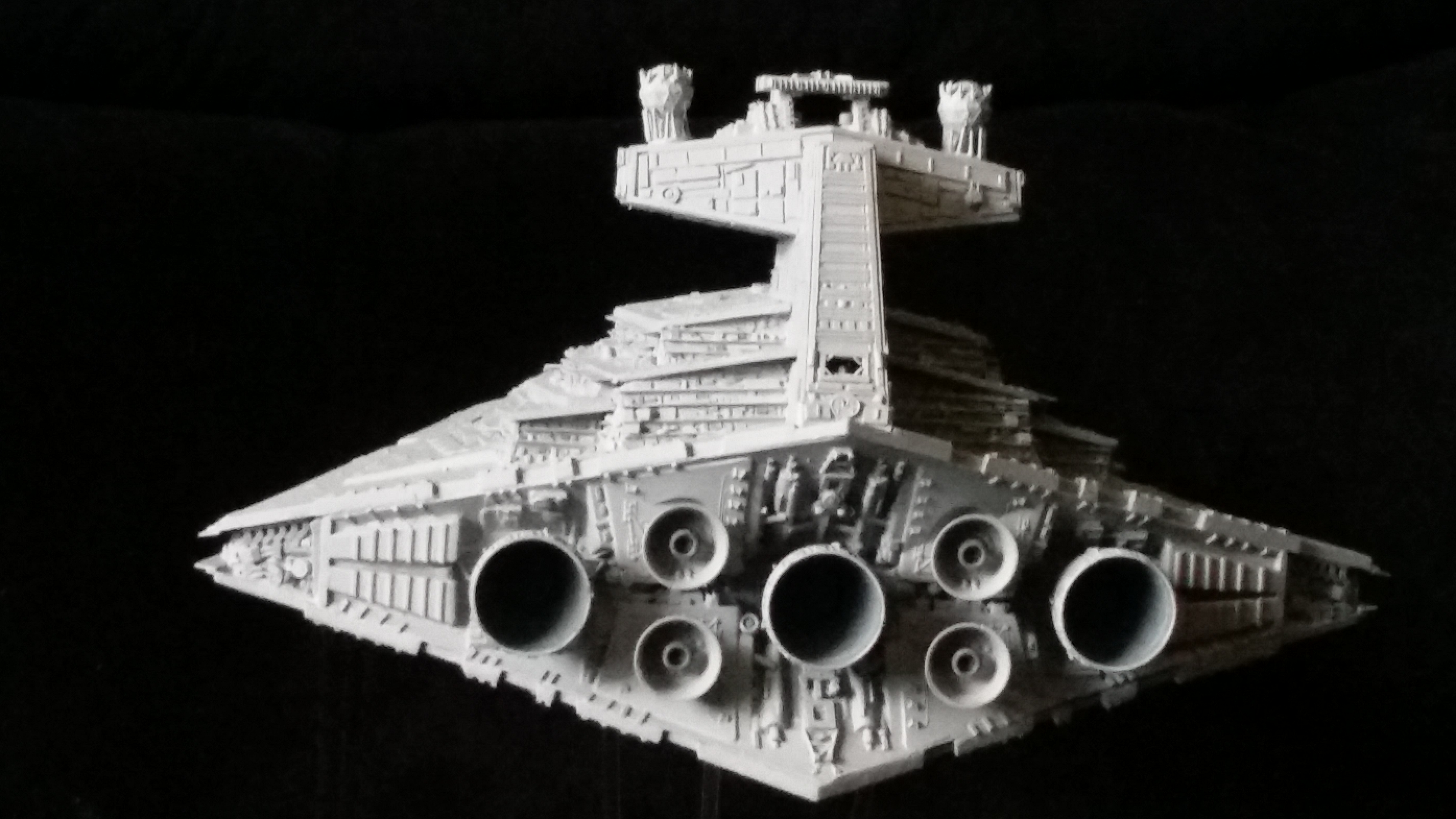

If you are up for a challenge then this kit is it. I did mine before these new kits came out. I based it off photos from the 8ft studio model.
I got the following after market parts......
Resin engines from SSM
Resin Hangar kit from SSM
Shield array from Shapeways
Avenger bridge ace from Shapeways
I custom made the Turbolaser batteries. I also used a ton of evergreen styrene strips for all the added detail. I changed the super structure angles, trimmed the trench to be shorter in height,adjusted the bridge head angle etc.... It took me a few months to complete but I am happy with the end result. I didn't bother lighting as I was spent after all the styrene cutting and placing and couldn't be bothered going ahead with .25mm holes for fibre optics.
View attachment 20161012_131041.jpg20161012_131115.jpgView attachment 20161012_132823.jpg20161012_132842.jpgView attachment 20161012_133326.jpg
