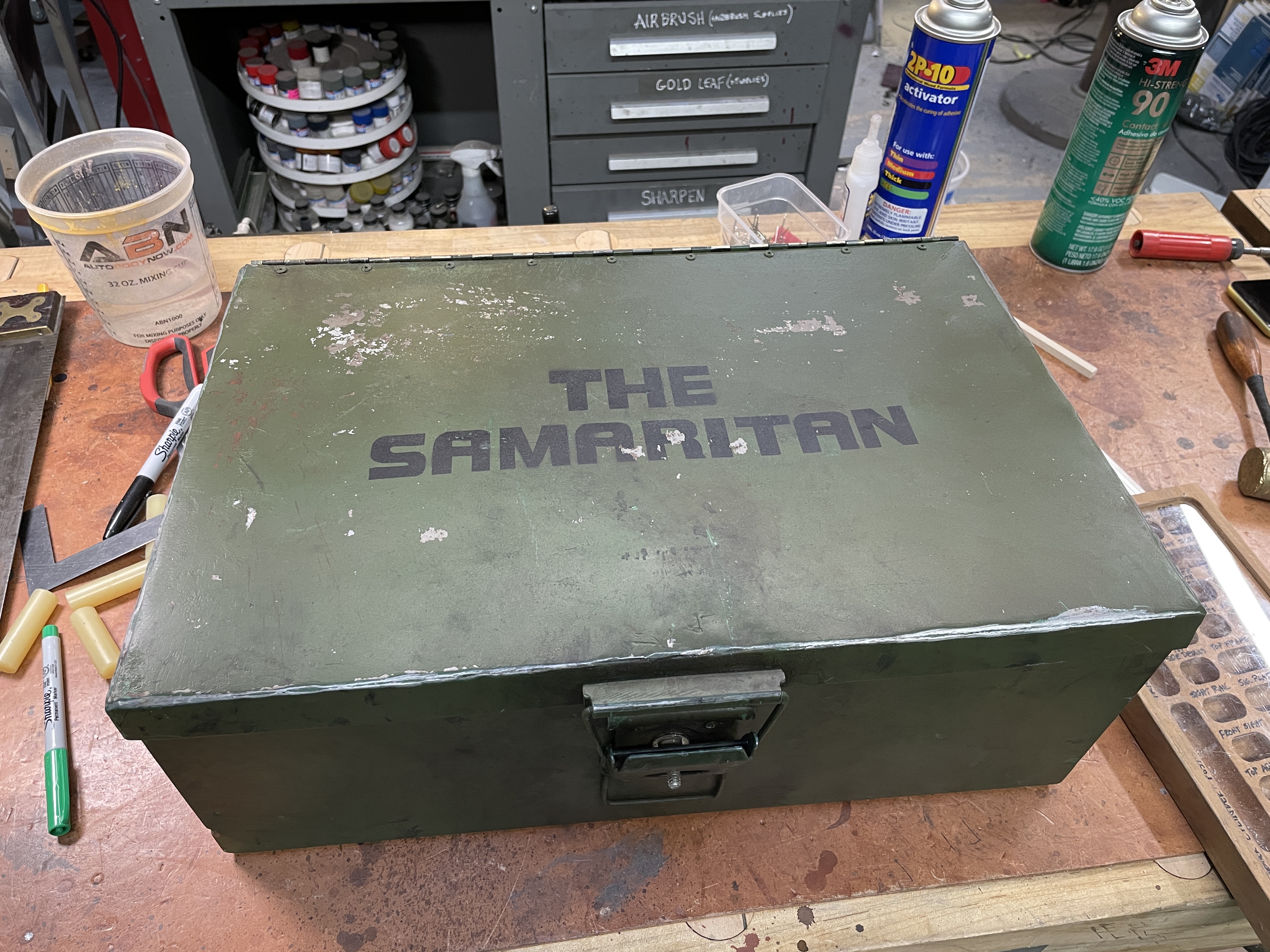

A couple years ago i won an ebay auction on a metal box that was very close (perhaps a bit large) to the correct dimensions of the Samaritan case from Hellboy. I've never gotten around to painting it, but finally did a couple weeks ago. Here's the result:
IN addition to the paint I added the clasp from an ammo box for the front closure (thanks to someone's research on the RPF) and also added a brass piano hinge across the back of the lid. I painted the interior black and added a bunch of dirt and rust.
I was really happy with this. BTW the olive drab color base was a Tamiya rattle can. I didn't overly prep the surface, so after my paint was dry I used masking tape randomly placed on the box and peeled off some spots of paint. It worked great! Then I clearcoated in a matte lacquer. I'd share my Samaritan lettering art, but I hand cut this from paper using some very rough reference material. I'll see if my stencil is scan-able.

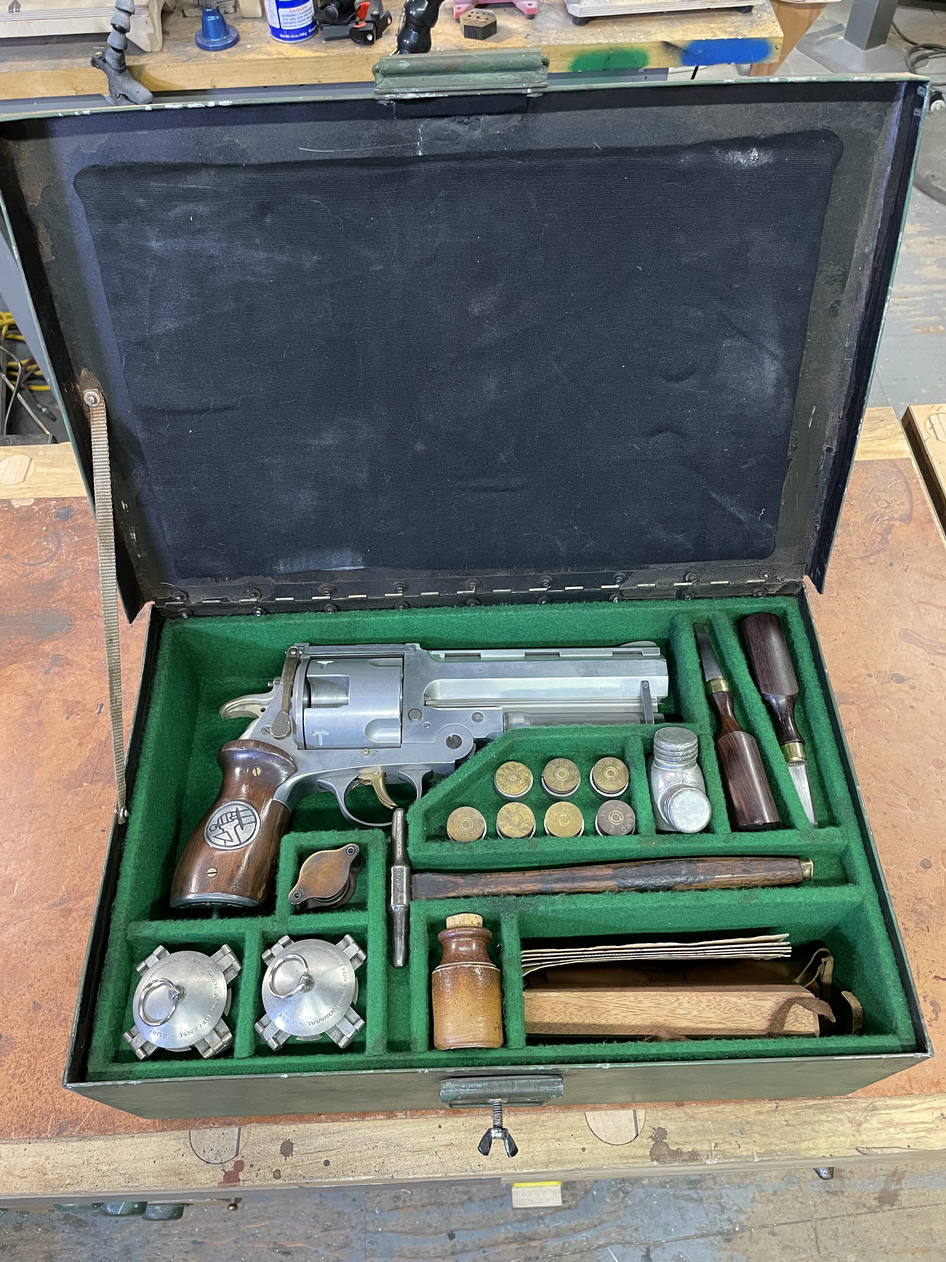

It's just a little...anemic for my tastes. So I considered a redesign of the interior. I researched some old pistol presentation cases and got inspired. Using 1/4" plywood and my 23ga pin nailer and some glue and felt, over two days I completed a non-canon interior that I'm really happy with. It feels authentic, and it's actually filled with all the tools I need for assembly, disassembly, and maintenance. Funnily enough, it took a lot of weathering to get the aging I did to show up on camera. I airbrushed burnt umber liberally in the corners and all over and you couldn't see a LICK of it on camera. I eventually did a distant all-over spray with black primer just to kill the vibrance of the green.

Without further ado, here's my hellboy pistola in it's new habitat.
The brown ceramic bottle in center bottom is a salt-cured inkwell. These were common during the civil war and several of them are visible in Broom's Box, which I own one of. They're not hard to find for a few dollars on ebay. So I liked the idea of putting one here full of some lithium grease. The speed loaders are static props from a run here on the RPF, I may end up re-making the mechanics of these, we'll see.
