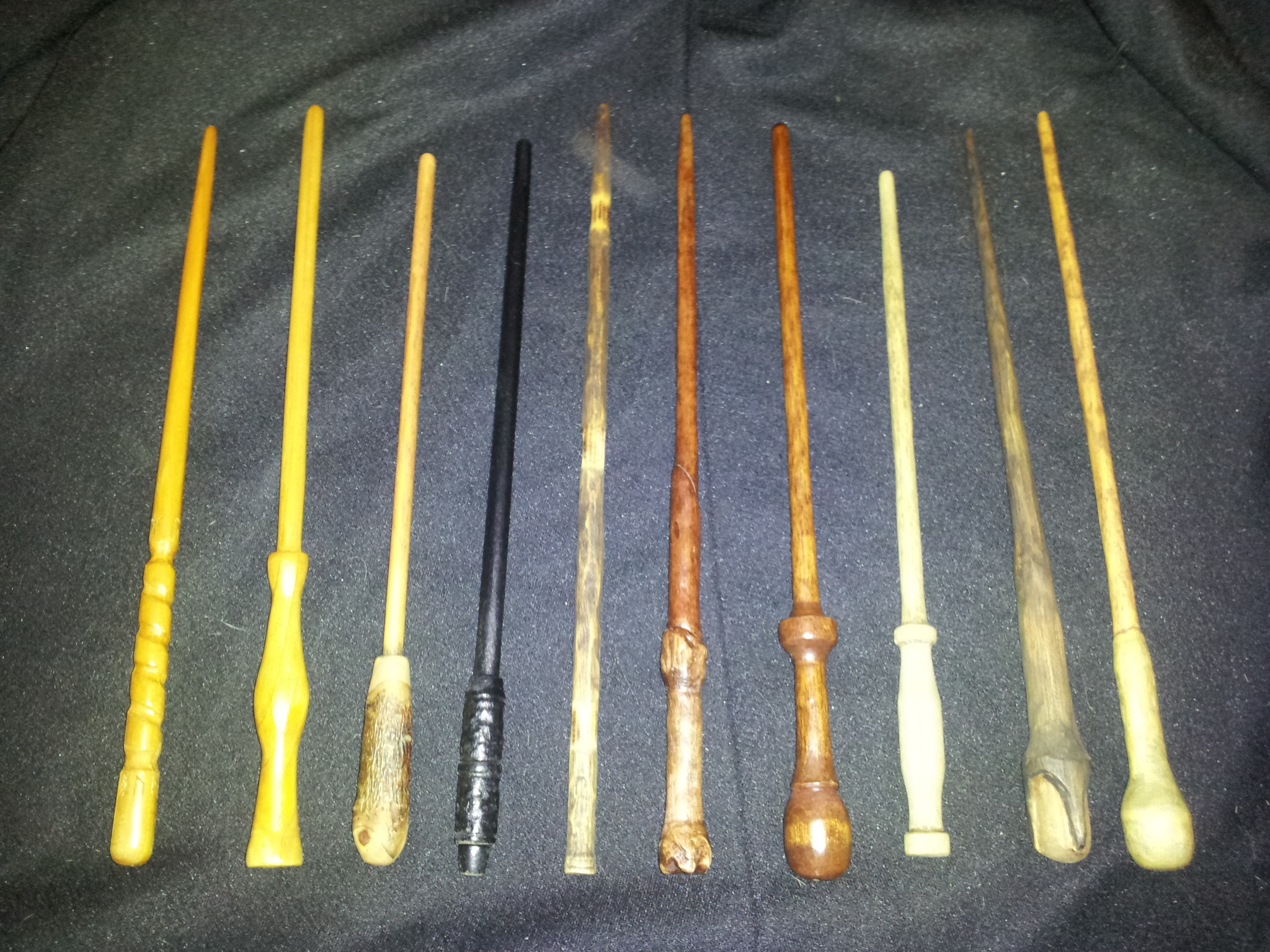

I lathe mine out of poplar. Used to use clear oak, but it's way too dense.
Here is a Luna Lovegood wand I lathed.
and finished:
and the earrings to go with it - I sculpted one out of plastic and epoxy, then cast it twice in resin. The leaves are from the fake plants aisle at Hobby Lobby:
I lathed a Harry Potter wand, and sculpted the bark details onto it with epoxy. I gave it my own flair:
and painted:
