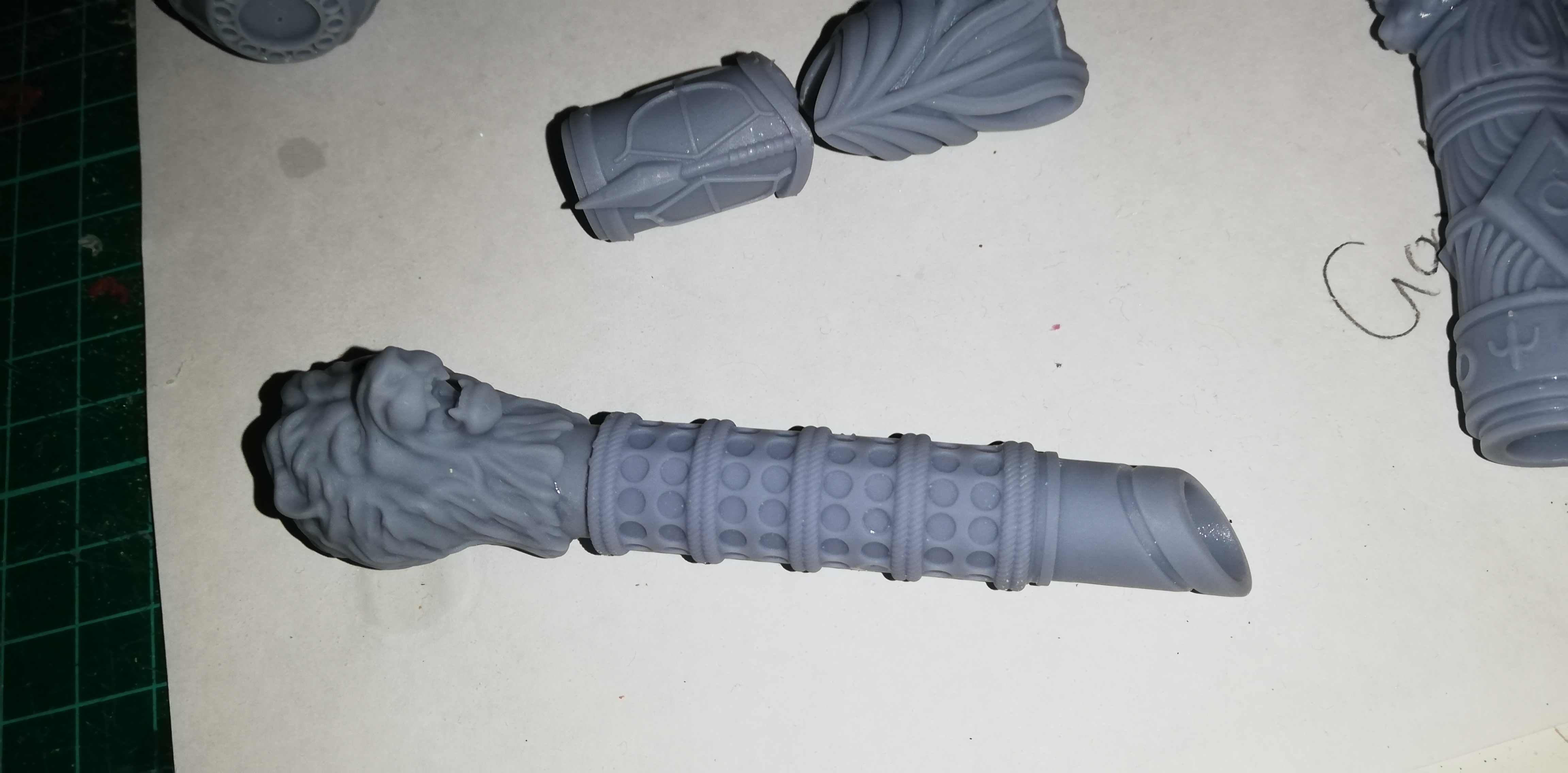

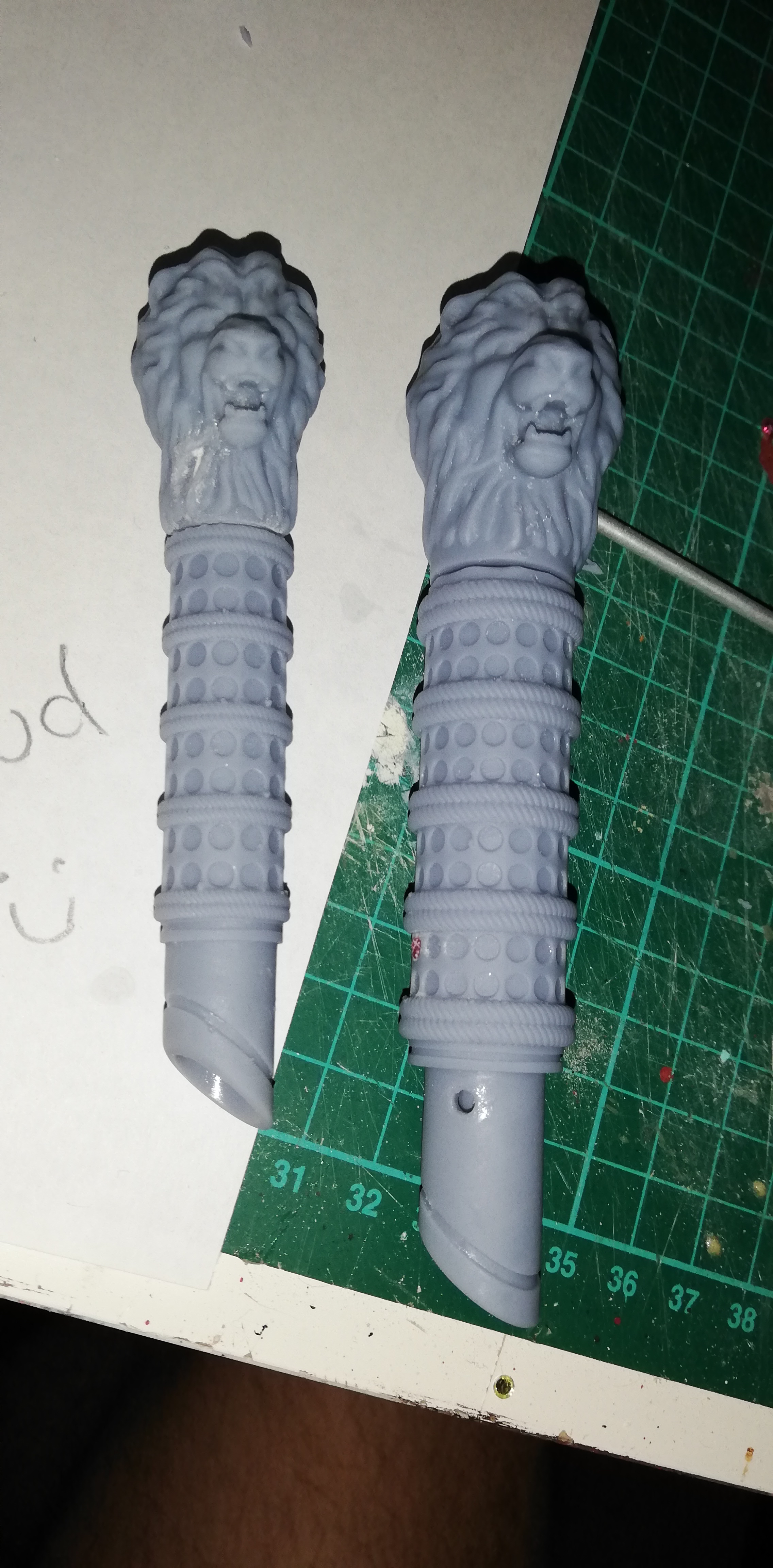

The lions head for the Lannister wand didn't come out so great the other day, specifically around the bottom where it connect to the main wand piece. I mad this a little bigger, and also fixed the connection point, which was far too loose.

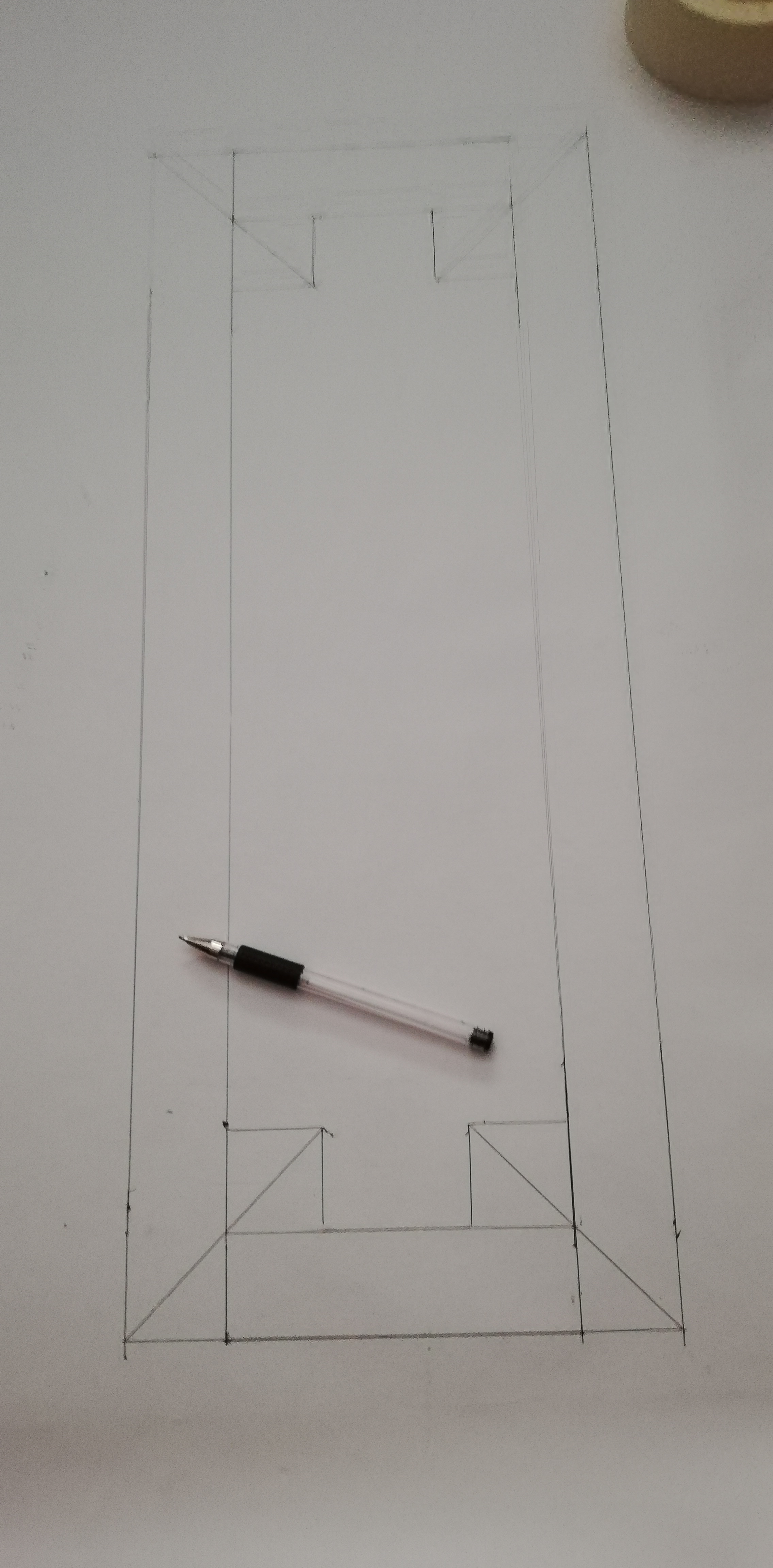

I've got a template cut out for the 15 Inch wands, and I'll make some seperate boxes for those that require different sizes.

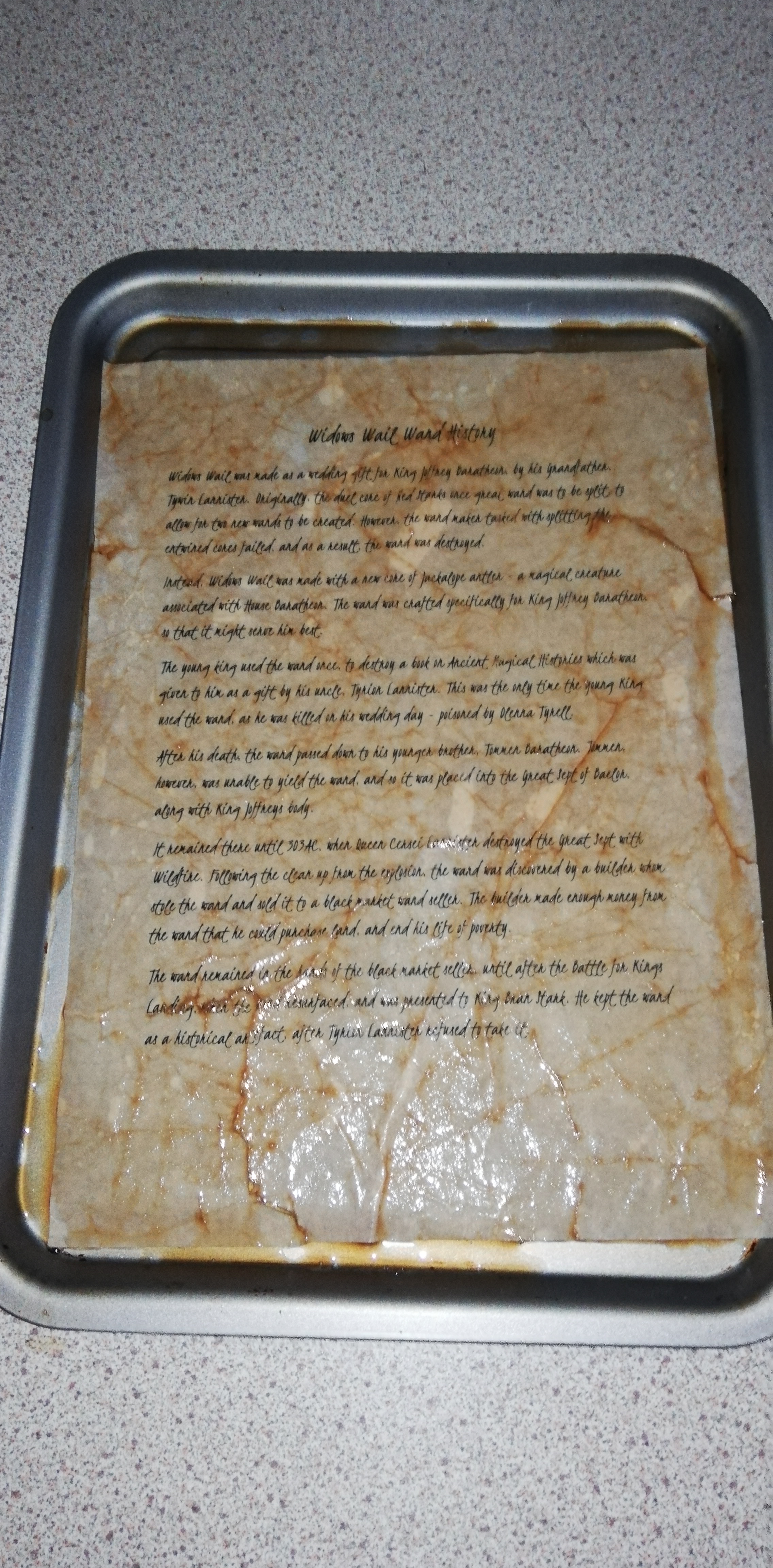

I've also been working on something else. Each of the wands will have a piece of parchment with a brief history of the wand, and I thought I'd show you the history I've come up with for the 4 house wands. The parchment backdrop is temp. I'll actually print and weather them myself.
I think that's everything up to date for now. Will post some pics of the Targaryen Wand once it's printed. I also need to make the Wildling wand, which shall happen SoonTM, along with the Nightking wand. I want to try and finish all the wands roughly together, but I may end up doing them all in batches.

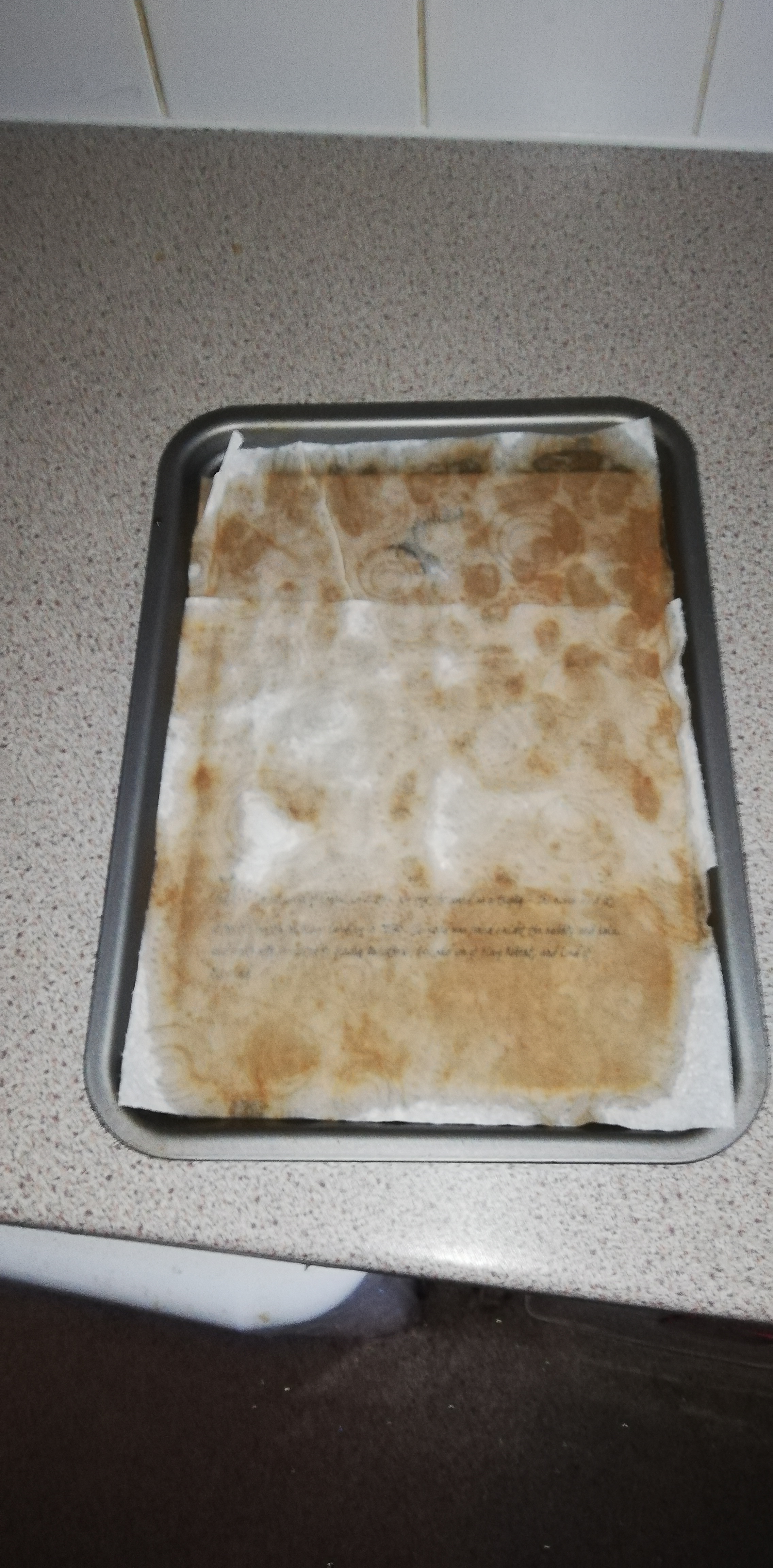

Done a weathering test on some paper, which was pretty successful.

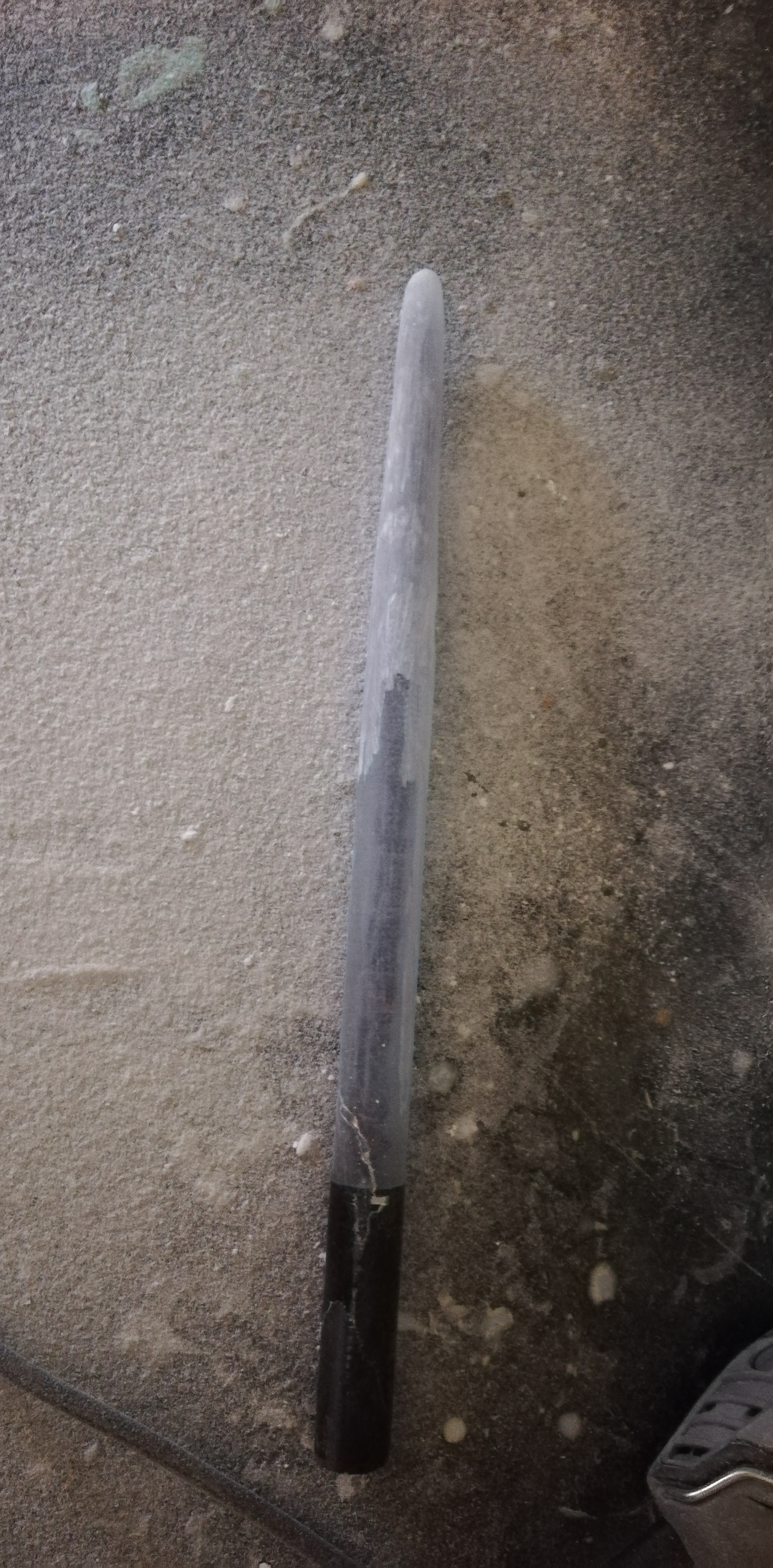

Wand prints came out great. Printed 3 on the bed, each in 2 halves. Could print more if I print upright on supports without an angle. 6 more to print, a custom one for needle, and then generic smooth ones for the other wands. These are the rough variant I've made.

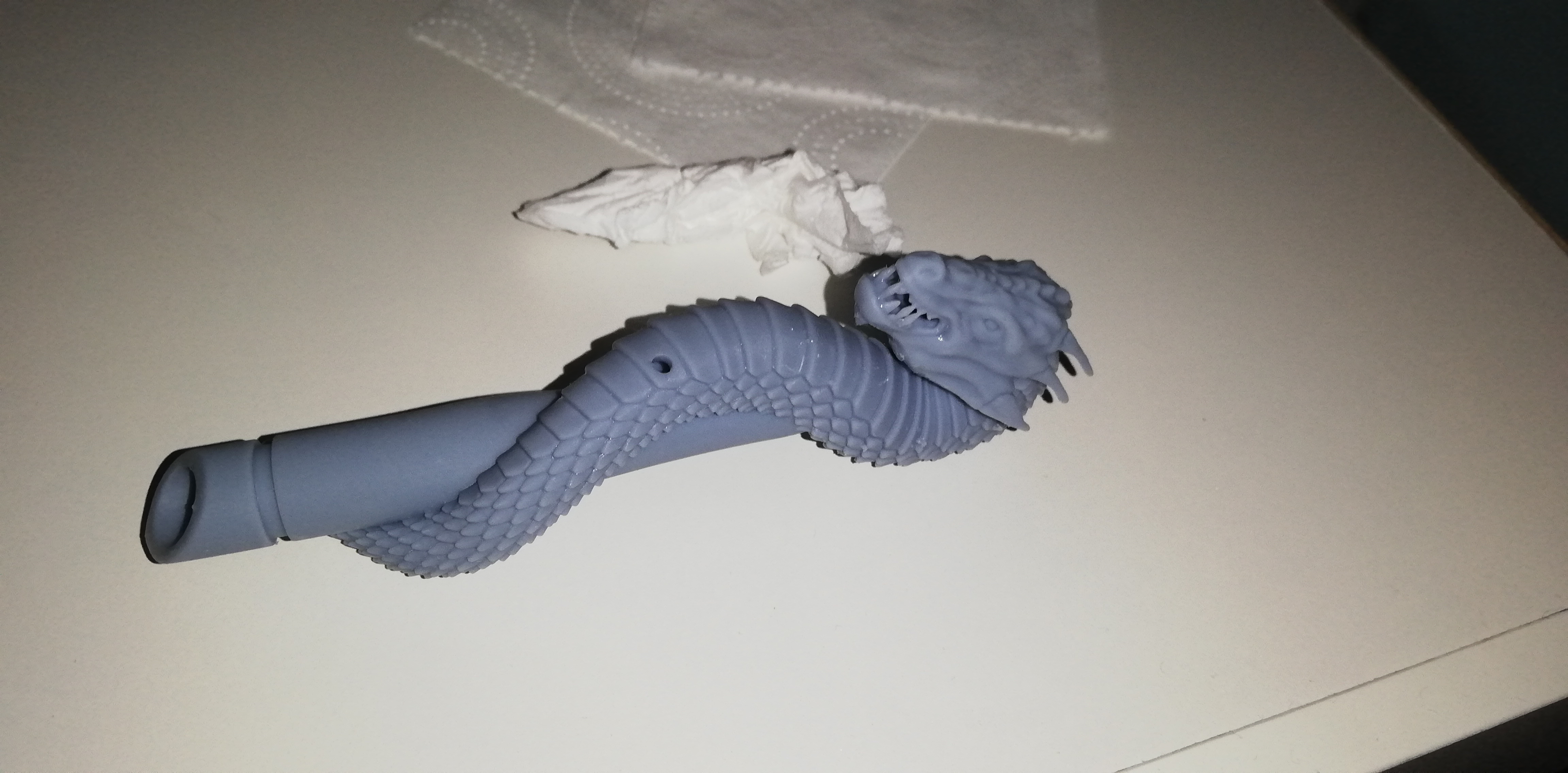

First off, I got all of the wand pieces printed.
Needle and the Targaryen wand were a little too small, so I reprinted those, as you can see below..

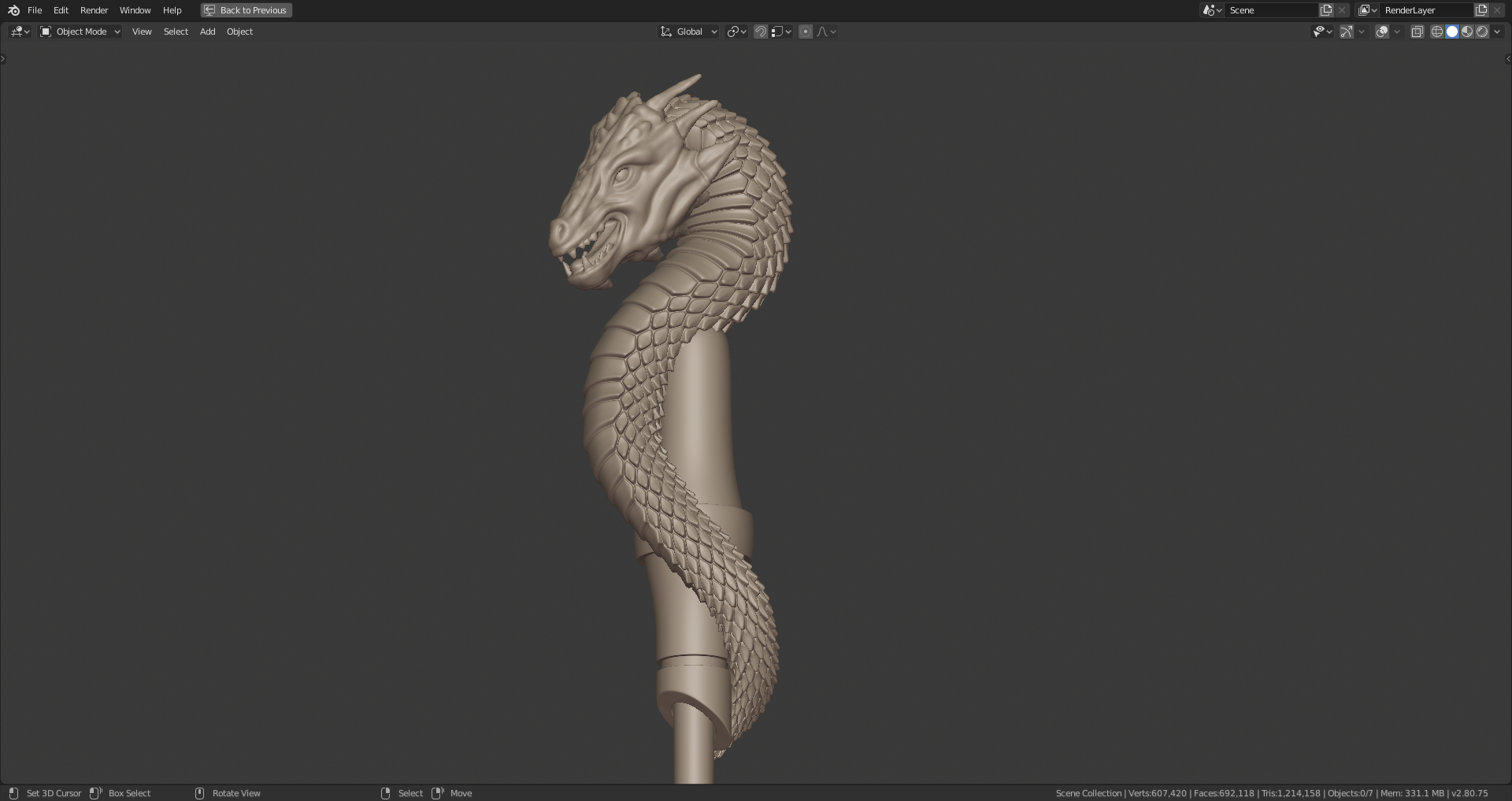

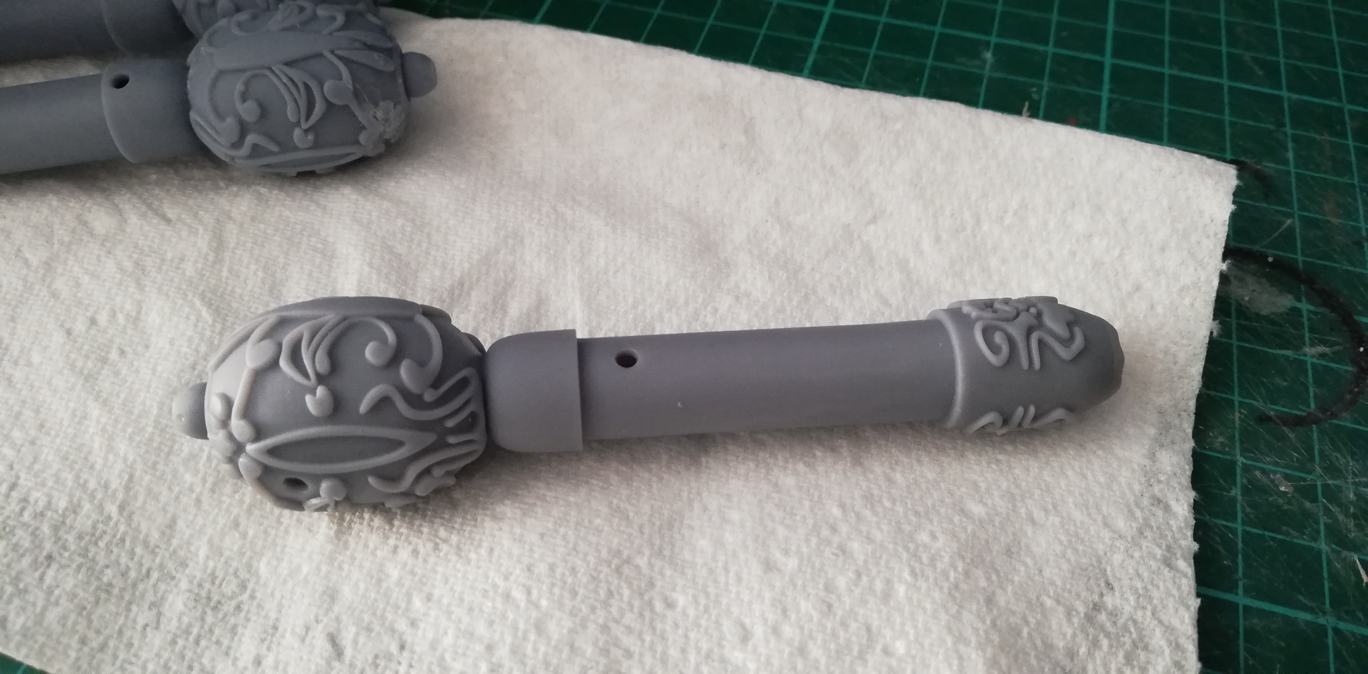

I also worked on a little bit more 3D stuff, making some decoration for the Nightking wand box.
I then printed them out on the Elegoo Mars.

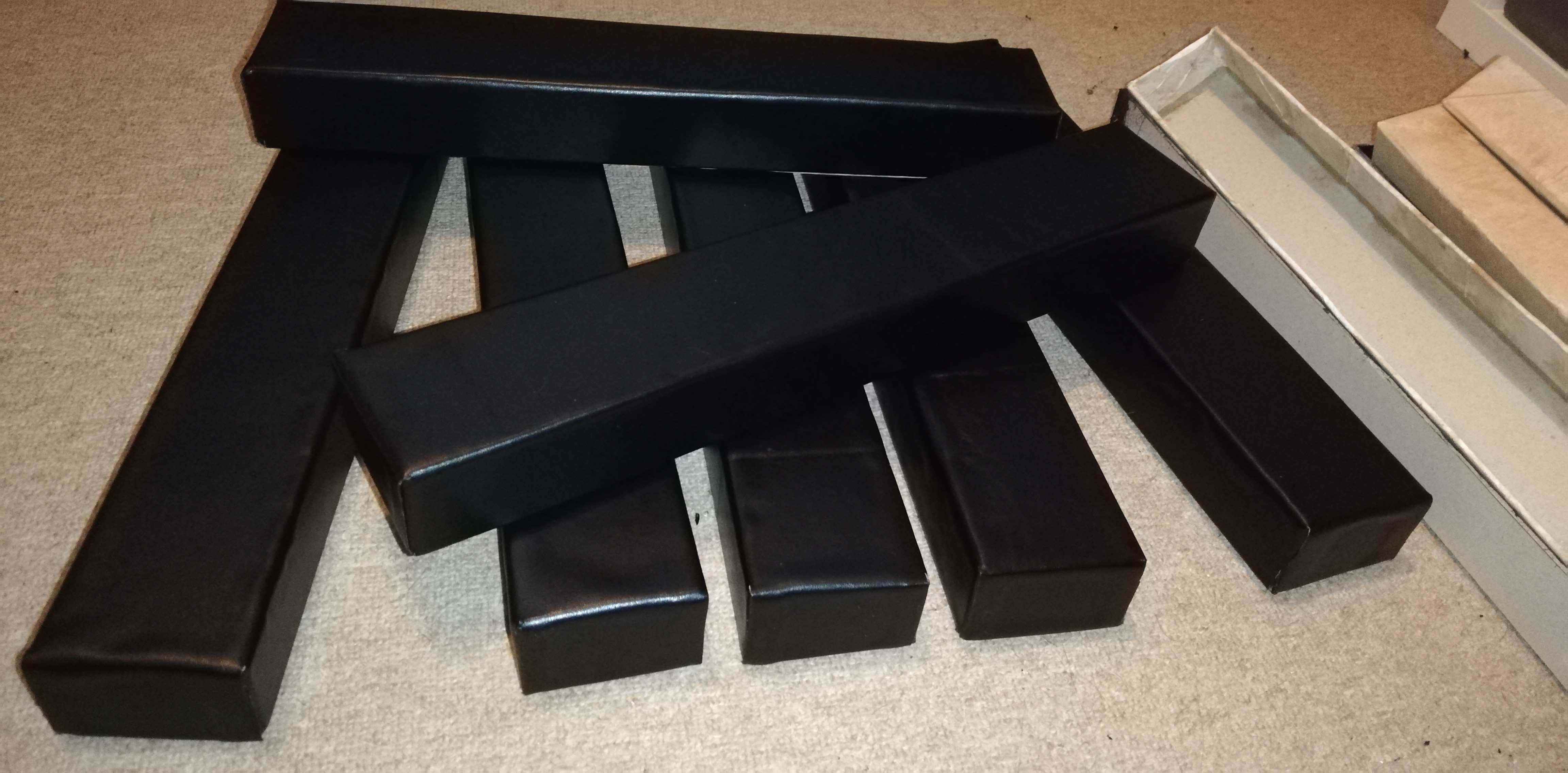

I've also started making the boxes, so that they're ready once the wands are all painted up. The boxes are something I can work on whilst waiting for stuff to dry, be it moulds, paint or glue.

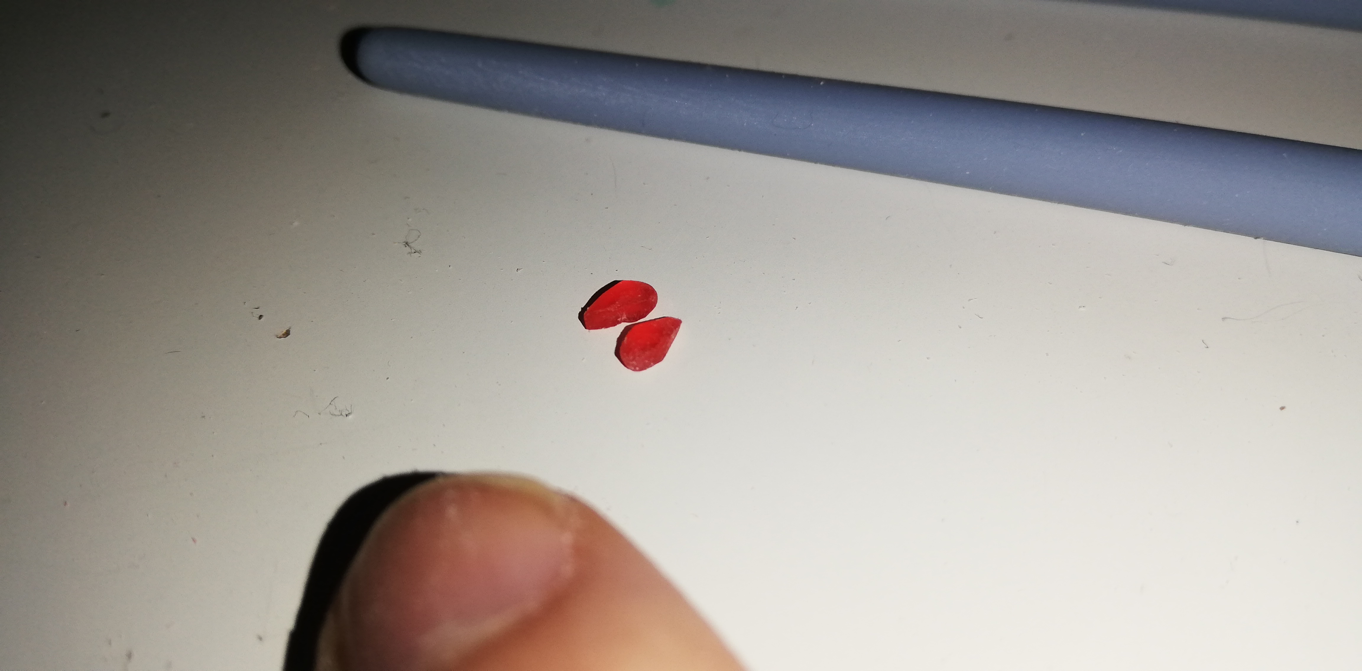

A little (literally) update which I forgot in my last post. I got the little rubies for Longclaw Pommel cut and shaped. Started with a 10mm red gem, and then cut and sanded to shape. They are tiny, but fit pretty well. Perhaps a tiny bit more sanding to get the fit a little better, but we'll see.

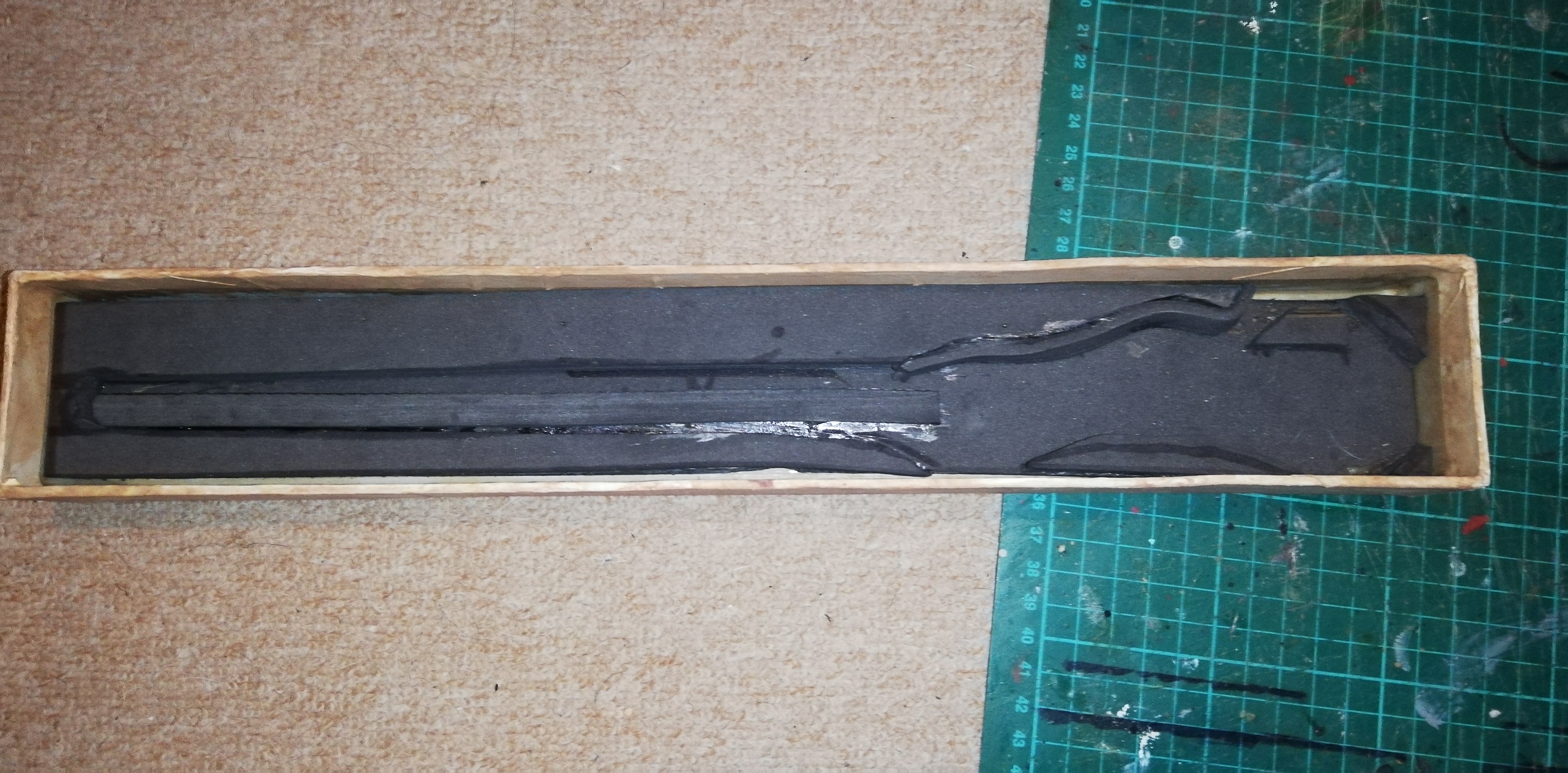

All this box needs is the foam insert and it's ready to go! After successfully making the test box, I moved on, and created the rest of the boxes for the 15" wands. There are two smaller boxes (which I'm cutting right now) that still need cutting, gluing, painting etc...

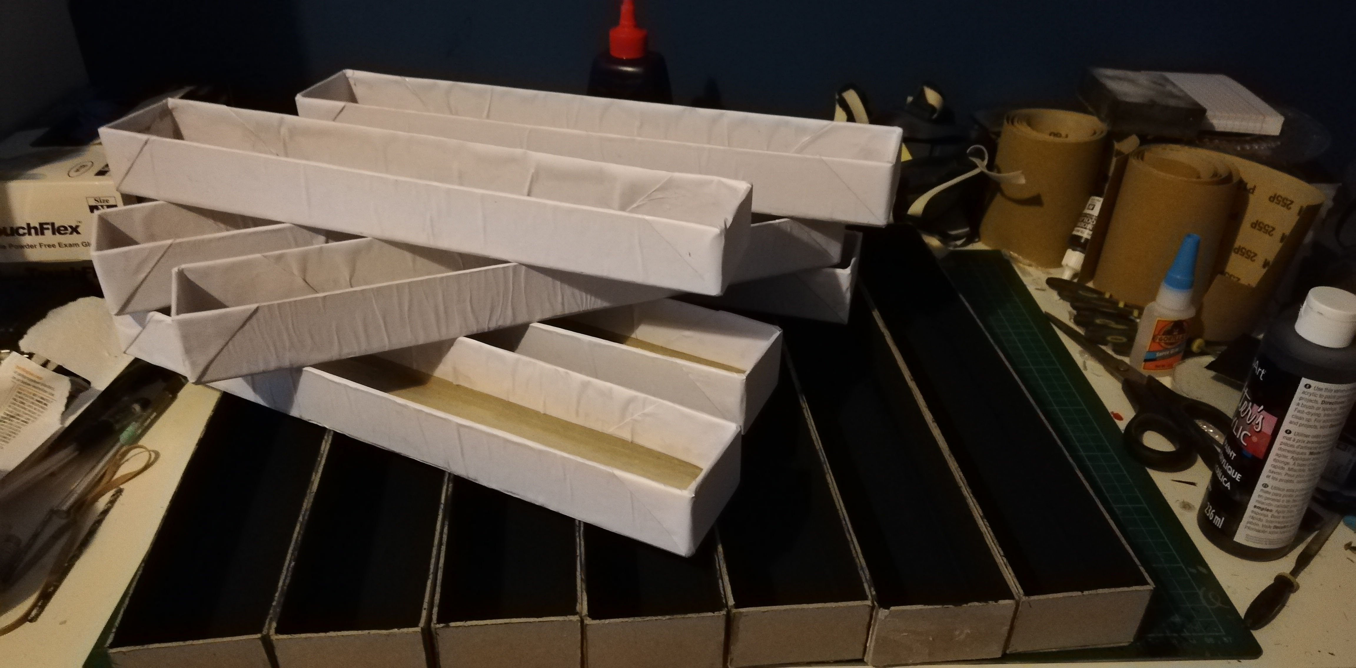

Bases and lids cut out
Scored the fold lines, and folded to form the box shape
Used contact adhesive to fix them into shape
Applied a generous amount of PVA glue to all of the joints/folds
Once the glue was fully dry, I could move onto covering the bases. The lids for now I've left alone, just painting the inside with a good covering of black acrylic.

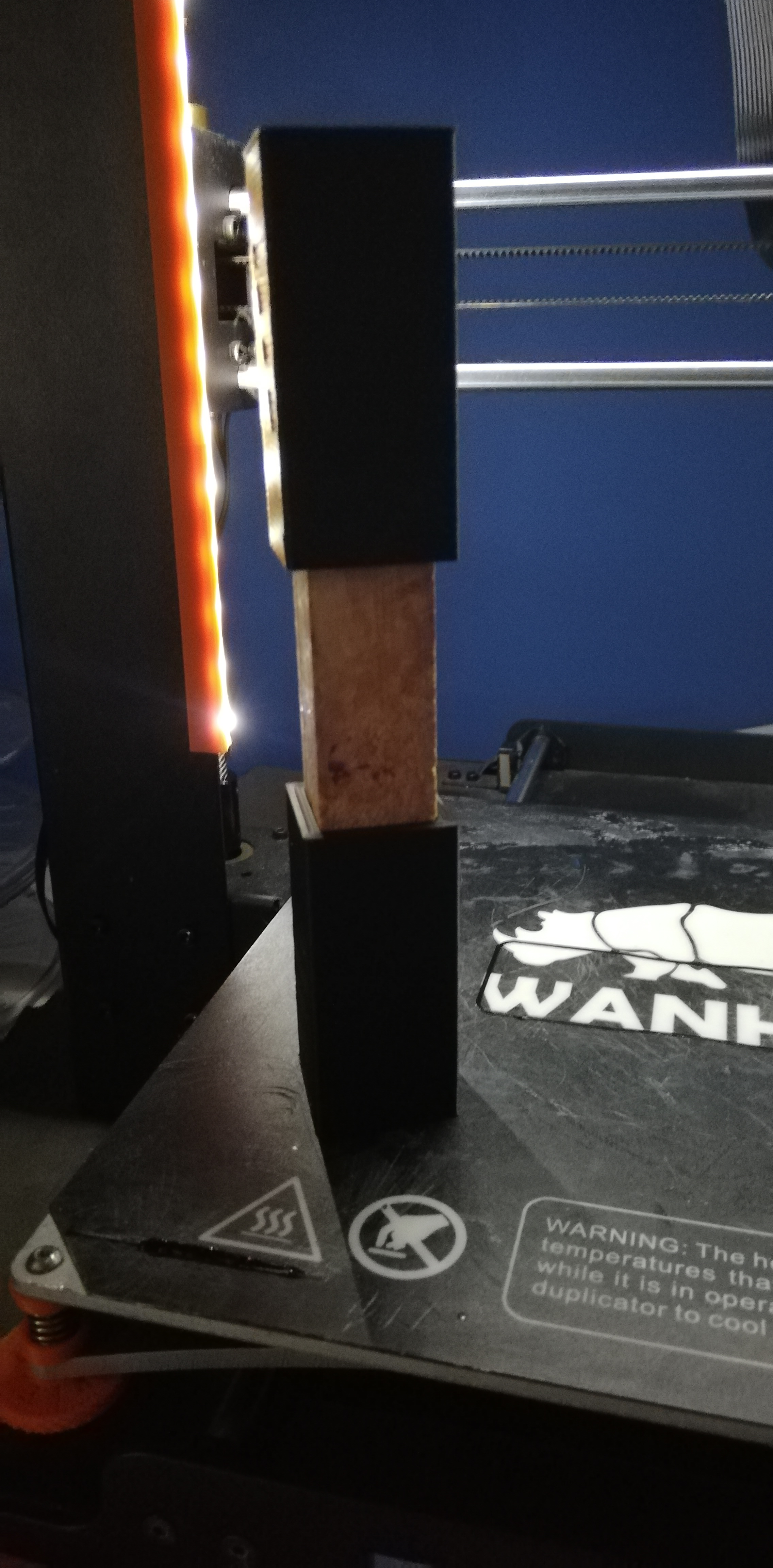

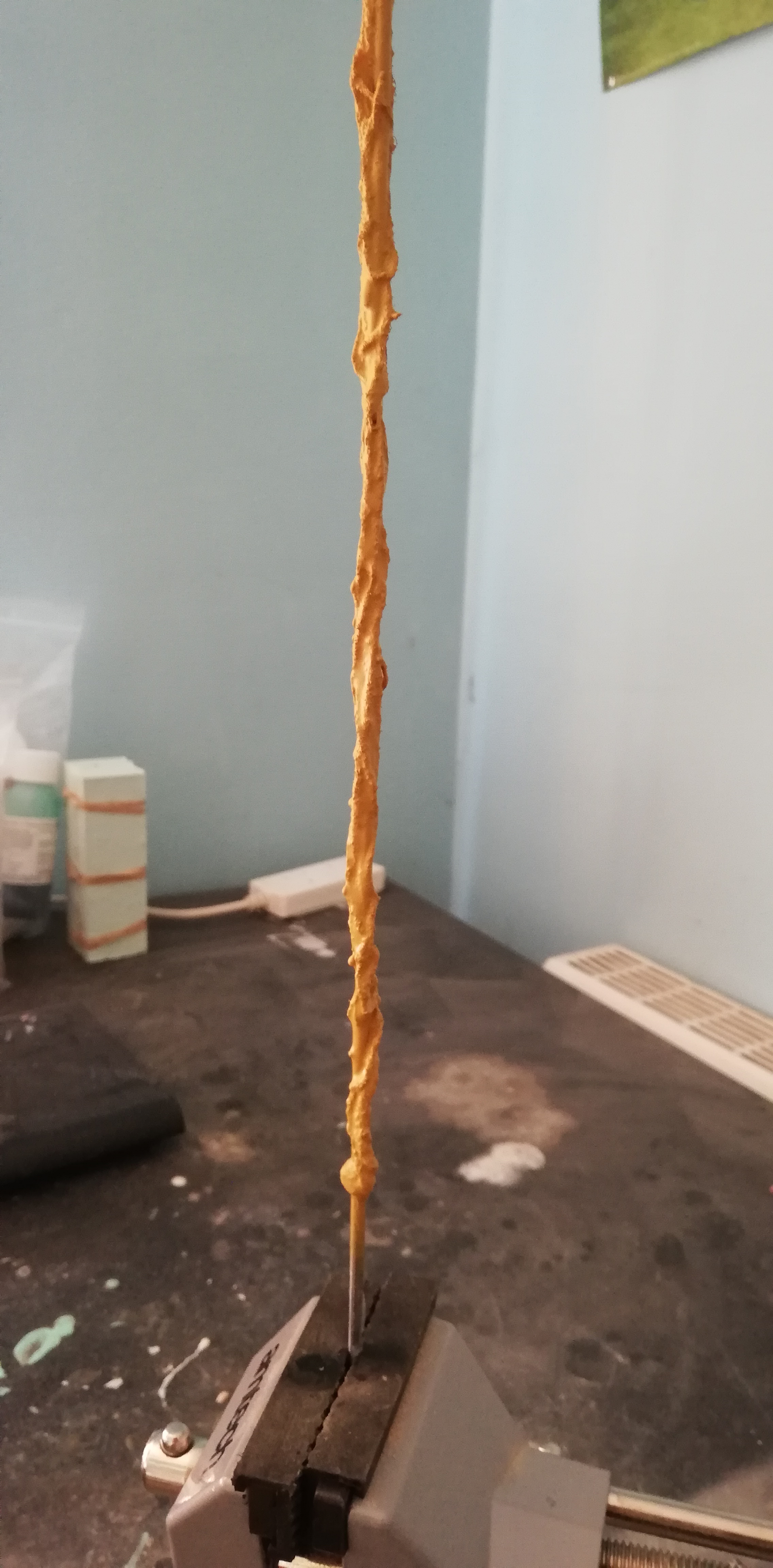

I've got the handle for the Heartbane wand made. It's not perfect by any stretch, but I'm pretty pleased with it considering I've never carved/shaped wood before, and I don't really have the ideal tools for this.
First step was to drill a hole through the middle for the 3mm rod. After trying it 'freehand' and wasting a piece of wood, I decided to print a couple little guides, which would keep the drill bit aligned, and create a nice clean hole. Worked perfectly..
I then used a combination of a dremel and a sharp blade to carve the wood. In the end the dremel wasn't really great, and I got much better results from cutting away slowly with the knife.

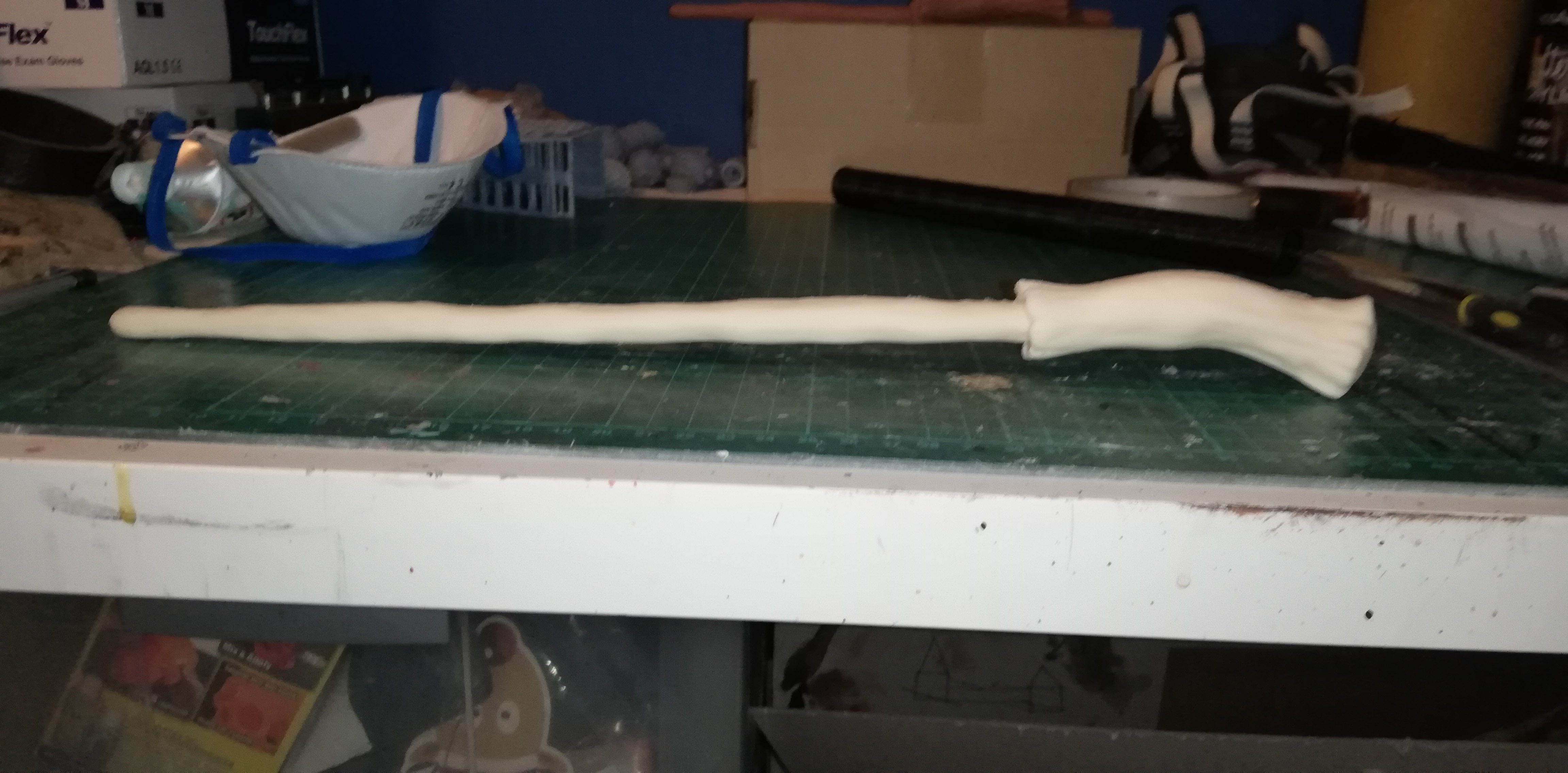

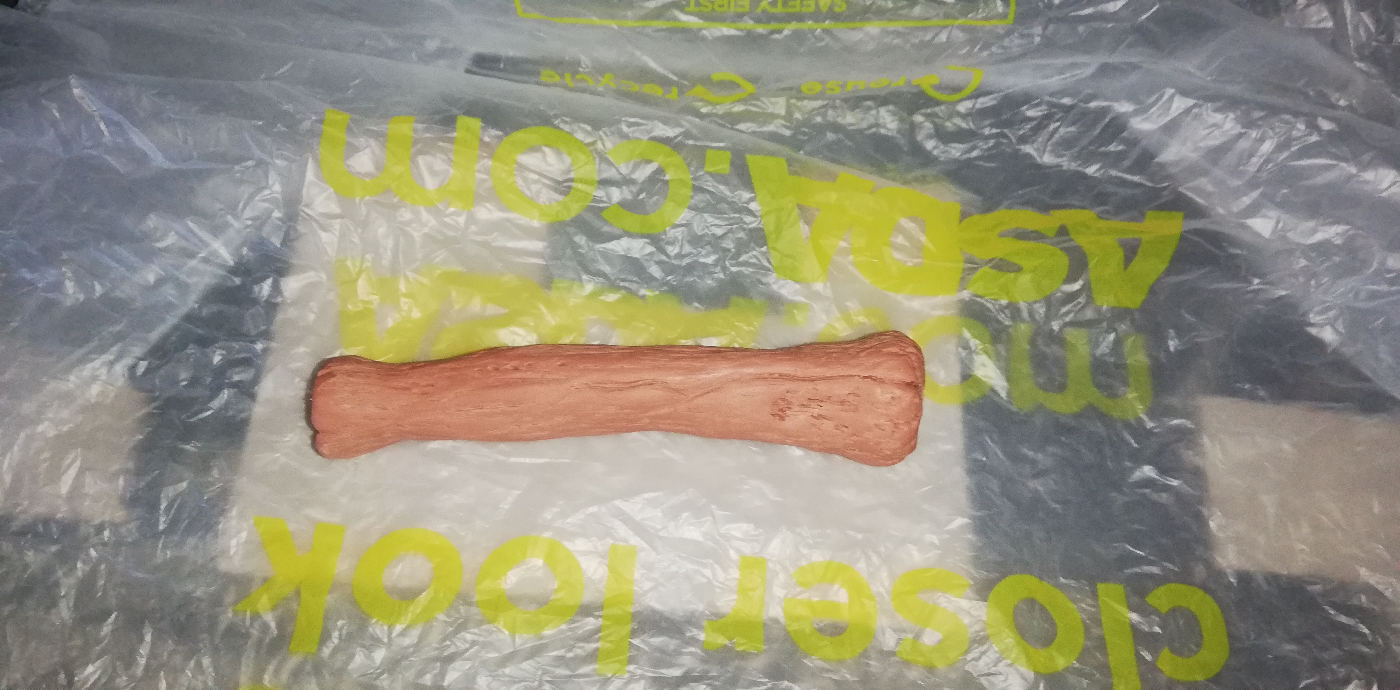

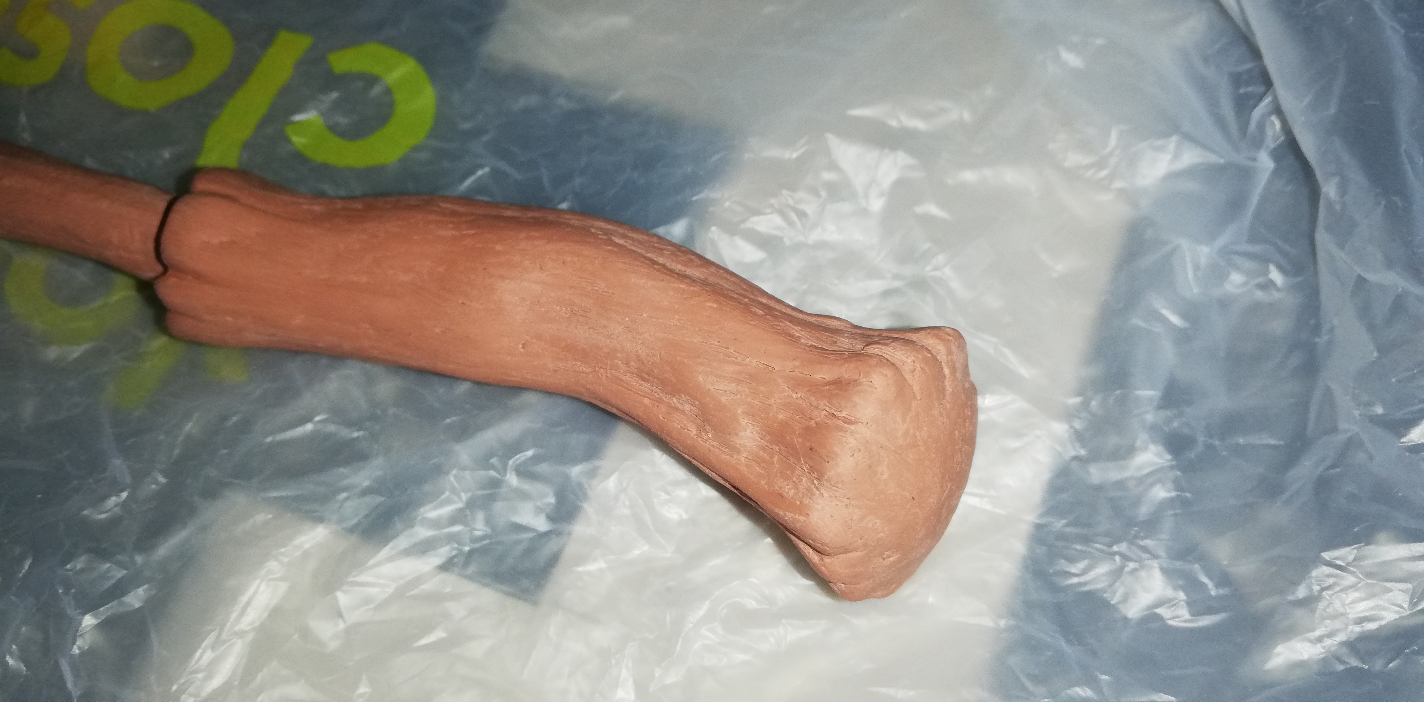

Moving on, I finally got the sculpting for this project done. Although I could have easily sculpted and printed these parts in 3D space, I wanted to have some traditional sculpting in this project.
Firstly, I sculpted the Wildling Wand. I wanted this to be a little more rustic looking.

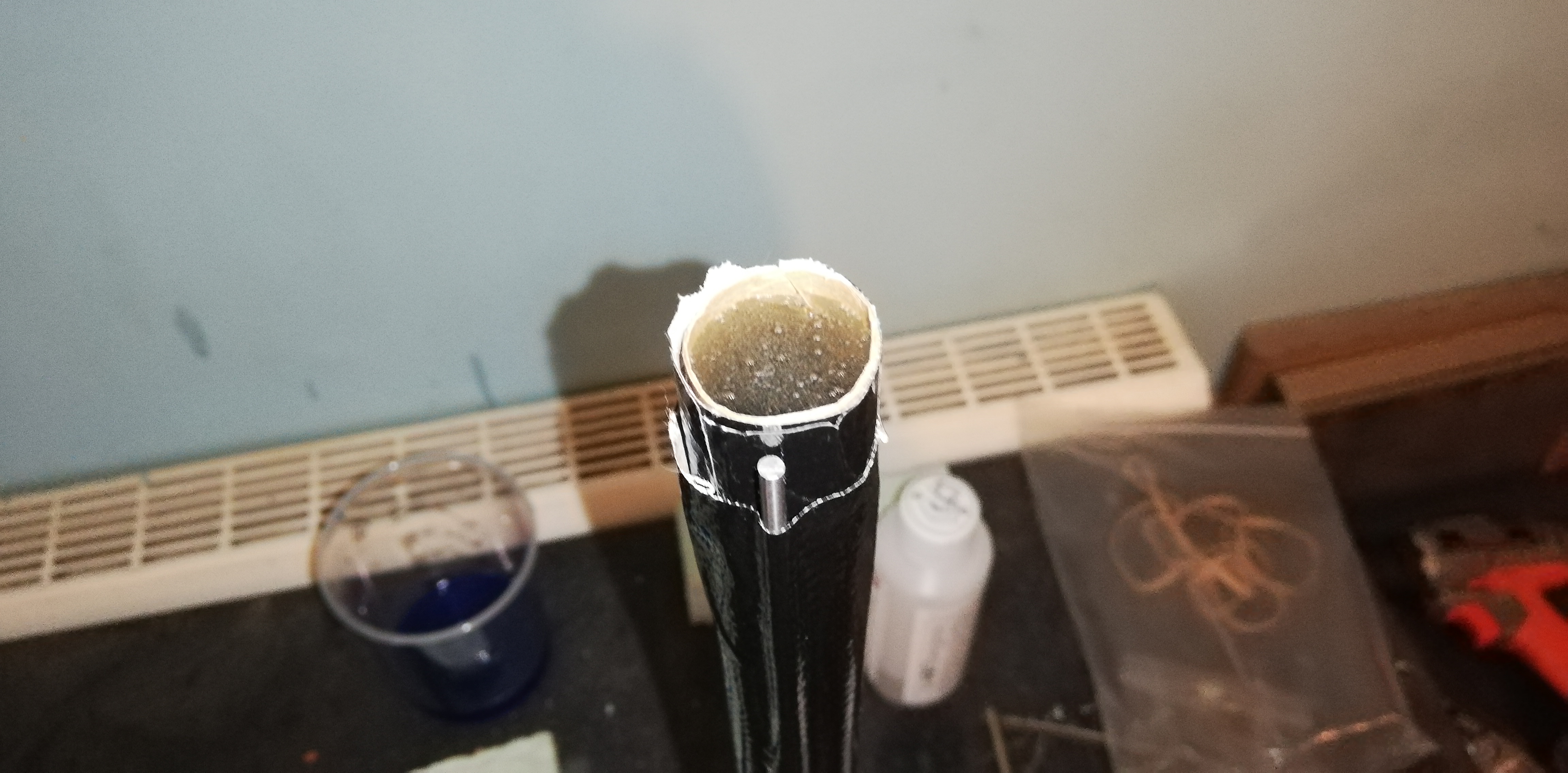

I've also sculpted the handle for the Nightking wand. This will have a clear resin wand, which will be done in two stages.
Next step is to mould both of these, although I'm not sure if I have enough silicone at the moment, so might get half a mould for the time being...but will probably get some more ordered.

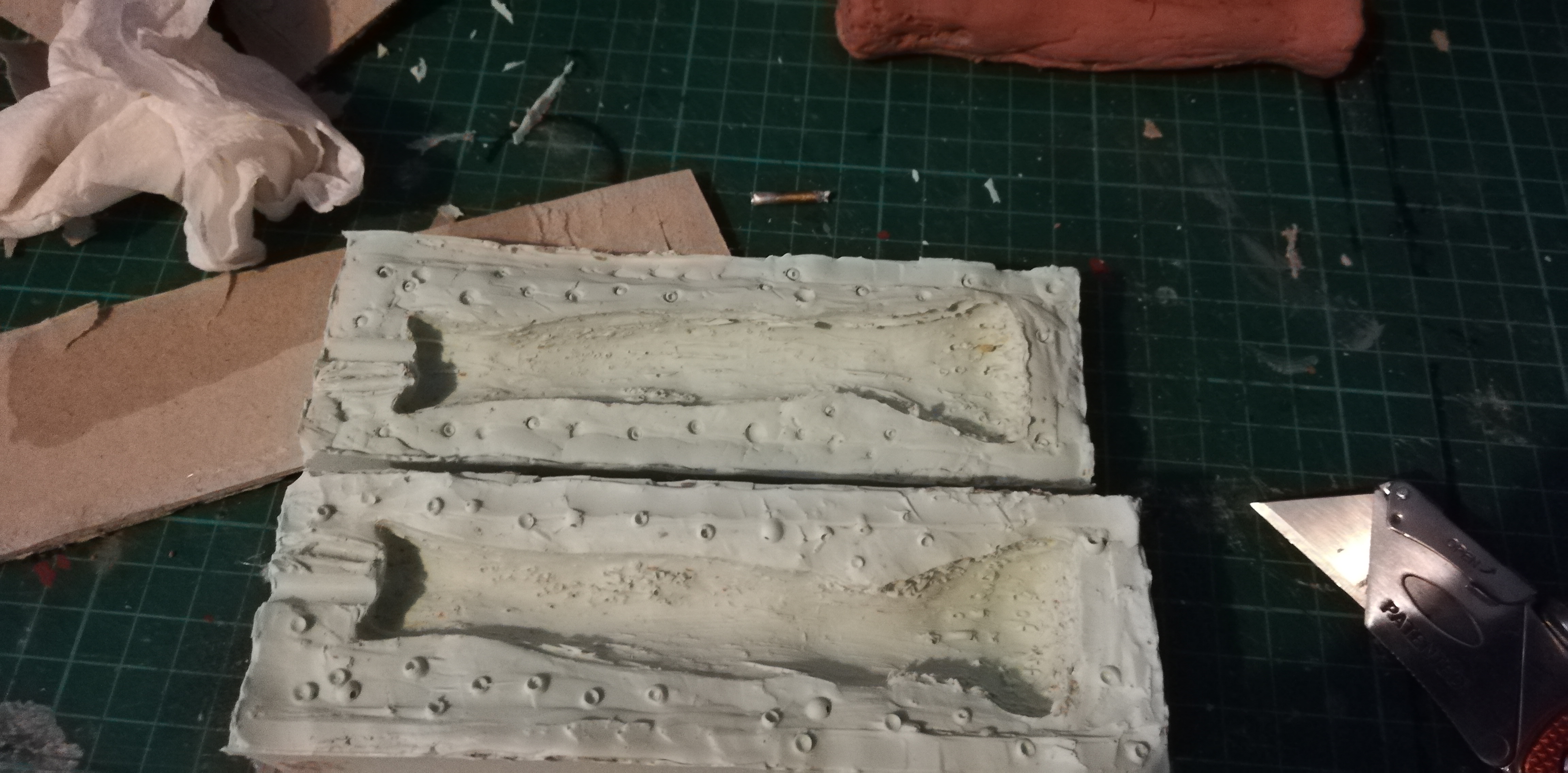

The mould isn't the prettiest mould I've ever made, but It'll work just fine, and that's all that really matters.
Yeah...real messy mould, but the jagged lines help it all fit together nicely o_O But as I say, it'll do it's job, and that's all that matters!

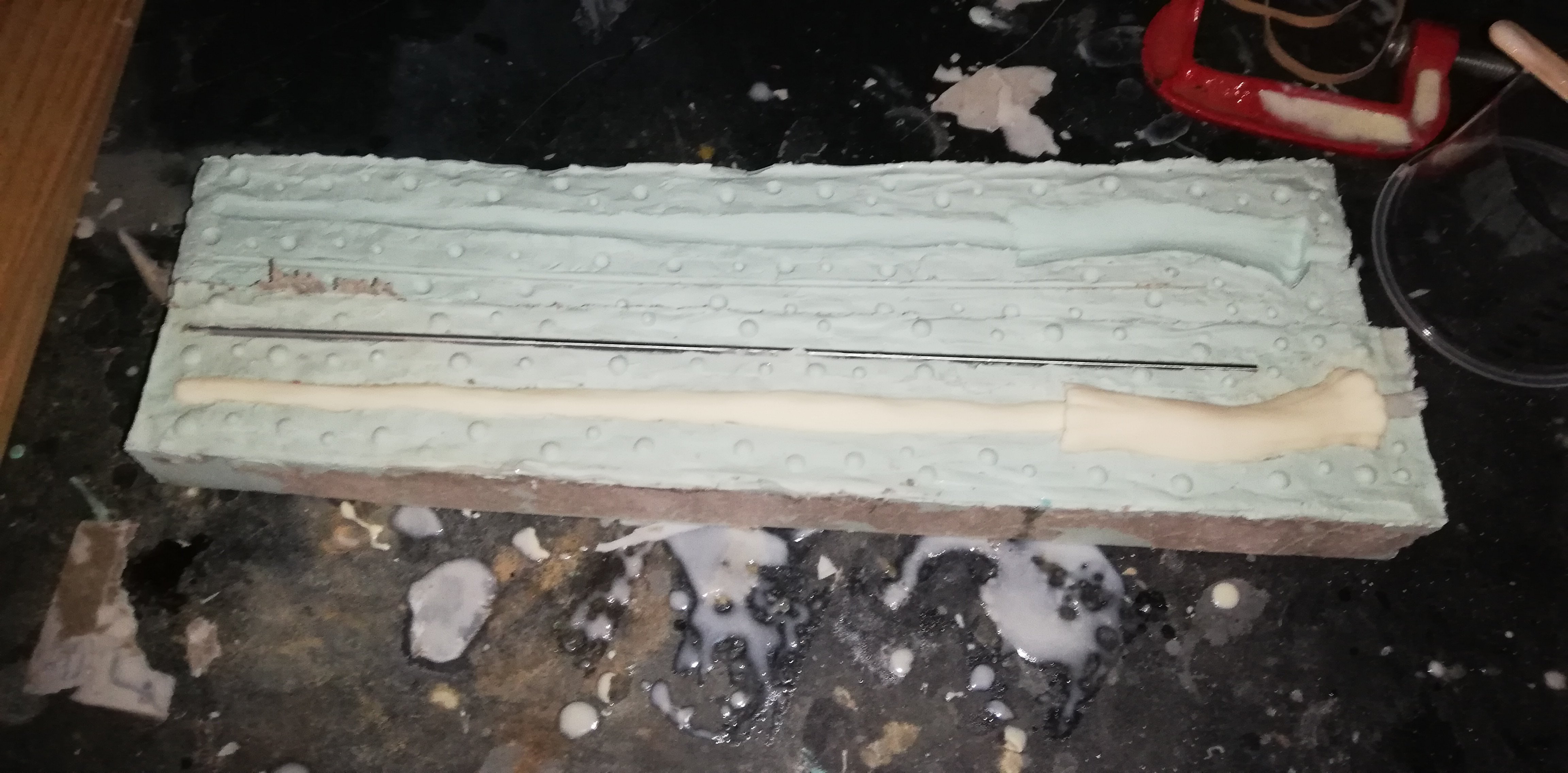

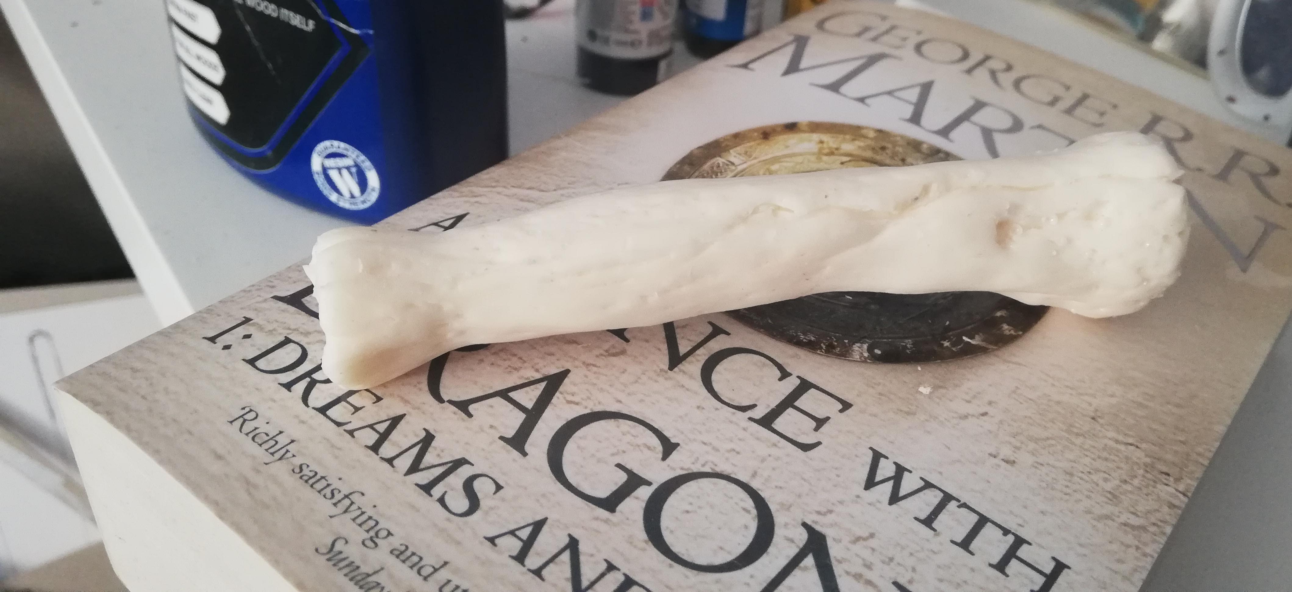

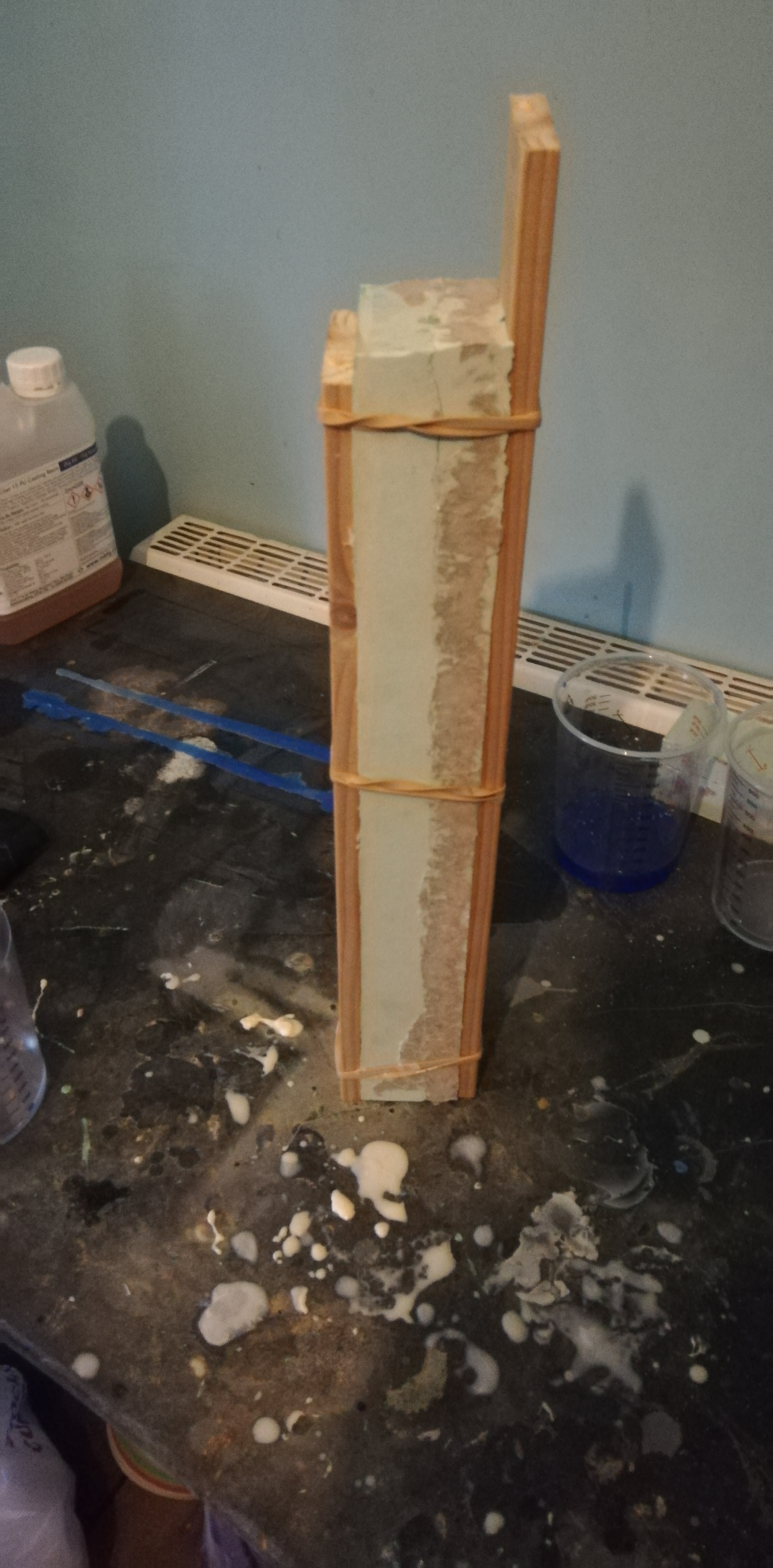

The next thing I did was to make the mould for the wildling wand. This was a little bit of a pain, but I got a half decent mould in the end, although I did have to scrape every last drop of silicone out the bottles. I had literally just enough to make the mould.

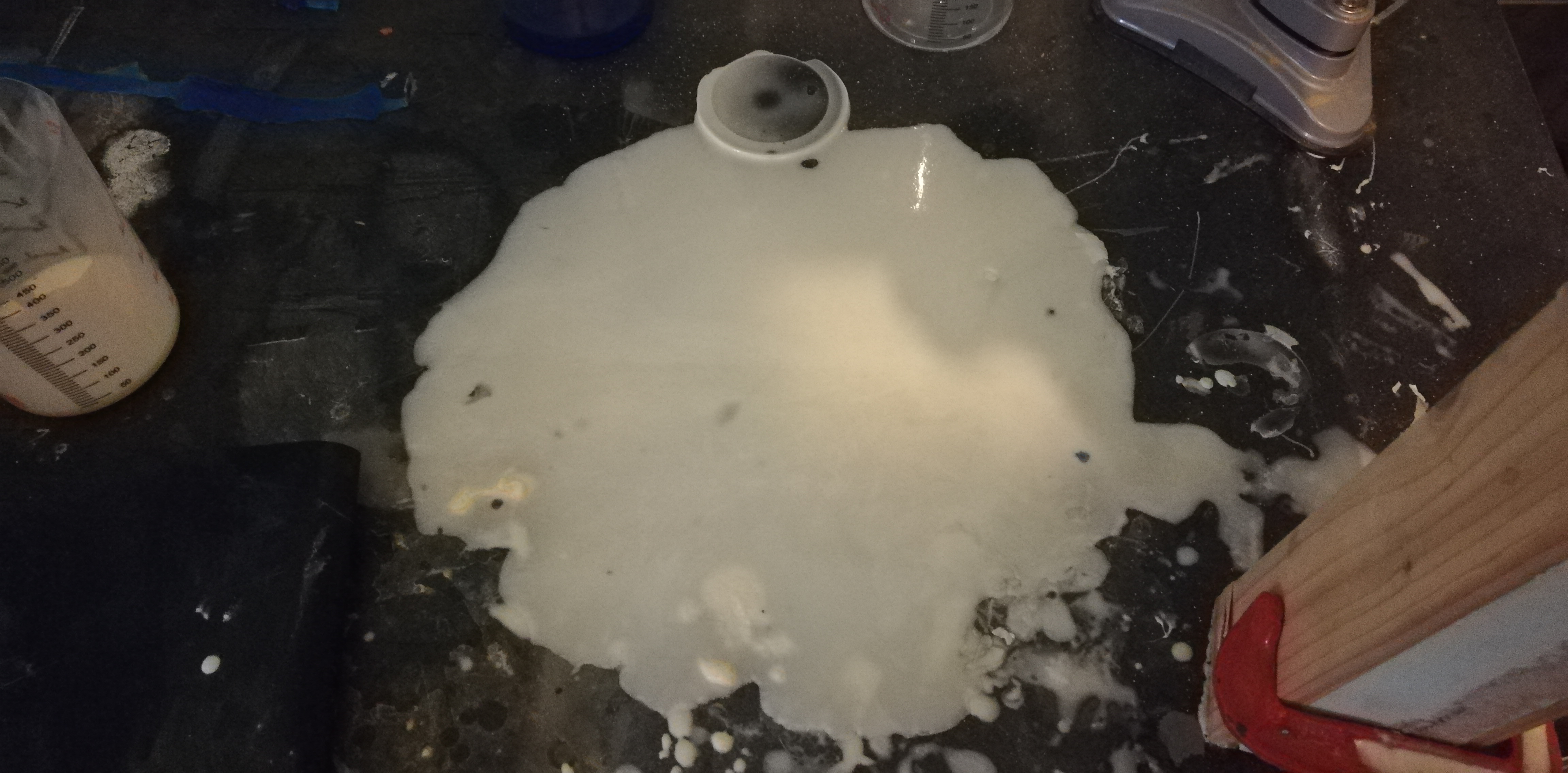

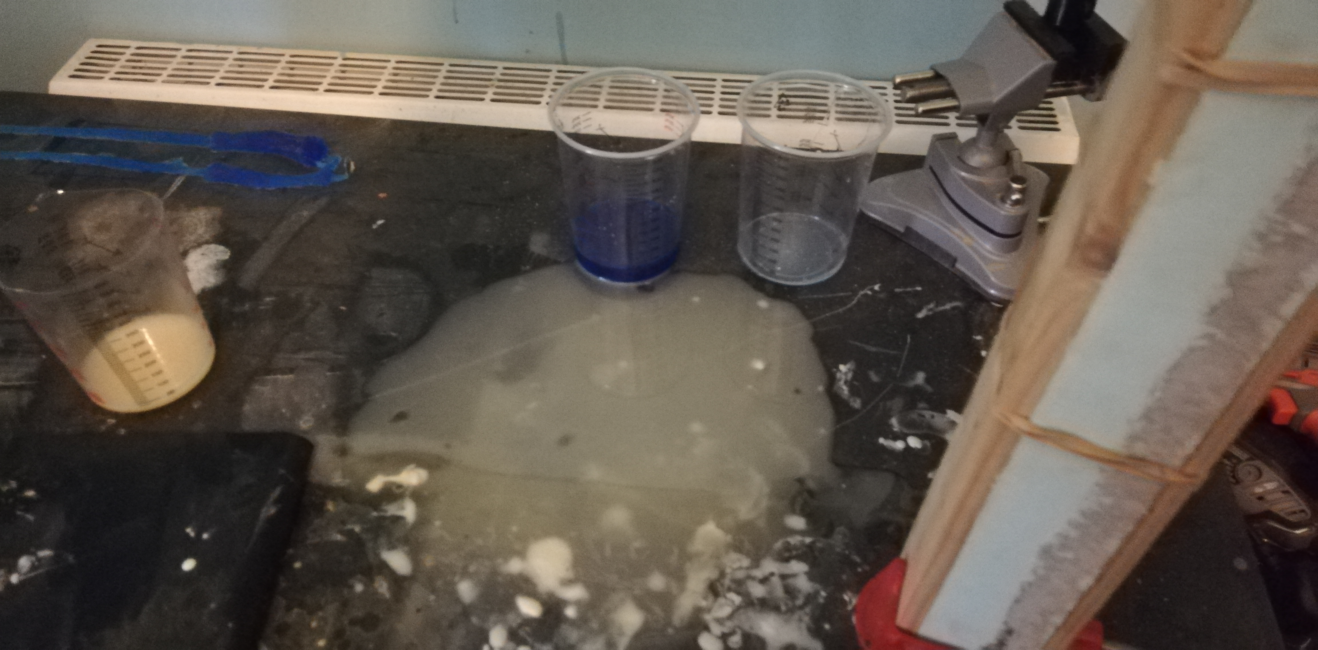

Now...I had a little bit of a oops when casting this one. The mould was all clamped up, and ready to go...
I began to pour my resin, and thought to myself: Huh, this is going very well. Nice clean pour. Ok, should be reaching the top any minute now...any minute no--FUUUUUUUUUUUUUUUUUUUUUUUUUUUUUUUUUUUUUUUUUUUUUUUUUUUUUUUUUUUUUUCK!
Straight out the bottom. I found the problem area, and grabbed a clamp, and put it around the bottom, and tightened it just enough to stop the leak - I didn't want to squish the mould. I stopped the leak, and still had a decent amount of resin left - which thanks to the longer working time - I was able to carry on the pour. I reached the top, and left it until the next day (like, an hour ago as of this post). Thank the moulding gods! No bubbles, and a near enough perfect pull!
The leak also dried, and came up in one big piece. It also took a load of muck off the desk, so...maybe I've stumbled upon a novel way of cleaning work benches. Just spill resin all over it!

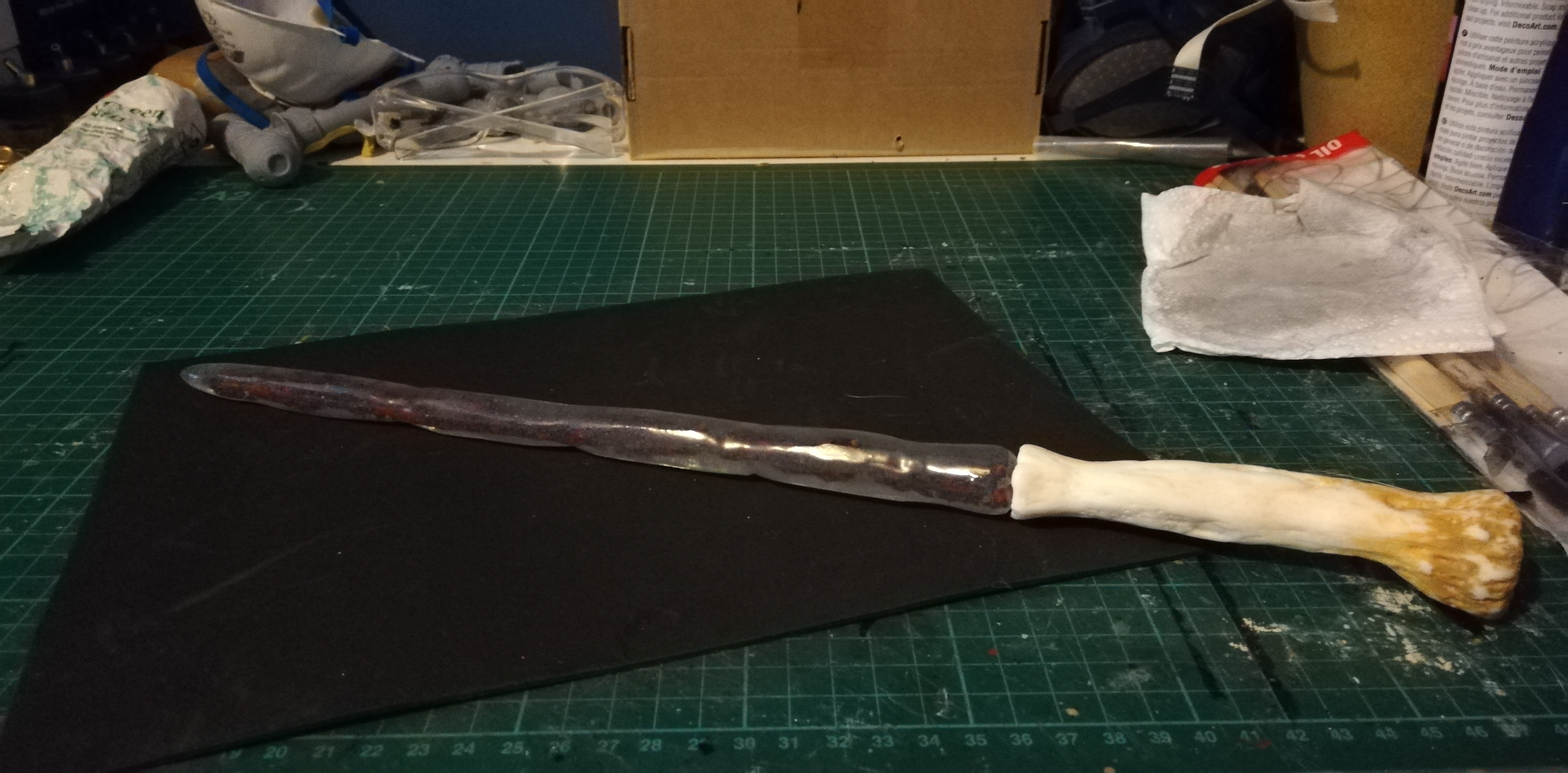

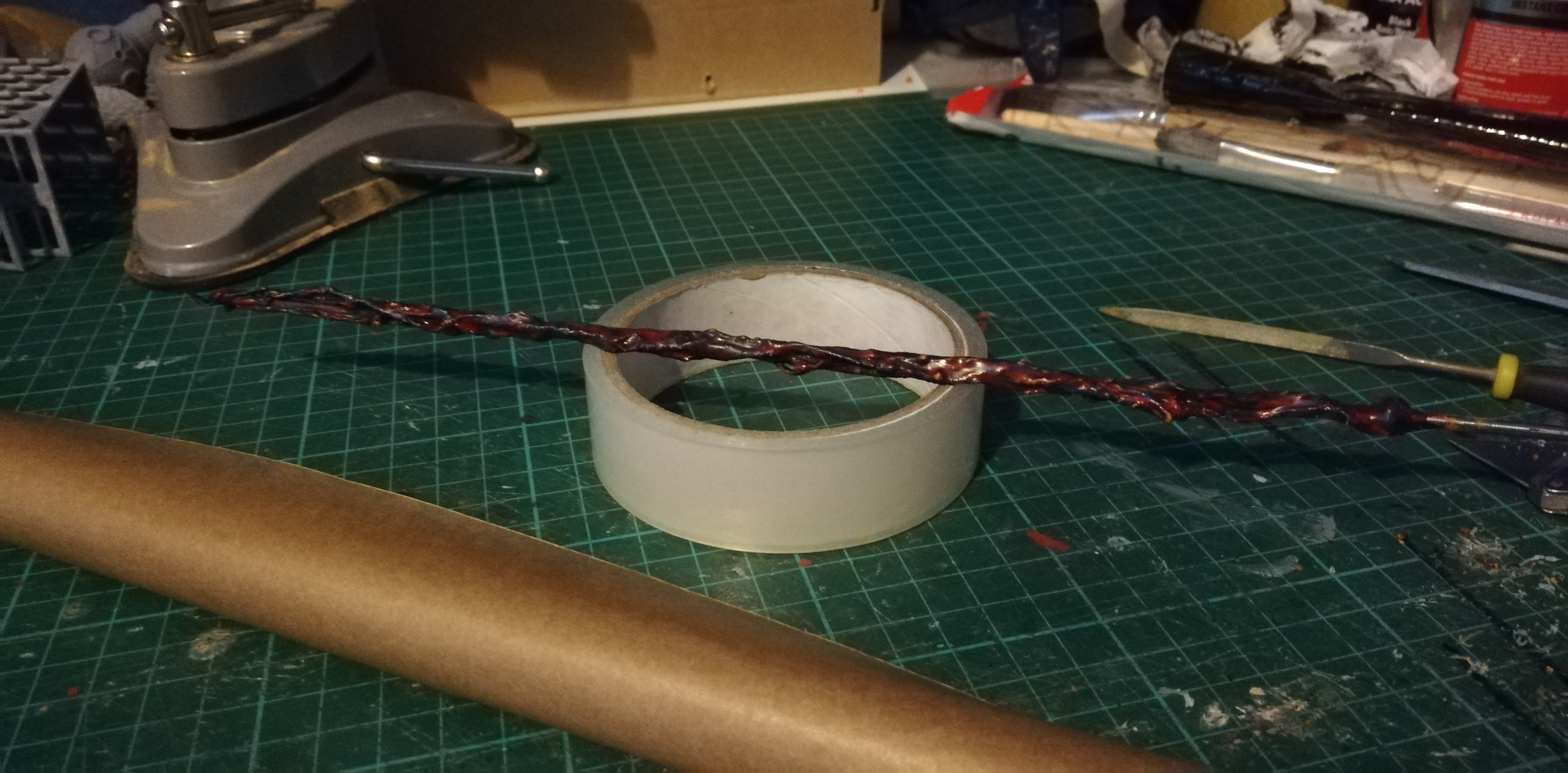

Whilst all of this was going on, I turned my attention to the Night King wand. With the handle cast, It was time to move onto the main wand stem. To give it some additional strength, and to attach it to the handle, I need to place a 3mm rod in the middle. Trouble was, I didn't want to see an obviously metal rod through my clear (or very murky, as you're about to see) wand. So, I thought it would be fun to disguise it as the wands core, which is...Child of the Forest Heart String. (ewwwww!)
So, obviously, I had no idea what that looks like, and I wasn't about to google anything remotely similar. So I did my best guess. I started out by using some string, and unravelling it a little, and gluing it onto the rod with some PVA glue.
I refined it a little, and then, once happy, I gave it a coat of XTC-3D to lock it all in.
Once that was cured, I sprayed it with some primer.
I then brushed on a base coat of red. Annoyingly, I didn't have any red acrylic at hand, so I had to use some Humbrol Enamel, which meant, I had to leave it for a day to dry, and even then, it was still sticky to the touch! (!!!!!)
Looks a little ridiculous just red...So, I had a blue and a purple acrylic lying around, so used that to paint...veins? I guess? I dunno...but it sorta turned out cool..
Some of these pictures are truly dreadful....it's been very wet and dismal around here the past week, and my phones camera is rubbish unless it has decent light. But anyway...
I then gave it a black wash..
Much better!
It was then time to cast the Night King wand, with this in the middle; essentially a blind leap of faith, and you'll see why in a sec..
For the Night King 'mould', I printed a shell, allowing the the excess rod to be inserted, and then wrapped it in baking paper, and duck tape. I strapped a steel rod to it aswell to give it some vertical strength. The printed shells were removed, minus the piece for the rod to sit.
I then mixed my "clear" resin (Glass like, watery clear, they describe it as...). I wanted a little bit of a blue tinge, and so added a tiny weeny little bit of blue dye...no, really...it was hardly any...
Yeah...waaaaaaay too blue. So I used it to clean out the wildling wand mould. Shortly after this, I read "Do not use this in condensation cured silicone..." Errrr
So I ripped that out the mould as quick as a could. I was a little concerned that it wasn't going to cure, because these "test pieces" if you like, were quite floppy, and I then read on the bottle, that the recommended depth was up to 25mm. The wand is 2.5mm x 290mm...But this was all after I had poured it into the mould, so not much I could do.
This one - thankfully - didn't leak out the bottom.
I waited once again until the next day, and I unwrapped it to reveal...clear, glass like...oh, no, forget that. It's murky dish water...nice!

First, as always, we'll start where we left off with the casting of the Wildling Wand, and the Night King Wand.
Little of cleanup to do, but a pretty perfect pull apart from a small hole from the pour spout.
Next we move onto the Night King Wand, and shaping it...
Quickly realised it was a stupidly messy job. I was covered head to toe in a white powder....looked like the snow monster from Empire Strikes Back!
But anyway, I kept attacking it with my dremel, and got a shape I was kinda happy with at the time, but looking at it now, I kinda don't like it at-all in it's current form...But I think I can save it. But I got it wet sanded up to 1500 grit, and it came up pretty nice. Little murkier than I'd hoped, but not too bad.
I know exactly how I want it to look, I just don't really know how to achieve it using my dremel. It's the only useful tool I have for this kinda thing, so it's either dremel, or a large file and trying to do it by hand. I want it to look more choppy and jagged. A reminder of what my concept for it looked like..
So I'm going to have to come up with something for that, maybe attack it with the dremel some more, and hold my nerve a little, as I an kinda holding myself by the fact that it's a one chance kinda thing? if that makes sense...

I got all of the wand histories finished up, printed and weathered. Simple process really. Grab some tea - I used 5 or 6 bags. Make some tea - no milk or sugar - obviously...
Pour tea, and use a brush to spread it out a bit. Let it settle for a while...
Pour loose tea back into container, and dab paper with kitchen roll to remove excess moisture...
Bake in the oven, until well risen, or golden brown....
Repeat ten more times..
I also got most of the box lids covered too, apart from the two smaller boxes, as I ran out of leather. I've also made a new box for the Night King wand, as it was a little too small, which means my maths has failed me once again!
They're pretty tight fits right now, but once I file the corners of the bases a little, they should be a little looser.
Final update for today - I got the rods for the main wands cut to the right sizes, which meant I got to see all of the wands 'assembled' for the first time!

So, after seeing the Night King wand with all of the others, I really wasn't happy with it. It didn't capture what I originally wanted, and so changed needed to be made. I had to throw caution to the wind, and sort of just go for it. Part of me was holding back a little when using the dremel, as I didn't want to ruin it, or sand too far and hit the 'core'. But I had to forget that if I was going to achieve a result I was happy with.
I started with a large file, and filed parts off, forming a more streamlined shape.
I had slimmed it down a fair bit, but it was remaining annoyingly rounded. So I made some large flat spots all over, until the roundness was all but gone. I then used the dremel a little more to finish it off. I had finally got rid of the roundness, and was happier. I gave it a quick clean up wet sand, and then a coat of XTC-3D. It really gave it a shine, and cleared up the murkiness.
I still wasn't overly sure about it. But I decided to drill the hole in the handle, and do a test fit. I was instantly much happier with it upon seeing it attached to the handle. It's kinda difficult to picture at the moment, but It looks sooooo much better than it did before hand!
A few bits are a little dull, as I think I handled it a little too much before it was fully cured. A high grit wet sand should clean those parts up and have it glassy smooth.

The final step before painting was to get the wand boxes finished up. I wanted to do these first before painting, because I needed to use the wands in the process, and didn't want to be handling freshly painted items too much.
Each box got a foam insert, which was then coated in some crushed velvet. £5 on ebay for 1x 1.5m of the stuff - Bargain! I picked up a few different colors (although, I really should have grabbed some more...grrrr!), as well as some decorative ribbon.
The foam inserts were pretty simple to make, but very tedious, and surprisingly hard work. My back doesn't approve!
I started with a card template for each wand. I made the template by simply drawing around the rough profile of each wand. Some are pretty crude, and in no way symmetrical. I tried to fix this as I went..
I then traced this pattern on some foam. The foam is two layers thick, with the template cut out on the top piece. I then place the wand inside the foam, and see if anything needs to be added or taken away. I'm not concerned with getting a super tight fit, aslong as the wand fits the space nicely, it'll do.
This is the template for the Targaryen Wand. A strip of foam is added up the middle to deal with the height difference between the handle and the wand stem. This allows everything to sit more or less flush. I also added a little bit of foam where the side of the head would fit, again, allowing it to rest flush, rather than at an angle. The fit for this wand was a little too close for comfort, but it's just about a loose enough fit.
I then placed the velvet inside loose, to check that the fit was still good with the fabric.
For this wand, I used a real thin layer of PVA glue to stick it down. I wasted an entire day trying to figure out the best way to do this, as I was unable to locate my double sided tape. The next day, however, after finishing just 3 boxes, and feeling very frustrated, I found the tap, which allowed me to pretty quickly power through and finish the others.
Some more examples:
Only one wand had an oddly crap fit, and it's the Baratheon wand. The perfectionist in me wants to tweak it, but I also want to finish this project before the next ice age, so...you know...
I've got 10 of the 11 boxes done. I'm just waiting on some black velvet to finish the Night King box. it requires a little more work anyway, so I don't mind waiting to finish that one.
